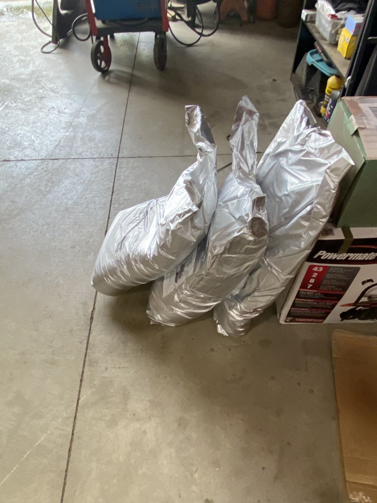

  17. Kind of, a few things.
    There’s A 2 part epoxy, mix with sand for volume and I can’t break it. But it’s hard to set up a pour, sets in 3 minutes and 3-4” gets hot enough to start a fire. Toughest **** I’ve ever seen, but sticky as hell, burns up mold releasing stuff. 30 ton press and nothing.
    A low temp thermo plastic that’s incredibly resilient. Shore D hardness equals a hard hat.
    It’s hard but flimsy if that makes any sense, the shape and detail is great but needs some stiff backing
    I’m going to try a 16lb density foam. Just showed up the other day. Saw a video of it and the guy whacked it pretty good with a BF ball peen H and could dent it or break it.
