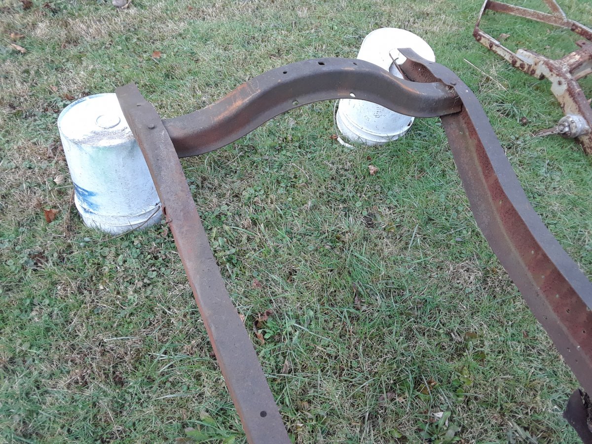

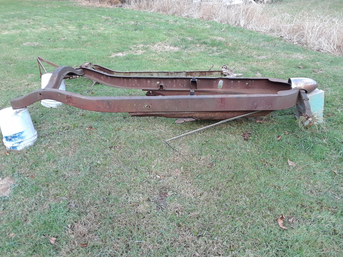

    I picked some remains from an old racers s**** pile. I though it was too nice to throw away. I really don't need another project. But I might have enough stuff laying around to make it a roller, maybe even make it move under it's own power. frame4.jpg

    It's an old midget or sprint car frame. I think. Or maybe it was an amu*****t park ride! lol Belly pan was an old car hood. Still has a strip of chrome attached to it.

    That may be an Es*** frame. In the pre-WW II era there was an automotive ch***is that was popular with circle track builders that looked similar to the one you brought home.
    Someone with better knowledge of race car fabrication in that era would have to confirm it, but I think Es***.

    Measure the approximate wheelbase from the center of the front spring to the top of the arch of the rear kick up.
    Midgets are nominally 72 inches and sprint cars 82 and 86.

    Frame kick-up does not look as abrupt as an Es***. It looks like the very back of frame curves back to nearly horizontal. I'm thinking that the kick-up is actually from the front of the donor car. Isn't the rear crossmember a Ford piece?
    Curved frame front corners were common, although usually smaller radius, interconnected by a short straight crossmember section. I'm told that Dreyer ch***is were so constructed. Can you see any weld evident, were the rails transition from straight to curved, or does it seem formed this way?
    Front belly pan is clever and kind of cool. I don't think engine belly pans were commonly used way back then.
    As suggested above, I'm curious what the wheelbase is. Although, it may not be evident whether the rear crossmember was over or behind the rear axle.
    In any event, it's a neat piece, and a good starting point for a cool project that could be built with inexpensive pieces you could pick up at a couple of swap meets. I'd s**** the bullet nose idea, and hold off on the front belly pan until you can mock-up the rest of the car, so you can better envision what it would look like.

    Note motor mount location and front belly pan.
    Lakester?
