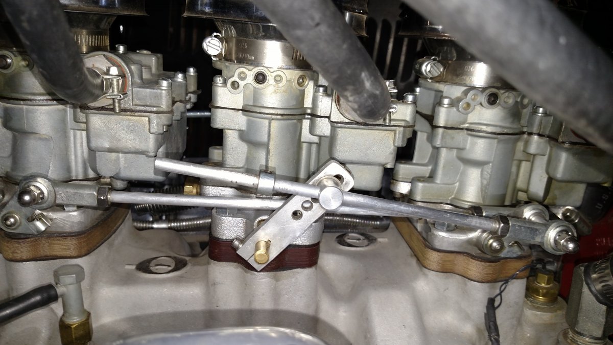

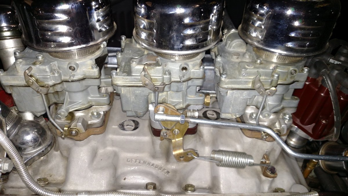

    Thanks for the reply. Here are some more shots
    Curb Side

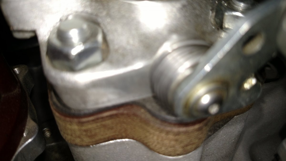

    Here is where the accelerator linkage is attached to the throttle shaft on the rear carb. This is the hardware that was tightened to the shaft to secure the bell crank.. It was you know, just the kind of loose that the bolt just 'popped' a little to tighten it a little more snug. accelerator linkage rear carb.jpg

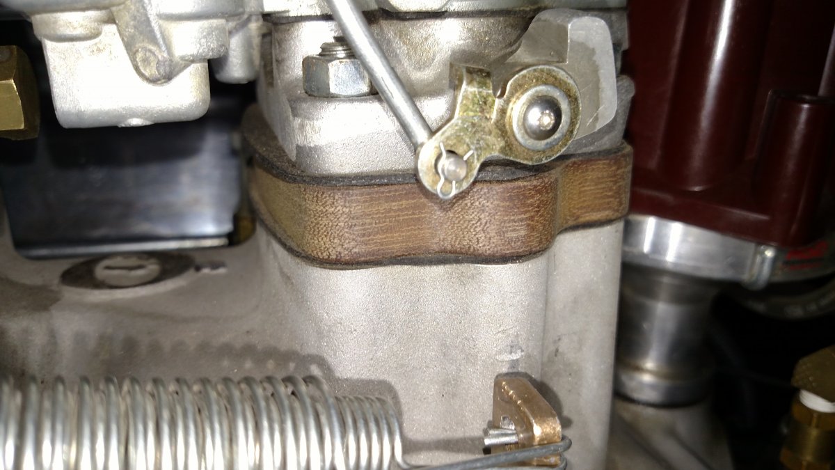

    The outboard carbs have the mousetrap type springs. This is as good a photo that I could get with out the sun being up and the car outside. Thanks for the information, I really appreciate the feedback.

  9. Your center carb is leaking under the spacer, the spacer is wet. Possibly a vacuum leak as well. On some of the 2g and 2gc carbs I will use a spring under the accelerator pump to help close the end carbs. In your case you could put an additional stop on the linkage to push the end carbs closed as well.
  10. miller
    Joined: Aug 5, 2006
    Posts: 527
    miller
    from New Jersey
    ...after looking at the pics....I would check to see that the rod that rides and is pulled by the center carb linkage fitting is not binding and sticking,that happened to me,...also I would disconnect the linkage from the front and back carbs,put a pull close extra spring on the front and back carbs,.. and then looking down inside them to the ****er flies making sure there fully seated/closed and nothing come loose,then I would set the linkage rod length from the front to the back carb,...the other thing I would check is to see if the intake manifold gasket is leaking from the bottom of the intake which can not be seen,...I was told if the heads are milled the intake/head mating surfaces may not be the same plane which will cause a air leak from under the intake,...miller

    Thanks but the gas in the photo was from all my messing with the accelerator linkages getting them set up with out the engine running. I'll clean it up and keep an eye on it but I had gas everywhere.
