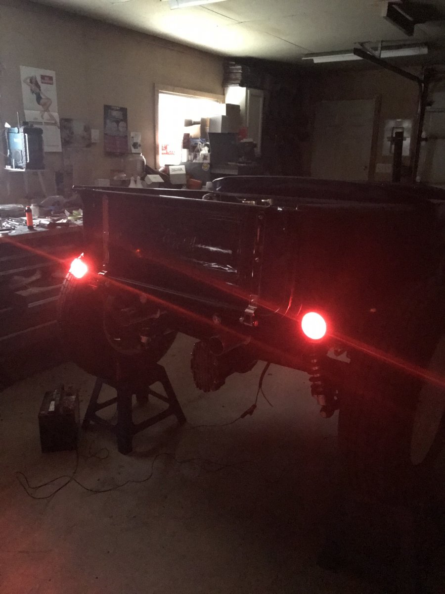

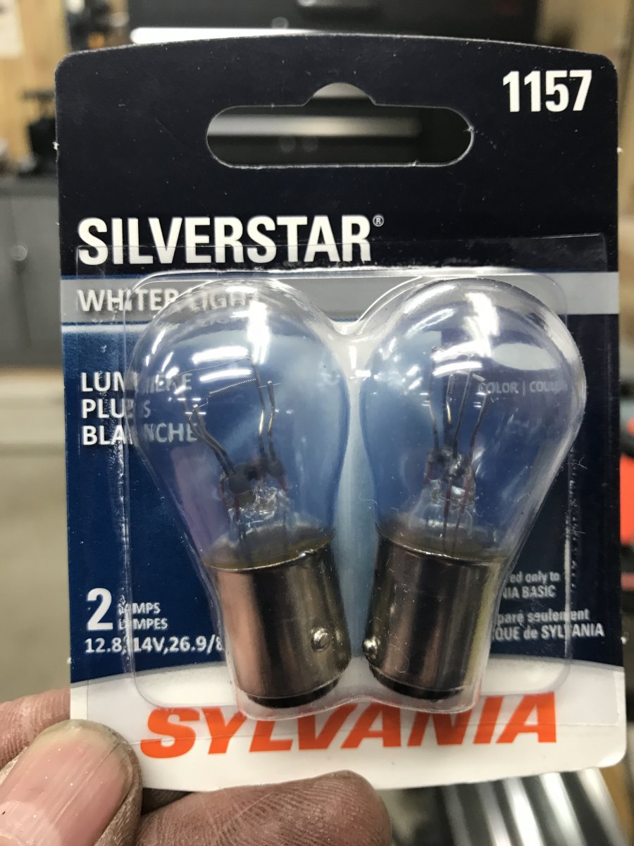

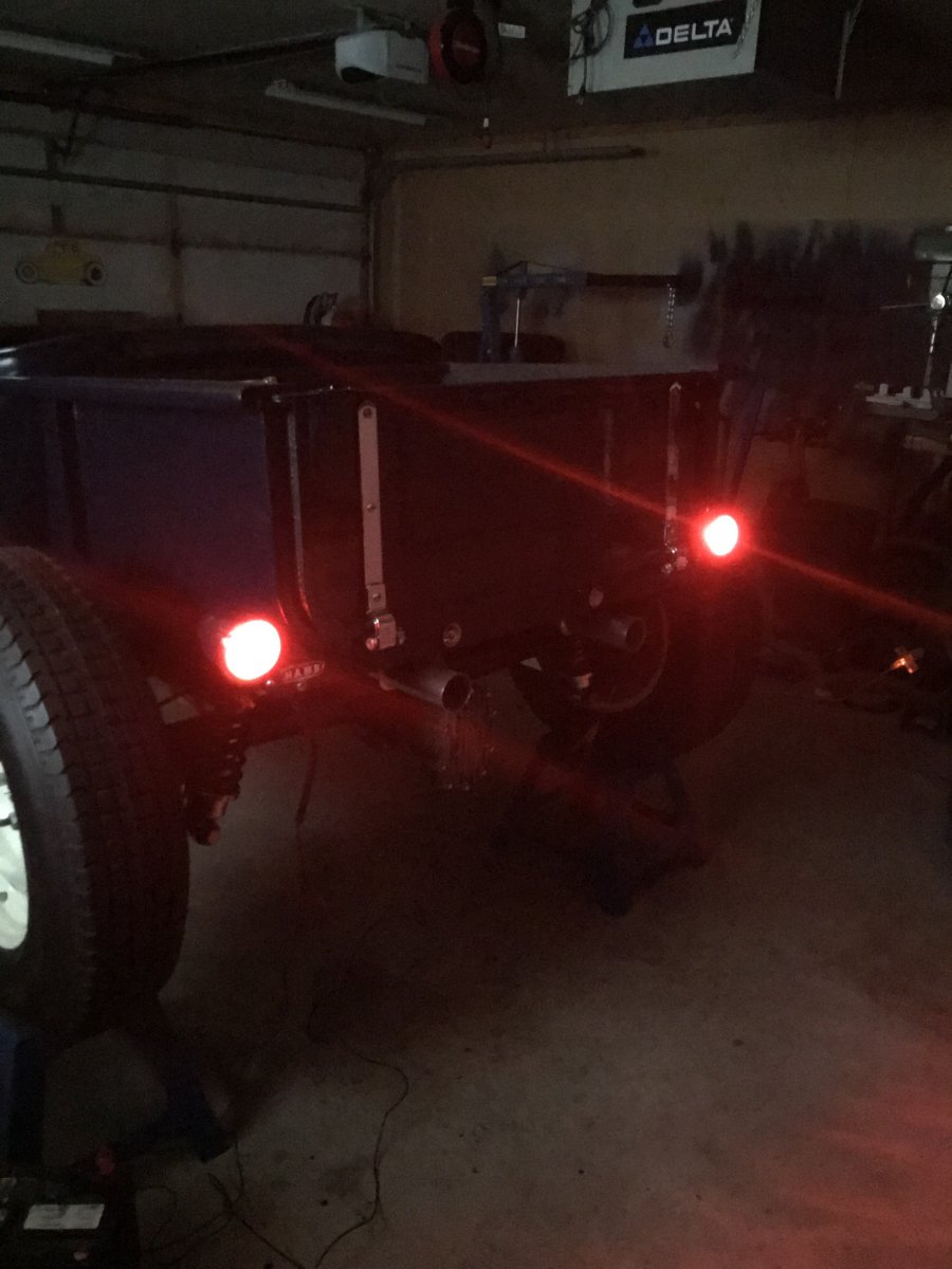

    I just finished removing the LED tail lights from my 26 RPU, contrary to what you might think they were not as bright as I thought they should be.
    They also had plastic lenses
    So, I ordered up a pair of nice gl*** lenses and new bulb sockets, then I painted the inside of the housings a bright gloss white.
    That along with a pair of Sylvania halogen 1157 bulbs did the trick.

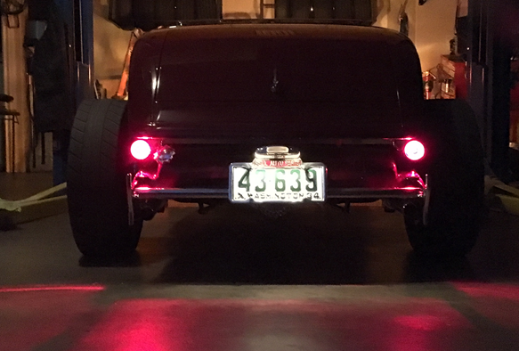

    Totally agree about the white, I made housings out of white aluminum to reflect the most light, results speak for themselves. To come to think of it here I am taking photos of my tail lights, seeing how well they work.
    Screenshot_20181001-230027_Photobucket.jpg Screenshot_20181001-230138_Photobucket.jpg Screenshot_20181001-230049_Photobucket.jpg Screenshot_20181001-230102_Photobucket.jpg Screenshot_20181001-230118_Photobucket.jpg
