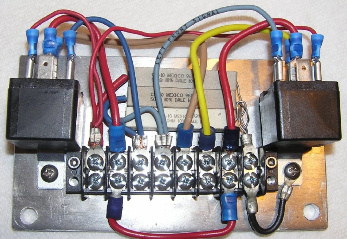

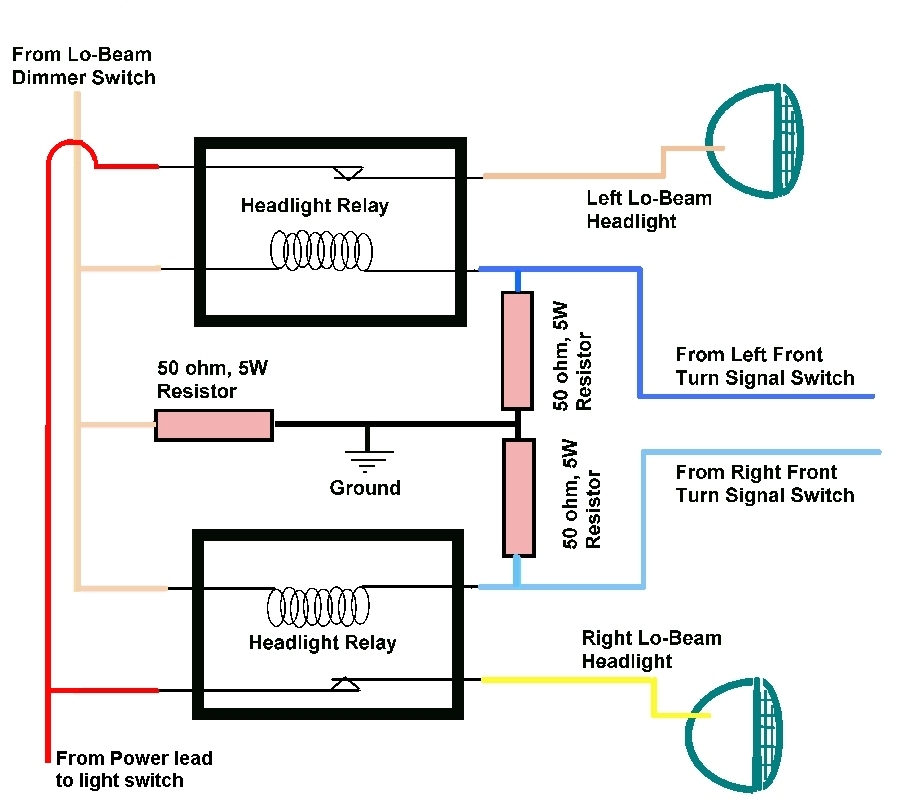

    I convert all my builds to flashing headlight for turn signals. Avoids the little hard to see accessory lights and no one can ignore them!! Use electronic flasher so its resistance isn't an issue. A couple cheap Bosch relays, 3 inexpensive resistors, a terminal strip and some chunks of wire. Cheap and easy.
    That's also one of my big gripes; I LOVE to see my Willys on the road but I am always driving it so never get to see it!!
