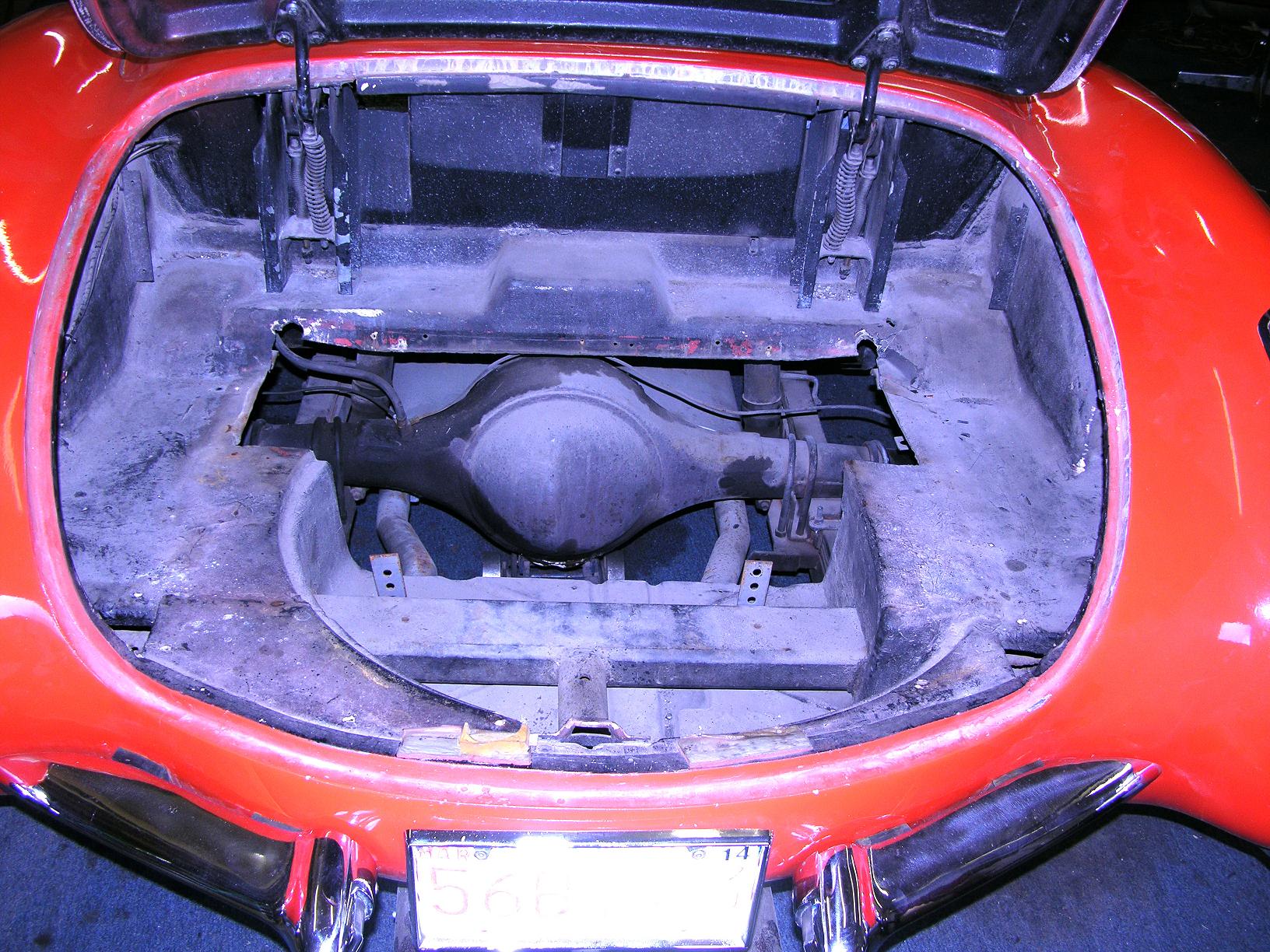

    Plan on replacing the rear crossmember. Congrats on the purchase.

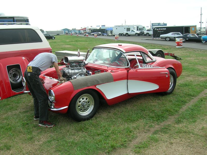

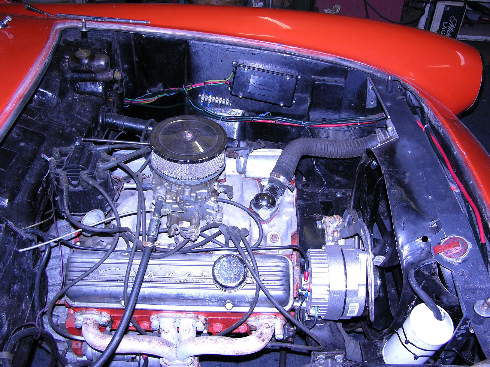

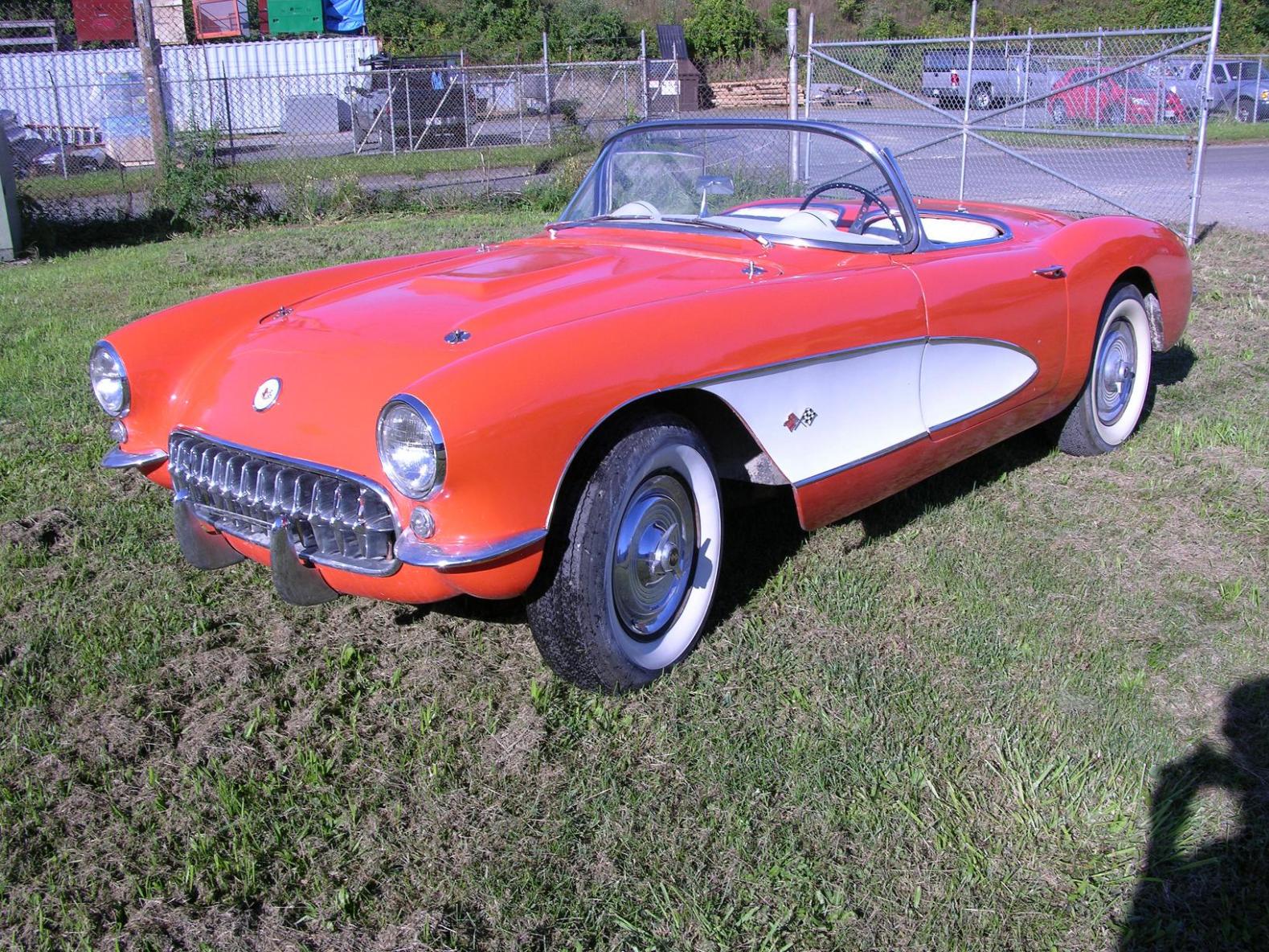

    I received my new toy a few weeks ago, a former drag 57 Corvette. It was advertised as a driver and was fairly complete. It turned out to be better than I was actually looking for when I received it.
    I was going to drive it for a few months until the winter, and then do a frame off.
    Closer exam of it showed that it had been hastily put back together to sell it to the person that I bought it off of.

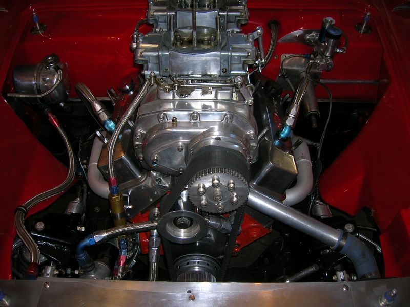

    I first noticed that the alt. wire was only 16 ga. so that had to be replaced along with a new batt. shut off switch. While under the dash, I noticed that it must have been re-wired by an Italian as it was stuffed with a lot of spaghetti in place of the wiring. At first , I noticed three new terminal blocks and a nice seven place fuse panel. Then I noticed that most of the wires had been cut and by-p***ed and only two fusses were connected up. That had to go.
    I took out my handy dandy wire cutters and proceeded to cut everything in view. I then mounted a seven place circuit panel box under the hood and began stringing different colored wires of different sizes around the car. When I got to the alt. regulator, I decided that there were too many wires, so I bought a new alt. with an internal regulator.
    After a 1/2 a box of wire ties, all the wires were tucked up nicely in place.
    My attention then went to stopping it. After replacing most of the braking system , tires (P225 and P215's)and wheels (7"), I noticed that the Olds rear axle had a Pontiac shurtrac center section in it and someone drilled the wheel bolt holes off center, so I have a new set of axles on order.
    I am now installing a new windshield wiper ***y. from Specialty Power Windows to replace the missing parts that were not needed for drag racing. (By the way, horns and the front sway bar and emergency brake ***y' are not needed for racing either.)
    I am completely amazed by the ***ortment of fasteners used by the mechanic that ***embled it, (including wood screws) along with the total lack of lock washers, I don't think he had any wrenches to tighten up any of the nuts ether.
    I should have it back on the road in a few weeks and when all is said and done, and about $4000 later, I am still very happy with the purchase.
    Now I can drive it till the snow falls, and I will then be ready for my my frame off.

    The windshield wiper kit was a breeze, One look at the video and it went like a charm. I took out the seat (two bolts each) and because I have no heater, I could have held a dance under the dash.
    I fell in love with the color when I mixed a gallon at a paint store where I worked in 58, for a friend of mine.
    Note the position of the jumper wire on the alt. Not technically correct, but it has worked perfectly on my other cars, The alt. is for a 76 Elcamino and is cheap at $55. (88) amps)

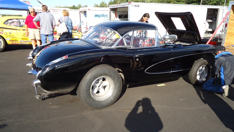

    I fell in love with this 57 up at the Hot Rod Reunion in Epping. Instead of a straight axle he fabbed up blocks to raise up the front and retained the stock front end. I wish I'd taken a close up of that. Car looks great, congrats and good luck.

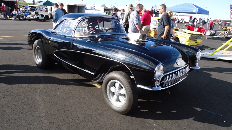

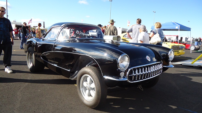

    This 57 is a killer car and runs 10.00's all day long. Quickest I have seen it go was a 9.85. Inspiration for my build.

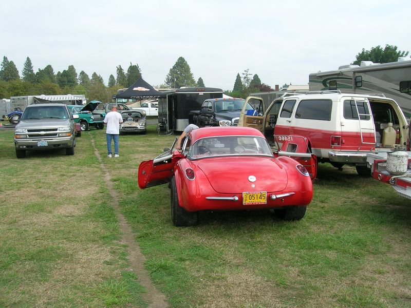

    Some diffrent pictures of my friends car and our last trip to woodburn dragstrip, i think he owned that car for 40 years, runs easy 10s all day long.
