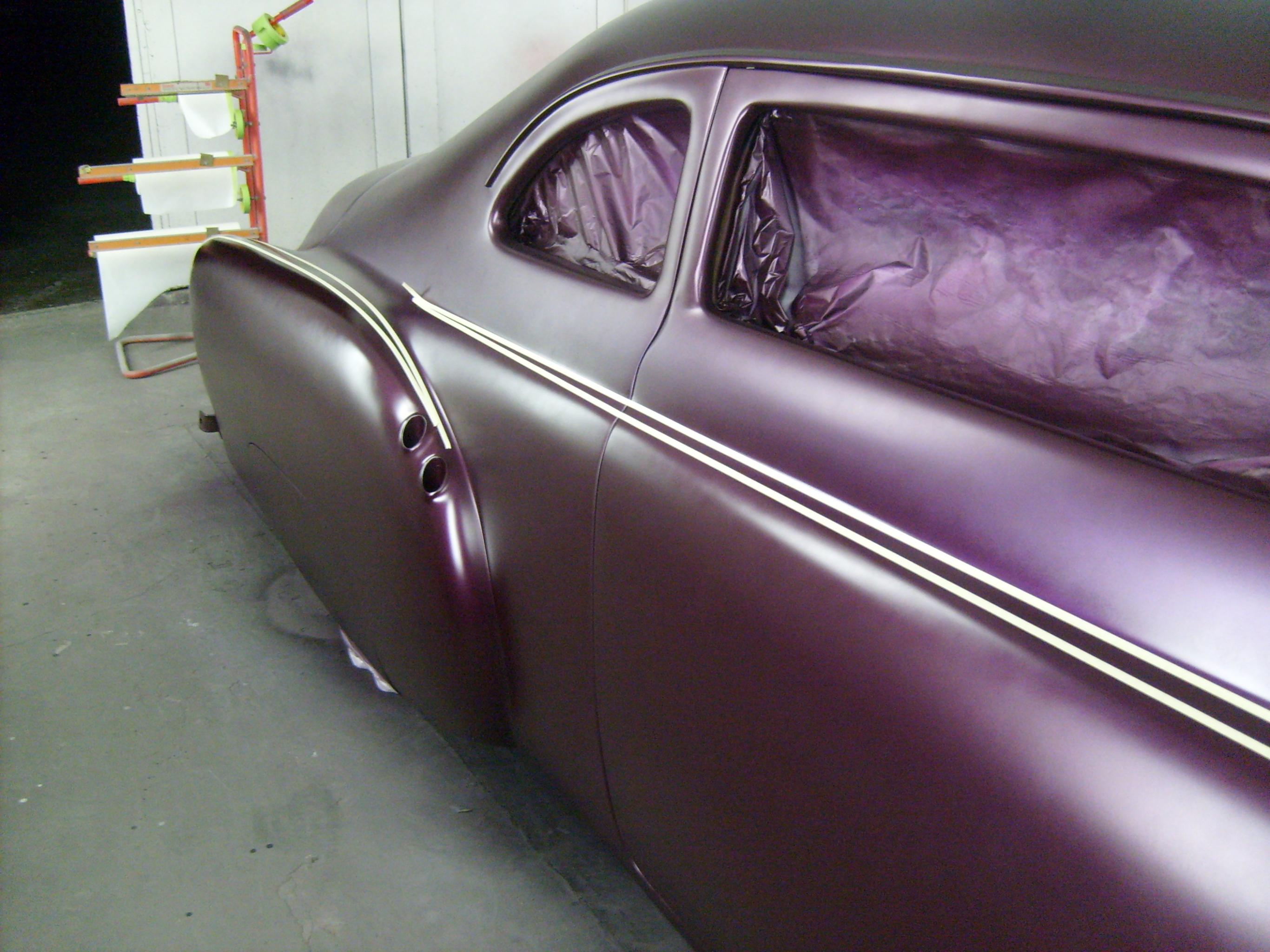

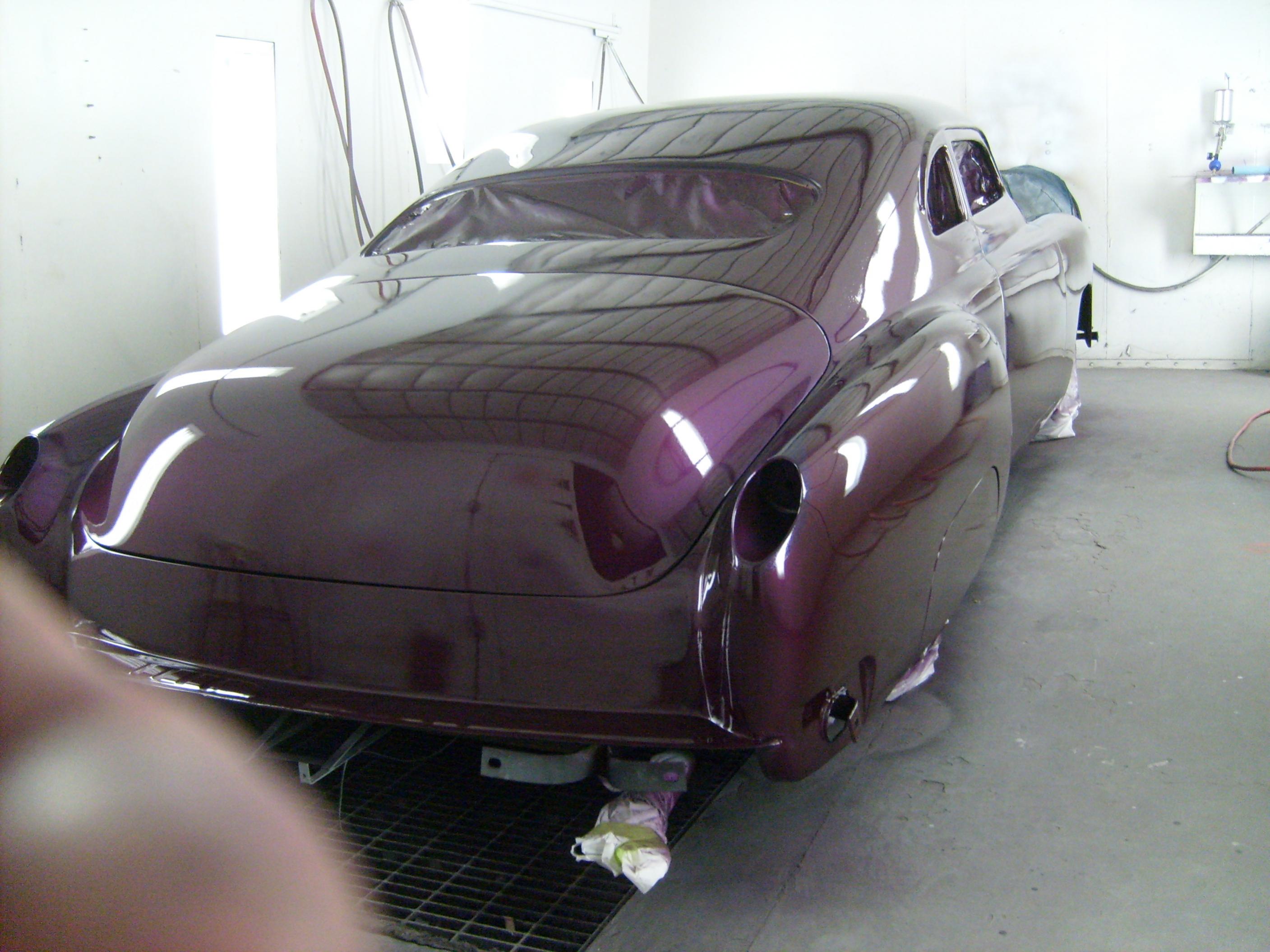

    pic #1 i believe is the gravel pan on the front of car, part of the problem I see I would say is calcium depost's under paint causeing, lil white bubbles, and then to the front of that is a hairline crack that I feel is bondo cracking loose from the feather edge do to metal not being ground with corse enough disk, or possibly metal has oil from skin before application of filler, (ie dirty metal) which includes not blowing off dust before application, these are the type of answers that a pro painter is going to have, and the guy who ownes a hf hvlp gun isnt going to understand. so yes part painter problem do to not getting surface wiped clean with hydro clean which removes calcium depost that wax and grease wont touch, but the solution to fixing the crack is grind it too metal redo, if bondo doesnt feather then you must remove all bondo.

    Posts: 1,297

    OK , I can by that, and if it fails what does it do? It goes to the delamination side of town and comes off in a chunk or a sheet, leaving a spot with no primer, paint and clear. is this what the pic shows? It looks in the pic like there is still adhesion, just a big ol crack, that looks pretty deep more then the few mills of primer and paint........ this pic shows a repair, that happened before it left the shop because there wasn't a check strap and door got opened to far, look at the film thickness of the layers, very thin in my opinion.

    Thank you everyone....here is my opinion and it seems as several others came up with the same opinion, BUT I am a stand up guy and I will make the offer to take care of this problem, Ian can stand right next to me and I will sand the paint down to primer, if the crack remains we will carry on, IF the crack is below paint into filler then we go to metal, and Ian will be responsible for that portion of the repairs, that is more then fair, I will fall back on my supplier for materials, paint labor is on me, anything more is on Ian,I am putting it out there and now everyone knows. The **** talking needs to stop, seems as tho evryone one from coast to coast has heard about my painting skills. we will now get to the bottom of it, but Ian will have to bring the car out just like last time. Its over THE END. here is some pics of how I got the car and of when I was painting it, I am saying it is bondo crack down center of hood , we will find out why when we take it to metal......

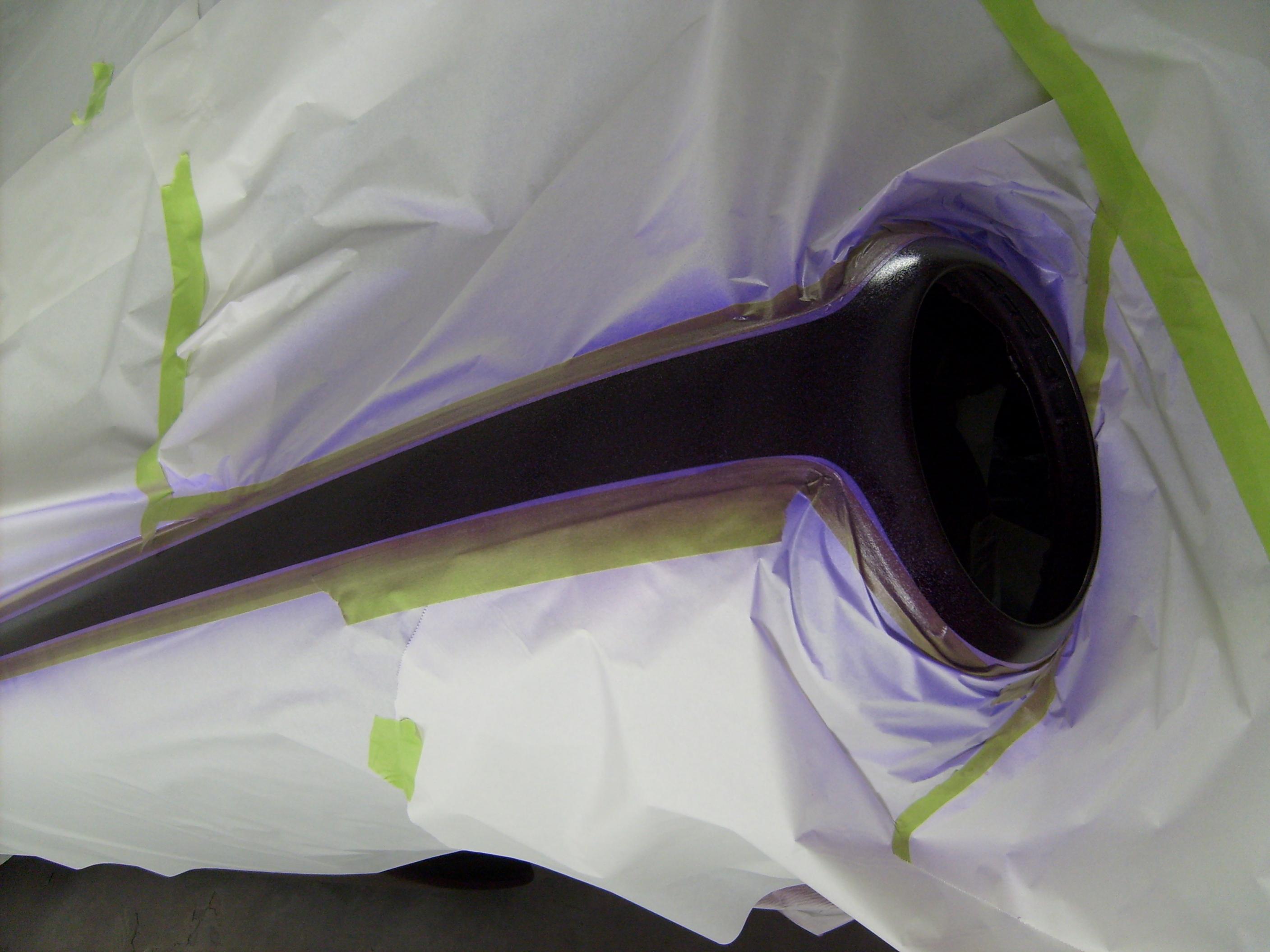

    I did the antennas see how the bondo work is and the color, compaired to the rest of the work. This was a very touchy job, I thought I made it clear I wouldn't be responsible for any bondo cracking, butI am a fair guy and want to put this to rest and stop all the **** talk, I have made my offer........ If I get the chance to repair this car I will post pics of what is found. you can see in this pic when i primed it and sanded all the steps. I looked at my notes today , I did epoxy prime then pcl brand black poly primer, then sikkens sealer , color and clear, you can see in first pic the pcl is starting to cover the epoxy, which is the greenish color product, then when blocking you can see i took it down very thin to where you can see the green breaking thru, then I reprimed areas as needed,

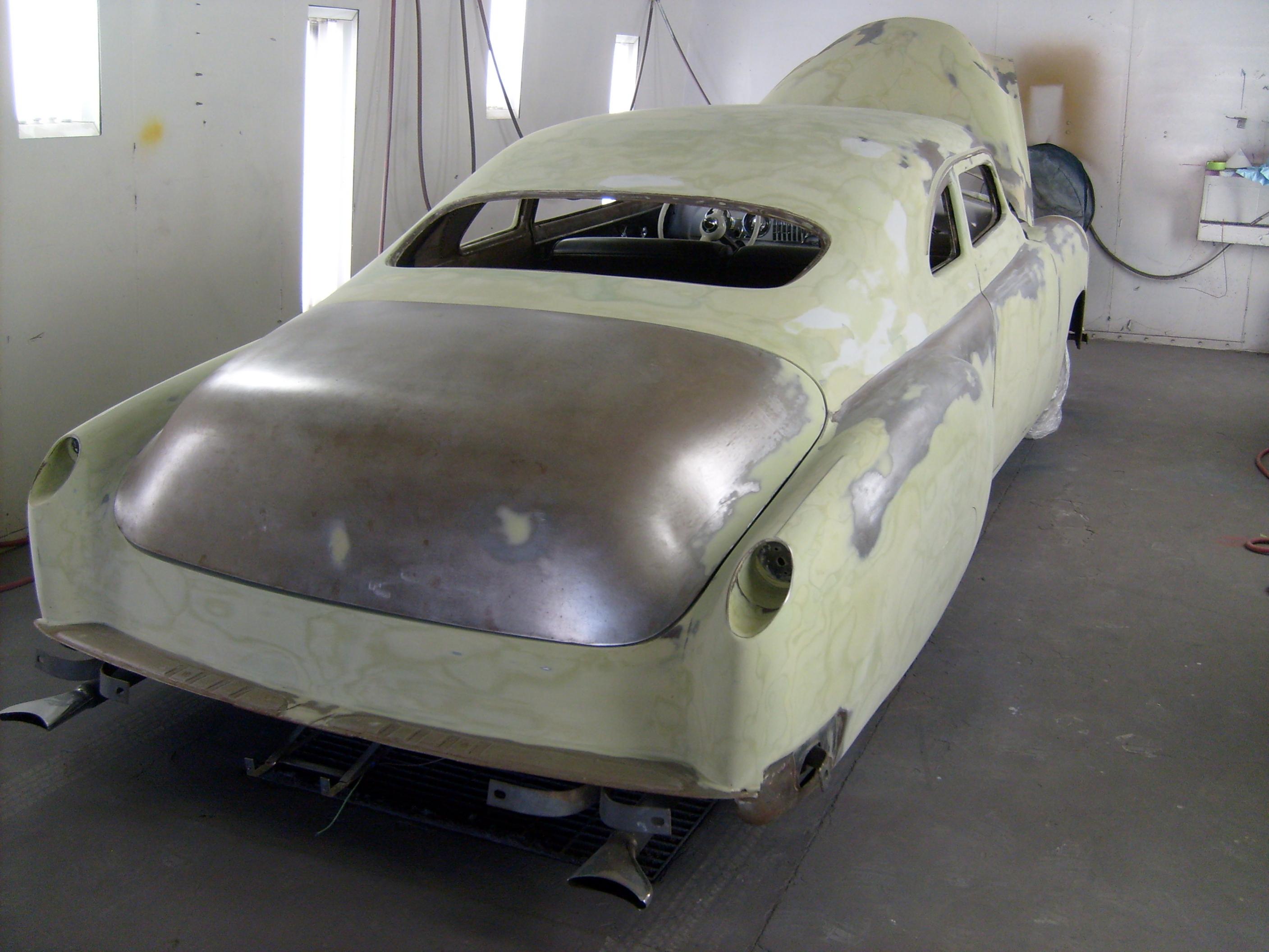

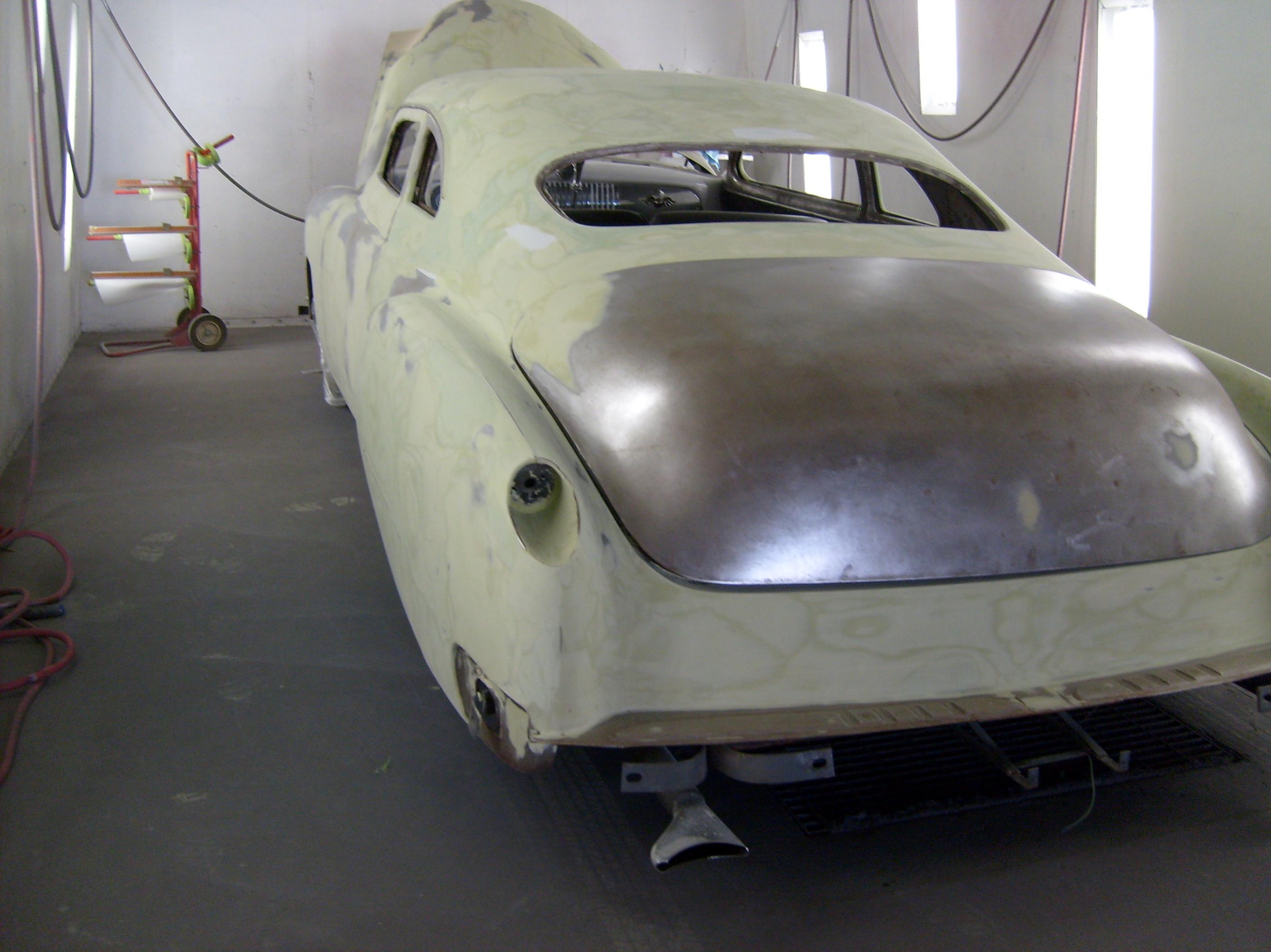

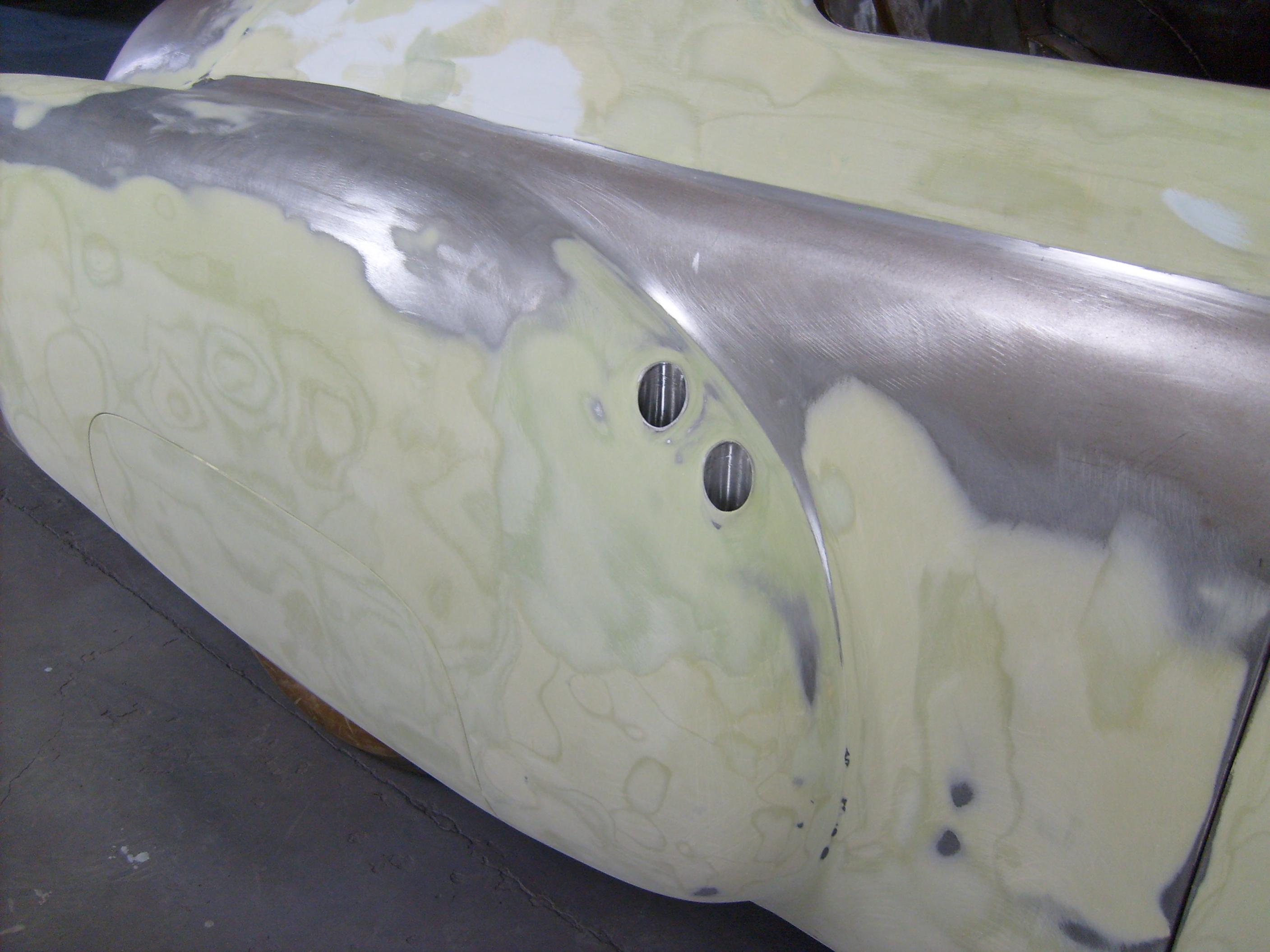

    yes the shot in the booth with all the bare metal and bondo is after I had blocked it all out straight, I did da the surface rust off before it was primed, dont worry. I feel that all the issues are bondo cracking as many have looked at pics and said the same, paint just doesnt crack like that, esspecially down the center of the two piece hood, that is most likely bondo and if it was welded solid it could have been ground too thin making metal flex and bondo doesnt flex as weel and cracks. thats my side of the story, I've mad e the offer It is up to Ian to decide how he wants to handle it. I have learned a valuable lesson, and I think Ian has too, I can learn from my mistakes and admit to making them, the true test is fixing them and making it where nobody can tell, and by that I mean not changing colors and doing a whole different thing like soo many carsa have been done when they have problems.

    and the clear... I was drinking coffee cause it was like 4 am when i was painting this....
