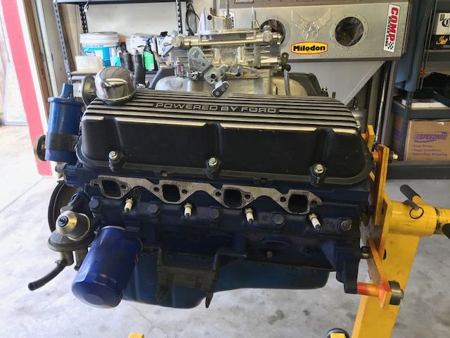

    I picked up a small block Ford motor that I have no idea what it is. There are no numbers or castings on the block anywhere. The water pump bolt holes are close to the deck so I understand it has to be a 289 / 302. I want to sell it and the C4, so I need to know what it is so I can advertise it correctly. The search I did here, didn't help.
    any help appreciated Dan

  10. Xman
    Joined: Nov 17, 2011
    Posts: 596
    Xman
    The block is clean, no grease or dirt and no cast or stamped numbers anywhere. The bolts for the bellhousing are 7/16. I pulled a valve cove and the only markings were cast in GT40P and what appeared to be 3A19. Could it be some kind of factory replacement block. It came in a 68 Mustang fastback I just bought and did not come in the car originally.

  15. Good chance that's a fairly recent factory 'crate' long block. It's a late block as it's lacking the boss for the clutch pivot, and I'll bet it's a roller block to boot although you'll have to pull the intake to confirm that. Also very likely a 50 oz balance, so if it had a C4 hooked to it that's a 'special' flex plate. You've got a mix of parts there; carbureted 5.0 Mustang valve covers, '64-65 timing cover/water pump.
    There should be a part # on the front damper (behind the pulley), that should help narrow it down.

  18. That's probably C5AE, and with a 3-bolt pulley that should rule out it being a 50 oz balance. At this point, it looks like this motor may have been assembled from various parts and isn't a crate motor or even a stock combination. Some rebuilders use whatever's handy, or it may have been an owner who scrounged parts to assemble it. Why there's no casting numbers on the block is a mystery, somebody must have ground them off. I'm starting to think somebody ground them off to conceal just what it is.
    The clutch pivot disappeared off the blocks in '75, so yours is at least that new. The next major change was a one-piece rear seal in '83 (which will be obvious), and finally roller cam blocks appeared across the full line in '86, but you'll have to pull the intake to verify that.
    So just what it is is hard to say; it could be a 289 or 302 if it was a running motor. Was it a running motor? It wouldn't be the first time someone swapped a 50 oz motor into an pre-'80 car (which is when the balance changed) and tried using the existing 28 oz damper/flywheel. It'll vibrate enough to loosen your fillings... That may be why it was out of the car...
    The only way to pin this down is to look at the crankshaft. If it's a 289, you'll find a 1M or 1MA on the front counterweight. The 302 will have 2M or 2MA, same place. Both are 28 oz balance, which matches the damper you have. Don't find either, then it's a '80 or newer 302 with the 50 oz balance and you have the wrong damper and probably the wrong flexplate.
    There are aftermarket bits that will allow installing the 50 oz motor in the earlier cars, just no OEM parts. Ford did make a 50 oz three-bolt damper for marine use, but it needs a bit of machine work for the car pulley to fit.
