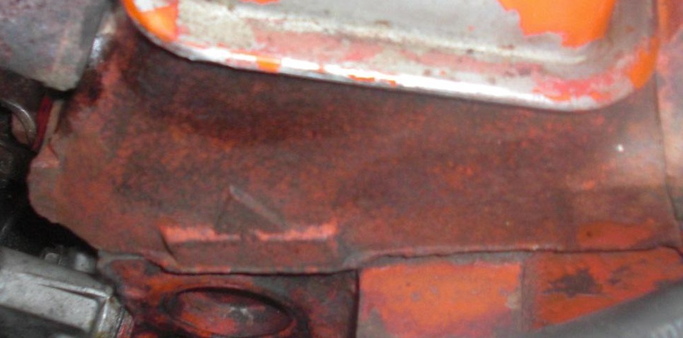

    Could you please tell me these SBC heads are here are the numbers-- 3795896 -- Thanks
    I was told they are Power Pak heads ? ?

  2. brett4christ
    Joined: Jul 8, 2007
    Posts: 5,505
    brett4christ
    62-64 327 60cc heads

  3. egads
    Joined: Aug 23, 2011
    Posts: 1,430
    egads
    58-65 283 , 62-65 327
  4. brett4christ
    Joined: Jul 8, 2007
    Posts: 5,505
    brett4christ
    Correction - See @egads info and add 60cc chambers

  8. squirrel
    Joined: Sep 23, 2004
    Posts: 60,026
    squirrel
    Do they have the little triangle on the end? That's how you tell a Power Pack head.
    If you want to know how old it is, look for the casting date code, which is also under the valve cover, like the casting number.

  10. 1953-55 F-100 guy
    Joined: Jul 15, 2010
    Posts: 528
    1953-55 F-100 guy
    from NE Pa
    Answer squirrel Question-- the heads have that markings on the Front-- # 3795896
  11. Bob Lowry
    Joined: Jan 19, 2020
    Posts: 1,614
    Bob Lowry
    3795896
    283/307/327
    58-72
    1.72/1.50
    60cc

  16. HEATHEN
    Joined: Nov 22, 2005
    Posts: 9,057
    HEATHEN
    from SIDNEY, NY
    Unfortunately, you can't trust most of the lists that you find on the internet. This casting number wasn't used until 1962, and not after 1967. Also, the chambers are close to 64cc. Lots of guys have freaked out when they see that, according to the listing they found, they've got a pair of 1957 283/283 HP F I. heads. Technically, they do...but they're the same heads that were used on all of the 220 HP 4 bbl. engines as well, and aren't worth megabucks. The 997 heads that were used on the 270 HP engines are another story.
