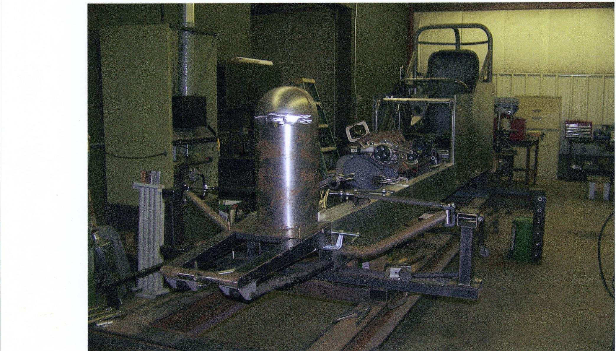

    I received some pictures from as friend this weekend. This picture was in the stack. Can anyone ID this car?

    Here is another picture of the frame.

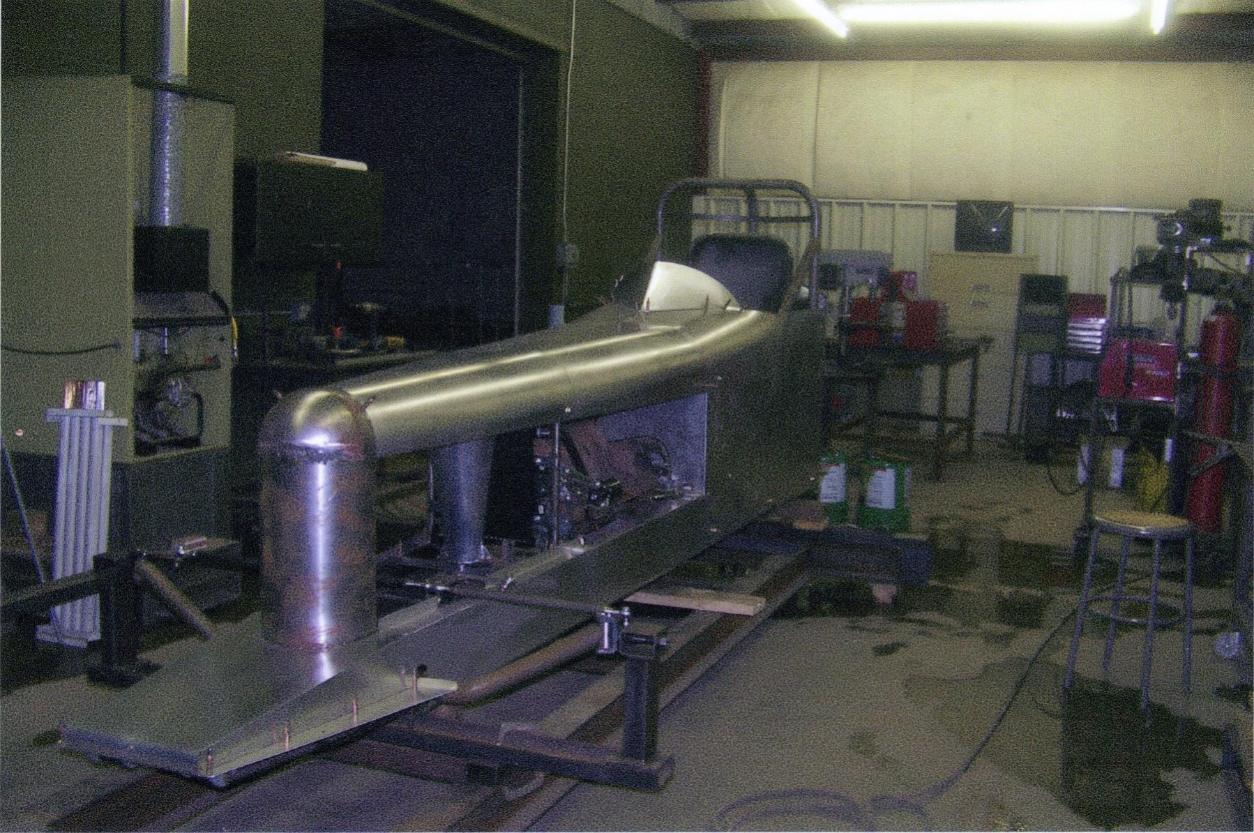

    Those two "senile ole men", that work in a pencil and paper world with a stick that has some funny little marks on it, ask me to post some more of thier work. So here goes.

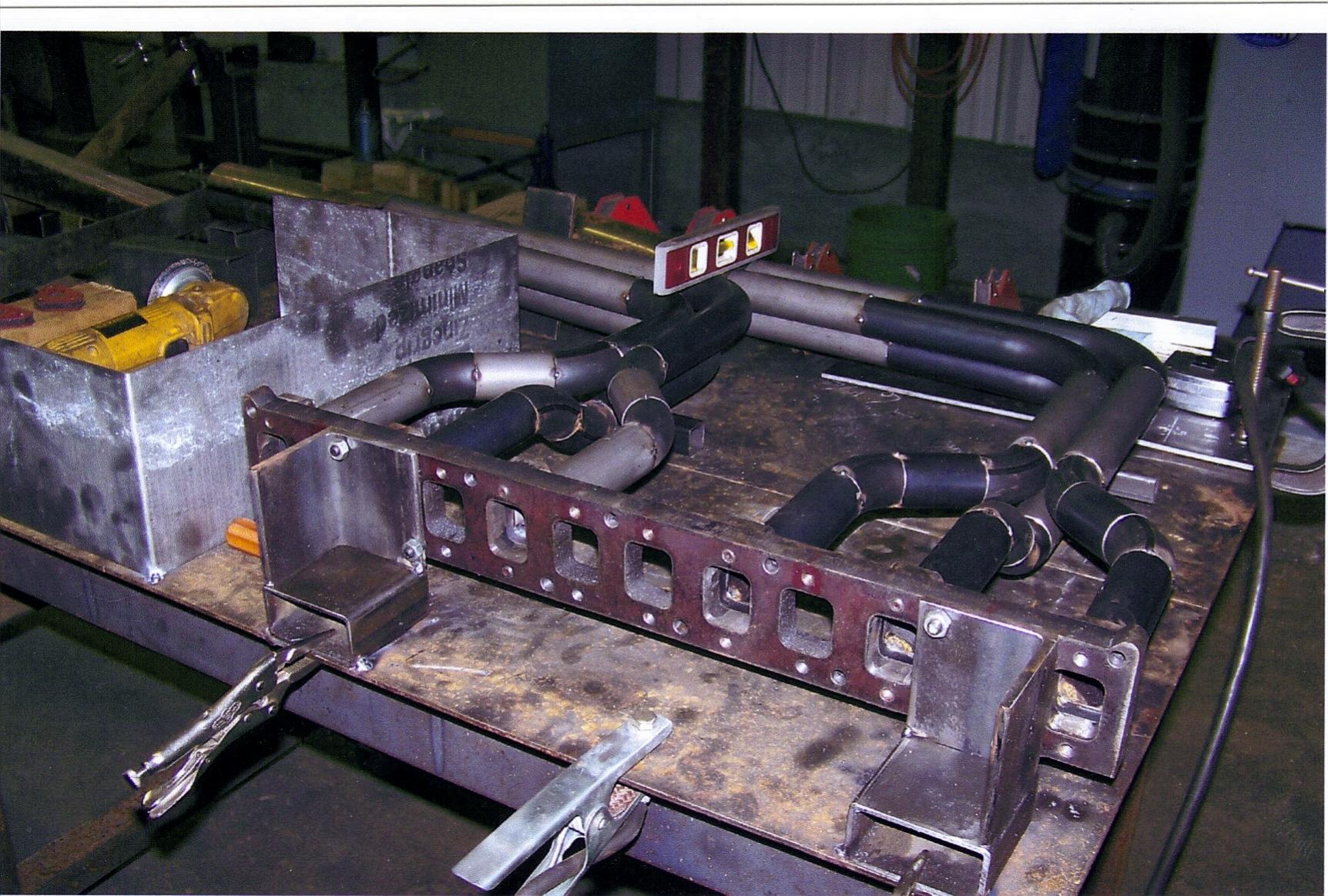

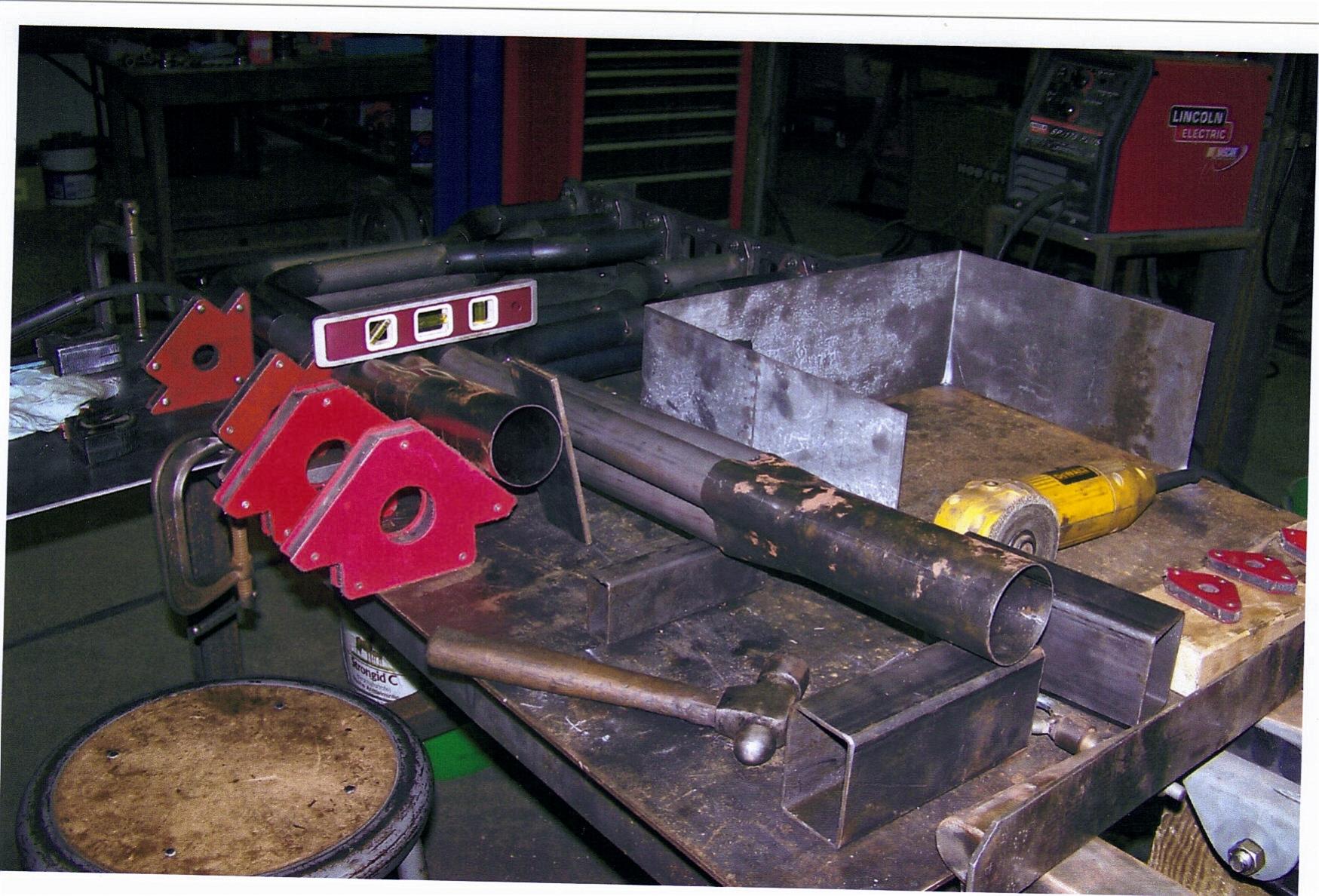

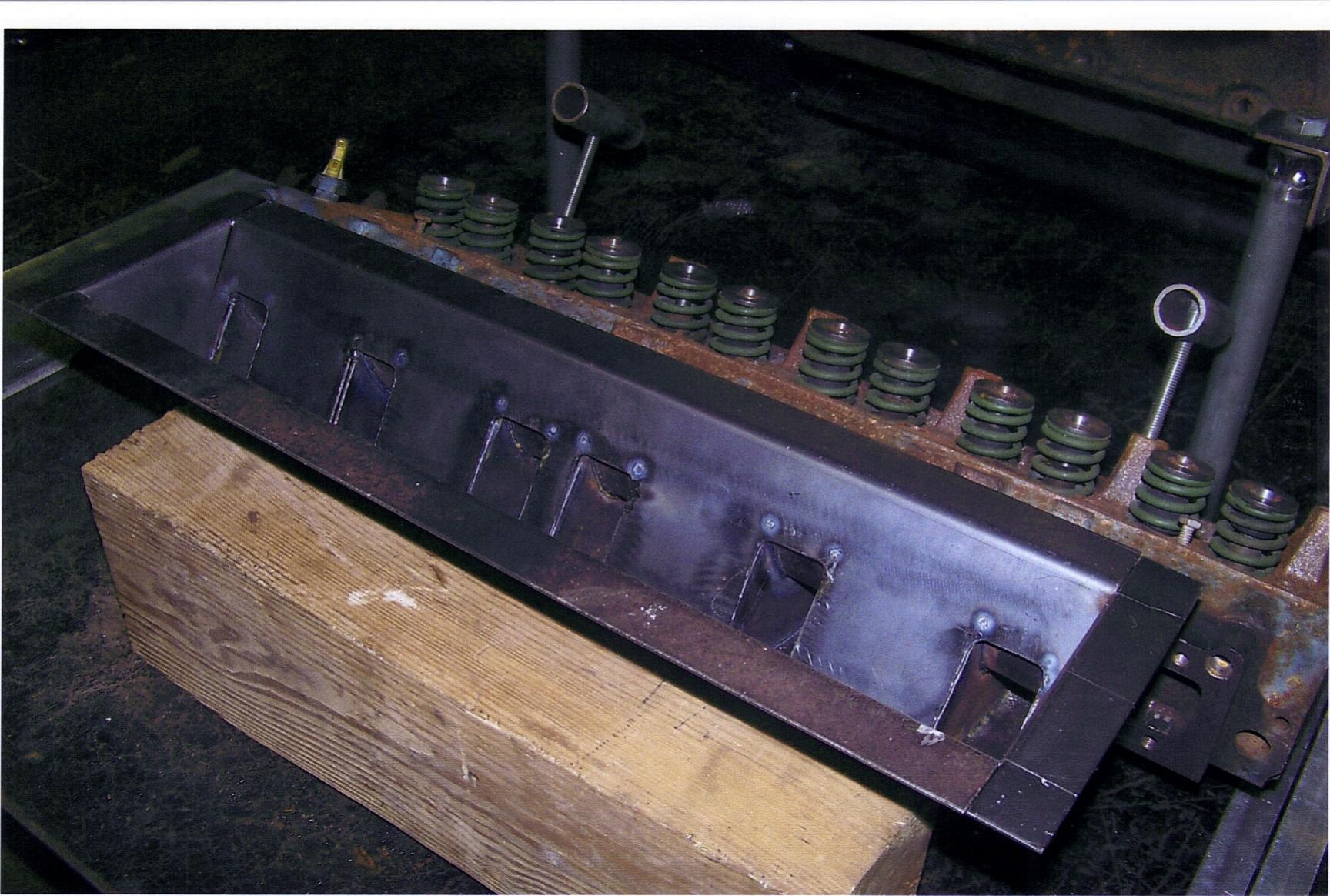

  18. CrkInsp
    Joined: Jul 17, 2006
    Posts: 513
    CrkInsp
    from B.A. OK
    Up date on “Senile ole men”
    I went by to check on them yesterday. They were in a meeting with a “suit”.
    So I walked around the shop looking. A few pic’s of interest;

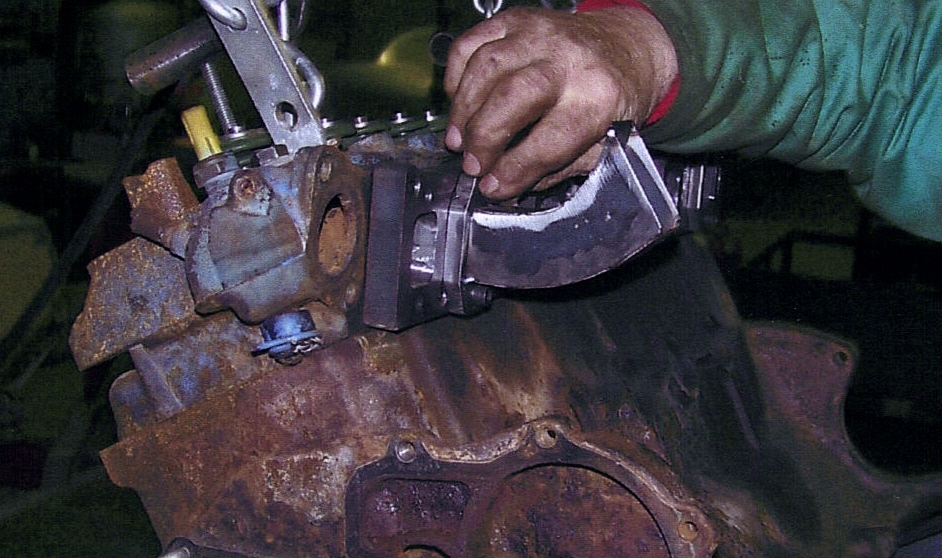

    A fixture for the fabrication of an intake manifold.

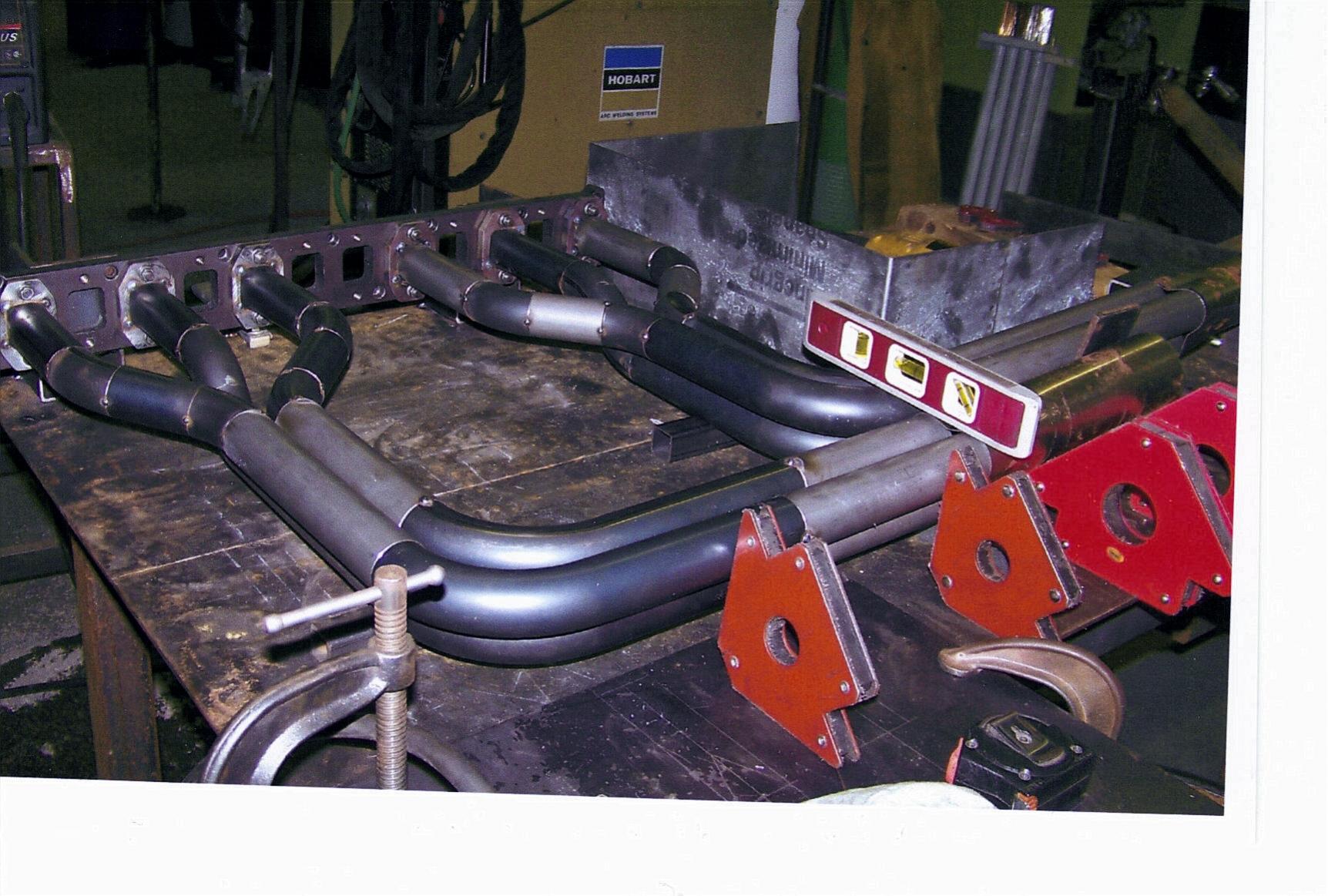

    The next is of a fixture for the fabrication of headers.
    Looks like they could make some sweet music.
    After the meeting, they said, the “suit” was a stock broker. After some bench racing I ask, what was his recommendation for the day? The reply was “buy can goods and ammunitions”.
  19. kwoodyh
    Joined: Apr 11, 2006
    Posts: 641
    kwoodyh
    That is a thing of beauty! Love that sheetmetal intake!

  22. And vision....
    I've been dreaming of doing something similar, look forward to see how long they make the intake runners, I'm going to guess about 18" to the plenum? please tell me my that someone else is thinking along the same lines as I am....;):D
    regarding the headers, was that 1 3/4" x about 44" long? I was aiming at 38" using 1 5/8"....
    Good torque from 3500-5500, right where we need it
    Look forward to seeing more, not long till Mokan now...
    Cheers,
    Drewfus
  23. mudflap261
    Joined: Oct 24, 2005
    Posts: 588
    mudflap261
    from tulsa
    Inch and half 36 long
  24. Ron Golden

  25. CrkInsp
    Posts: 513
    CrkInsp
    from B.A. OK
    It looks like "Senile ole men" went with a design that uses the 4th harmonic as the basis for thier intake manifold. Or they wanted to keep it under the hood. ???? They don't talk much about some of thier design ideas. Like the long up travel front suspenion, etc. Maybe I shouldn't have said that.

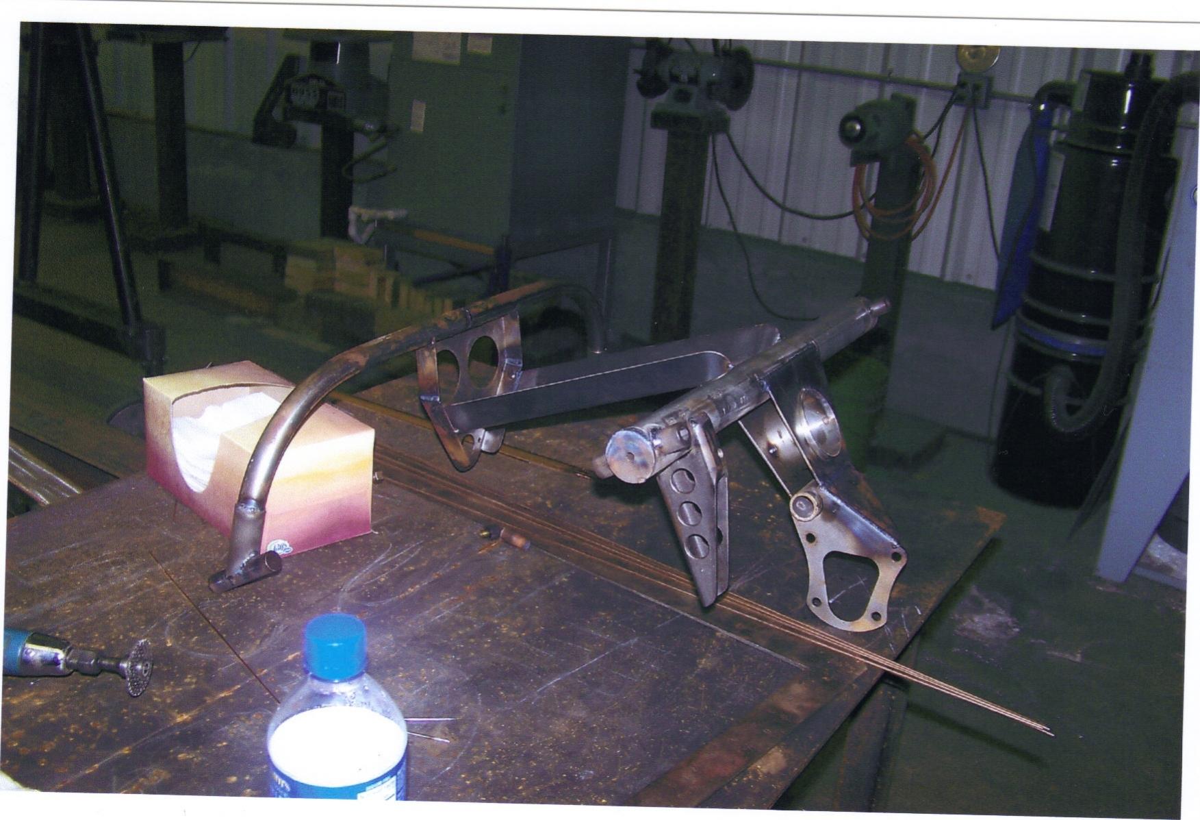

    I went by to check on "Senile Ole Men" yesterday as it's been hot here.
    Larry was shuffling around putting the disco lights on the "Pit Cruiser".
    Jack was mumbling something about foggers for his injectors under the hood while he was welding. Couldn't really tell what he was talking about. I think the heat or the fumes are getting to him. Anyway they both are still working away toward completion of the car.

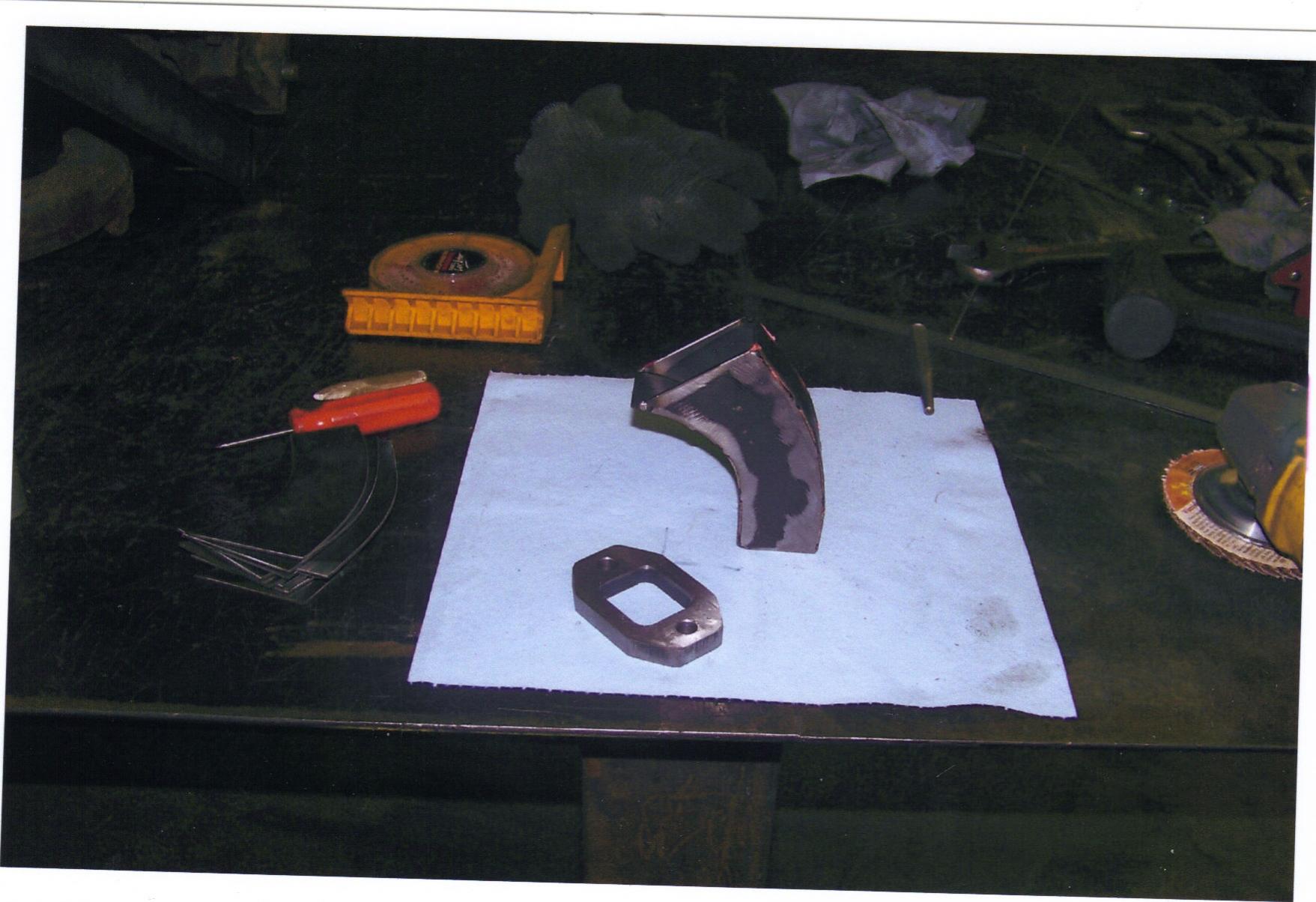

    Saw this setting on the bench. Must be a speed secret.
  28. 348chevy
    Joined: Apr 2, 2007
    Posts: 431
    348chevy
    Those look like Hilborn carbs to me. With the short runs on the intake I would say they are planning 8000 rpm shift points. This could spell trouble for the rest of us.:D Roy
  29. very short....more photos please, thats such a tease...;):D
    Cheers,
    Drewfus:)

    those hilborn carbs are very very rare this is only set known to exist
