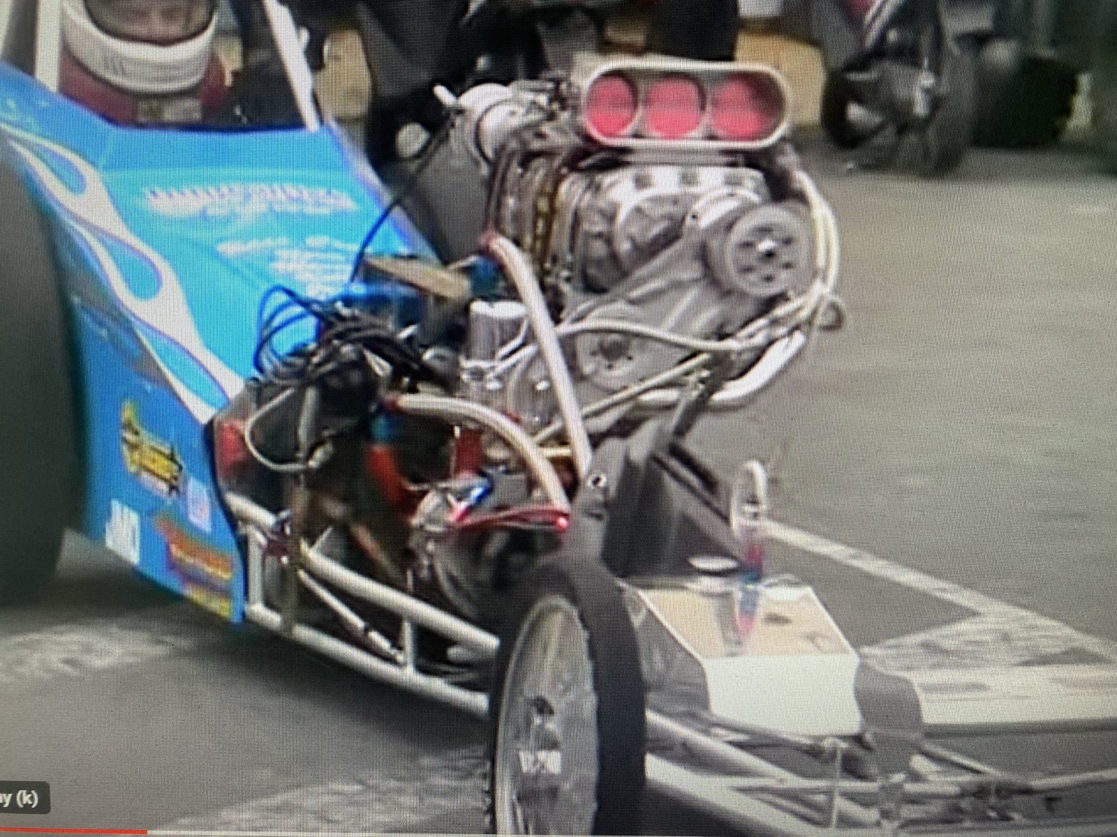

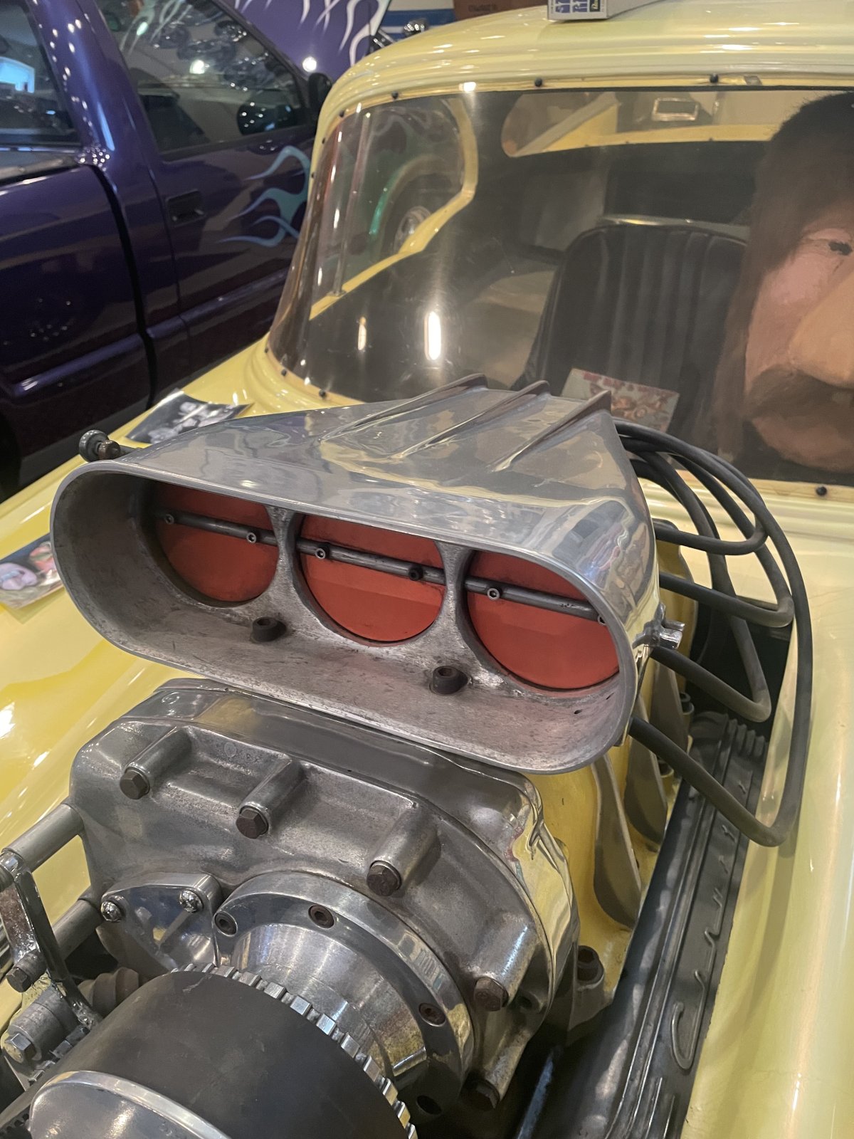

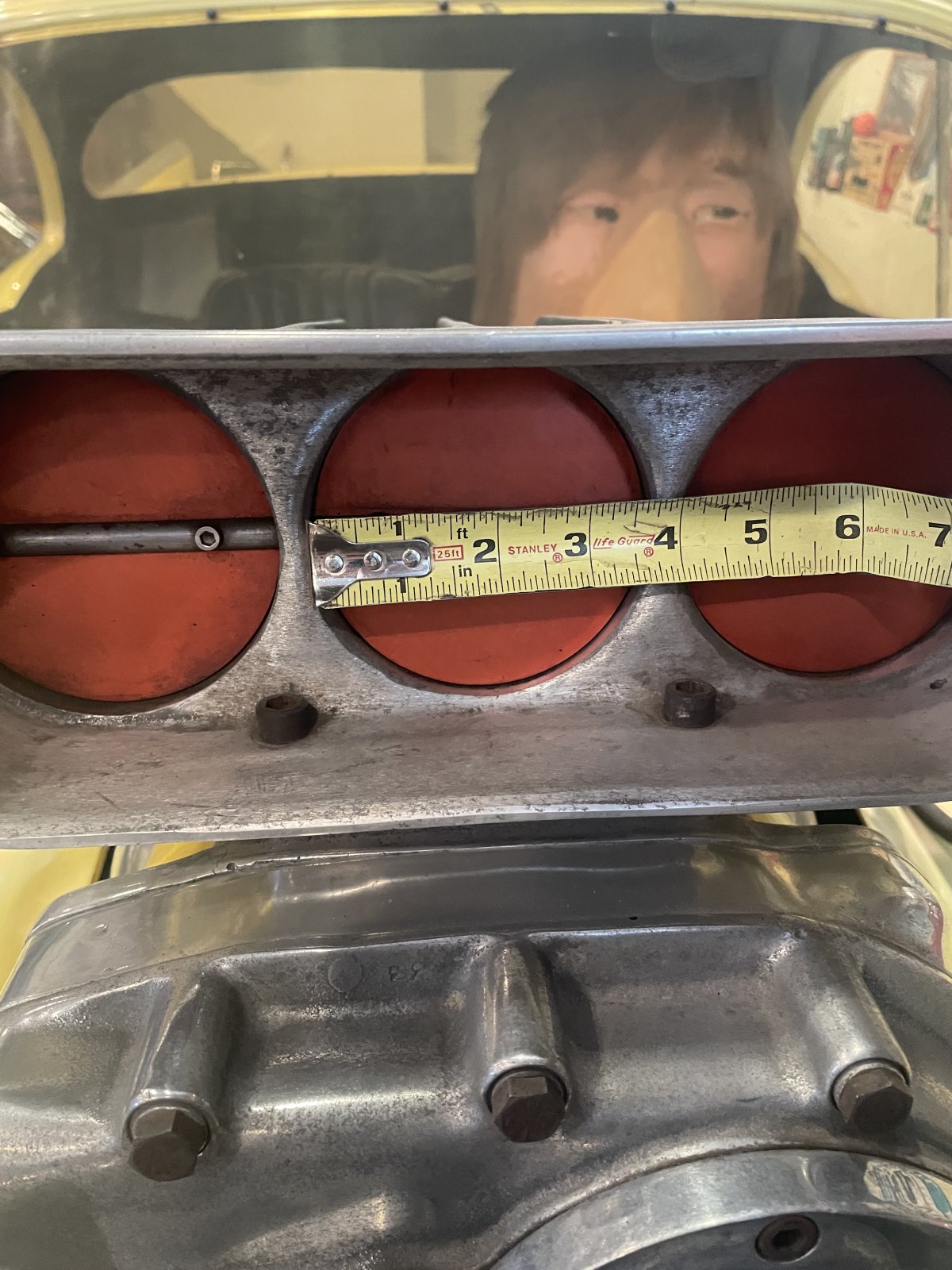

    I have been looking for a small injector hat for my blown sixes. I have considered attempting to convert my Cal Custom scoop to a functioning unit. So while looking through a group of pics of set ups lstnight I found this one on a 202 ci on inter web.
    I would have said it was an Enderlee like the one I just sold but it’s tiny in comparison. Anybody got an idea ? It’s way smaller than the smallest hats I’ve seen Hilborn /Enderlee are otherwise. I would really love to convert my sixes and ditch the carbs.

    First post pic ,Looks to be Enderle bug with ribs , more likely so!!
    Late 60s to present , or you can get with out ribs

    I agree with @19Eddy30 , that looks like an early Enderle bug catcher. The very early ones had the three fins and a raised rib around the front, first that rib went away and later the fins. The photos are grainy but it appears the front two bolts that hold the hat to the blower are there, also indicative of the Enderle bug, with the earliest ones nicknamed the shower head because of the fuel nozzles on the drivers side of the hat. Later Enderle's, the bird and lastly the buzzard had larger throttle plates set forward with the two front bolts being inside the hat.

    Yep, early bug, I bought this one around 1975 from a local river rat, it had never been machined, was just the casting.

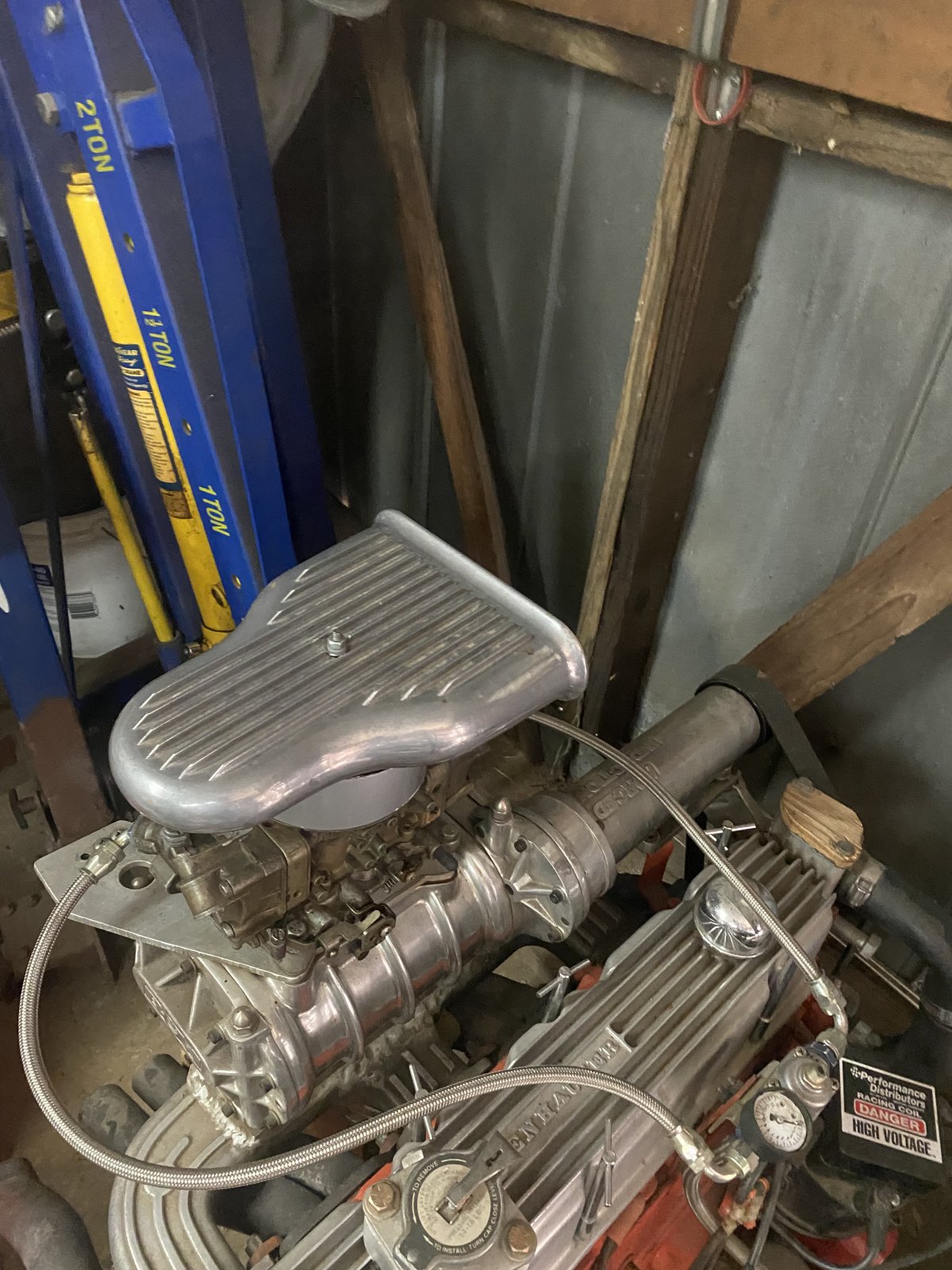

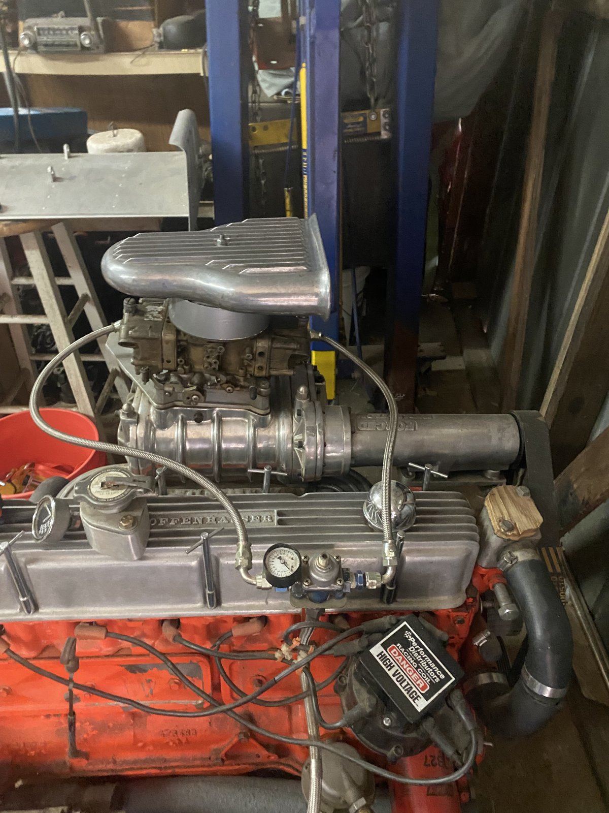

    This is my Cal Custom scoop. It’s perfect proportionally for the blowers I run and the ci I run. The big hilborn and enderle that I had are just to big. In every way. I am only running 255 inches. And the updated version under construction will be 260 max. IMG_2072.jpeg IMG_2073.jpeg IMG_2074.jpeg
  7. Mitchell Rish
    Joined: Jun 10, 2007
    Posts: 2,346
    Mitchell Rish
    from Houston MS
    I would love to convert this one to be functional. I have talked to 402Bossman here and it would be pretty difficult considering how thin that casting is. .

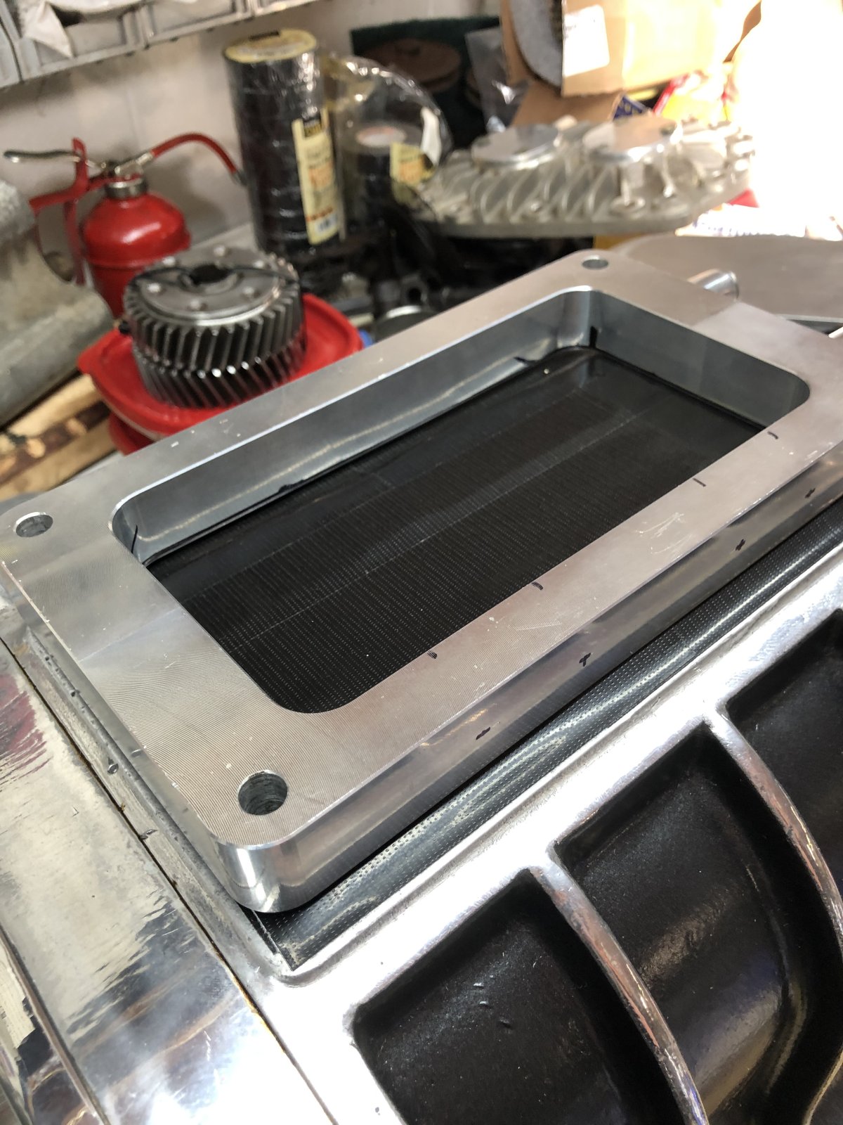

  9. Kind of in the process,,,,I started several years ago but came down with a life threatening illness and have never gotten back to it .
    I will start back on it sometime .
    Here are a few pics ,,,not much really,,,,pre stage I guess,,,still in the conjuring stage,,,lol .
    I was going to call it Cyclops,,,or Gort (from the day the earth stood still ),,,,lol .
    Tommy

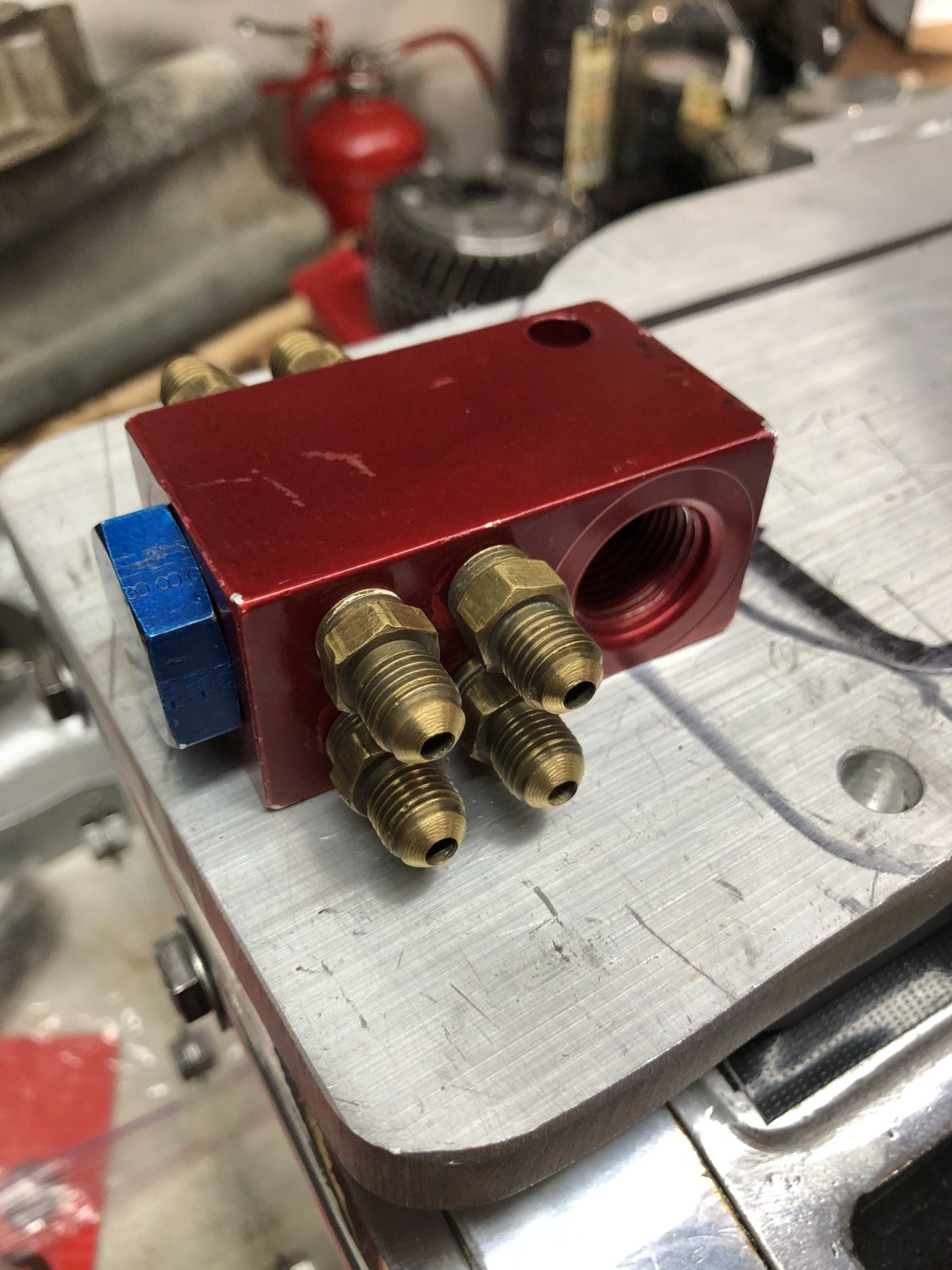

    Just Enderle Bug with or with out Rib
    & block Val for Gas , Alky , or Nitro ,
    (K)

    Thanks for that info 19Eddy30. That’s on a 202 CI Holden. That’s still impressive /or boarder line insane to me. That’s a tremendous amount of air flow for a 202.

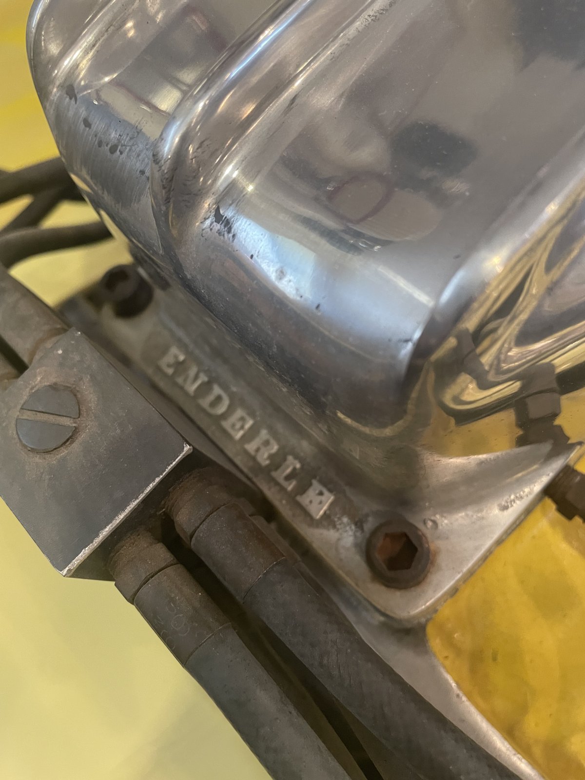

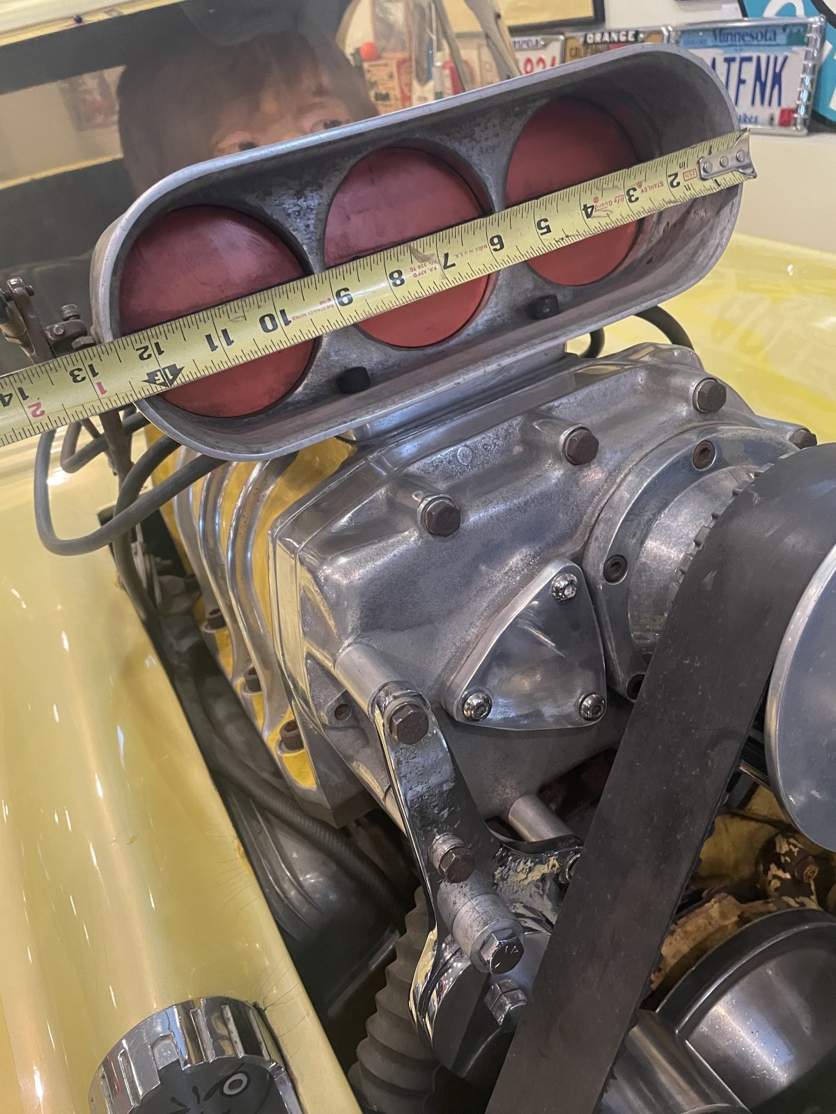

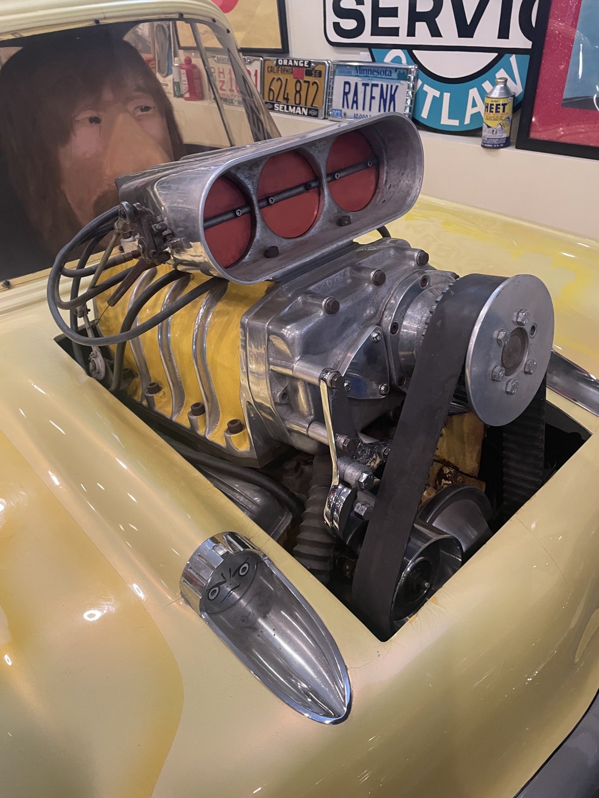

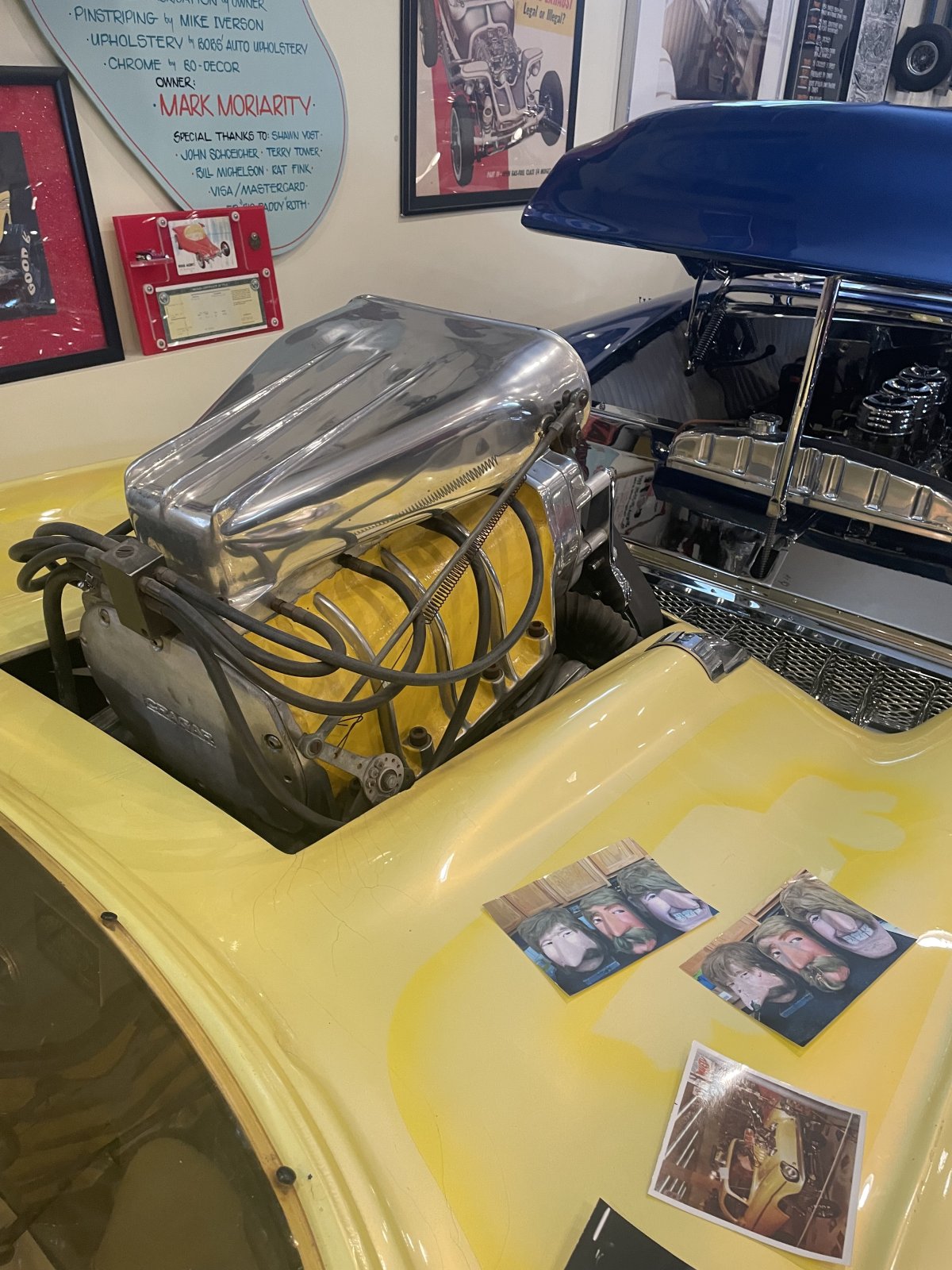

    I think those Enderle injectors are all the same size aren’t they? Here’s the one on the Deals wheels 57 IMG_9088.jpeg IMG_9087.jpeg IMG_9086.jpeg IMG_9085.jpeg IMG_9084.jpeg IMG_9083.jpeg
  18. Good looking piece Mark !
    That’s an early Bug,,,,,going by the tape measure .
    Tommy

  20. That looks almost just like what he had some pics of,,,might be the right one for him ?
    Tommy
  21. Oops,, sorry,,,,I just went back and looked and he had a scoop to convert in the pics ,,,post #6 .
    Not an actual hat in those pics.

    post #6 looks to be a Hillborn with mods to set on a Carb ...Time was spent on ****erfly's.....May be some one did
    One off modifying the Original cast....
    ( working at Hillborn)
    Also there are/ where many cast there own parts to fit there needs ,,,
    I do not know about a Shower Head Bug ,,, all None Shower Head Bugs are same Size to present ,,, You all do know Enderle brought back the Nostalgia Ribbed Bug ,
    With work/machining & thought the Cal Custom scoop can be made into MFI, It would not be hard ,, also depends on type/ style ****erfly's,
    If not doing the work I would say
    $1500 plus

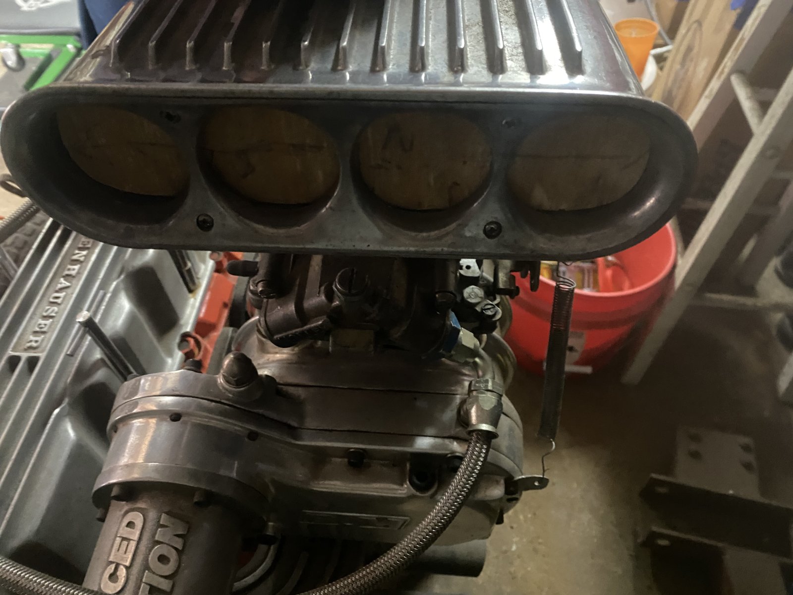

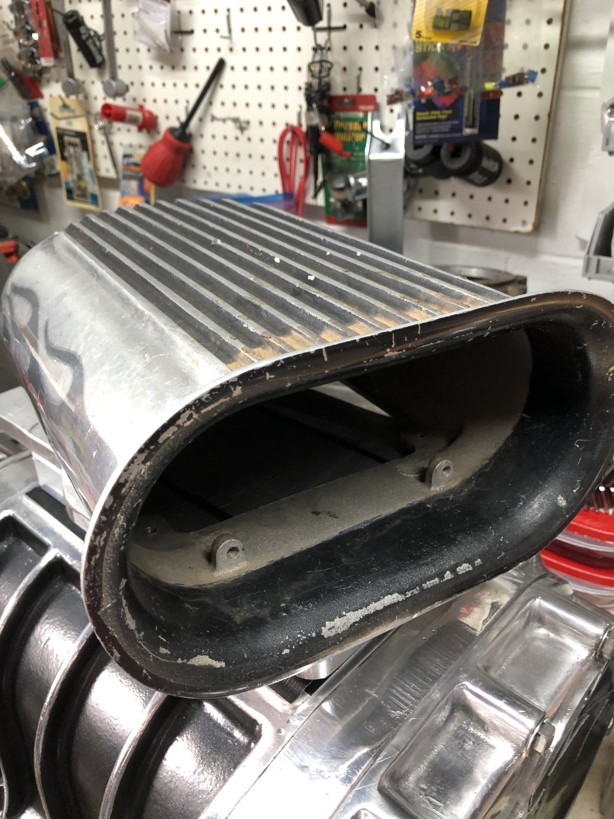

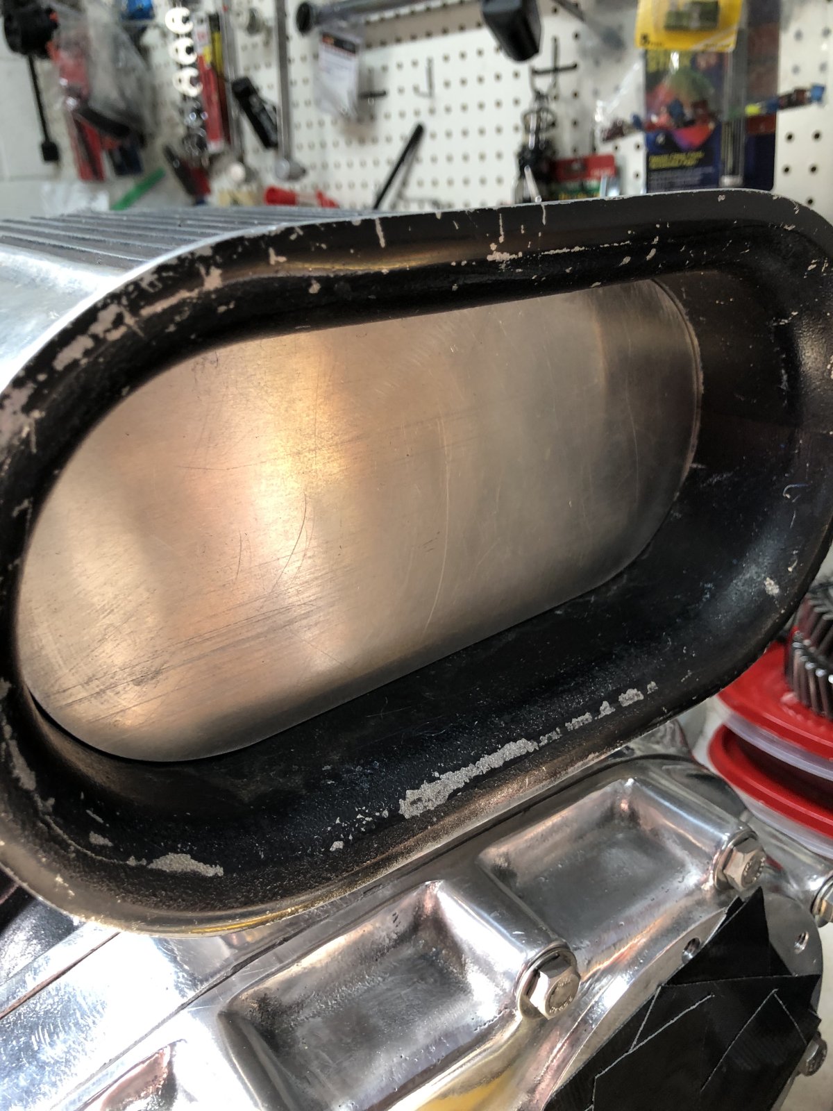

    IMG_2072.jpeg IMG_2073.jpeg IMG_2074.jpeg Moriarity I had two of the hilborns. One Enderle. I am very familiar /running and set up on both the stack and hats. Everything we have other than the 57 is hilborn stack at this time.
    But none the less you’re not gonna hurt my feelings /with anything said/or suggestions /etc. Pretty much why I reached out. As suggested. Kinda hopping someone is sitting on a little one. Don’t care who made it. Just needs to be small. I would have traded my entire big Enderlee ( bird catcher) for one.
    I just don’t think any of my sixes /blown or other wise can use a big hat. I’d love to be able to convert my cal scoop. It just looks right /as compared to blower and the engine.
    402 Bossman has kinda guided me what it takes to convert it. Can I do it - Probobly. I’ve done a lot of one off but a blower hat is not the place to guess at.keeping the throttle shaft /****erfly’s in spec is not easy. Have had a throttle stick before and yes it was my fault.
    Keep the thoughts and ideas coming. Again I will take all the help I can get.

    19Eddy30. I just read your post. If that’s all id do that tomorrow if you know of someone that could convert to ****erfly /shafts etc.
    The machining of the throttle body/****erfly’s is what I question my machining capabilities on. All of my machines are way more capable than the owner operator. I do dearly love my little cal custom scoop. The throttle openings ( holes are 1.92). And there is an inch plus of room that if it could be fabricated it could be inserted sealed etc and the front face plate bolted back on.
    It will come out with 4 screws. I can tig the bottom body on and machine to fit the smaller blowers. Am using 144/and 177 style.
