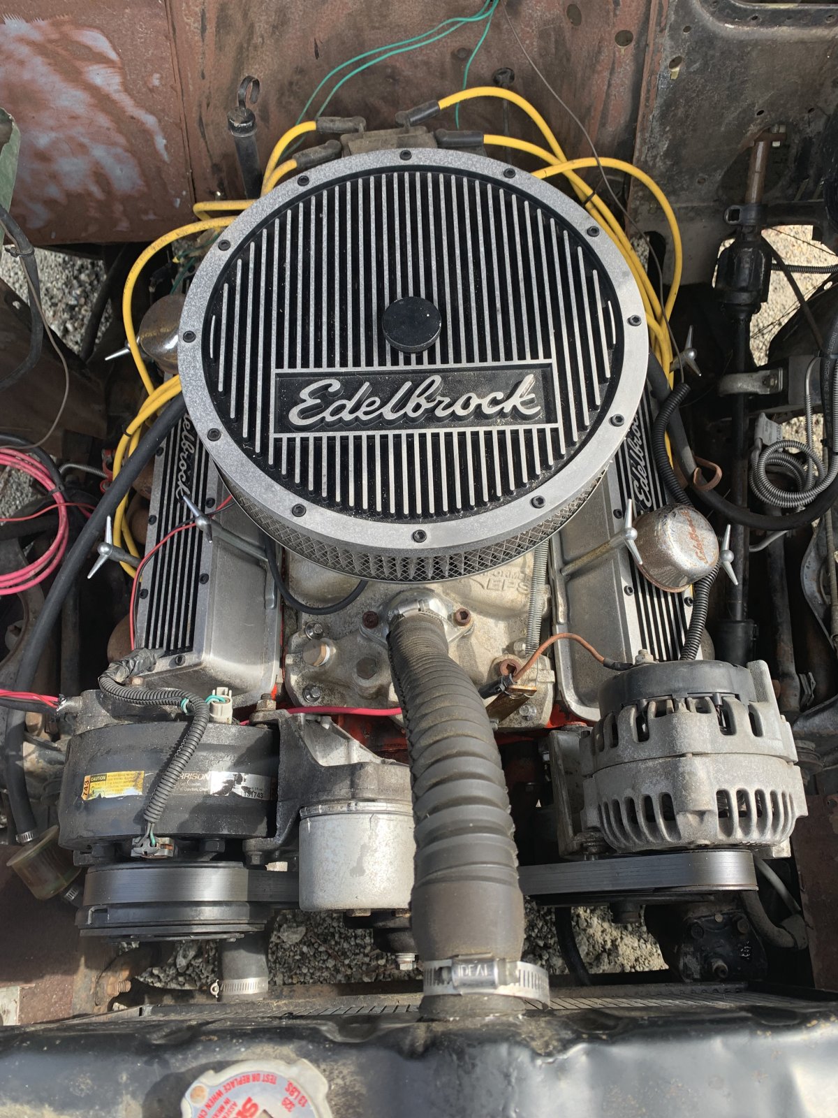

    Trying to ID what car my engine came out of that is in my 50 Chevy Styleline. Block casting# 3970010 and the only other numbers I have found on the front are 161101073 K08. Thanks for Help!

    Thanks for the info guys. We are just confused why the 161101073 K08 number on the front of the block doesn’t pull up anything.

    Posting pictures of this ^^^ might help us narrow it down.
    Edit; The belt drive, AC Compressor, etc looks late 80's to early 90's

    Thank you for helping me with this. This is my first project car. I purchased it from a lady whose father passed that was working on it. She has no info on the motor, rear end or the front clip. We were hoping if we figure out the motor might point us in the right direction of the front clip. Will try to get the numbers under valve cover posted in a couple of days. Thanks again.

    The numbers sound strange, a picture of them will tell us if they're the original stamping or something else (it's pretty common to find the block was decked, and stamped with an invoice number by a machine shop, for example).
    But it's pretty doubtful that you'll get any useful info, even if you can ID the block's origin. Lots of pictures of the parts you want to know about, will help folks help you figure it out.
