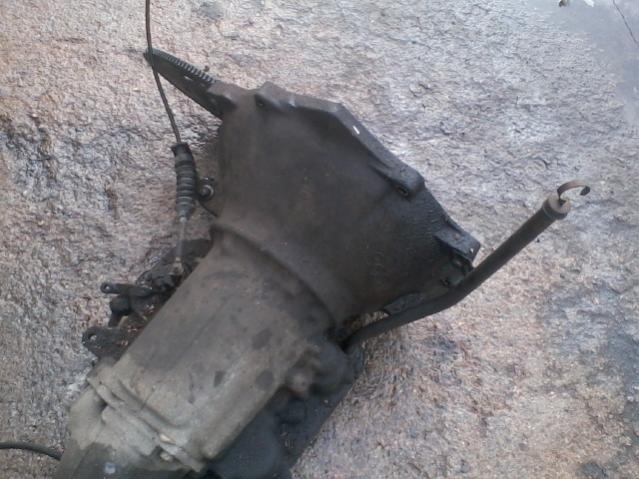

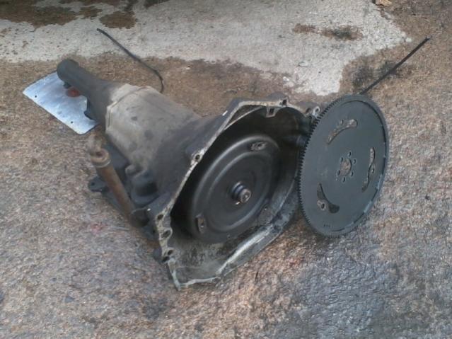

    A friend picked up this factory 1 piece transmission the other day and wondered what it came from? Chevy bell housing with Chrysler torqueflight. Any help would be appreciated. What else is required, special convertor, flex plate crank extension? He also picked a modified torqueflight with C4 Ford bell housing machined to bolt to modified Chrysler case, a 2 piece unit. GM904b.jpg GM904a.jpg

    cool beans, I never saw one of them before! I'm guessing it came in a Jeep behind a 4 cylinder, but that's just a wild guess. If you can find a part number stamped on the flexplate, or find some casting dates or numbers on the case, that would help identify it. Often you can tell what company a part was made by, by the way the part number looks.

    After-market converter companies; Pro Torque, Transmission Specialties, PTC, etc, should be able to make a half GM, half Mopar converter. They will just need you to take some measurements, flex plate will be the one appropriate to the engine. I'd use a TH 350 and keep the GM Torqueflite as a conversation piece.

    Yes, Jeep. But have him check that 2 piece Ford/Chrysler unit- it may be a Clutched automatic. The Clutch Hydro (TH400 with a clutch) and the Clutch Flite (727 with a clutch) are the most common clutched autos, but the fords are out there. They are cool!-rick

    Great, thanks. I'll get the numbers next time I'm over there. I copied photos from net as I'm laid up with damaged arm and can't download photos from new phone. 2WD jeep, who would of thought that. Had no idea. He'll rebuild it. What a novelty, a Chevy TF727! Did some further research and found from www.jeeptech.com the 151 (2.5L) inline 4 engine was used in '80-'83 CJs including the CJ-8, CJ-7, and CJ-5. The 151 is often called the "Iron Duke", but is actually a Pontiac engine designed to replace the Chevy "Iron Duke" I4 engine.

    It's a 904, not a 727. Same thing but lighter duty.

    Those transmissions are very hard to find now but can be built up to handle a pretty healthy motor. Convertor is no big deal either... it is an AMC convertor for a TF-6, they used a regular flex plate like shown and no ring gear on the convertor.

    These transmissions were found in the 2wd US Postal Service jeeps more commonly than in the "civilian" jeeps.
