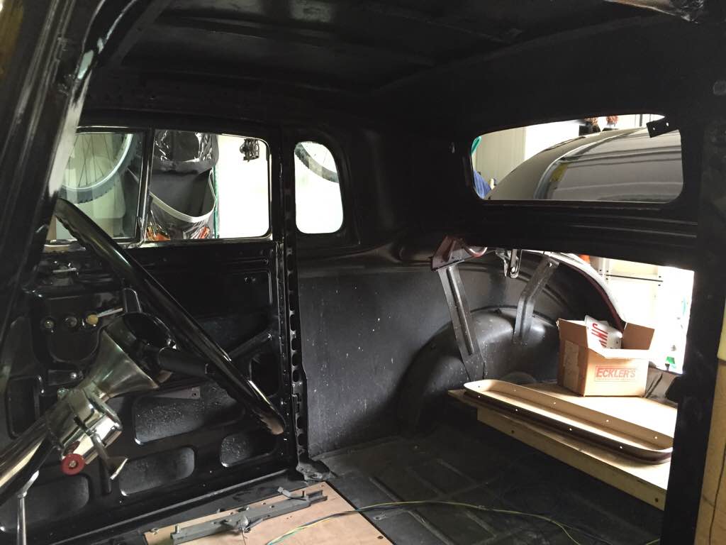

    I made more progress today. I finished the wood framing in the interior and laid down some heat insulation material.

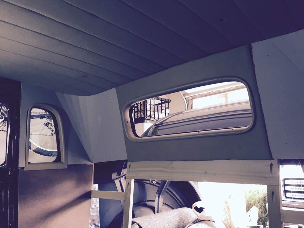

    Most of the panels are cut. Need to order the tweed that matches the seats to cover door panels and lower panels. Got the transition in the upper rear panel to work nicely with aluminum. Still scratching my head on how to do the headliner.

    Thanks for posting that. The details in the photos on that site really help. I may redo the upper rear quarter panels now that I see how they did it.
    I did the wood from scratch. I had seen a couple of pictures of wood kits and had a basic idea of how it would install. I started at the rear quarters and framed my way to the rear center. I used poplar and a pocket jig to do all the joining. It's in there pretty solid.

    I did notice the pocket jig, did you also wood glue it? I use the pocket jig on a lot wood projects, but glue it as a backup.

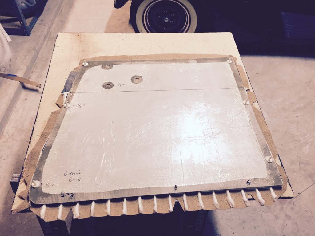

    More trim panels are going in. Decided to use chip board to make these panels since it was easier to trim and they mount nicely to the underlying panel board with clips. Using Weldwood contact cement brushed on from a can to attach the material. Just a couple of small gaps to nitpick over but still really pleased with the results. ImageUploadedByH.A.M.B.1419205021.609923.jpg ImageUploadedByH.A.M.B.1419205039.434367.jpg
