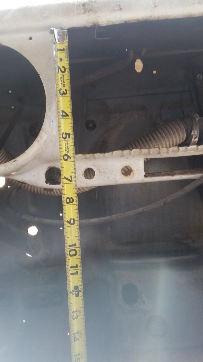

    I have a 54 Chevy truck that a previous owner hacked the entire radio area out of. After looking at the small detail of the stamped ribbing I have come to the conclusion that even if I had a new dash piece, welding it in and smoothing it out would be impossible at my skill level and time available. I also have researched and found that I don't want to try and locate a useable dash and replace the entire dash. Not an easy endeavor from what I have read about the AD trucks. So that leaves me with the only option of finding something to fill the gigantic hole where the speaker grill/ribbing once was. It is about 6 inches high and 10 1/4 inches wide and has the curved contour of the rest of the dash panel. I have seen many of these trucks with dashed hacked up, anyone have any ideas that would fill the gap and somewhat traditional in the Hot Rod sense? Here are some quick phone pics:

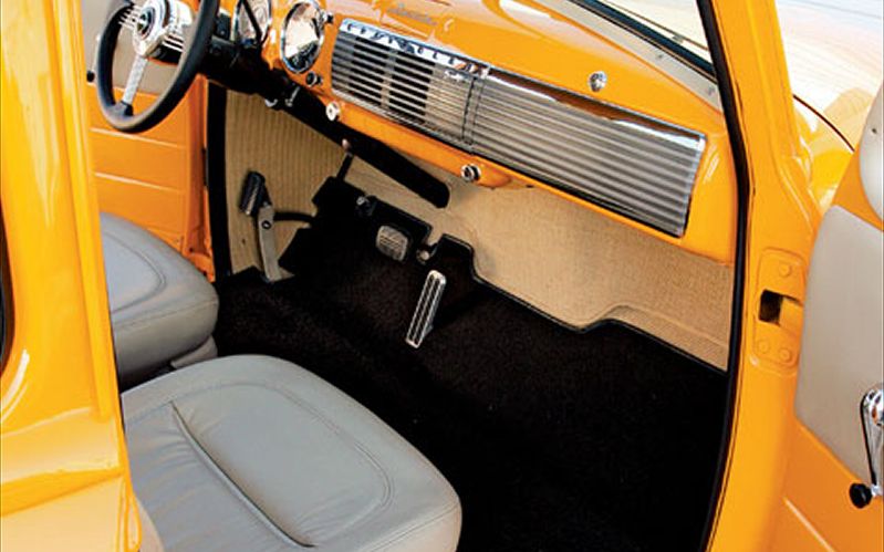

    some ideas for trim. images-1.jpeg images.jpeg 0903cct_05_z+1950_chevy_truck_cal_custom_valve_covers+dashboard_view.jpg

    I have fitted a piece to do this but it just doesnt look right.

    This is a 54, so alot of the parts reproduced stop at the 53 model. I have not found a reproduced grill section of the dash or even the whole dash for this year (54-55.1).

    I looked at some 54 truck dash pics, do some not have a seperate chrome cover that goes over them kind of like the earlier yellow one tb33anda3rd posted?

    If you are going custom something like the 54 car dash that Low Budget suggested would look great but if you want to keep the dash pretty well original I think I would find a donor panel wide enough so that I could cut though a spot on the hole for the gauge cluster and cut an inch or two into the opening for the glove box so I had a straight across seam to weld across the dash a bit above the style line and small welds above the gauge opening and glove box opening and at the bottom of each so I could have the whole original switch and radio panel below the dash intact and not have to weld or do finish work there. That would keep all the speaker grill intact without being worked on and most of the finish work would be along that seam across the top of the dash.
    belair and tb33anda3rd like this.
