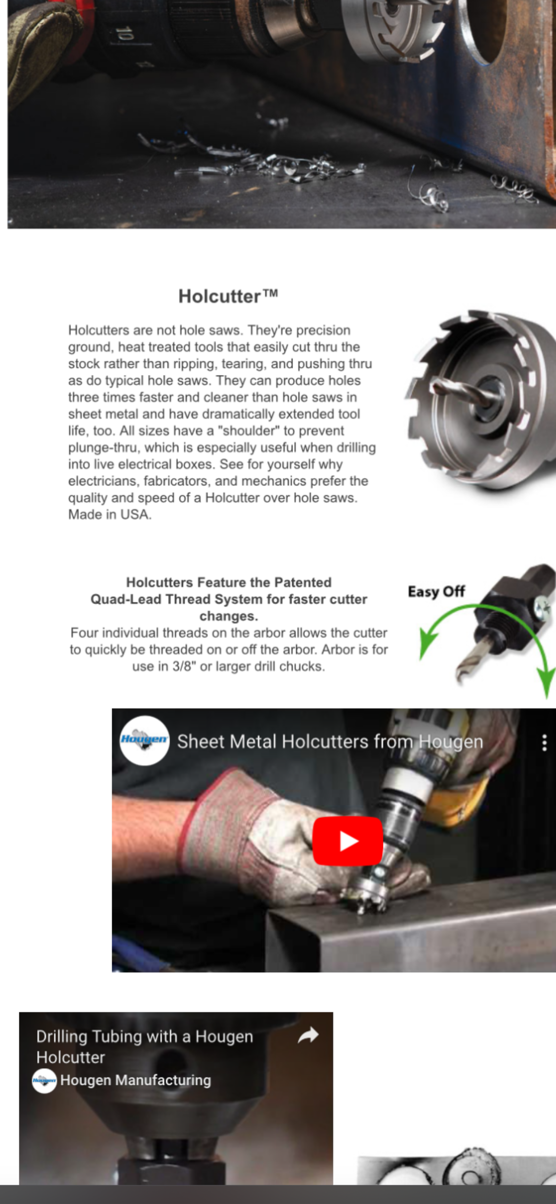

    I use this type of hole saws / cutters
    Single or kits Hougen
    Starting sizes 1/4 to like 3 inch
    Pic is just 1 kit , sizes & series.
    Drill
    Mag drill
    Mill
    69fury, flatheadpete and Budget36 like this.
