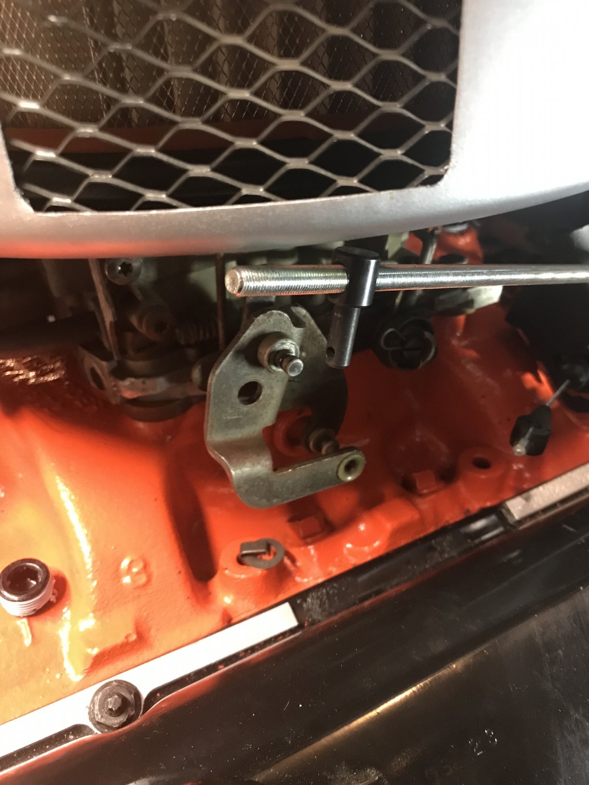

    Here is how I did mine:
    I was reluctant to modify carb linkage, although that may have been easier.
    The piece over the carb pin is an aircraft item, I think from that Spruce place. It is similar to the hardware used to adjust return spring length.
    A threaded tube from hardware store to connect to the throttle rod, which is threaded.
    The two nuts and chain are linkage for cruise control, so that can be ignored.
    Hope this helps.

    Thanks pprather.
    That was my thought as well, I was hoping to find a solution that would avoid drilling out the factory stud so that gives me some ideas.
    I was confused by the chain until I read your comment at the end. It almost looked like a solid and cable linkage when I first looked at the picture.
