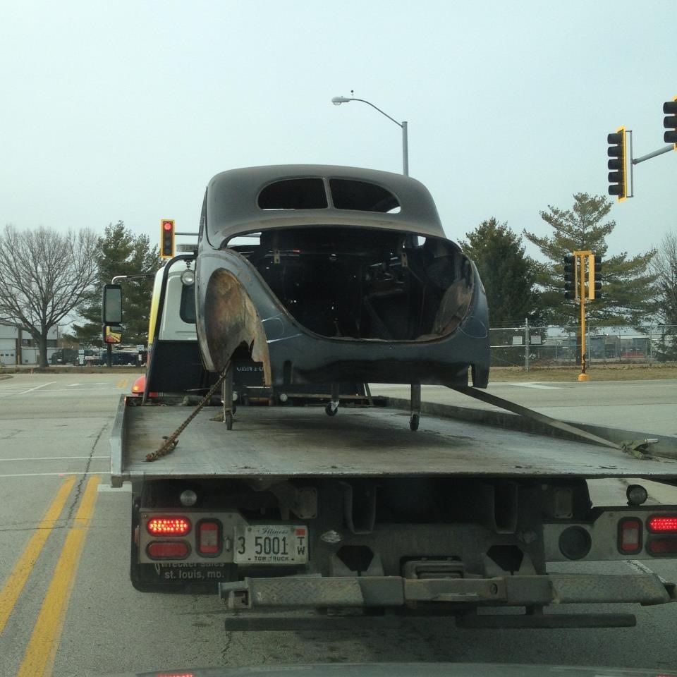

    Thanks alot for the feedback fellas, one thing I might add is that it's getting towed to my house also ....

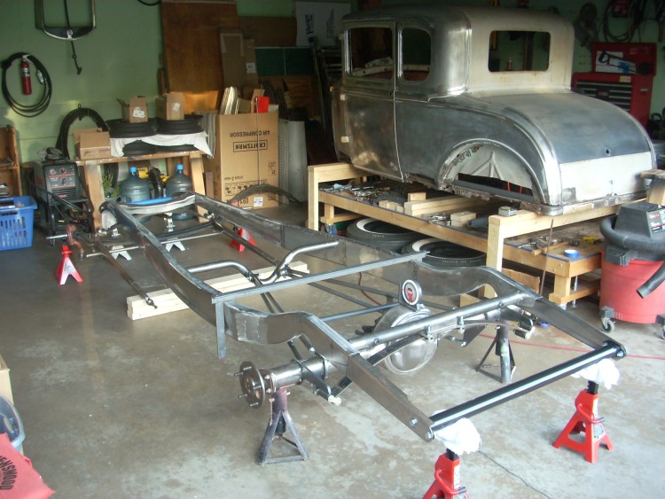

    First pic. I made a cart from some 2X4's, a 4'X8' sheet of OSB and some casters to hold the body. Second pic. I made a couple horses from 2X4's to set the body on so I could roll the cart out from underneath. Third pic. I bought some 1 1/2"X1 1/2" angle and attached it to the cart to make me a half-assed frame table complete with fixtures. Last pic. I even made some leveling jacks. It's not very pretty but it did everything I needed it to do...
