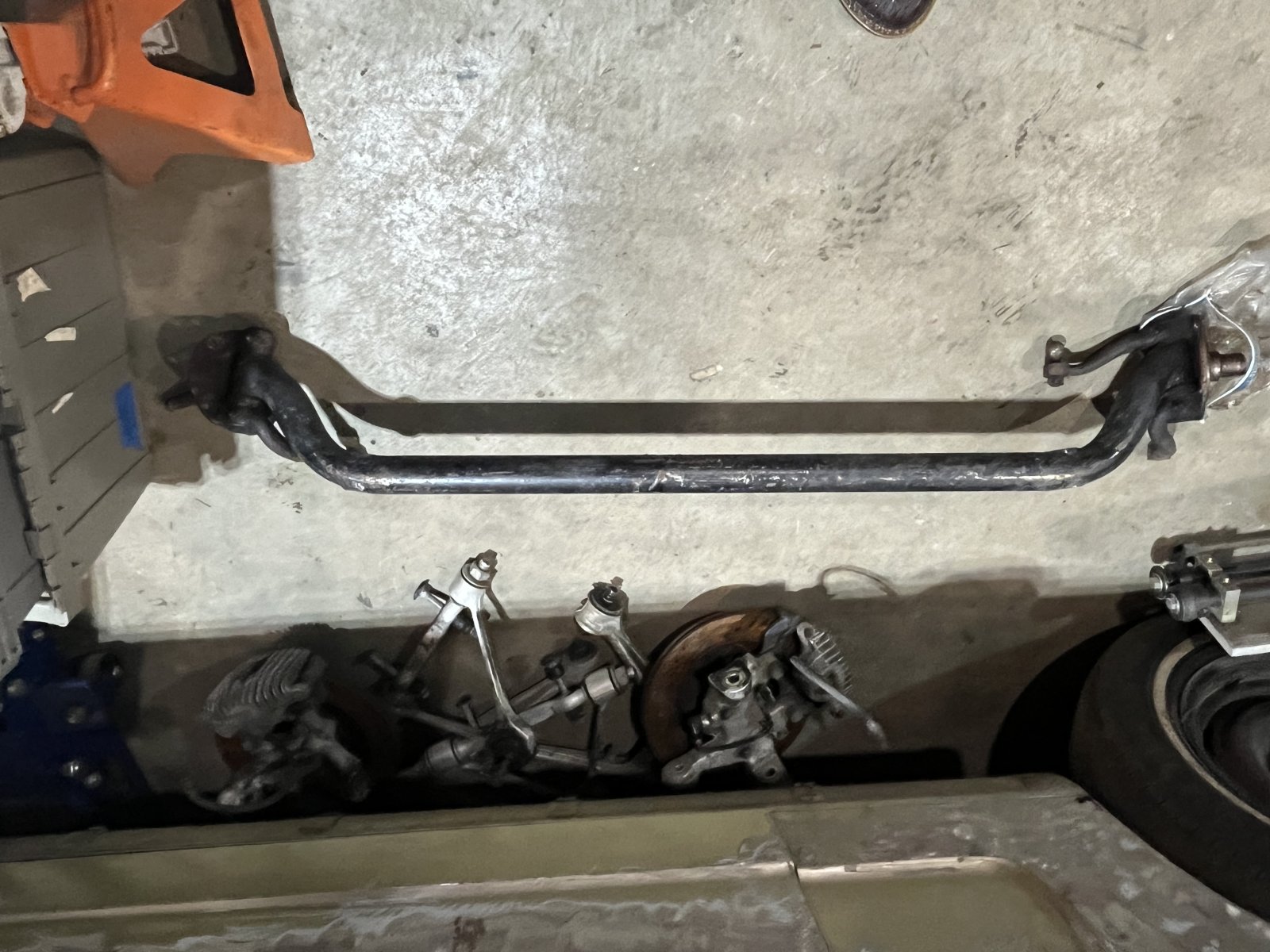

    IMG_6902.jpeg IMG_6903.jpeg IMG_6901.jpeg I have this 4” dropped tube axle and have never seen another one like it. It has set screws for the king pins rather than the traditional tapered wedge bolts. It was removed from a 1934 Ford pickup that was drag raced in the 60’s and early 70’s. Can anyone here identify who the manufacturer was?

  2. I’m thinking Speedway Motors

    Could be home made.
    Not the sort of thing i would run on the street looking at the construction

    looks pretty nice to me. Get it magnafluxed, put it back in....

    if its been in there a long time, which it looks to have been, it could be an MAS axle. those were pretty common in the 70's and 80's

    I have an old MAS tube axle that looks almost identical to your's, but has better welds.
    My guess is you have an MAS axle.

    I think these guys are right. I had a tube axle from M.A.S. (Minnesota Auto Specialties) under the front end of my first '27 T roadster. It was set up for Econoline spindles but also used allen head lock screws to hold kingpins in place.

    I agree with the MAS axle. HRP

    I have a dropped tube axle I bought at the Sr Peter, MN swap meet years ago the also has the allen-headed lock screws. Given the location, I always ***umed it was an MAS.

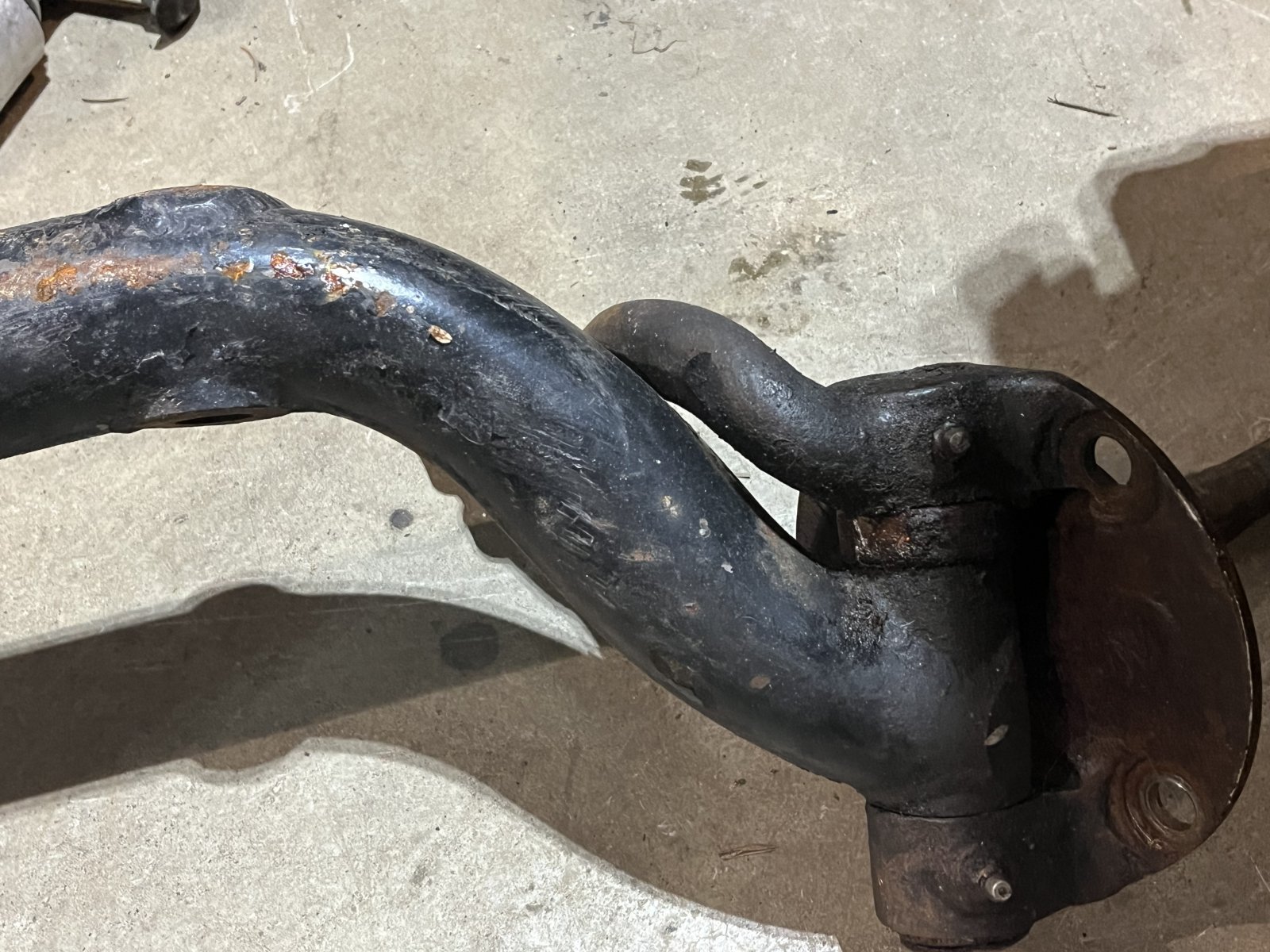

    Did MAS make tube axles with perch pin bosses welded in? Don't remember seeing them in any of their stores.

    EXTREMELY poor welding.

    Wonder what the spot of what appears to be br*** was about !

    Rust where the spindle contacted the welded on steering stop.

    These are definitely welded in. Thanks for all your input. MAS makes sense to me.

    PSI.. I had one. Same set screw set up. WAC uses 2 set screws on his axles.
