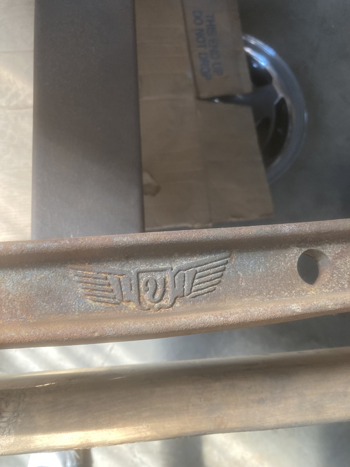

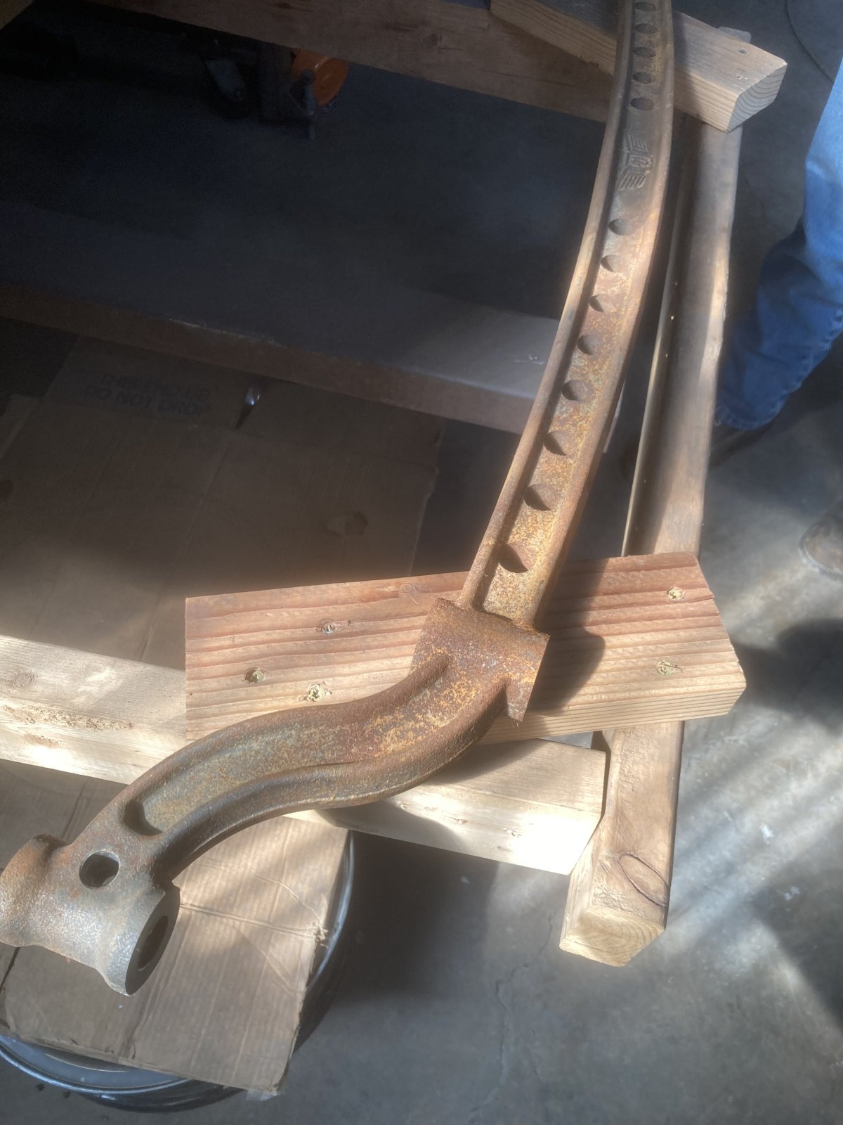

    I have a 4” dropped and drilled front axle with this embossing in the middle. Who can tell me who made this and quality. Thank you

    You could hang it on the wall and use it for a hat and coat rack, but don't hang any heavy things on it........:eek:

    NealinCA beat me to it. If you think you might give it a try then reread NealinCA's post.

    Cut it in half, we need to protect our species. You may not use it and no one else should have the opportunity either.

    Chinese junk cast axle!! Not a forged one! I saw one in person and it's a skinny too!

    I got three words for you. Snap, Crackle and Pop!!!

    That axle is such a piece of **** it could break hanging on the wall!

    Here is a ****ysis from a New Zealand Hotrod safety organization

    I commend everyone for calling out the dangerous quality of the Hoffman axle. The market should eventually determine the manufacture and sale of this part. But even faster would be a m***ive personal injury lawsuit. Seeing as how they are still selling this part, I can only surmise that there has not been a catastrophic failure as of yet. Does anyone have any first hand knowledge of this axle breaking?
    Several years ago Magnum had a bad batch of axles that broke and they did a commendable job of remending the situation. How has Hoffman continued to sell this axle?
