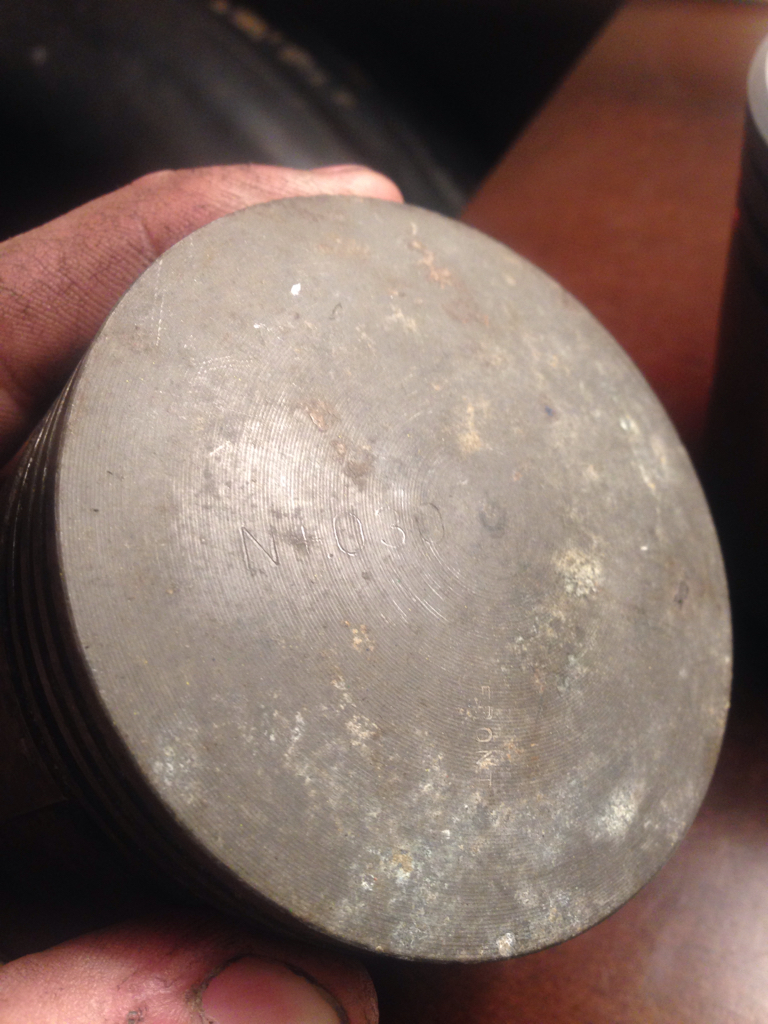

    Looks like stock fords to me. "Std" is definitely standard bore. And I'm not sure I would call it a domed piston but stockers do have a slight dome in them.
    N.O.S. .030 over Ford piston.
    I don't know if you can see it but it's stamped N +.030. Also note, no dimple, and the machine grooves.
