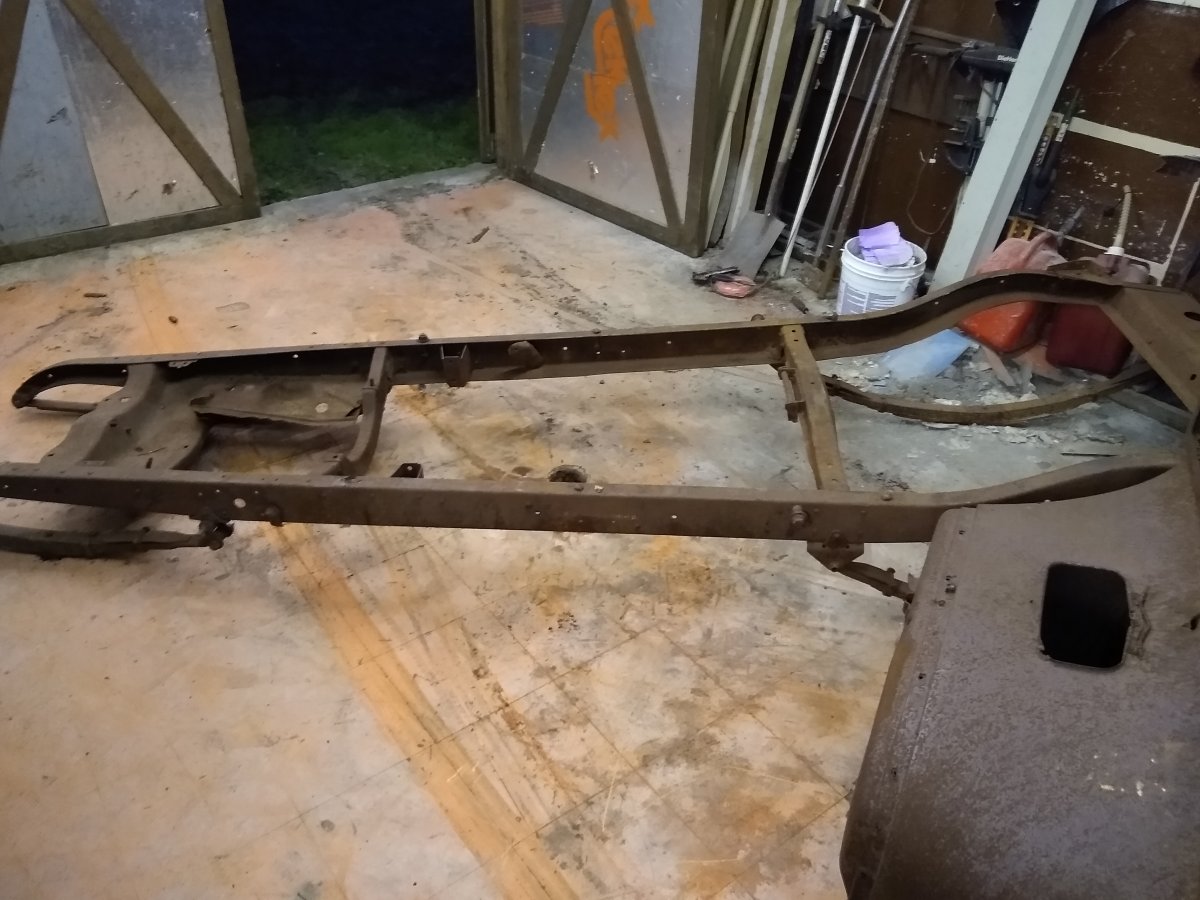

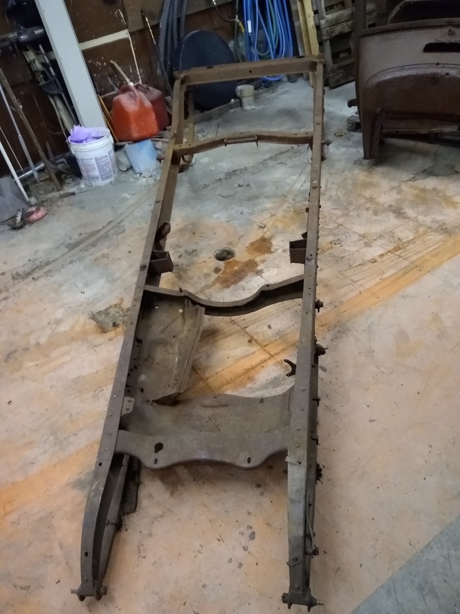

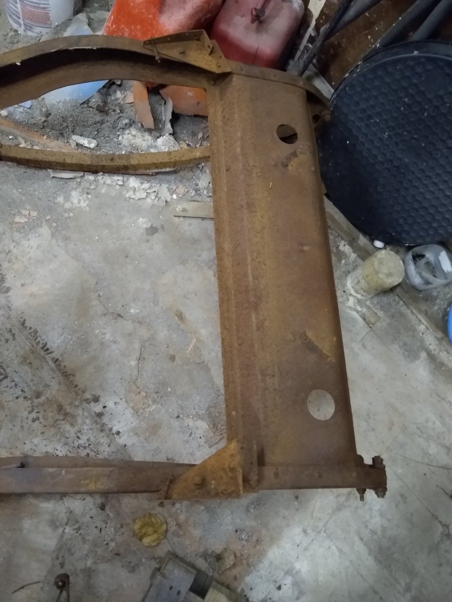

    I was pretty sure this was early Chevy, but now I don't know. Plymouth maybe?

    Giving me chevy vibes. Don’t know for sure so here’s a bump to the top
  3. gimpyshotrods
    Joined: May 20, 2009
    Posts: 24,487
    gimpyshotrods
    Same, but something about that rear crossmember is throwing me off a bit.

    the steering box mount and the side trans mounts are throwing me off.....also the battery box looks really similar to my 34 plymouth.

    28's were still 4 bangers. Maybe you could figure it out further by the length of the motor mounts
  11. studebakerjoe
    Joined: Jul 7, 2015
    Posts: 1,176
    studebakerjoe
    28s were supposed to have the six but they used a different front crossmember due to the shorter 4 cylinder. At least thats the story I heard. Not sure if I have a 29 parts catalog. I might. That could explain a different crossmember to accommodate the longer 6.

    It looks very similar to the 29 Chev frame I started with for my Modified Roadster.

    RMR&C you have a 27 chevy frame. There are a few indicators to year, Studebaker Joes front cross member says 28, the smaller pressed front cross member on yours says 26-27 (25 had one pressed cross member for radiator, one cast for front engine support), yours has transition cross member stirrups (between rear motor mount and battery box) started late 26. The brake rod support was on one side of that cross member in 26, and on the other side for 27 (I do not remember which). The clincher is yours has two holes in the rear cross member. Second hole for gas gauge------ 26 had no stinking gas gauge!
