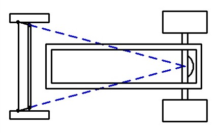

    Have fun an enjoy it,fix ackermen,an play,check out as much as you can,Looks nice ! AP4.jpg Over all looks cool
    ,dosen't matter what the body is as long you like it ! As long as vin # are right for frame your good. Hotrods are custom cars with tons of mods,so it dose not have to look like a 31 Ford anyway ! As for the frontend,only thing I see there in pic,is tierod out front{thats OK if done right},but spindle arms as is,don't go enough outword,ends /joints need to be a little more out nearer to tires for ackermen and would need a bit longer tierod.= The way it is now,will drive fine in a straight line,but in a turn the two front tires don't work together as they should. So they will slide more in dirt/water or higher speeds--thats why fairly good ackermen is needed for better turn control,so fix that. Frankly ,lots of hotrods have that misstake in there front ends,an bullheads* just keep driving that way,cuz they can't addmit* lie to there self about how it works good as is.. They been very lucky.
    Drawing shows the way the dotted line should go though the outer tierod joints and the kingpins for ackermen to work right. Something close is good,but a rear arm on the front is bad,or even a arm that is just straight out is not great ether.

    Oh come now...There is all sorts of Ackerman angle there....And none of it correct...………...

    Since you seem to have a lot of criticism on your car, I'd like to say that it really doesn't look that bad. While we all know that the tierod in front is a bad idea, no one seems to ask what components are used in the build. These are things you need to know if you ever need replacement parts. It has a Model A front axle, but what are those spindles and brakes? They aren't early Ford - smaller diameter. If you take pictures of the various components like rear axle, transmission, steering gear, etc. , maybe we can be of help.

    With no dropped axle and dropped steering arms I don't see a reason in the world why you couldn't swap the steering arms behind the axle where they belong.

    Here ascetics don't count as long as they don't factor in a safety issue. The front mounted tie rod might factor in there as while it isn't necessary on that car because there is plenty of room to have it behind the axle the builder may have thought that was a T bucket style rod requirement from looking in rod magazines at the time.
