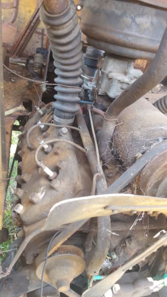

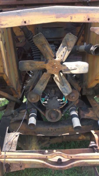

    I am wondering if you could shed some light on this engine and it's suitability as a fit into a traditional Model A. I have just come across it as an option, as the powerplant I eventually settle on will be the deciding factor for the theme of the car.
    The seller states it is full of oil, sealed as you see and turns over easily. Also states it comes from a 1944 Ford Blitz with manual gearbox and transfer case included. From my (very quick) research, as it was during wartime, it could be anything.
    Would this sort of engine be suitable for seeing street and highway duties? I am not sure if there is a difference between military and civilian models.
    Is there anything I can look out for or inspect when it is ***embled and complete like this?
    Thanks in advance from Australia.

    See if you can pull the heads for inspection before you buy. Look for cracks between the valve seats and cylinder walls. Does it turn over?

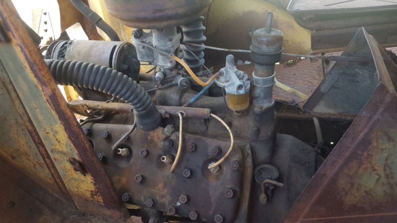

    Is that the dipstick tube shown to the left of the generator? If it is extended that much, I would wonder if it is a truck engine. The truck engines have lower compression and considerably less power. I'm not sure how to verify that it is or is is not a truck engine. The distributor is also missing. What is the engine currently located in? Sort of looks like a machine application of some sort.

    kbgreen...look again,,distributor shows in my photos

    Ignore the fact it's in a truck. You can use it if it's OK, but not the gearbox. Obviously rebuild it.

    Look for a raised 59 on the upper bellhousing,indicating post war 44-48. 59 motors also had round water holes in block with heads removed(lower center) Pre 59 motors had a "keystone" shaped water hole in block.Keystone blocks (Merc-Trucks) had 3 3/16 bore and keystone blocks in cars had 3 1/16 bore. image.jpg

    I believe the trucks have a oil pan that has a removable shield on the flywheel area. This allowed you to change flywheel and clutch without pulling the pan. The car pan would have to be removed to replace the flywheel. Didn't some of the heads have "8rt", if they were truck?

    8RT would be after 1949, which this engine is not. If it's actually from the 1944 vehicle it is technically not a 59A motor. S****e the gunk off the top of the bellhousing and look for some big numbers/letters cast into it. It has a 1942 style distributor cap on it, but that may have been changed as it's easy to do.
    No matter what the numbers may be, it would still be a fine engine for a hot rod. But as stated above, you need to pull a head (not and easy job) to check for the most common cracks. Then a complete dis***embly to check for more in the pan rails. Then if no cracks are found during magnafluxing, have a pressure check done to see if there are any corrosion problems through the water jackets.

    It appears to be a Canadian wartime motor. If accessories are original, 1942--end of war. Blitz probably means the Canadian built CMP cab forward trucks and gun tractors used by all imperial armies...I think their engines were 239's, and you have lucked into essentially a '42 Merc engine. Doesn't seem to have PCV or full flow filter, so pre-1943...Looking at details will settle that.
    As it is furnished, if you swap the huge fan for a smaller p***enger car generator fan you will have the perfect (shortest!) flathead ensemble for fitting a Model A.

    Yep, top photo is very clear, you are correct.
