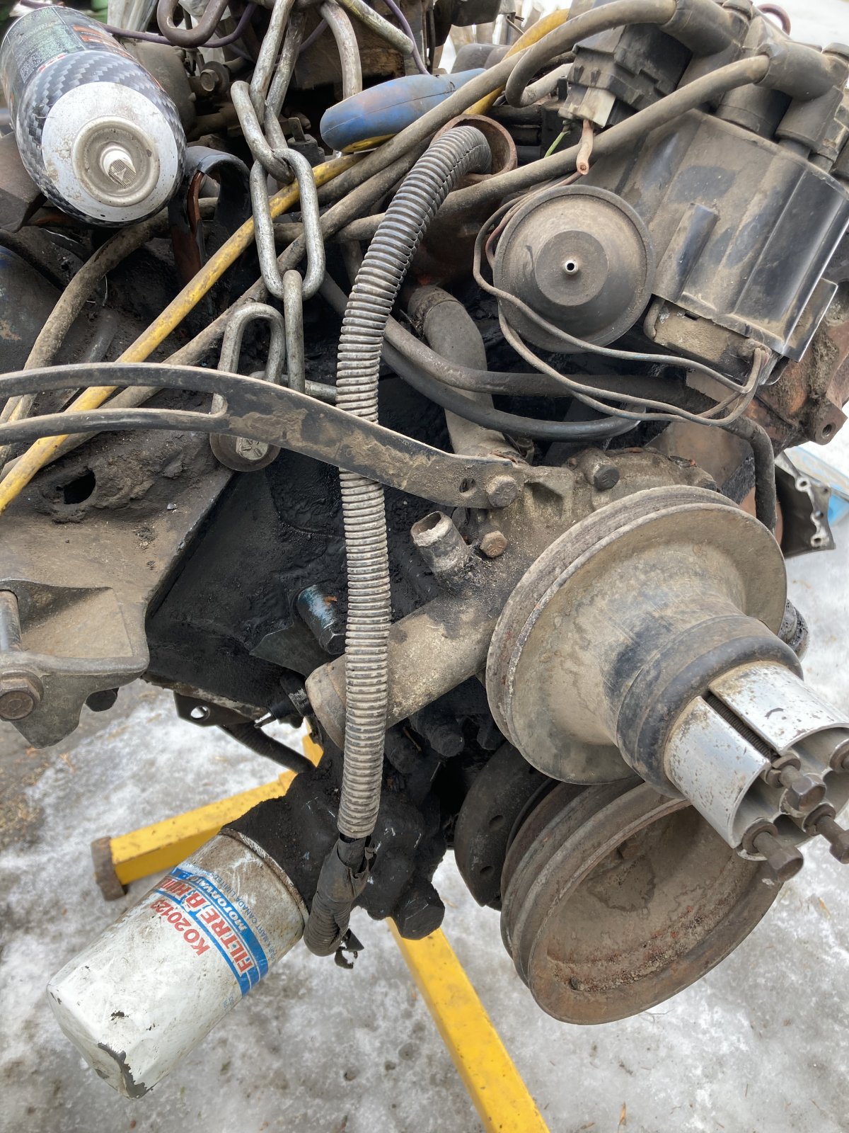

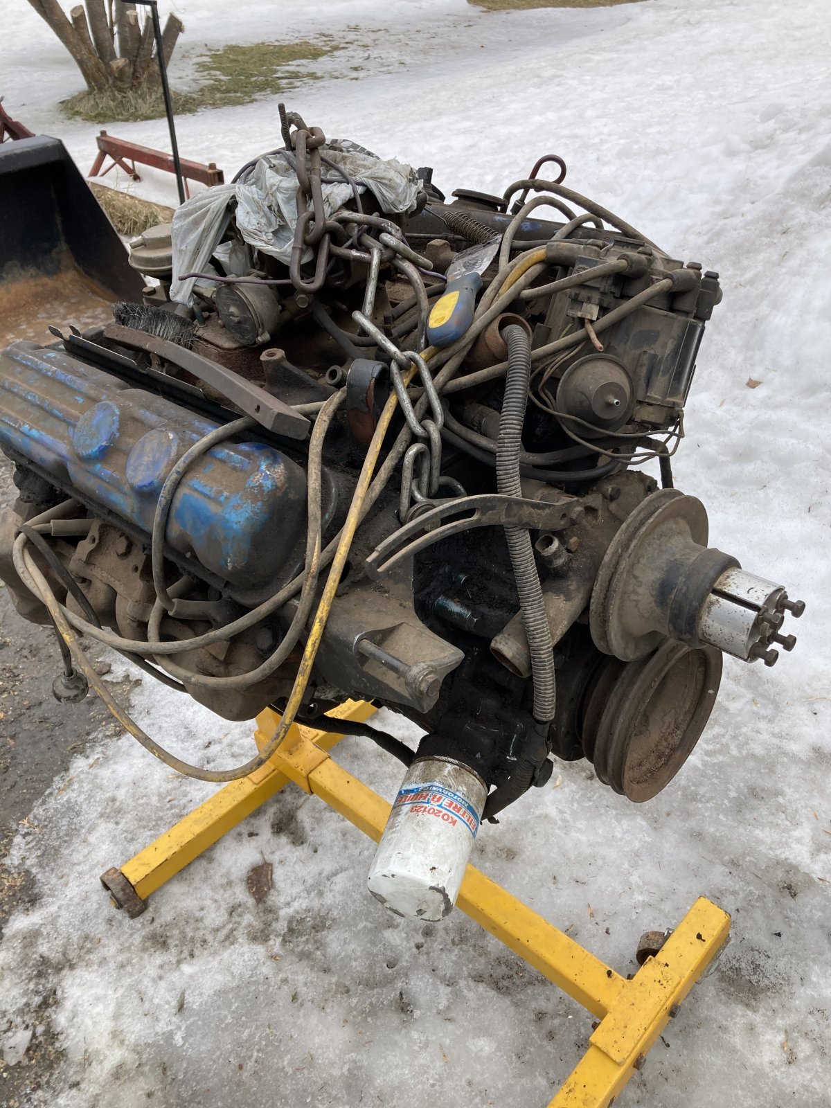

    how about some pictures? The 350 buick is a unique engine, we should be able to tell just looking at it whether or not that's what it is. The 340 looks like the older engines, the 400-430-455 are quite a bit larger, but look similar to the 350.
    The partial VIN 25L....indicates it's an engine from a Pontiac from 1975, built in Los Angeles.
    The intake casting number looks right for a Buick 350
    but pictures...yeah, they tell us everything.

    that sure looks like a Buick 350. HEI was introduced in 1975.

    Yes, That is a Buick 350……

    External oil pump and 6 bolt valve covers . And blue paint suggest its a late 70’s buick motor. Likely 350.

    Seeing how that is a metallic blue engine with hei it has to be 74-76. 77 and up would have been light blue.

    From what's shown in pics the balancer rubber ring is intact and not cracked, up close may be different story.
