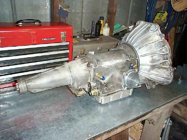

    The C5 was a separate transmission. Used '83-'86 it was a C4 modified to accept a lock-up torque converter. The bell housing was longer, and used a different valve body. The case has better oiling and the internals are good. It's a good core for building a C4. Just need to use a C4 valve body, converter, and bell housing. The c5 also came in the 2 different case/bell configurations. Big bell, pan fill with the 164 tooth flexplate, and the small bell, case fill with a 157 tooth flexplate.
    The small bell was used in compact cars to minimize the floor hump. Mid/full size, vans, trucks got the big bell.
    Small bell case fill C4. Note the stepped case at the bell. The bell is attached by the seven 3/8" pump bolts
    Big bell, pan fill C4. Note the smoothly flared case at the bell. Attached with five 7/16" bolts.
