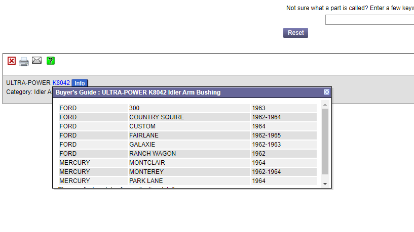

    Moog catalog shows K8042 (two bushings) to March 2 1964, and K8094 and K8139 after that date. No dimensions given. Each only fits a couple years.
    looks like there are some NOS and repop on ebay. Who knows if/when they would get to you down there.

    All the bushing identified so far feature the longer idler arm bushing and not the shorter drag (Centre) link bushing. The cross reference with Galaxie (K8042) is 1.75"L X 1.29"Dia (Outside ) x .634" (Inside). It's almost impossible to locate OEM drag (Centre) link bushing (1.124"). Just clarifying Moog K8139 measurements.
