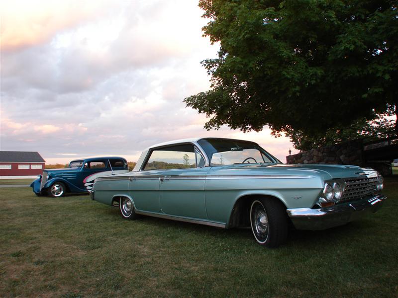

    I got under the '62 Impala yesterday to look into raising the rear end a little. My buddy, from whom I bought the car, cut the coils. It looked cool but the axle banged on the tailpipes over bumps.
    When I pulled into the garage, the brakes felt "funny", and when I jacked the car up, I saw why. The left rear brake line, brand new, was squashed on top of the axle where it got betweent tailpipe and axle. It had been pinched off so effectively that the small hole :)eek:) worn it it wasn't leaking out too much brake fluid, but it had finally leaked out enough to make the brakes spongy. Fortunately, I noticed this before I head cross country in it and lost the brakes in East Overshoe Oklahoma, or somewhere.
    I replaced the line, repositioned the new one a little, and am going to replace the heavily whacked rear springs with new ones and add some overloads. The goal is to lower it just enough to look non stock, but still be able to load car with passngers, the trunk with gear, and not squash brake lines and tailpipes :D.
