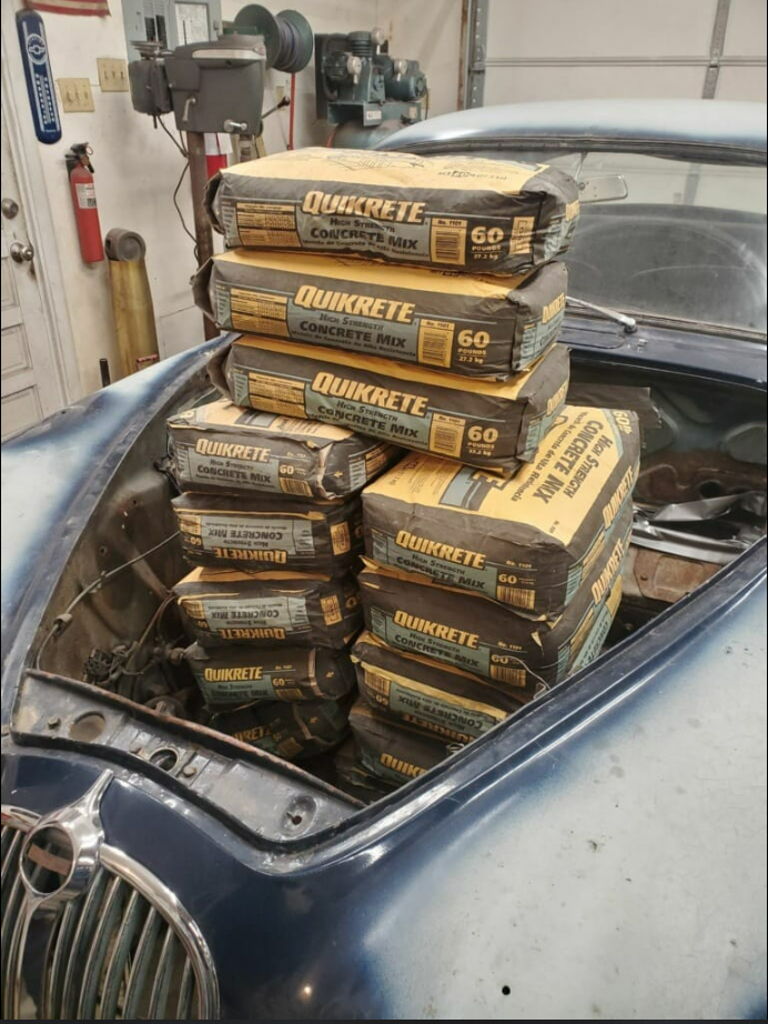

    WHAT YEAR JAG? Photos would help with worthwhile answers & tips. Bob
    I believe this is the Hellfish Jag project.
    anthony myrick likes this.
  9. The37Kid
    Joined: Apr 30, 2004
    Posts: 32,366
    The37Kid
    Six bags of cement in place of the engine would help with the overall stance.
  10. 20 bags of cement would be closer to the number for a Jag 6 and transmission.
