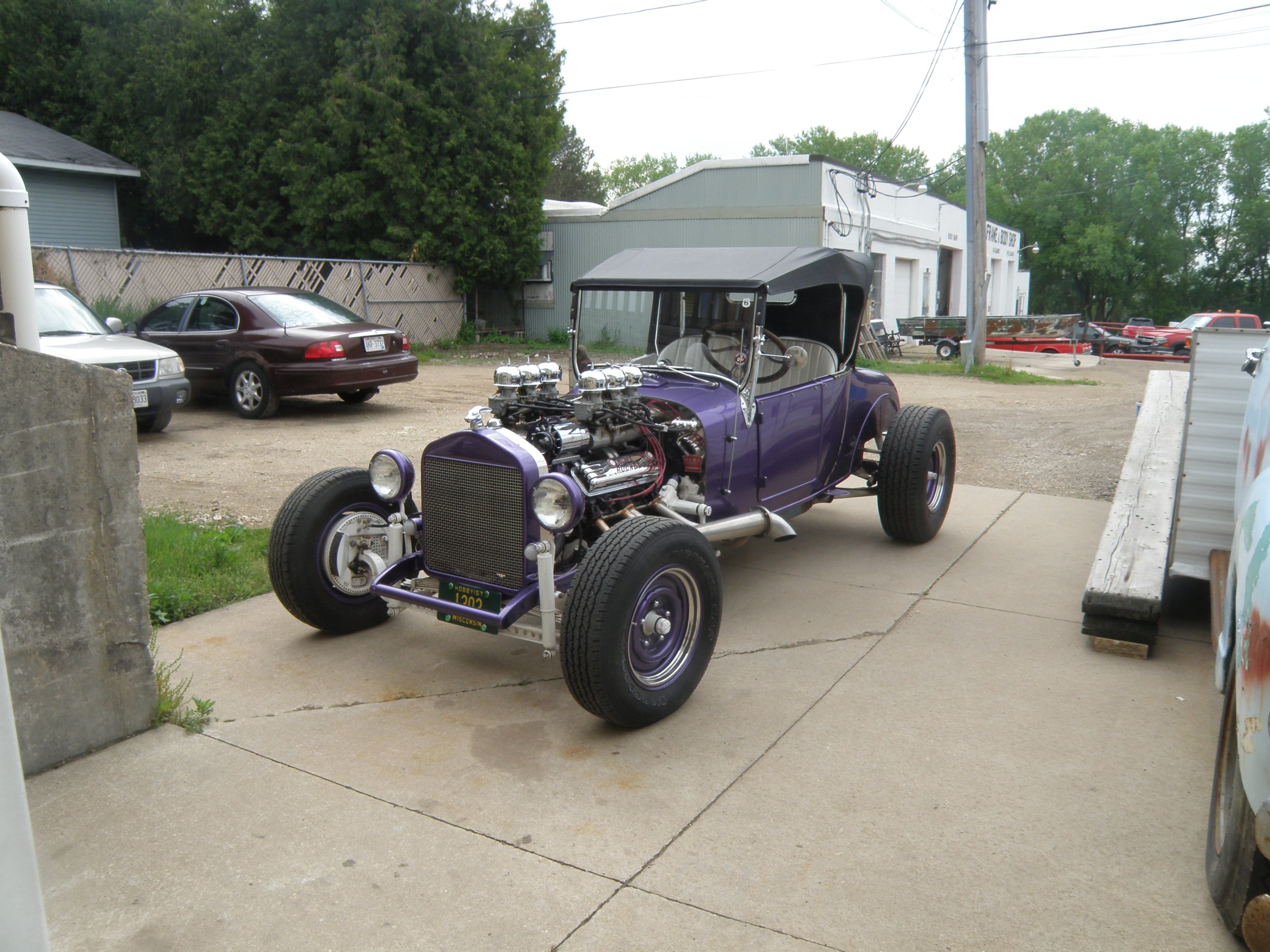

  10. ROADSTER1927
    Joined: Feb 14, 2009
    Posts: 3,299
    ROADSTER1927
    This car rides pretty good and I have sliders in front and back springs. I also removed a couple leaves in both P5190009 (1).JPG springs.
    leon bee likes this.
