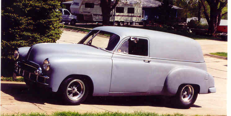

  18. and yet you don't say what your car has .....:confused:
  19. ...guess I'm a cheap hack!
    ...you better go with Chassis Engineering bolt in if you don't wanna be one too!
    ...BTW, here's a 49 Fleetline I put a 72 Nova clip under, worked out great.
