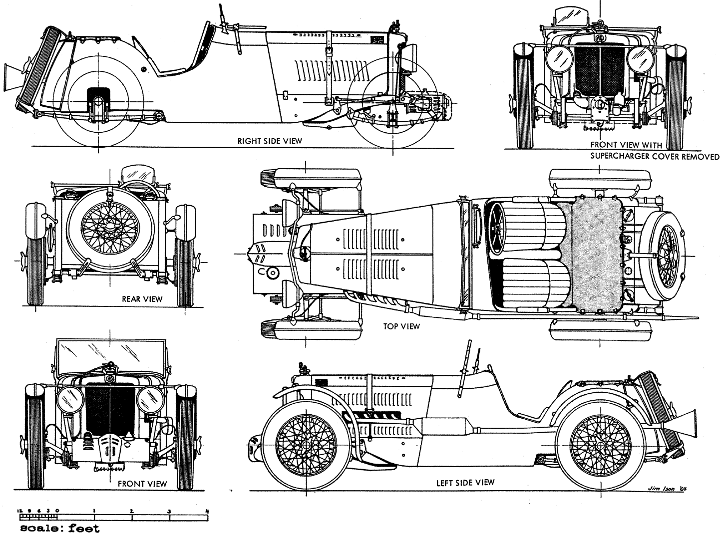

    As you're working with MG bits you might also take a look at the MG K3 for inspiration:
    My '31 project has undergone considerable metamorphoses from its origins as Model-A-based to its current status as Model-A-based, now locked in due to my having acquired a '31 firewall and a Deuce shell. Along the way it was Model-T-based for a while, and for a short time it was an MG K3 replica.
    The story here was that a local used car dealer near my office had a VW-based MG TD replica on their lot, but grossly overpriced. I was watching to see if the price would come down to a realistic level, and in the process had the idea of "de-faking" the thing. That is, losing the Beetle floorpan and subs***uting a ladder frame, front-mounted water-cooled engine, and beam-axle front end. As it was registered as an MG I even had the plan to sling a detuned Audi 5 in the back for the roadworthy inspection and then transfer it to the front at my leisure afterwards. It might be a weird choice of engine but in the right state of tune those things can have quite an appealing sound.
    But this, to cut a long story short, required a bit of a wheelbase stretch, and as I was going beam axle it wasn't going to be any more a TD than it was on the VW ch***is. Looking around for an historical precedent turned up the K3: right size, cool proportions.
    But things moved on. The TD replica was sold, I found some bits, and the '31 is a '31 again.
    Not to take over your project, but I think we might have thick wads of notes to exchange :D
