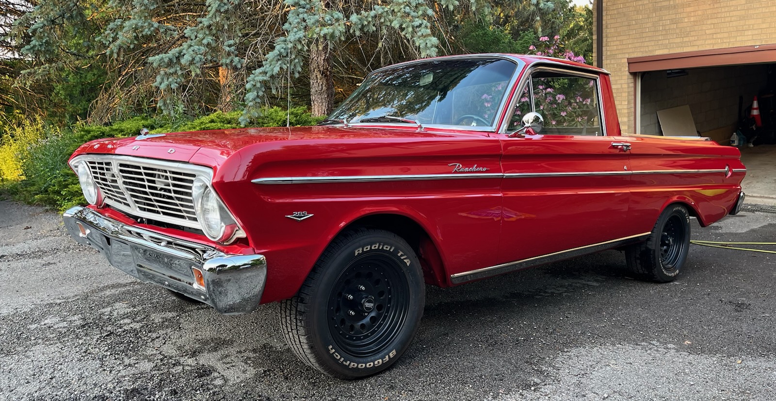

    Hey Guys,
    For context: I've been running Holley's Sniper EFI - forgive me my sins, I now see the error of my ways - on my '65 ranchero since I installed the rebuilt/hopped-up original 289. It has been okay for me, but I'm getting sick of fixing it: an O2 sensor here, a pressure regulator there, two fuel pumps... I'm going to switch back to a carb [Holley 4150]. I put the EFI on there to improve the reliability and fuel economy and got neither...oh well. The engine itself is healthy - it runs cool, has great oil pressure, spark plugs look healthy, so I know the engine is solid. Car is a 'peppy' cruiser, not a race car, by the way.
    Anyway, here's my question for you guys:
    I can't reuse the 'Hyperspark' distributor and ignition system from the Sniper. I'm planning on picking up an MSD 'ready to run' distributor and blaster ignition coil, but I'm not sure if I need an ignition controller. So, my question for you guys is: do I need to add a 6AL ignition box or something similar for my application? I've seen mixed reviews on whether or not they're worth it. I'm not running a blower or crazy compression/cam or gnarly RPM's which is usually what I see listed as being the defining elements of needing one of these units. I can afford to buy it, but if it's not going to do me any good or be more trouble than it's worth, I'll just save the money. Highlights of engine specs below.
    Engine:
    • 289 bored .03" over, standard stroke
    • 10.2:1 Static compression
    • Howard's hydraulic flat tappet cam & lifters [.501/.501 lift, 221/231 @ .05" duration, 106 LSA] - max RPM = 6200
    • AFR165 heads with Edelbrock performer RPM intake
    • Running 93 octane, T10 4-speed, 3.25 gears
    Thanks in advance for any input you guys may have! And because everyone likes pictures, I've attached one just to show off the ole Wrenchero...
    -Chris
