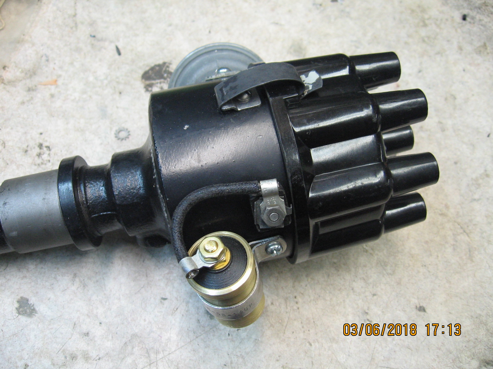

  19. tubman
    Joined: May 16, 2007
    Posts: 8,678
    tubman
    These have proven to be very reliable. They mount on the outside of the distributor.
    LAROKE, warbird1, egads and 4 others like this.

  21. G-son
    Joined: Dec 19, 2012
    Posts: 1,553
    G-son
    from Sweden
    Sounds very large for an ignition cap, my memory suggests something closer to 0,2 micro farad/200 nano farad. Too tired to research now unfortunately, 4AM just being awake to get the heat out before trying to sleep. Summer hit hard, at 36C in the shade in Sweden.

    Yeah, the article linked to earlier in this thread says .20 - .22 microfarads. 600 volts.
    Here you go:
    Axial leads - https://www.mouser.com/ProductDetail/Cornell-Dubilier-CDE/940C6P22K-F?qs=zsnhSutGCZWd1UevJM1khQ==
    Radial leads - https://www.mouser.com/ProductDetail/Cornell-Dubilier-CDE/715P22456MD3?qs=mKWJoQeCbqC0Cv58%2BZJ2pg==

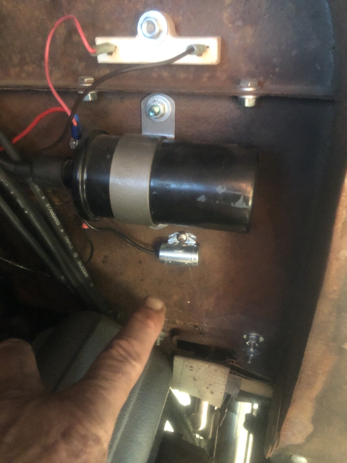

  27. pecker head
    Joined: Nov 8, 2006
    Posts: 4,499
    pecker head
    1F1A3EF6-E46C-489D-B06F-1F2A38F9AAFF.jpeg I just moved my condenser out of distributor and on to firewall, will be lots easier to change. Went to Oreileys and bought a lifetime warranty condenser and a year warranty condenser.
