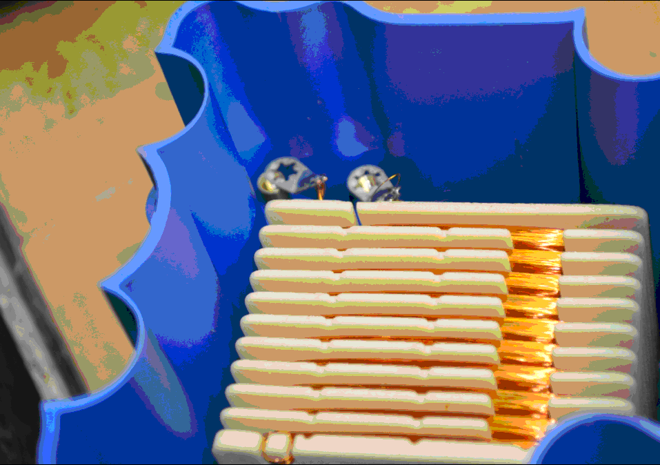

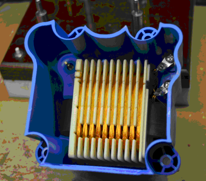

  27. lol, i'll be more then glad to show you some pictures on how our hvc series coils ( 8250-8252-8251-8253-8261)are all hand made...( nothing to hide)....
    http://www.youtube.com/watch?v=a1lfWWTfk0c&feature=youtu.be
    <?xml:namespace prefix = o ns = "urn:schemas-microsoft-com:eek:ffice:eek:ffice" /><o:p> bobbin machine.gif
    hvc 2 coil 8253.gif </o:p>
    <o:p> </o:p>
    <o:p></o:p>
    <o:p></o:p>
