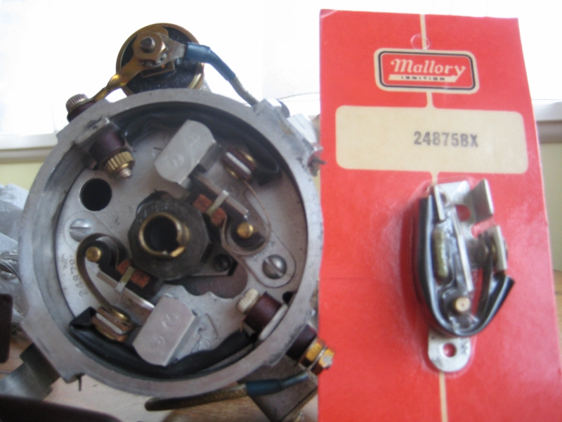

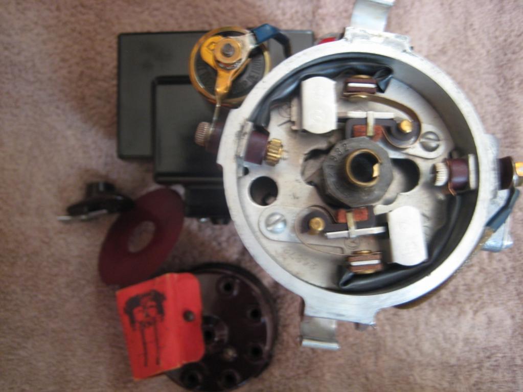

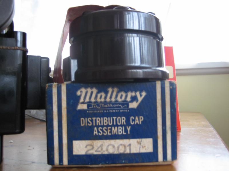

  2. The 24001 two piece cap assy or 24004 lower cap, 24215B rotor, the brass condensors and 24875B points (Summit Racing etc have these) are what I got but had to wait on E-Bay sellers to front them up, the X on the pic with the points means extra strong spring for racing, not necessary on street. I searched but found no store suppliers for these parts (except points) :(Might be able to adapt a 4004 cap and 4215C rotor, dunno....maybe distributor guru GMC Bubba can help :confused: Do you have the Magspark coil to suit?

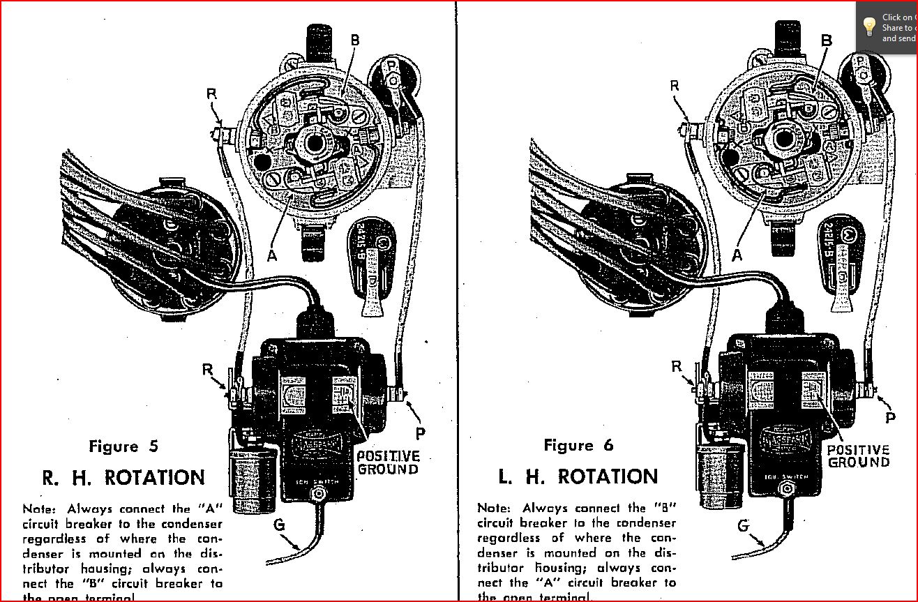

    I've read the Mallory transformer is ideal for the magspark. I've also read you can wire up a regular coil as well. Can anyone go into detail about the transformer with regards to the magspark?

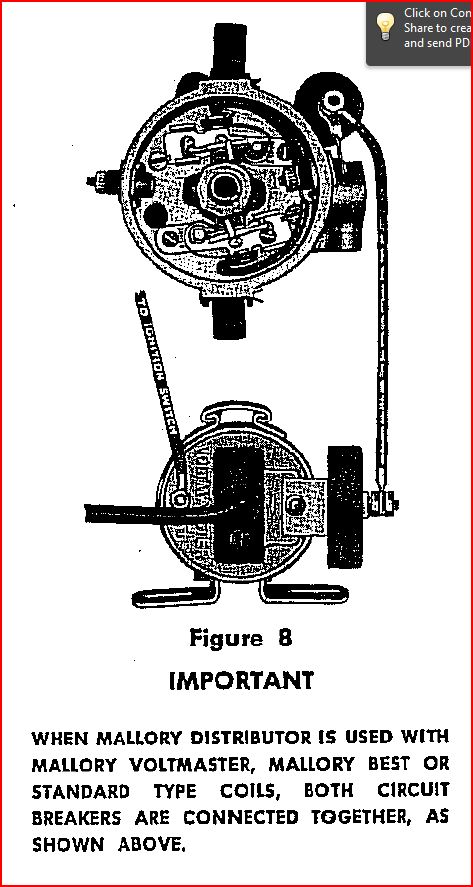

  13. If you join the two breaker points together you can run as a dual point, I have the complete Mallory Magspark instructions in a PDF file (Adobe Acrobat will open), PM me with a e-mail address and I will send you a copy if you wish :D

    Wiring them together only works on eight lobe cam units, the four lobe requires a distributor machine. You adjust one set of points to spec and then sync the other set on the degree rings. Other wise the cylinders wont fire 45 degrees from each other.
    Actually i like using the pertronics unit on the four cam units.....for this reason...

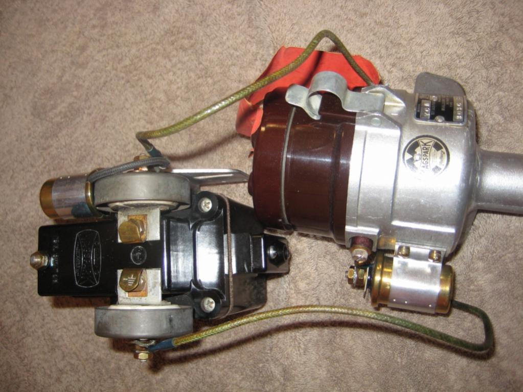

  18. Pics as requested by Terd
    Original wiring for use with MagSpark coil (requires 2 condensors)
  19. Magspark wired for non Magspark style coil (requires 1 condensor)
