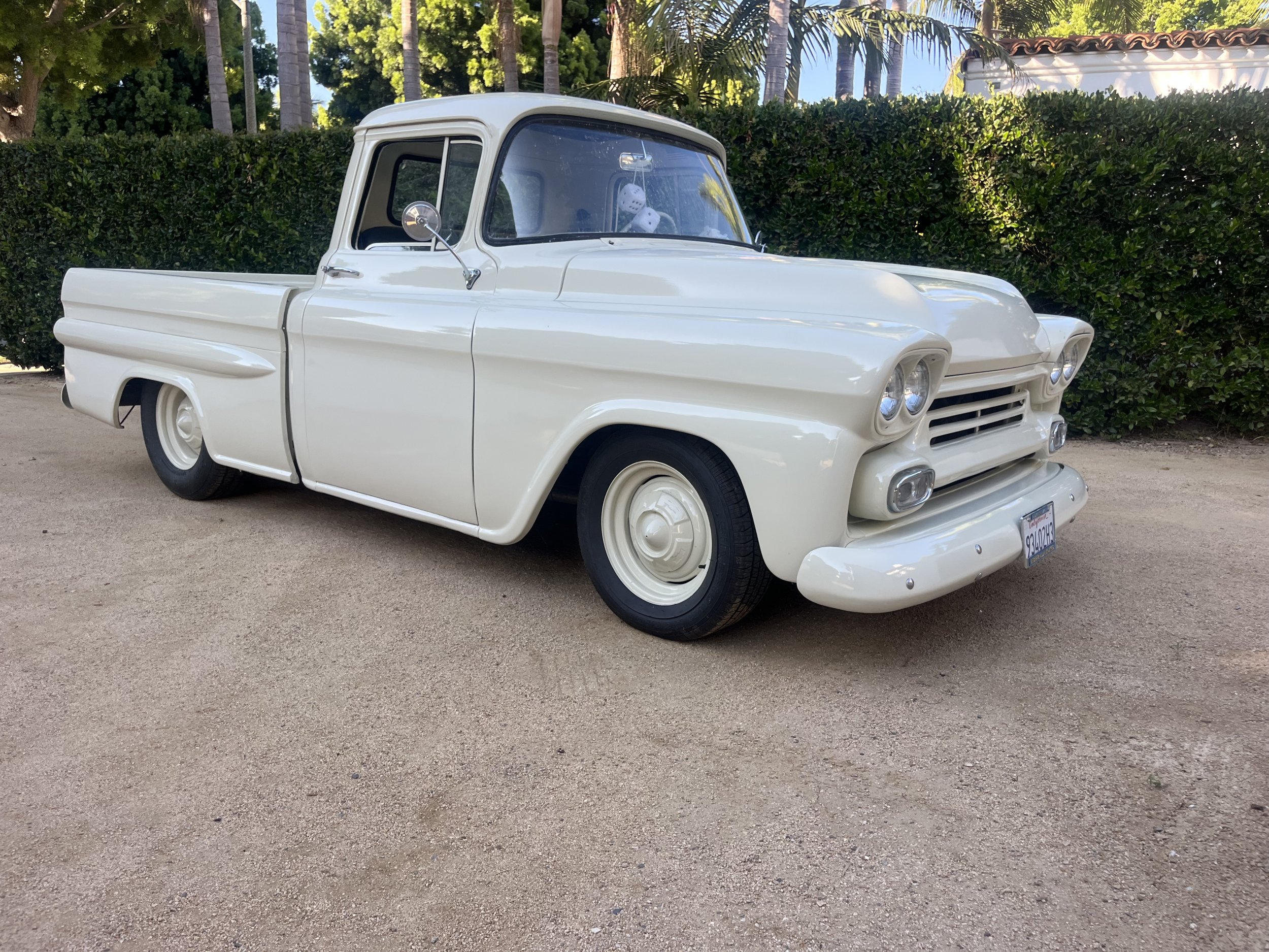

    I built a truck for my 16 year old daughter and my Ignition wire gets hot while driving and then it doesn't start unless I jump the wires at the starter. Thoughts please!

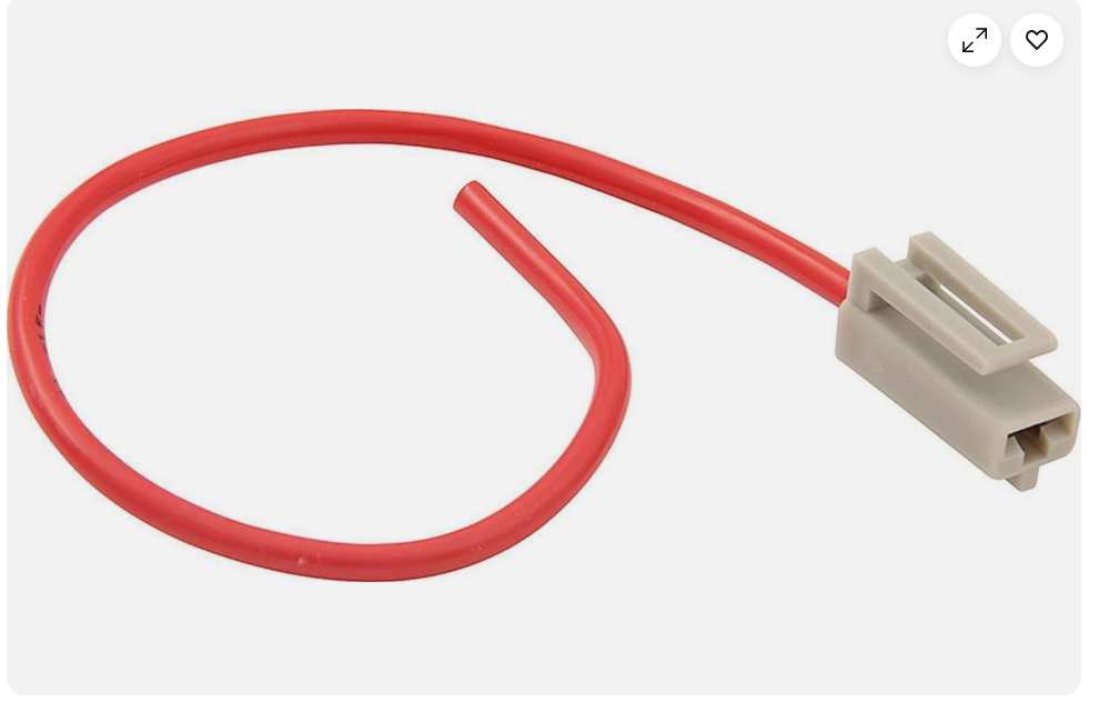

    Screenshot (1004).png What did they use for a connector on the igniton wire to the distributor. It has to have a correct Hei clip on the wire and the wire has to be the correct gauge to handle the load.
    The HEI doesn't use a ballast resistor or resistor wire as it needs a full 12 volts all the time.
    When I first stuck an HEI in my 71 GMC I went Joe Cheap and used a female slide and length of wire and the female slide would get just loose enough to loose contact but still be kind of connected especially when it rained and I was on the way to work at 3 am. I'm thinking that the wire was probably too small of a gauge too as I just grabbed a female slide terminal out of my termainal box and used some wire I had.
