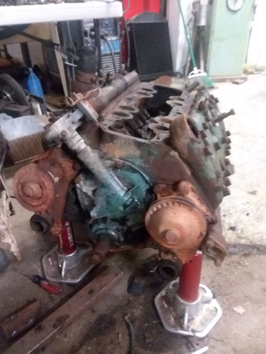

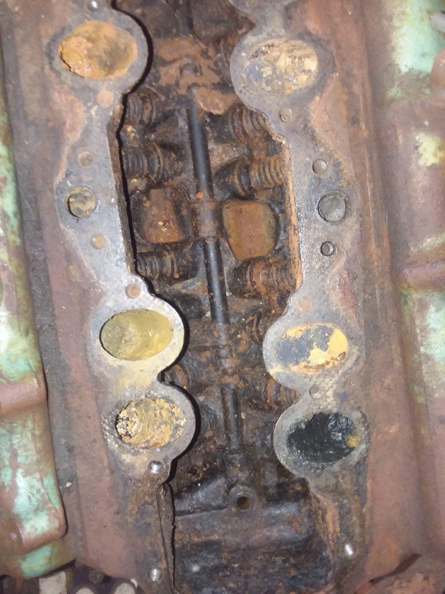

    16059110592911413721550519841851.jpg 16059111090626788232923338629270.jpg 1605911176802594318569546998084.jpg It's pretty crusty in the intake ports

    Heads can easily be swapped for those in desperate need of a HP " increase". Check for the throw of the crank out the elongated dimple on the crank.

    welcome, the timing gear housing has a small indent near the base of the shaft... pilot...
    if stock that is a 1949 only...

    Just because it has Merc heads means nothing. Don't ask me how I know. If it has a Ford 3 3/4" crank the Merc heads will lower the compression. If you want to run stock heads find a set of EAB heads whether or not you have a Merc crank.

    '49 Merc would have had wide belt pulleys. From what I can see in the photos the pumps are narrow belt but its hard to tell and pumps could have been changed over the years. Did it come with a bell housing? If it has a 1/2 bell sheet metal housing that's another indication of Merc but not a guarantee. Pull a head and measure the stroke. Then you'll know for sure.

    Be sure to check all of the decks for cracks. Flatheads came with a national stock number for the cracks.

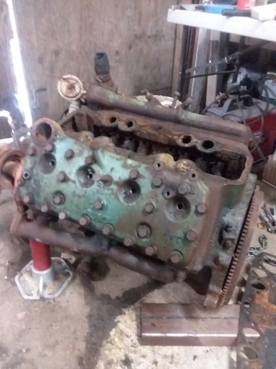

    The read two cylinders seem the roughest but it seems that there is no major pitting from what I can see and feel I'm going to try to get the oil pan pull tonight but it might carry over to tomorrow 16059224436656640272720227011351.jpg 16059225685728207328451211513478.jpg

    Hmmm. I enlarged the picture and don't see even the "part number" cracks. You may have gotten lucky.

  24. brady1929
    Joined: Sep 30, 2006
    Posts: 9,633
    brady1929
    You may have to have it magnafluxed at the machine shop. Cracks may not be visible to the naked eye. Good luck and welcome.

    Just so you know, "part number cracks" are the cracks between the middle head bolt hole and the water p***age just below it between the #1 and #2 cylinders and #3 and #4 cylinders. They are considered to be harmless and are common in a lot of flathead blocks. I have found that if you get a block without them, it is practically guaranteed to be good. (Maybe I have just been lucky.) They are called "part number cracks" because they are so common that a few wags have suggested that they should have been ***igned a "part number" by Ford.
    In addition to having the block magna-fluxed, it should be pressure tested, which a lot of folks will say that will detect internal hidden cracks better than magna-fluxing.

    Depending on how much of an over bore you plan on (if any) you might want to consider sonic testing the block in addition to the magniflux and pressure test. The machinist that did the work on my 8ba said based on his experience (extensive) and the mag test he didn't feel a pressure test was necessary. 10k on the rebuild and no issues so he was right

    Hmm. In my experience, 1/8" (.125") overbore in an 8BA has never been a problem (and the pistons are the same price); Ford had the "core-shift" problem under control by then. I also believe that skipping the pressure test would be a mistake.
    I also recommend "Mart"'s videos; the guy is a "practical" treasure. In the same vein, you might want to try "The Ford Barn"; website where things are a little more "flathead focused".
