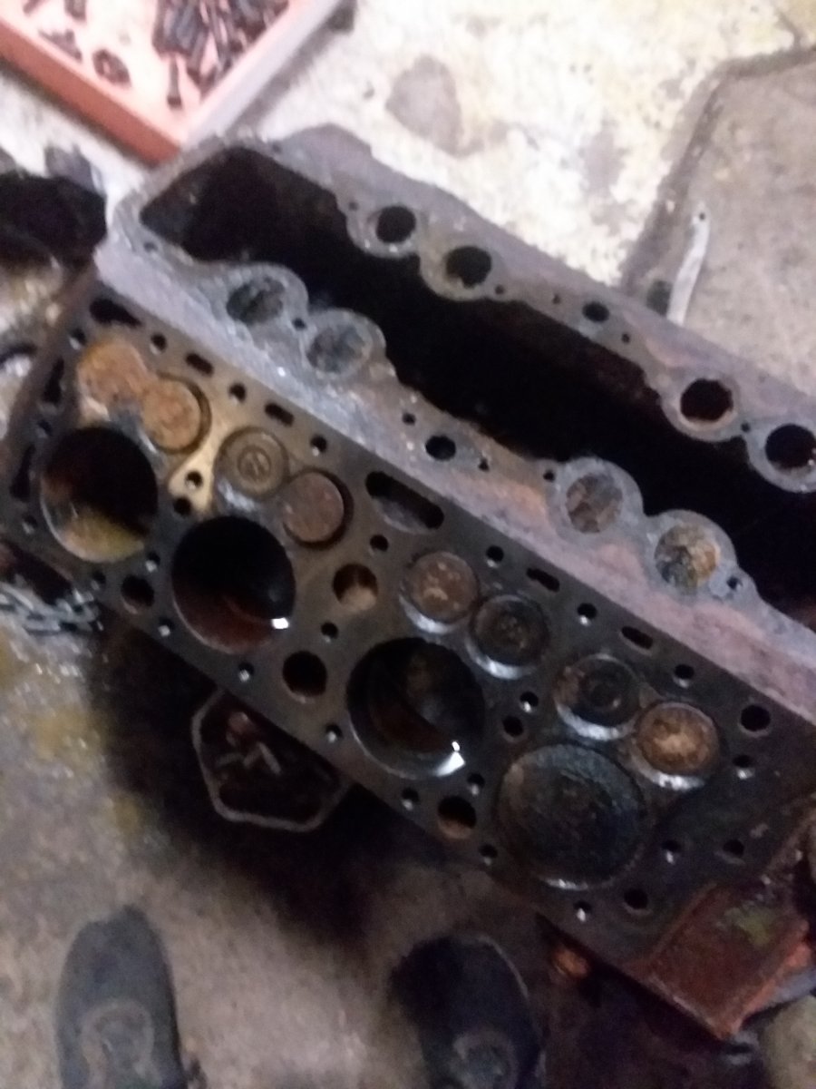

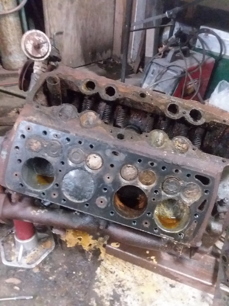

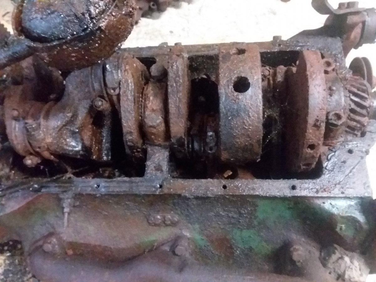

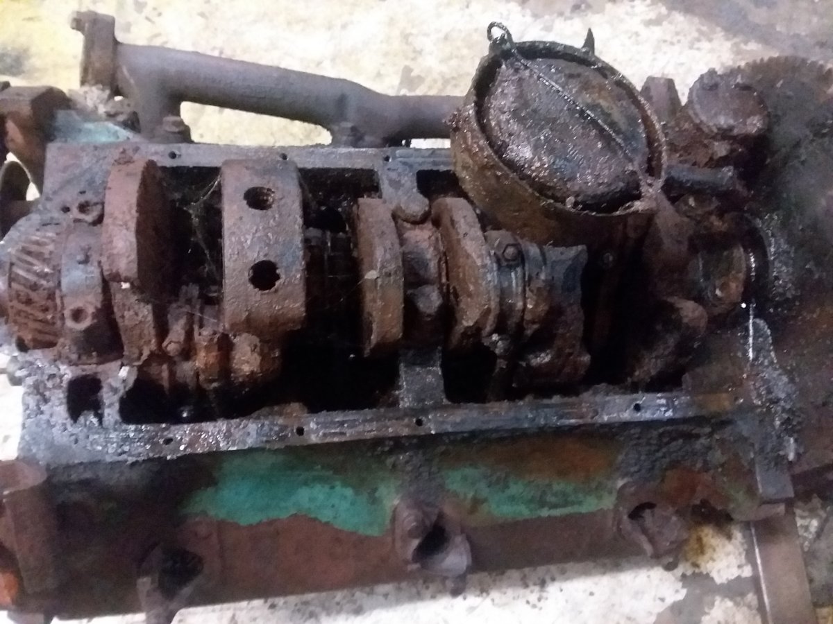

    I got the oil pan off today, I'm guessing it's a good thing that there was oil in it? 1606004452517325295476165857936.jpg 16060044864286474622179977261196.jpg

  26. Other than the fact that it would affect bearings, I think I'd be tempted to do an oven cleaner/pressure washer clean up, then soak it in citric acid for about a month before I turned any more wrenches. Might make life a whole lot easier and prevent a few broken parts.

    Citric acid may be better than mol***es but with the one exhaust manifold already broken it will not hurt it. Try to get the water pumps off then the solution will also get in and help clean the water jacket.
