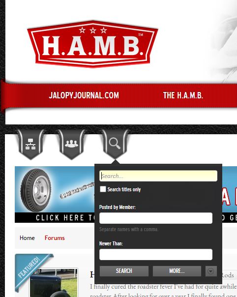

    no disrespect to anyone, but the above mentioned search function doesn’t always bring the required results.
    A better option is to do a google search and type in the word hamb first.

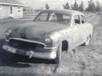

    Last flathead I took apart took 3 months to get the pistons out. I soaked them in an ATF, diesel, acetone mix, tapped on the piston tops every time I walked past it, set it on fire all for nuthin! After 3 months of frustration I knocked holes in the piston tops from underneath and carefully tapped the remainder of the pistons out. Done in an hour.
    BTW, when I was 16 my dad and I built a 53 merc motor for my 50 ford. Your 34 is far cooler than my 14 year old 50 ford. Rockysfirstshubox1.jpg

    Your 50 ford is cool too I've always loved the lines on them.
