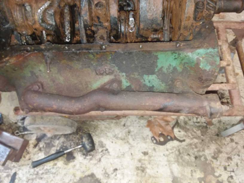

    I'm going to work on removing what's left of the exhaust manifolds today. 1609621975859.jpeg 1609622009633.jpeg

    After a bit of heat and wrenching the manifold bolts came out pretty easy, there's 2 broken bolts on the manifold side that was broken that I will have to remove that were broken when I got it I'm now trying to figure out what to do next. 1609625504533.jpeg 1609625527887.jpeg

    Great no cracks along the oil pan rail. Are the exhaust manifold bolts broken off below the surface of the side of the block or even with it? Use your Dad's experience with them and possibly weld on a nut to get them out. That along with the localized heat will most times get them removed.

    According to my dad they stick out just enough to weld a bolt on.

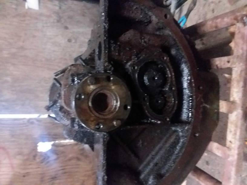

    I removed the flywheel and the idle gear cover next I'm going to try to remove the ider gear any tips on how to do so would be much appreciated 1609631453435.jpeg
    Sent from my SM-J727V using The H.A.M.B. mobile app
    chryslerfan55 and dana barlow like this.
  11. 51504bat
    Joined: May 22, 2010
    Posts: 5,659
    51504bat
    Its been a while since I removed one but IIRC I took a flat bar and drilled 3 holes in it. The 2 outer holes bolted to the 2 holes directly across from the cover bolts (about 2 and 8 o'clock in your photo). Thread a bolt into the gear through the center hole. You'll need to space the flat stock off the block which will allow the gear to pull out as you tighten the center bolt. The center bolt has to be flush with the flat bar to start. As you tighten the bolt it will pull out the gear. But like I said its been a while and I no longer have any flatheads laying around to verify this procedure.

    When ever I need to remove the oil pump idler gear I simply use a slide hammer that has a 3/8 inch co**** thread stud on the end. The end of the idler shaft has the threaded hole the shaft will pull out easily using the slide hammer idea if you have one handy.
    Ronnieroadster
    48fordnut and chryslerfan55 like this.

    put a little duct tape on the block, keep it as close to the broken stud as possible so you can't weld the stud to the black...
    i was chopping a '29 tudor as entertainment at our rod run...
    guy had a break down, so i welded to the end of a alt bolt broken off in a bbc aluminum head... i did not weld a bolt on as i had a better shot just welding the stud, i built up about 3/8"... was going to use vise grips but didn't need them...
    worked great and the stud gets so hot welding it that when cool it came out with plyers...
