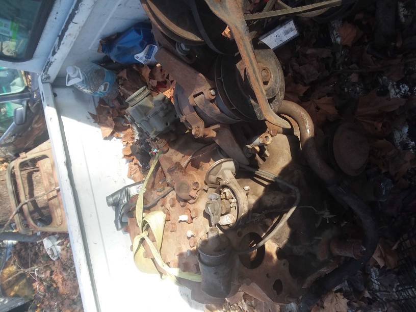

  3. Jesse Borba
    Joined: Nov 20, 2020
    Posts: 99
    Jesse Borba
    So this is what my 3 day weekend was full of I found all these parts that somebody had 2 hours away from me as a bundle on facebook marketplace. I got piles of generators, heads, and single carb manifolds. I also got a 59 L motor that was running but not well that has like .10 over left on it so it might be junk but it came with all the rest of the stuff. I also got a complete 8ba and a merc block that needs at least one cylinder sleeved. 1611166884547.jpeg 1611166918156.jpeg 1611167040074.jpeg 1611167083163.jpeg 1611167260967.jpeg
    Sent from my SM-J727V using The H.A.M.B. mobile app
  4. Gearhead Graphics
    Joined: Oct 4, 2008
    Posts: 3,890
    Gearhead Graphics
    from Denver Co
    nice score, sort out what you need, sell some and fund your project

  6. tubman
    Joined: May 16, 2007
    Posts: 8,255
    tubman
    Did the Merc block come with a crankshaft? If not it's a Ford block.:( Even if it was no good, I'd clean and paint that 59L block and leave it sit in the corner of my shop just for braggin' rights.:D
  7. Jesse Borba
    Posts: 99
    Jesse Borba
    It did not the guy I got it from kept it for his motor it was just thrown in with everything else. I did also get 3 nice ford cranks with everything and I have a 4 inch crank from my original motor as long as I can get it out. I might end up doing that with the 59 L at some point it has adjustable tapits in it and it's bored to 3 3/8 which I think is the max but I've read on here people being able to bore 59 L motors more than a standard block.

  10. F-ONE
    Joined: Mar 27, 2008
    Posts: 3,717
    F-ONE
    from Alabama
    From the Flat Spot...
    You have something to work with now!
    I'd check the new Mercury block to confirm it needs to be sleeved. It's a given that the block you started with is going to have to be sleeved.
    In short...
    I think you need to concentrate on that 59L.
    Why.?....
    8BAs are a pain in the ****. Two things...Loadomatic distributors and the road draft system. These two things make souping up an 8BA troublsome.
    To soup up an 8BA, you have to change distributors if you change carburetors. Either you have to get a GM distributor modified, a vintage Mallory Flat Top, A HEI distributor that looks like *** on a Flathead or newer China Made Mallory of questionable possibly dubious quality.
    The vent system of a 8BA means earlier intakes like the Slingshot( not offered for the 8BA) require a make shift vent/PCV system to run a 59 or earlier style intake.
    Build the 59L!
    chryslerfan55 and Jesse Borba like this.
