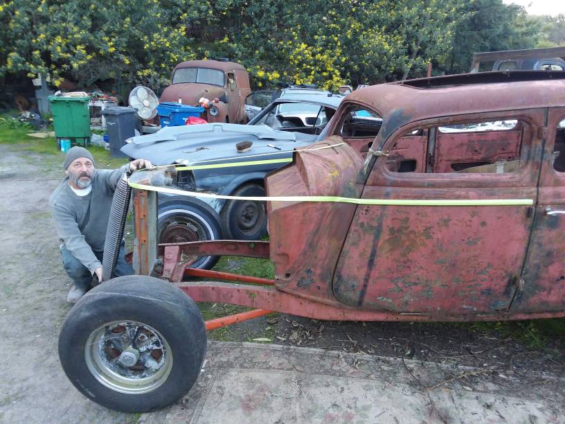

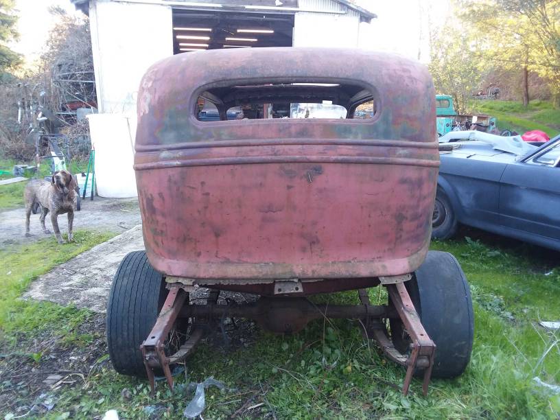

    Got the 4 door out so I can start fixing the rot in the body. I also picked up a lasalle grill that I think would look really cool as a track nose. The rear end set up is kinda wacky with the parallel leaves sticking super far out but when they extended the frame they didn't butcher it at all so it should be reversible. It also already has a 40 ford rear cross member. I'll be putting a 40 ford rear in it that I picked up that was supposedly frozen but it spun free and really nice as soon as I got it home[emoji2962]. 1614385892606.jpeg 1614385962183.jpeg 1614386005340.jpeg IMG_20210219_185317_985.jpeg

  22. Jesse, that body looks to be in good shape but we all know that internet pictures can hide small imperfections. I don't know about the Lasalle grille but it is your car, your vision.

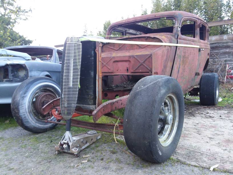

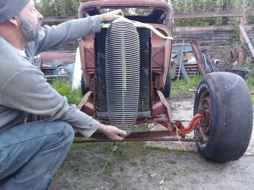

    Got some tape, a radiator, a jack, and the grille setup to give myself an idea about how it would look. 1614389460627.jpeg 1614389609467.jpeg 1614389647536.jpeg

    You can get a much better vision of what it can look like if you post a request on the photoshop thread of what you're thinking of doing. Those guys are magicians and are always willing to help a fellow hot rodder see what something will look like without a lot of work and expense to discover that their idea is not a great idea and was just a brain fart!
