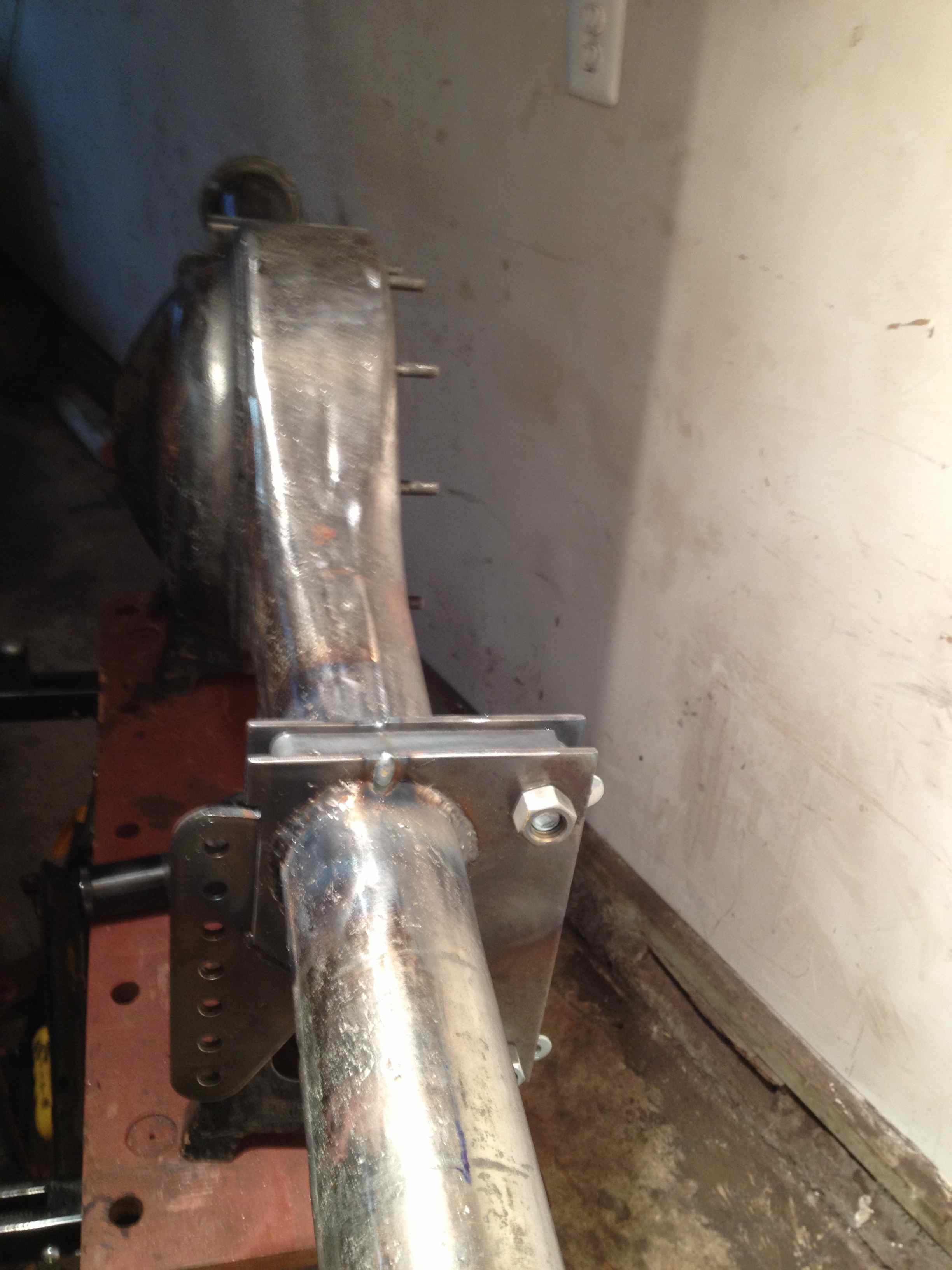

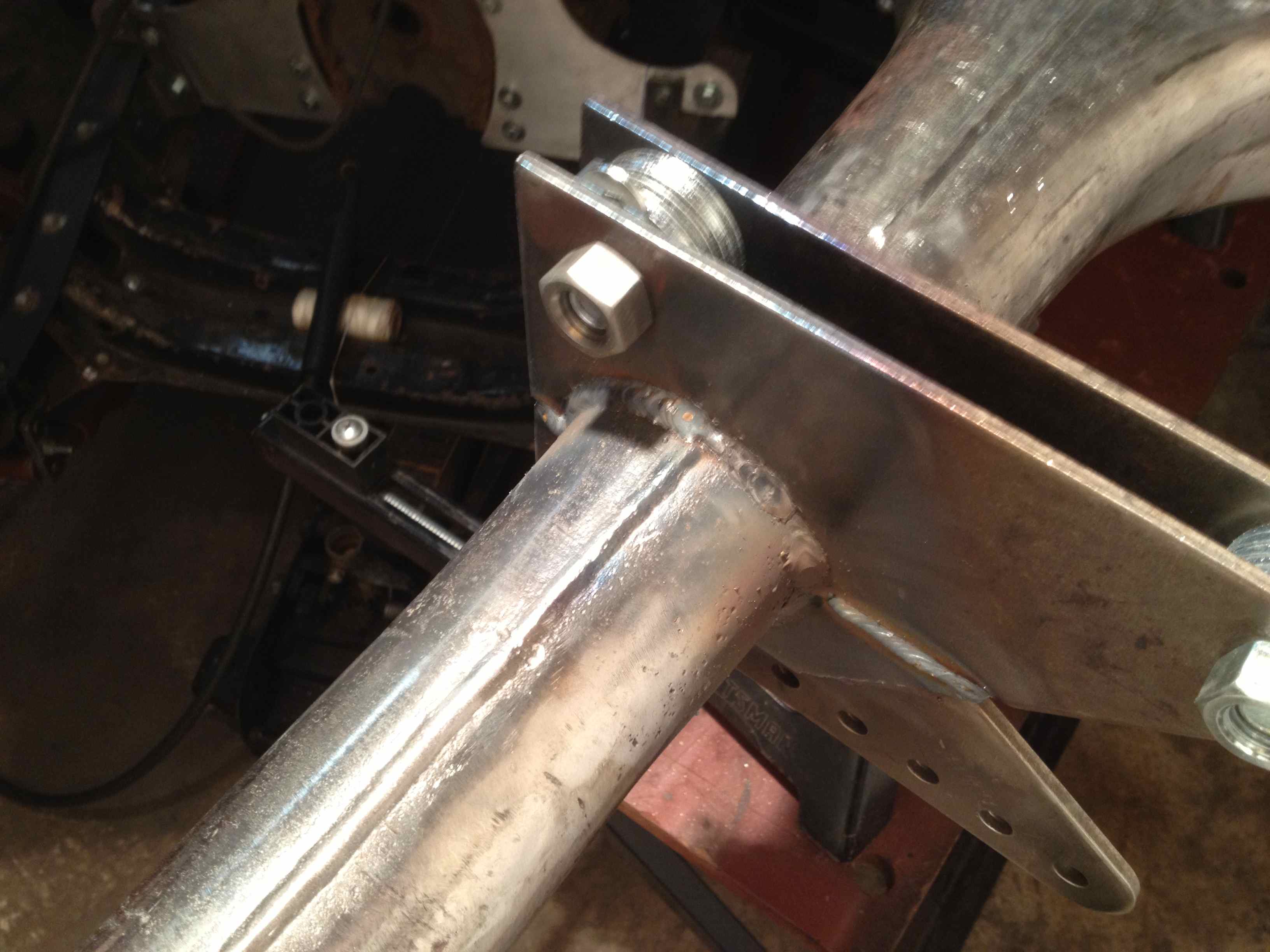

    IMG_0234.jpg IMG_0237.jpg IMG_0238.jpg IMG_0239.jpg IMG_0241.jpg Well, I hope I didn't scare anyone off with the My Little Pony talk. Anyway, as promised, my wife took the kids away for the weekend, so I got something done. I got all the brackets welded up on the rearend. I had the idea that I might take pictures of the whole process, but being only one man, it made it hard to take pictures, heat with the torch, and then weld. Oh well, you'll have to live with the ****py pictures that I did take. Here is the process that I used:
    1. Once everything was set up I preheated the axle tube with a rosebud.
    2. Started on one side of the bracket and welded about an inch, then flipped to the other side of the bracket and welded about an inch going the opposite direction. I continued to flip flop back and forth to each side of the bracket, keeping the heat in.
    3. When the weld was completed 360* on both sides, I used the rosebud to post heat the axle tube again and then let it cool completely.
    4. Then repeat on the other axle tube.
    It took SIX hours to get it complete, but, there is no warpage and I am very happy. It may not win any beauty contests, but its REALLY solid. Thanks for watching, hopefully more to come tomorrow.

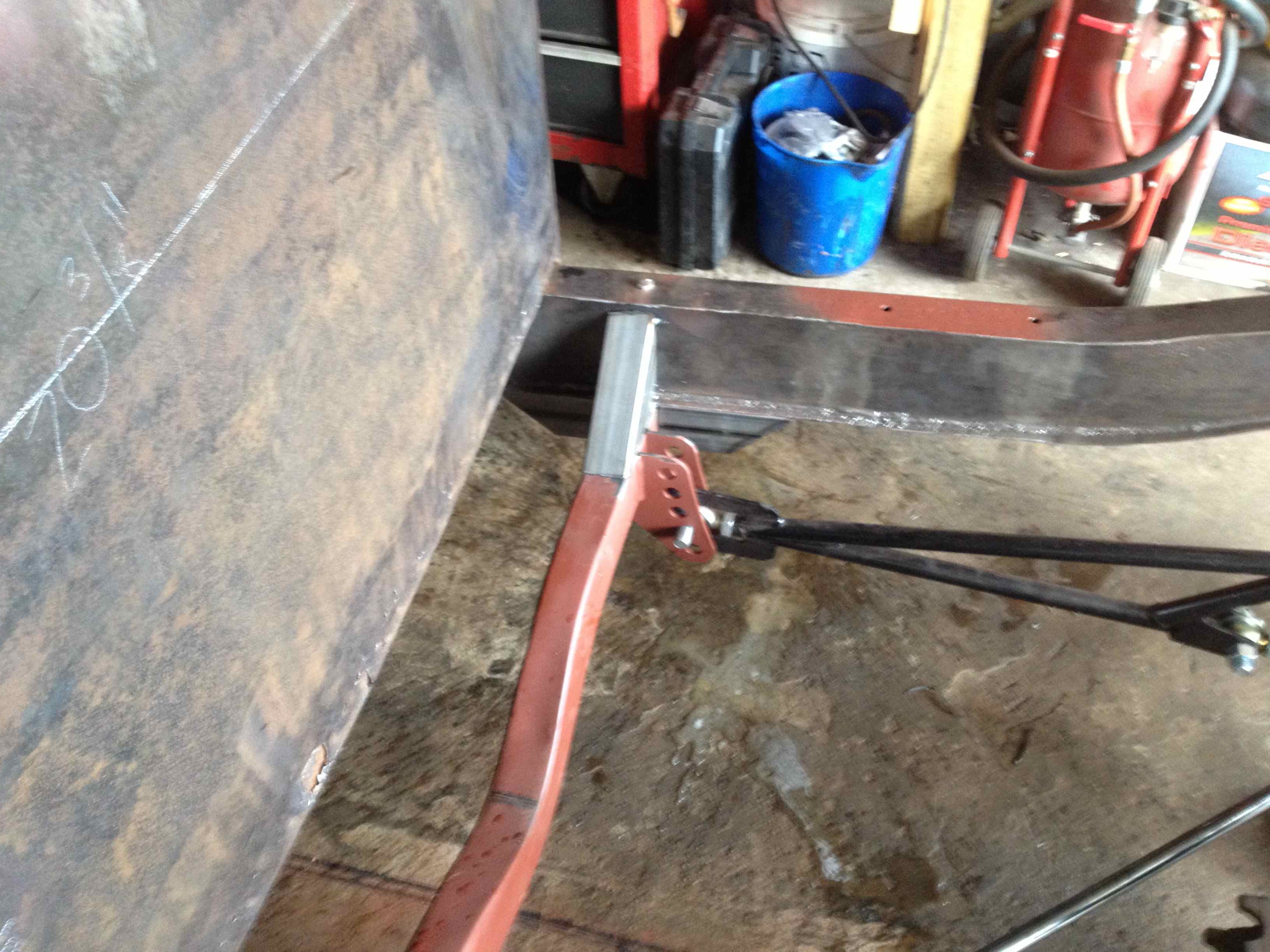

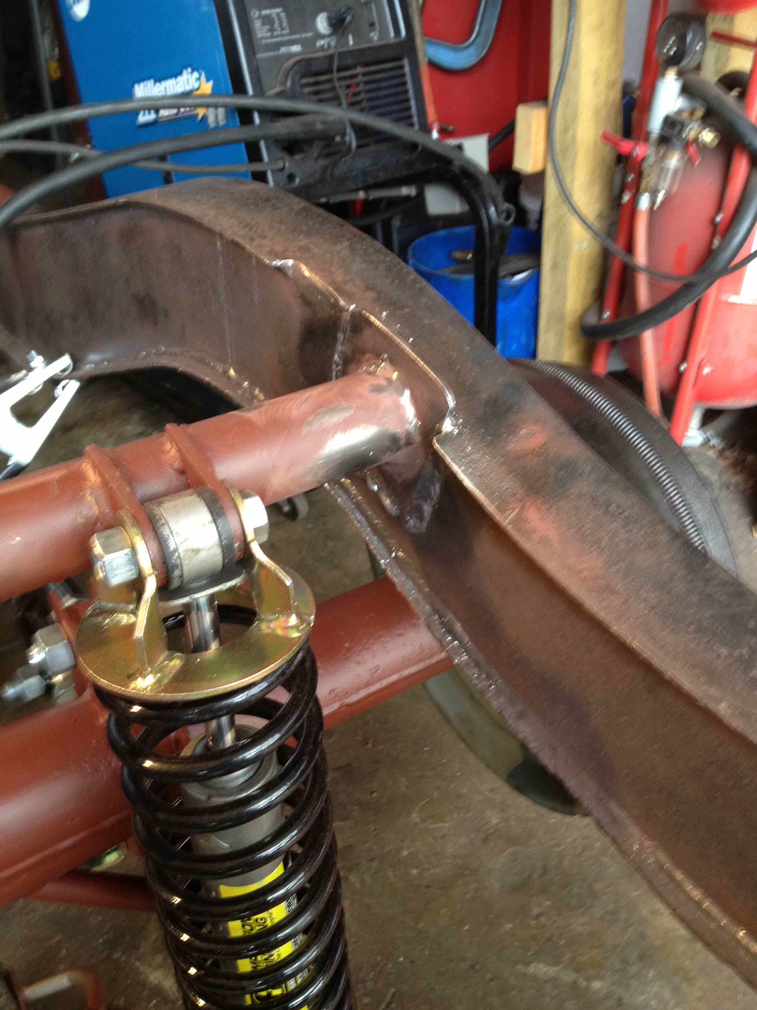

    Took awhile to figure the angles, but got the shock bracket gussets all done. The rear is officially done. If I could only say the same for the truck.

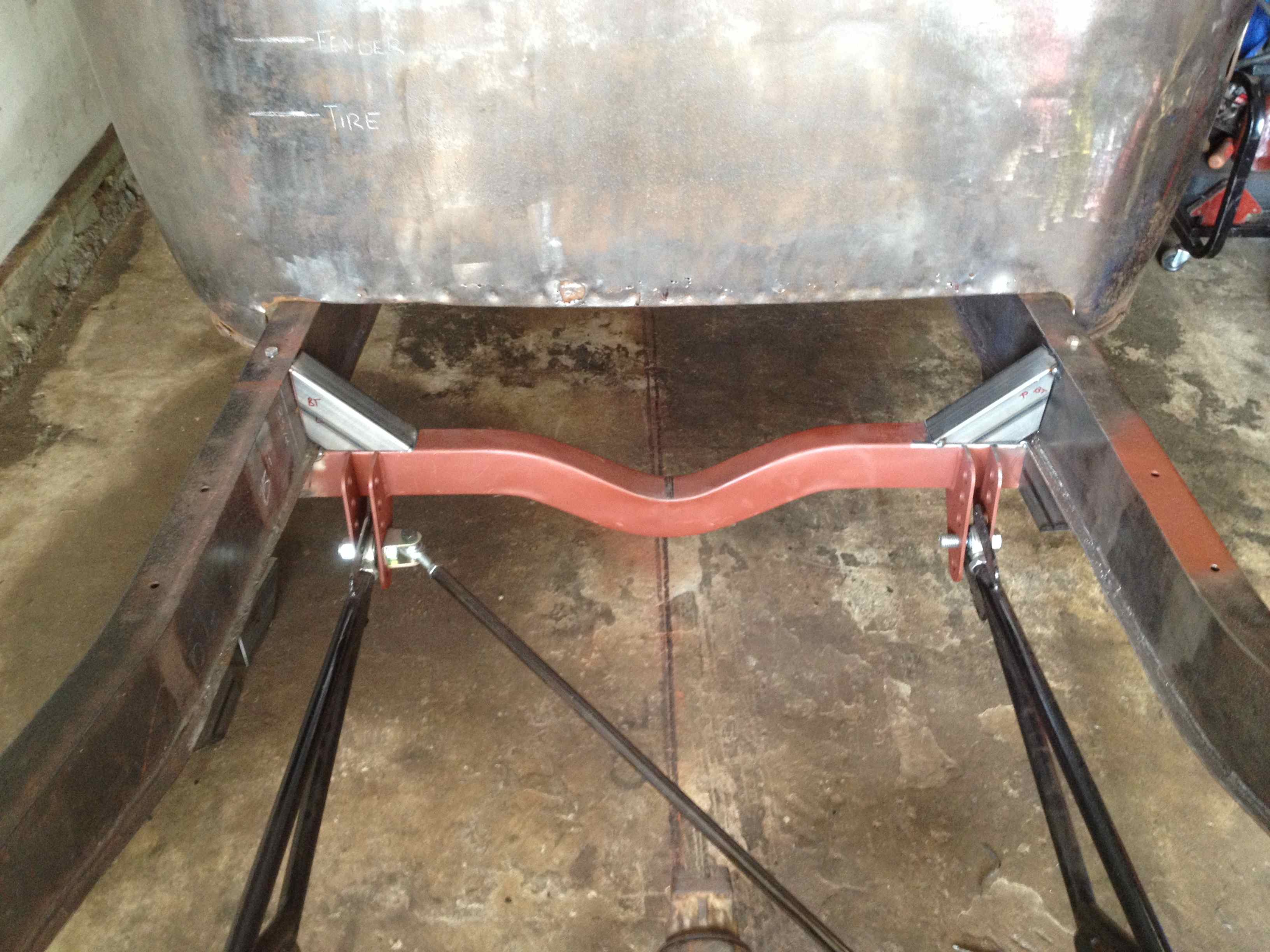

    IMG_0301.jpg IMG_0302.jpg IMG_0303.jpg IMG_0304.jpg IMG_0305.jpg IMG_0306.jpg Another quick update:
    You didn't think I was going to leave that ladder bar crossmember like that did you? I may be dimwitted, but not that dimwitted. I got the gussets all cut out and got the right side tacked in. I ran out of time to tack in the left side. To finish it off, I'll final weld all the gussets to the crossmember and frame, and then fish plate over everything and about 3" up the frame with 1/8" sheet to really tie it together. Should be no worries after that. Here's some pics so you get the idea.
