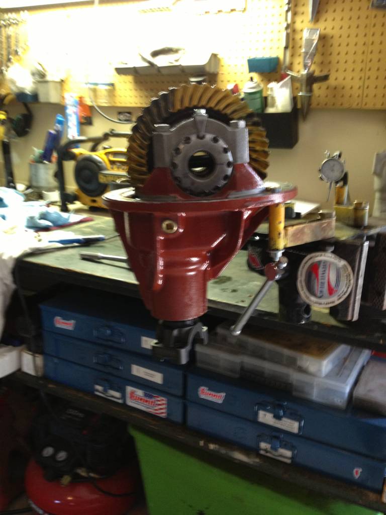

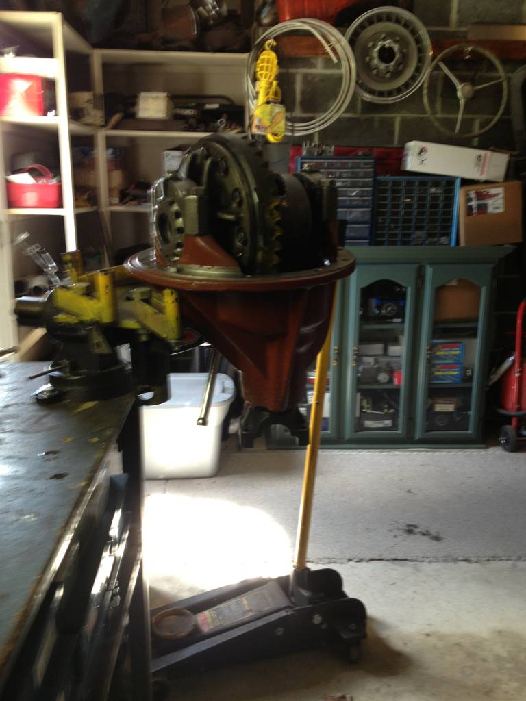

    Big day! Finally finished the third member. It busted my balls from start to finish including the bolt breaking on the locking tab. But it's finally done. Moving on.

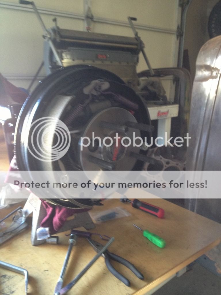

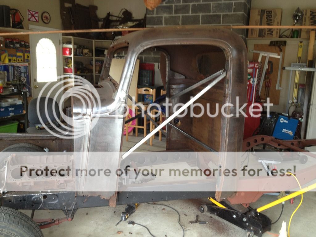

    Finished the brakes on the rear and ****oned it all up. One thing that's ready to roll down the road.
    Then, I braced the cab up and took the floor out for repair:

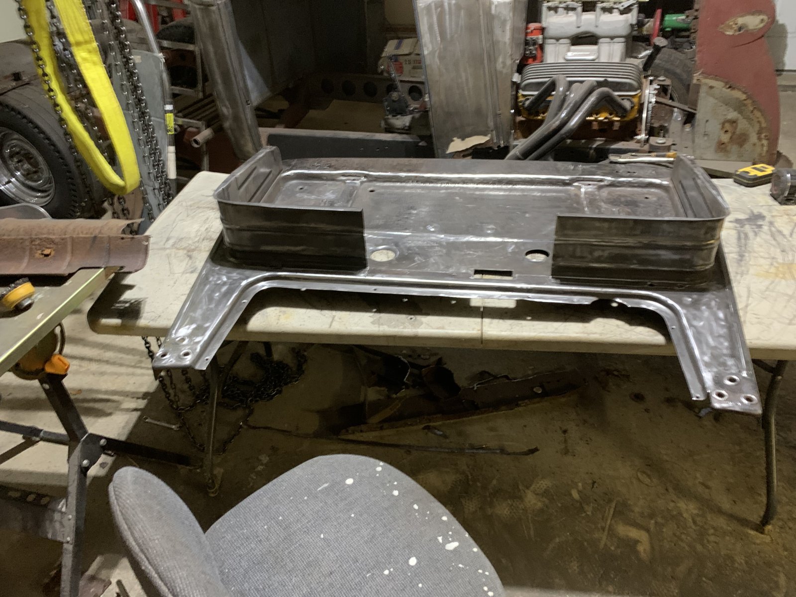

    Got some time in the garage today. Finished the section of floor where the cab mounts in the rear. The old section was cracked all over and missing a large section of metal. Now, it looks like this:
    Not great, but not bad for a hack like me.

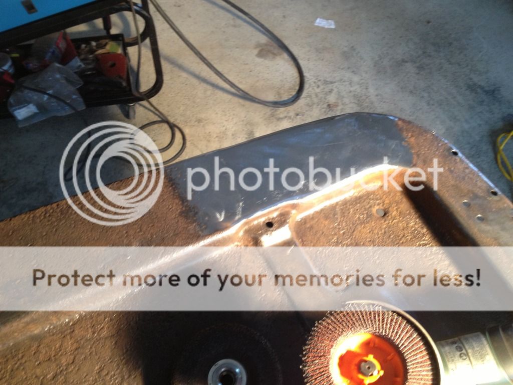

    In order to put the floor back in, I need to patch the area where the floor is spot welded to the cab. I got the patch cut, but still needs to be trimmed, welded, and worked.

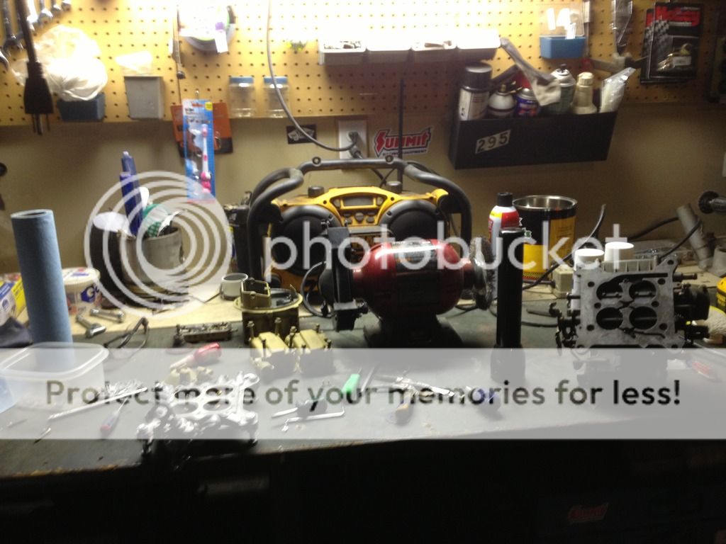

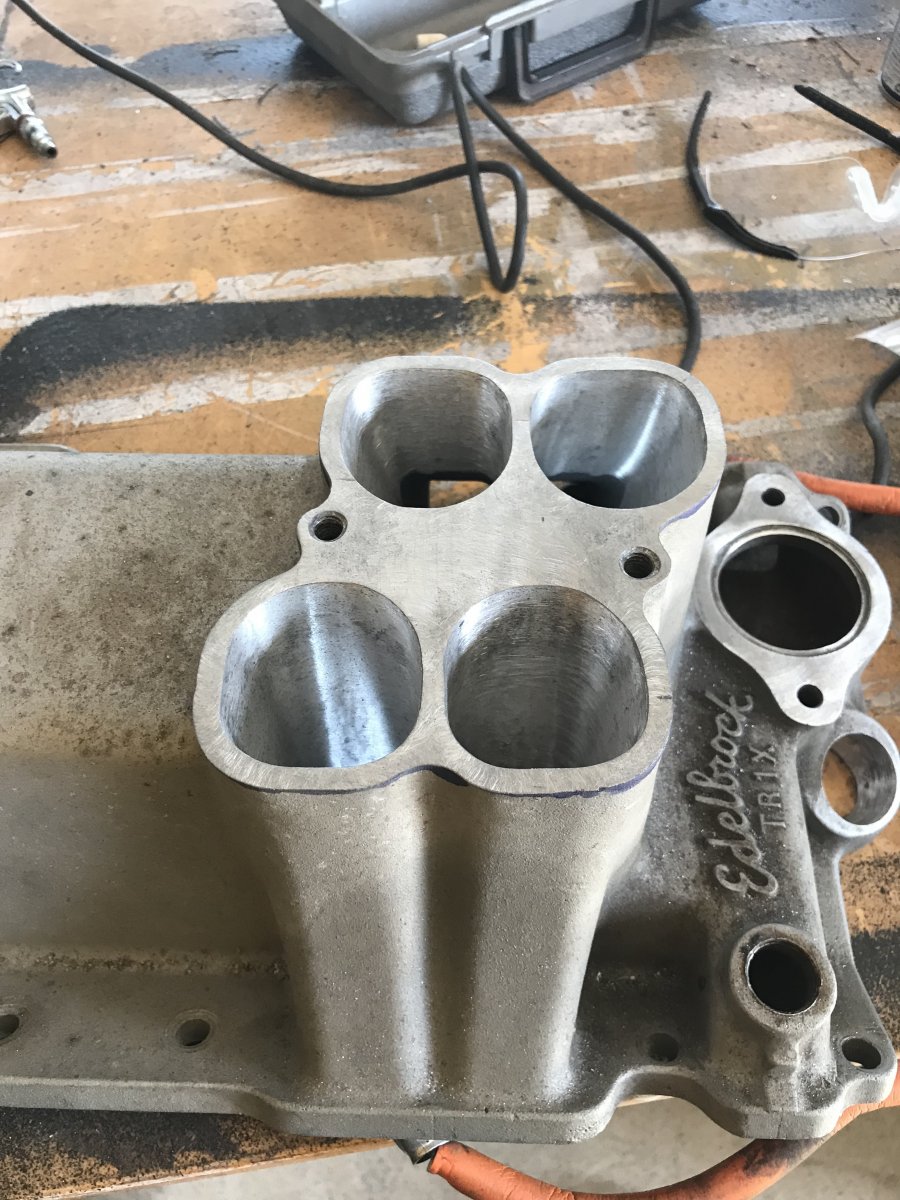

    I haven't quit yet. Started doing some engine work. Figured I'd start from the top and work my way down (because I do everything backwards). I rebuilt the two Holley 1850's that will sit on top of the Edelbrock TR1X, and because it seems totally logical at this stage of a build that is taking forever, I started to gasket match and clean the ports of the manifold. Oh, and a cab in much better shape then mine popped up locally. Should save me loads of work. Already have that almost stripped to bare metal. IMG_0535.JPG IMG_1033 2.JPG IMG_1783.JPG IMG_8156.JPG IMG_0241.JPG IMG_2121 2.JPG IMG_7877.JPG

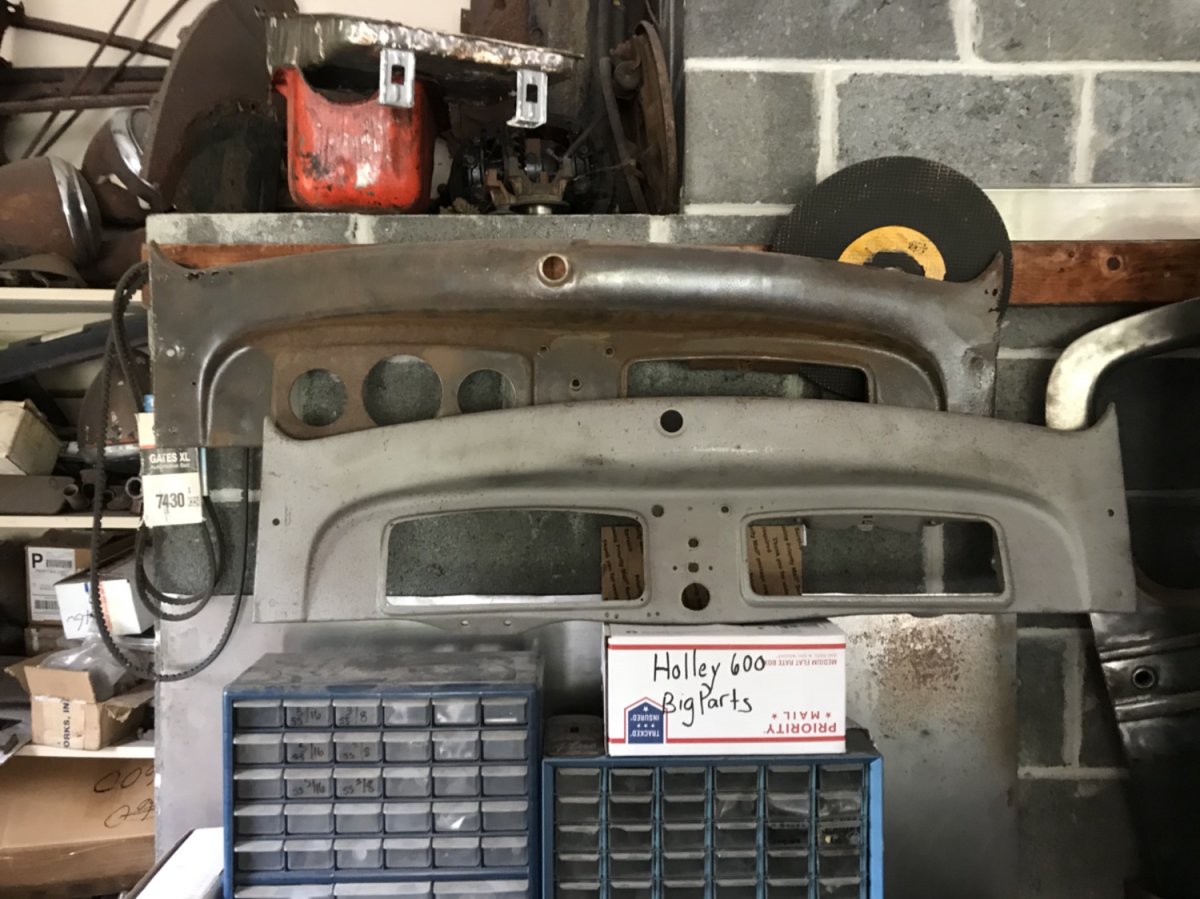

    Didn’t come with a dash. Bubba55 sent me one without the gauge panel thats in nice shape otherwise. My original is complete, but a lot like Swiss cheese. The truck was under a blue tarp (worse thing for these) for years with pine needles and dirt trapped in it, so all the window areas have big holes and rot. Very happy with the new cab though.

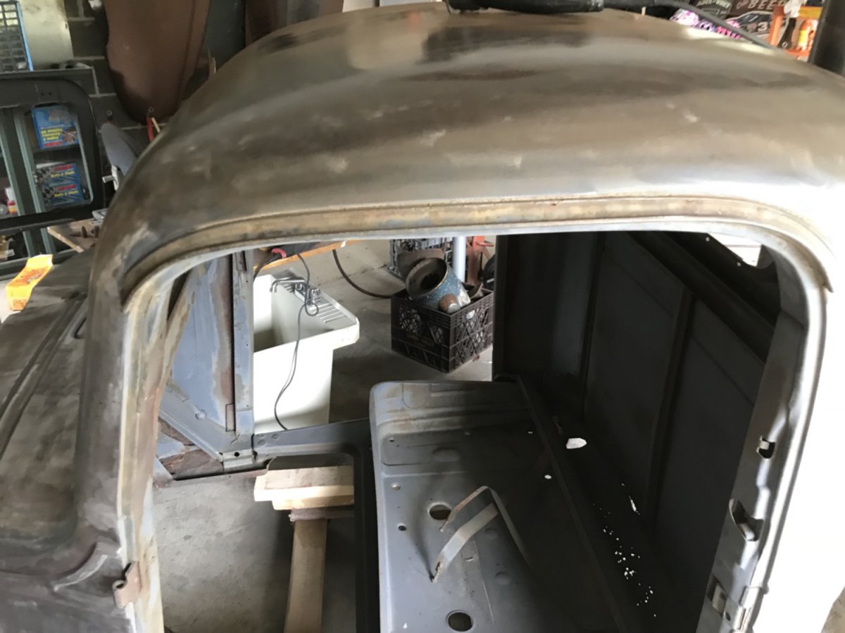

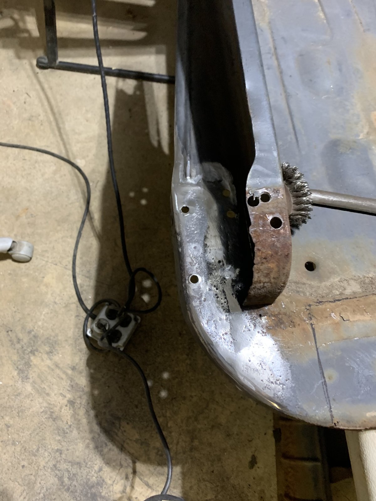

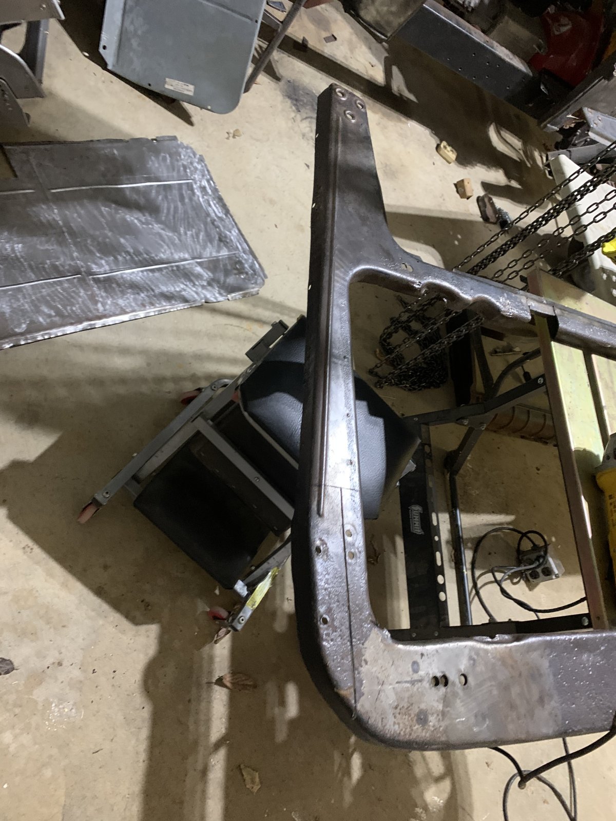

    Wow...not a post on this thread in over a year. Somebody's slacking (it's me). The other thing I noticed looking over the thread this morning...I suffer from severe project ADD. I've started a lot of different things that still have not been completed. So I decided to add on to that theme by starting something new. I finally got my garage cleaned up (projects from my business have completely taken over my space and left sawdust everywhere) and got to work further destroying my piece of history.
    Started by removing the original cab and placing the new one I picked up:

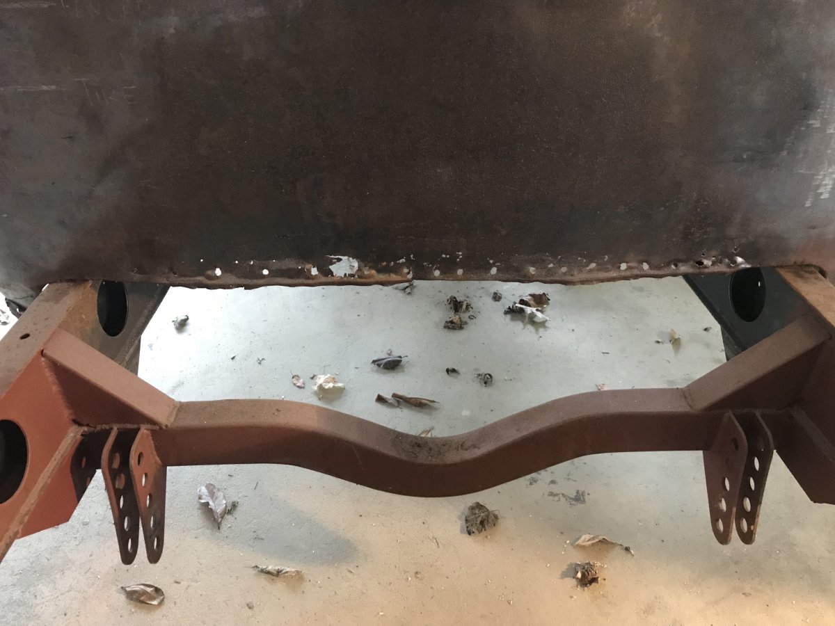

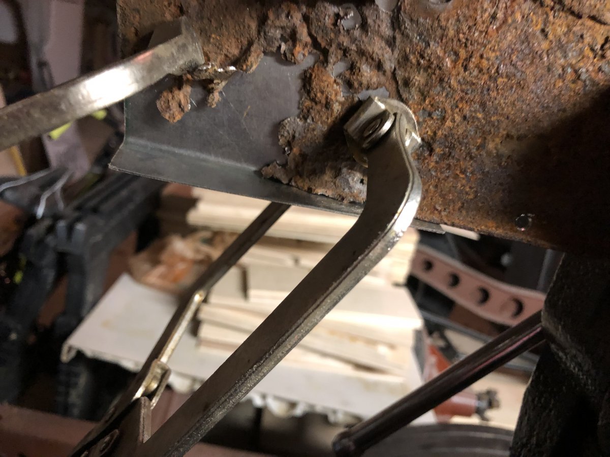

    Then, I started by removing the right side lower cab mount leg and foot because they were pretty rotten:

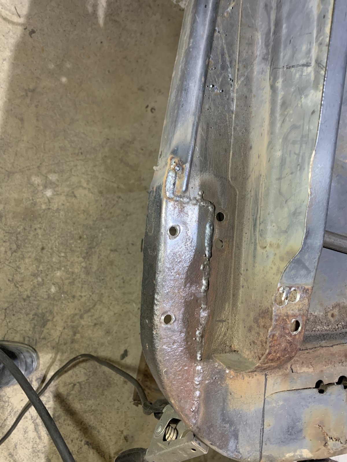

    It was really the front of this mounting foot that was rotted, so I decided to only replace that part. Bent up some 1/8" angle in the shape of the original, cut some 1/8" plate to fit in the middle, then welded it up:
    I pirated some of the pieces off of the other cab that were in better shape and will use them to finish this up. I think I have photos of me fixing them up, but have no time to post them now. Maybe tonight? Maybe next year?

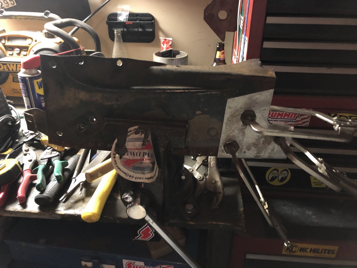

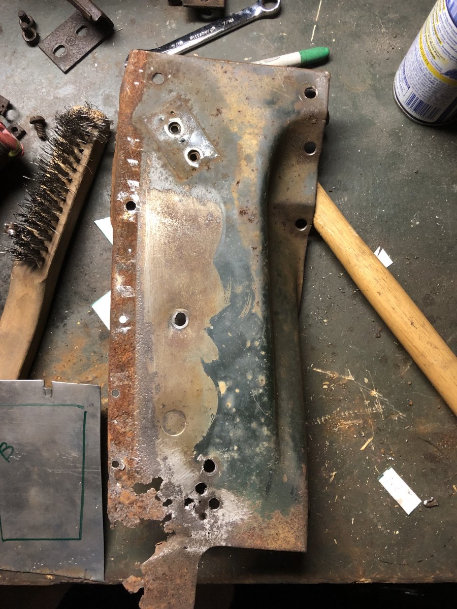

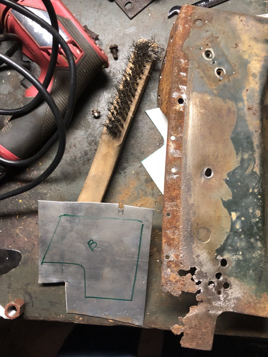

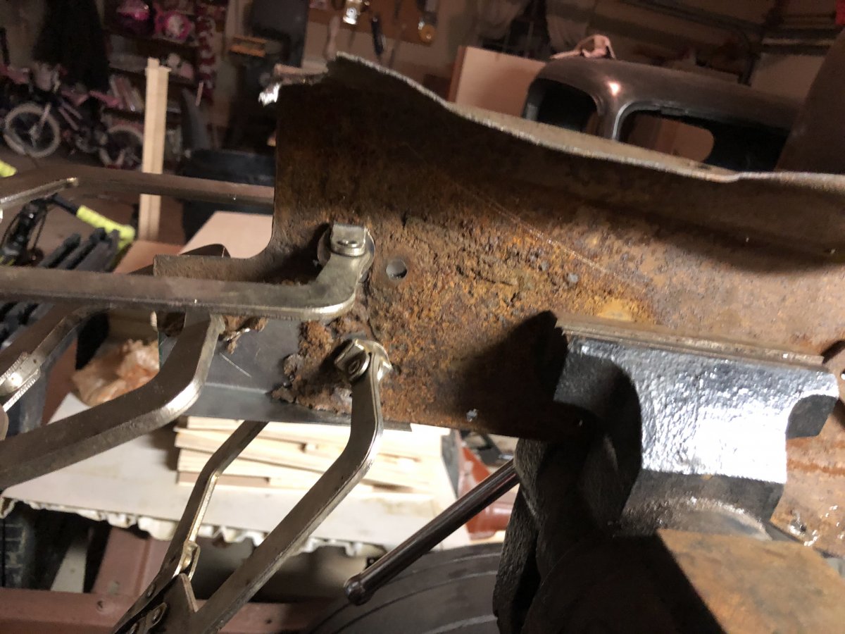

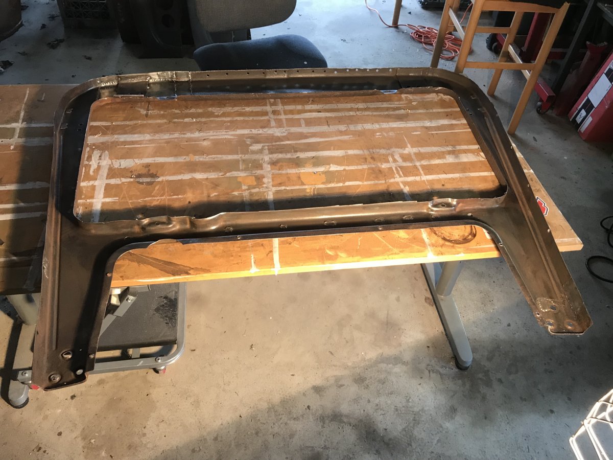

    Two posts in one day! Thats more than the last two years combined! Anyway, I found the pics of the parts I pirated off the other cab. I fixed up the right one a bit, the left one is in decent shape. I also needed the part that connects the cab leg to the cab foot, as both of the ones on the newer cab were shot.
    IMG_2796.jpg IMG_2795.jpg IMG_2818.jpg IMG_2796.jpg IMG_2795.jpg IMG_2818.jpg IMG_2817.jpg IMG_2816.jpg
    I did cut out the **** and weld the new one in. There are no pictures of that. I guess at this rate we should all be happy there are any pictures at all.

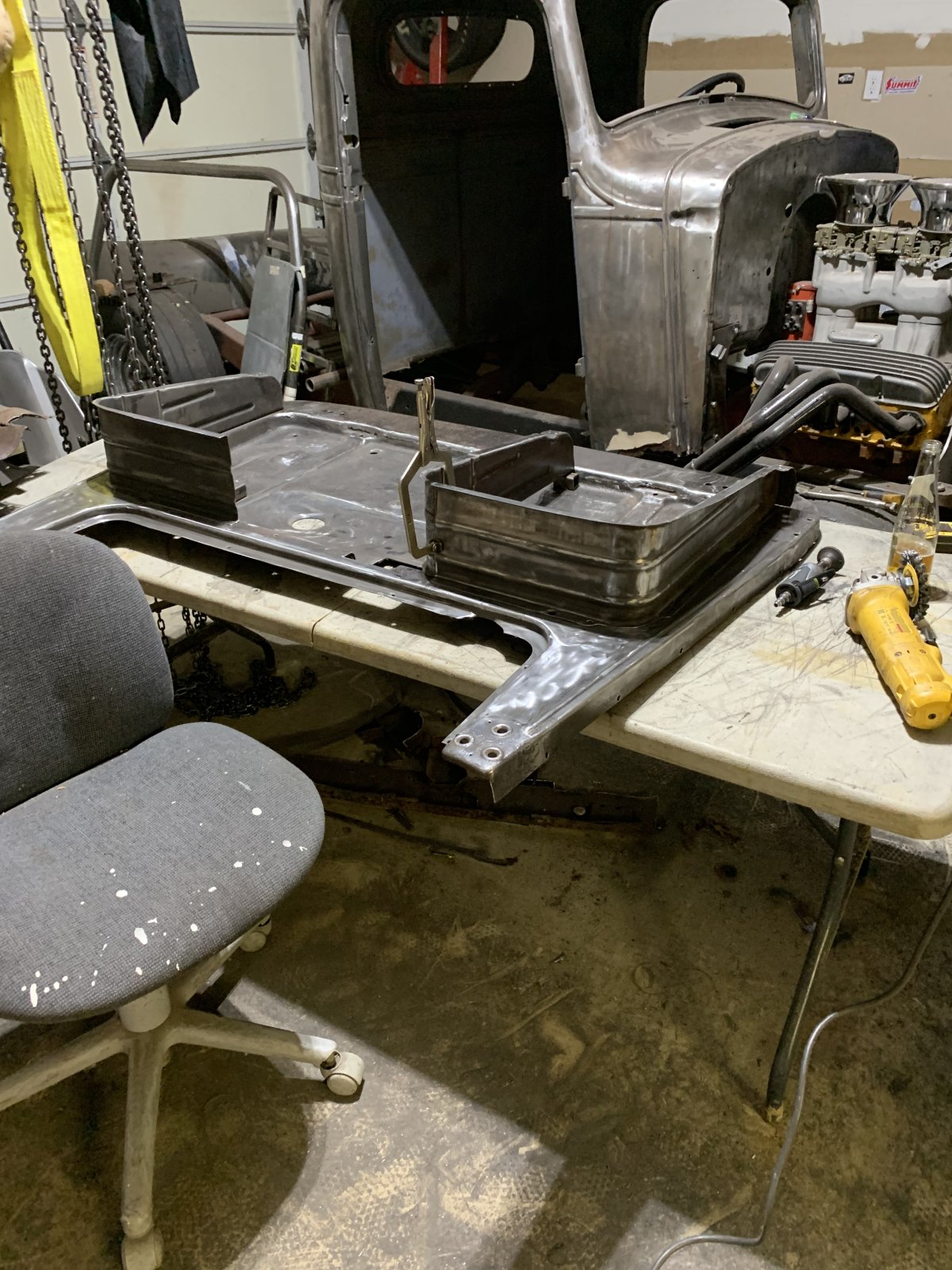

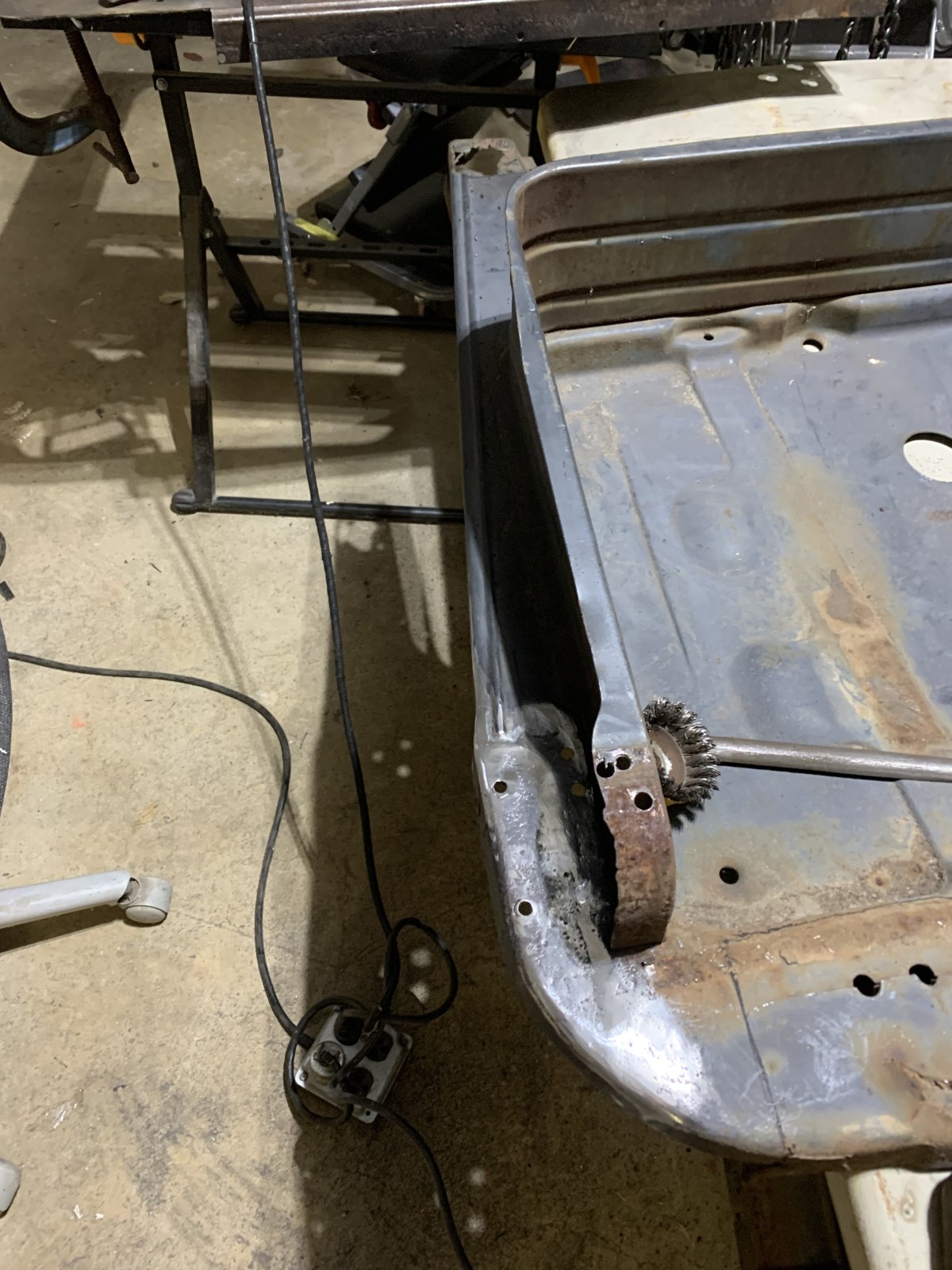

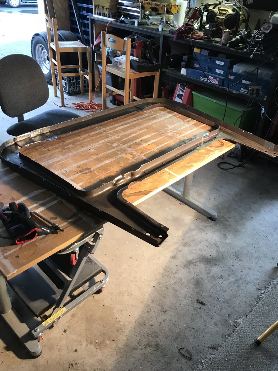

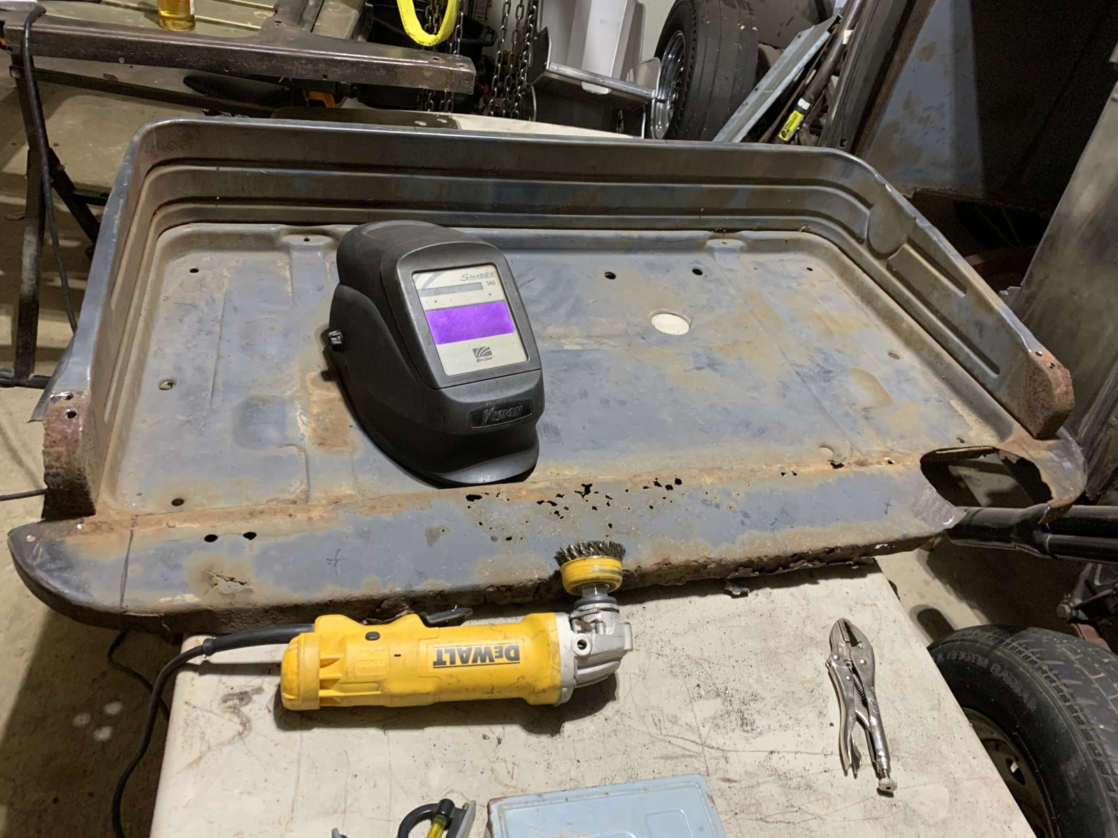

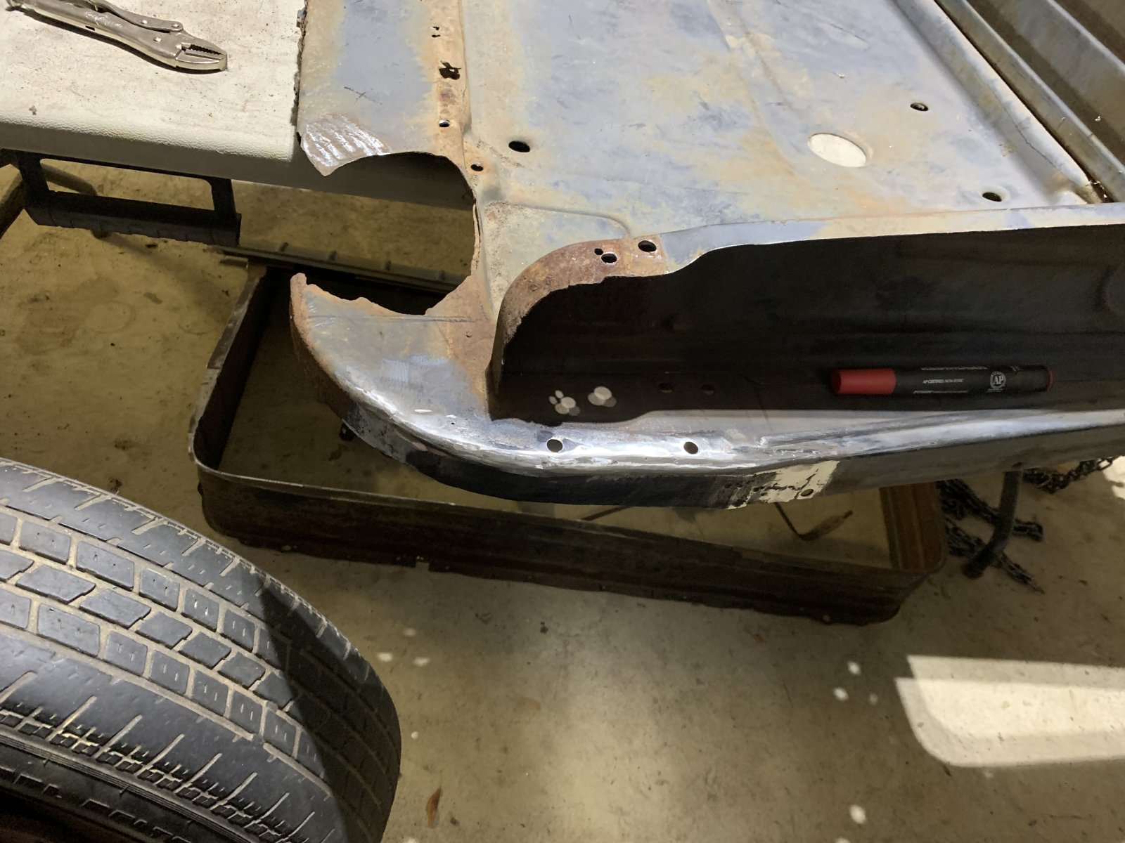

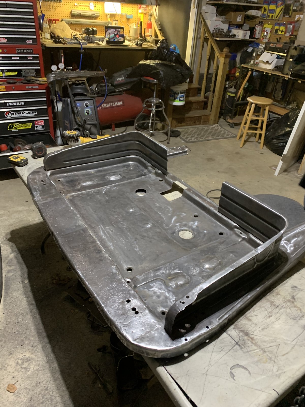

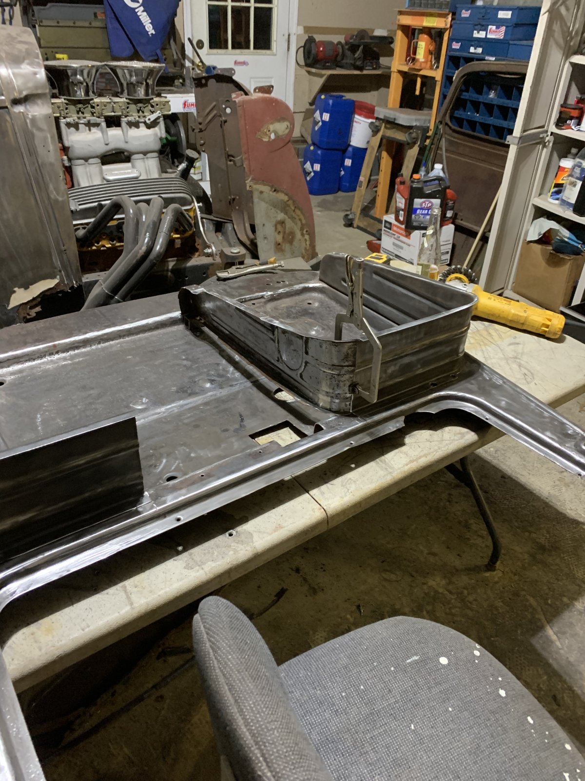

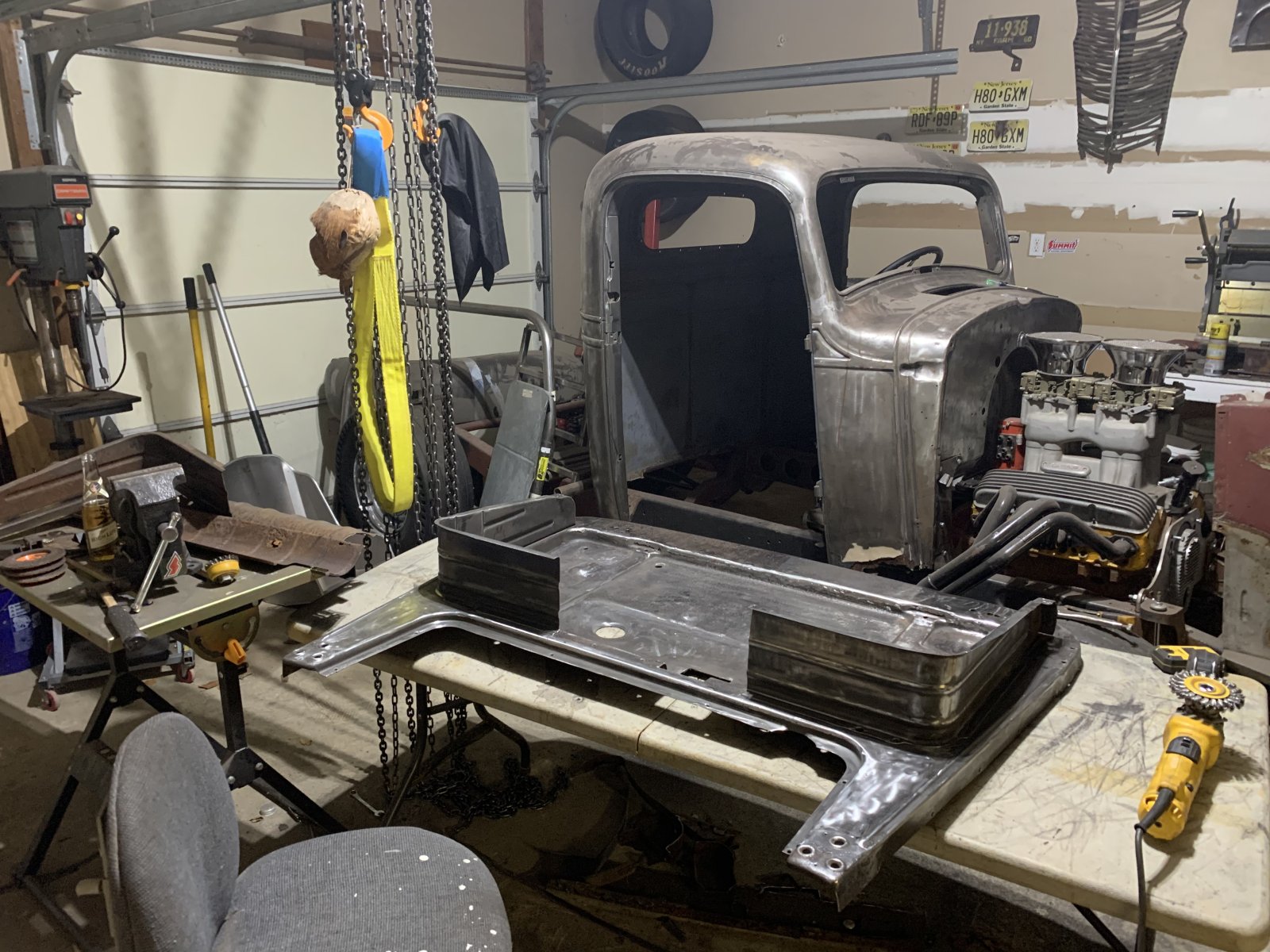

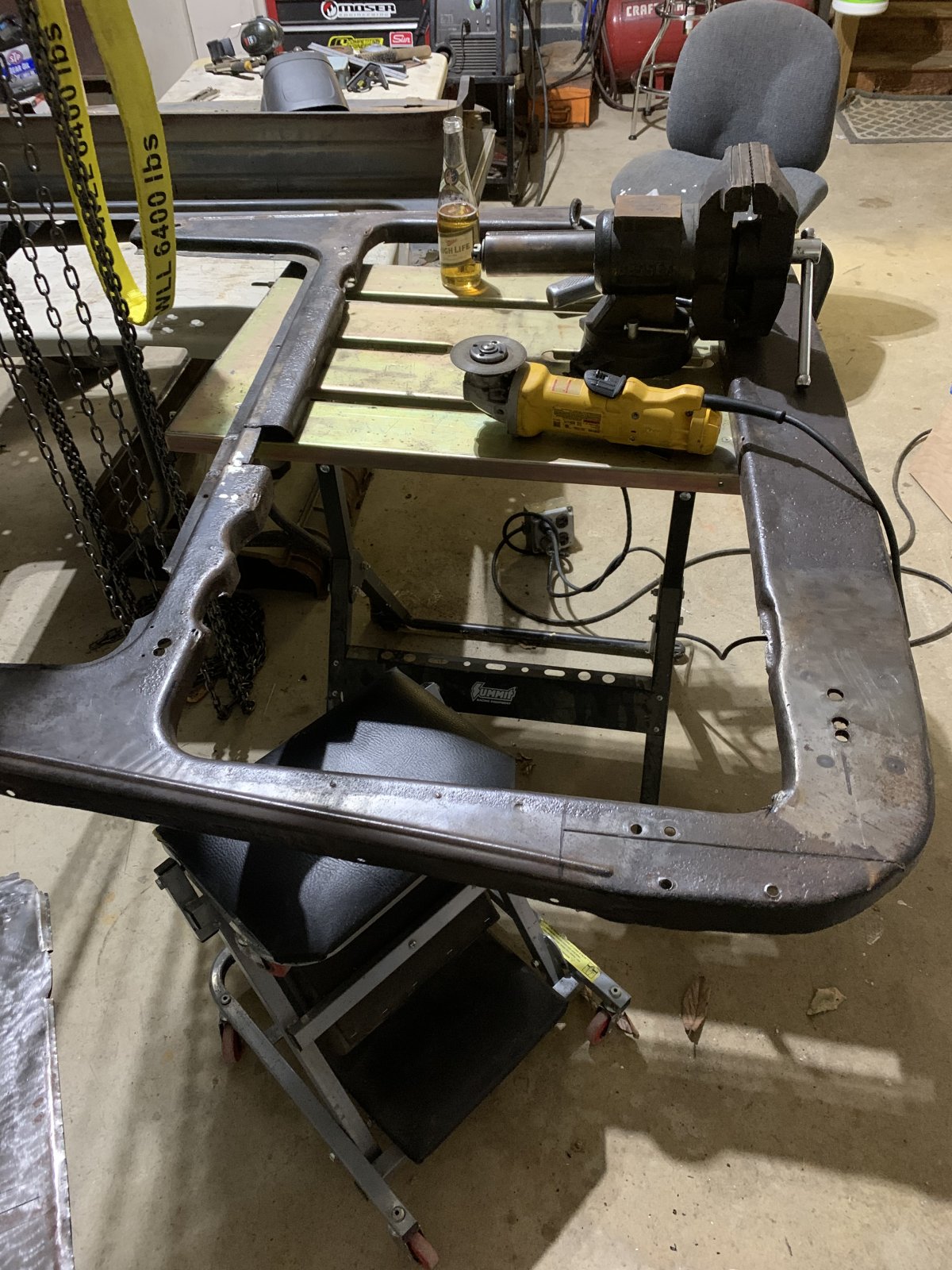

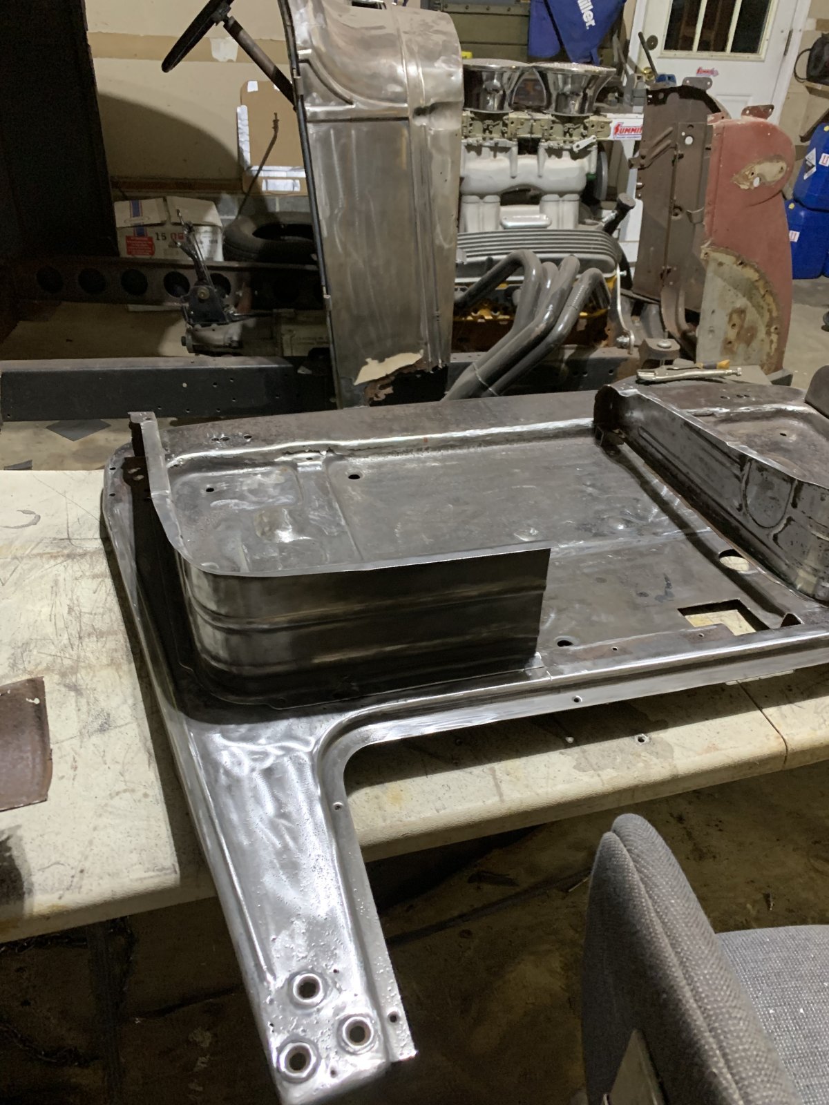

    Hi. I’m not dead. Yes…I still work on this heap. Hated the floor situation so I started all over. Using the existing floor and the extra I had around, I made one good solid original floor pan and cut up the seat riser to accomodate the Kirkey seats I’ll be putting in. The challenge you ask? Stuffing an 8 pt roll bar and a ramrod shifter into a ‘30s truck cab leaves very little space for someone to actually drive. Doesn’t matter though…at the rate I’m moving they can just use this as my casket, no need for it to actually work. Welp, that’s it for this decade…talk soon. Here’s some pics to look at while you wait for my next update. 8D474FB2-F572-4F58-AA00-AA78B4EFB409.jpeg E8F2F745-5B96-4607-A88A-E2A976FD1E64.jpeg 55A3EBDB-2911-4F4C-A387-5CF8F1D6A9EF.jpeg 5AEB4B24-5D6C-4E9D-99AC-27B316EBF15A.jpeg 3A1872FA-DE7C-42E6-A767-9758C61FA764.jpeg 4C212511-859A-4CF3-910B-F835C1D1571B.jpeg A47F0589-76E5-4AB2-BA2D-24CEECDDDDE6.jpeg 325B2C10-536C-4B89-883B-42002D292523.jpeg 14F03AF7-E46F-4F93-B1ED-7B3B34482F75.jpeg 2418DF4F-FBAD-470F-B168-48E1453312CA.jpeg 97B4A5A9-E5CA-400C-8B47-3DF3E05CC853.jpeg F9CEFE87-1EC2-411F-8A1F-5D2864C52A15.jpeg AA5EC383-1968-4901-BC88-8B177B828518.jpeg 055D857B-7F7F-45A6-A662-884A2FC12C8C.jpeg FF00DA39-1C45-4D5C-8931-EF4AF66394CF.jpeg
