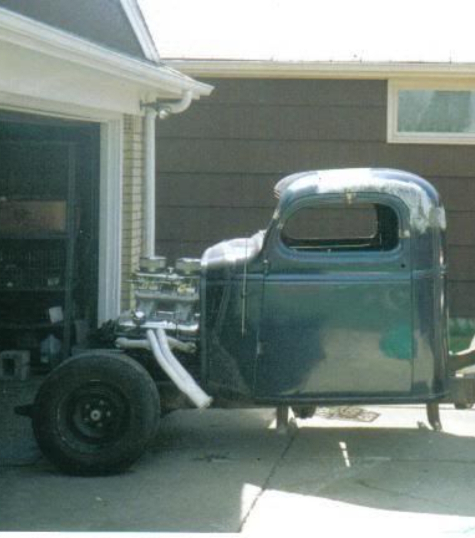

    What were those headers made for ?
    Kinda reminds me of my sbc days in my 41 but those headers you have look like they might work on my 57 pickup better than the tri-fives I have.

    They’re for a 67-87 Chevy truck. Schoenfeld makes them, part# 1346. 1 3/4” primaries and 3.5” collectors. They make them with bigger tubes as well. They fit pretty well, but the two highest tubes hit the fender, so yeah, I’ll be cutting the fenders up. Small price to pay for being an awesome mother f*****r.

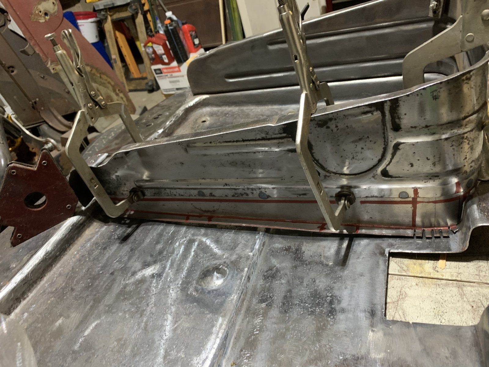

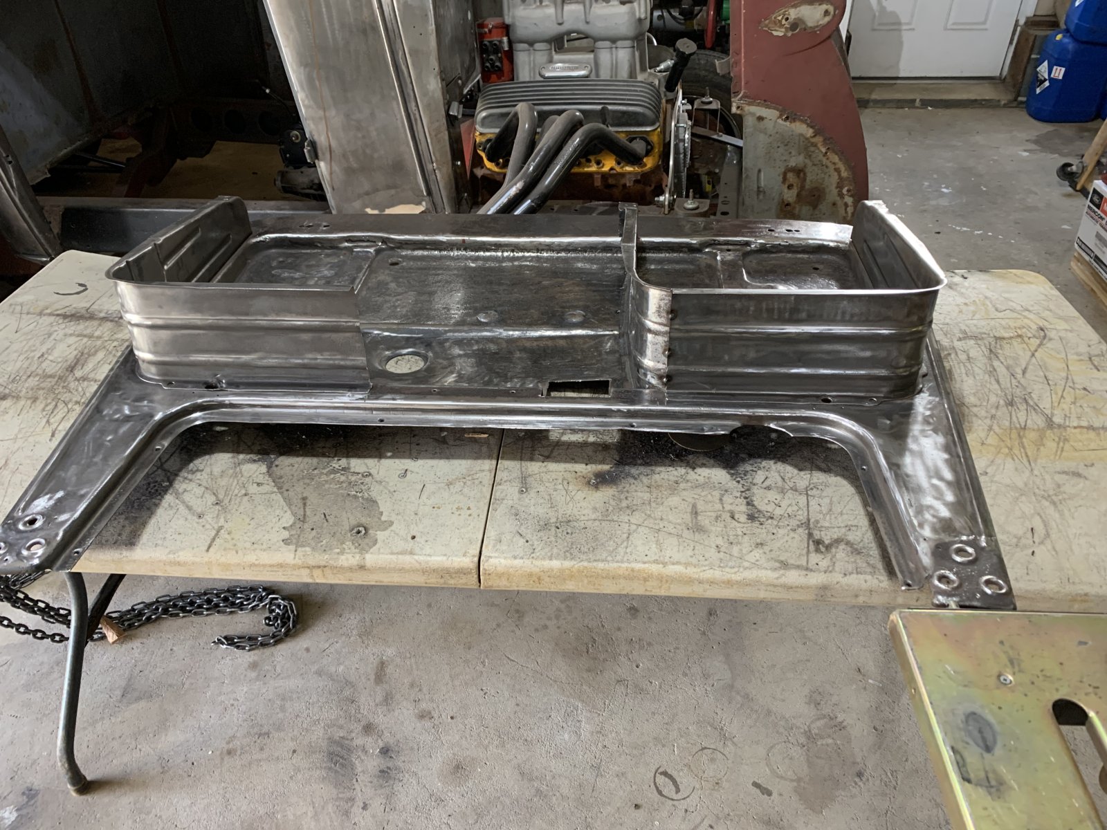

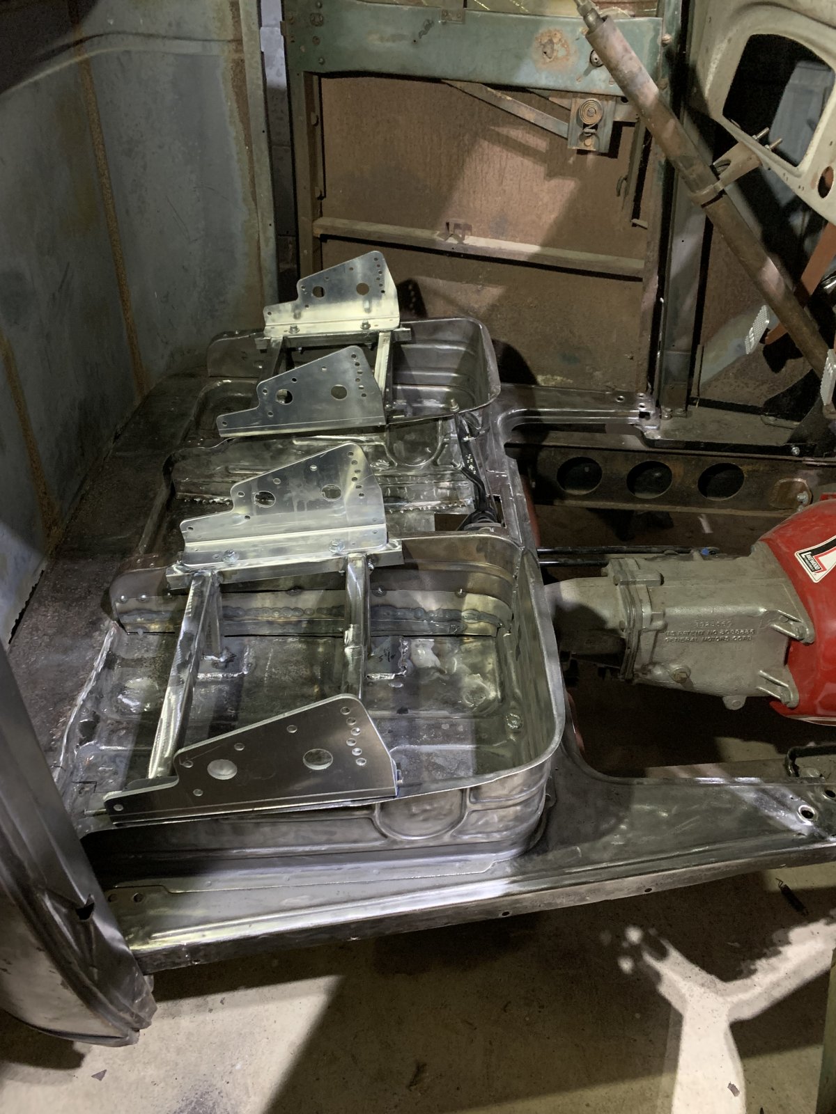

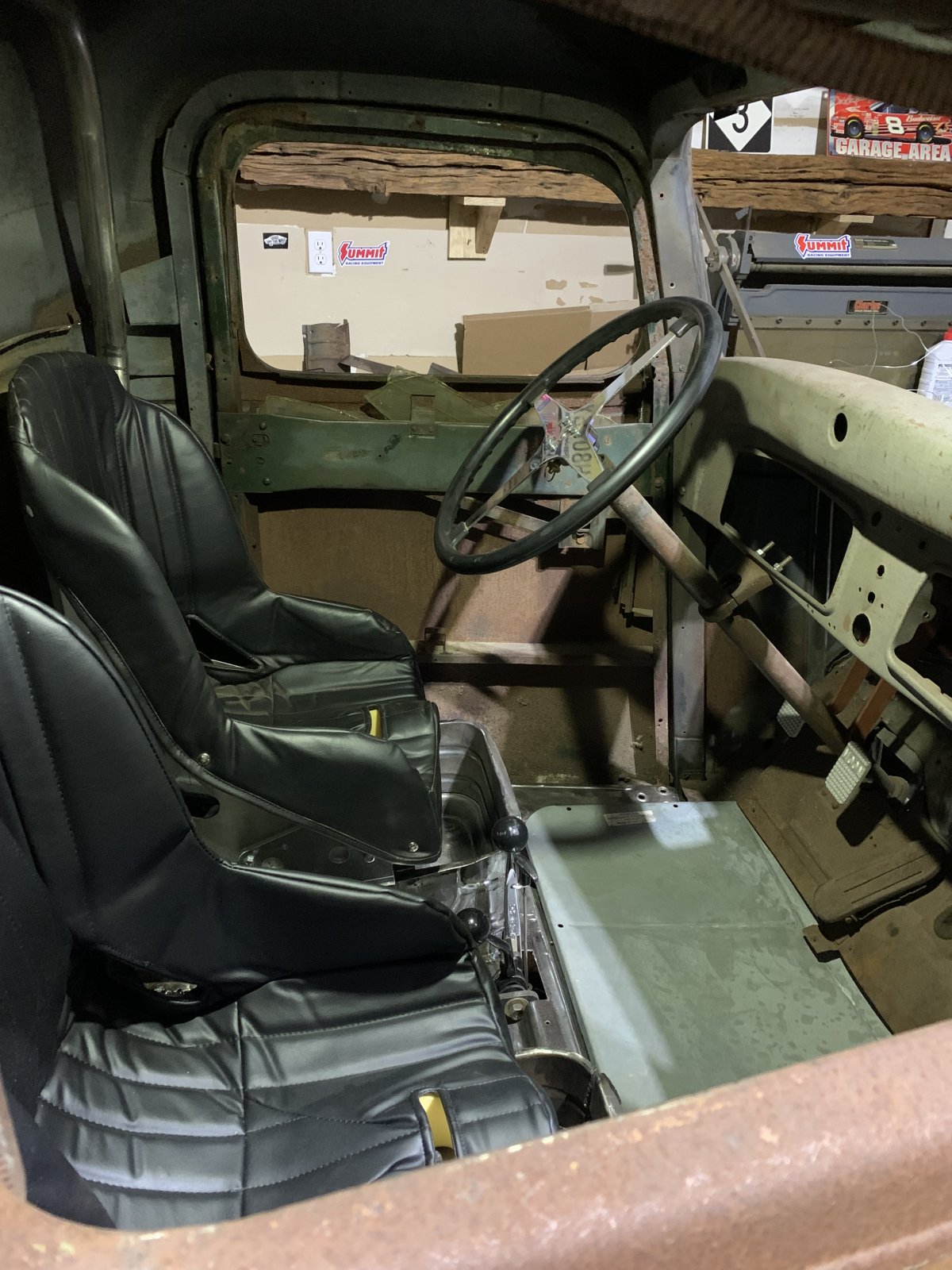

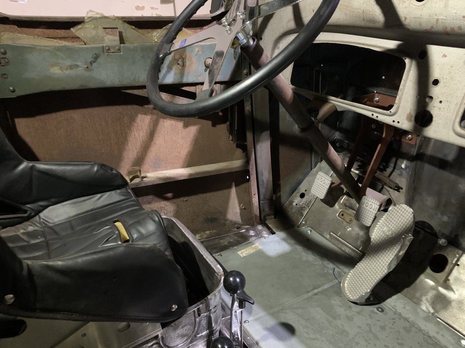

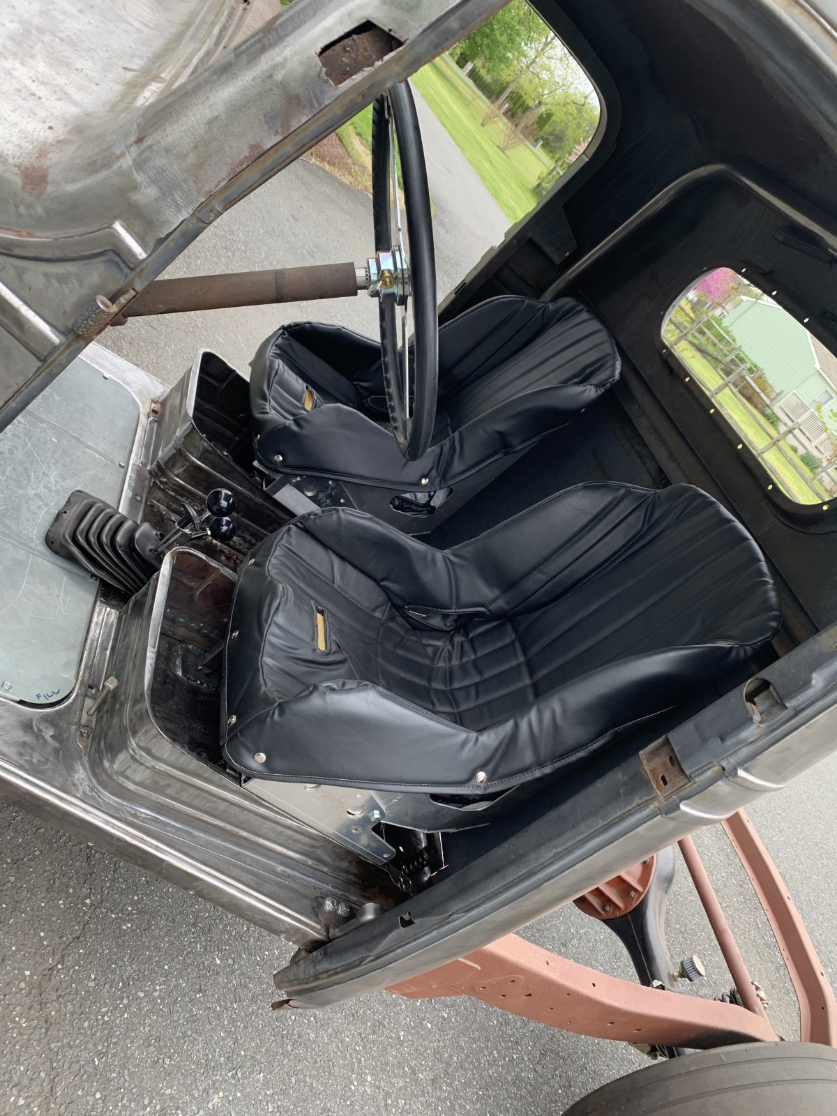

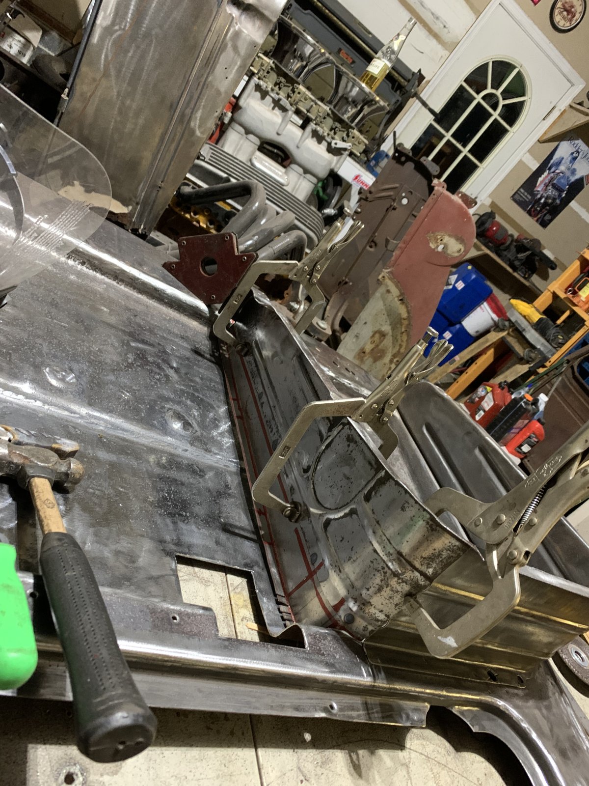

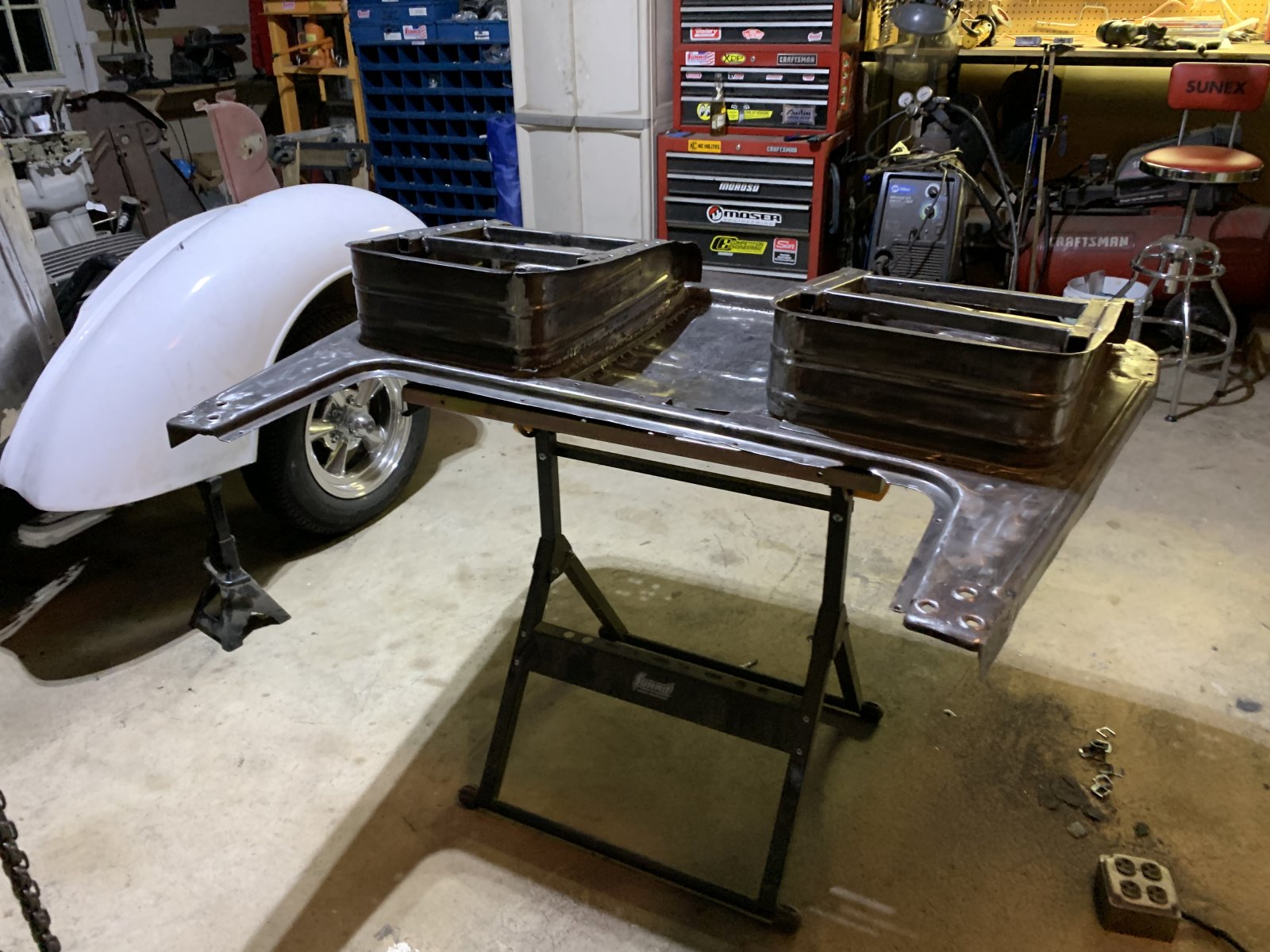

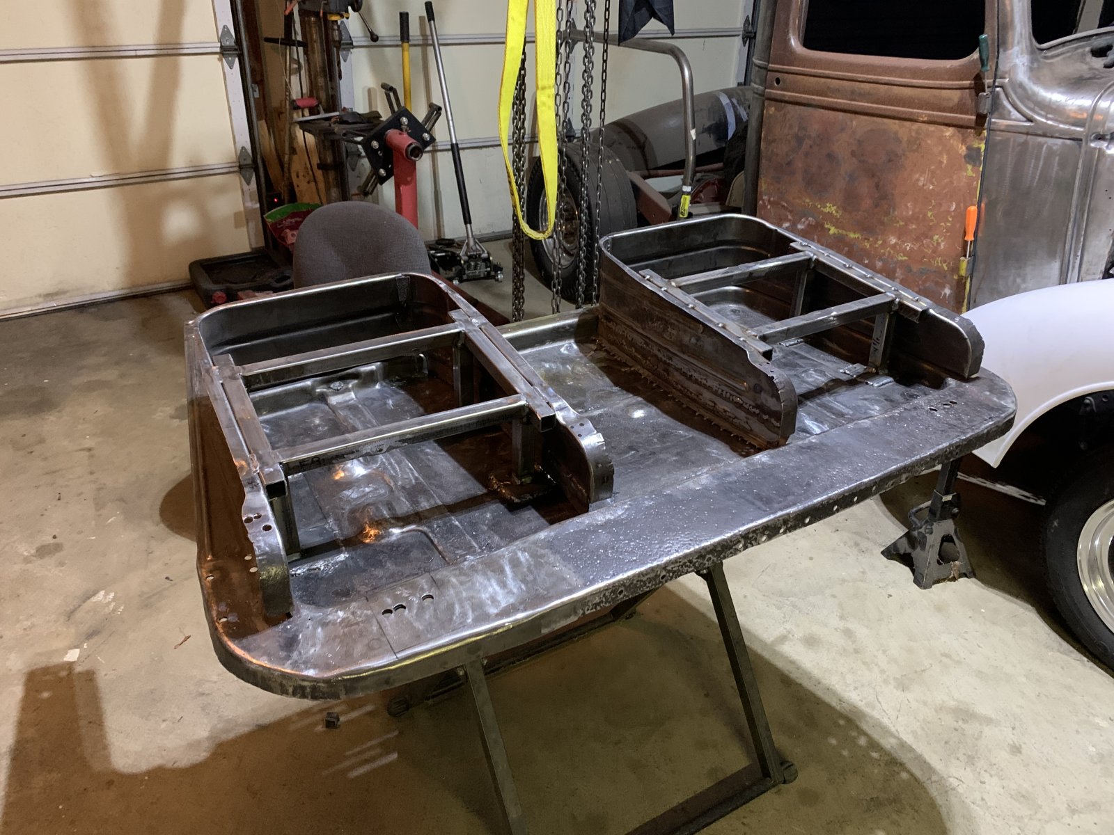

    Got one seat riser close to done, just needs a little more hot glue. Pics are a bit out of order. 2DAA7CC5-55C2-4B8C-9E9A-FD4BB6A3E336.jpeg D71409E3-218D-40BB-8B7C-4BE4F0943D26.jpeg 0475916D-8943-4890-8AE0-07AB20490AC9.jpeg D2910B8E-3D33-4958-B76D-7A6E86037F11.jpeg 04C844C1-9FB5-4792-9FF2-7E5079942C50.jpeg 14DE58B2-EEF1-4DC4-BF5D-23DAA24F690C.jpeg .

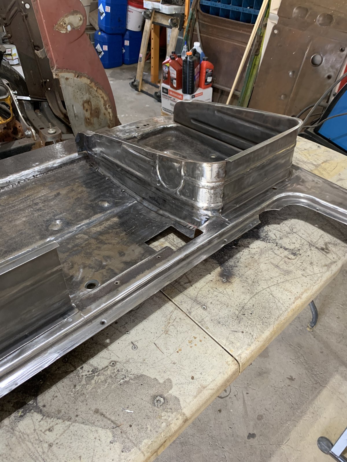

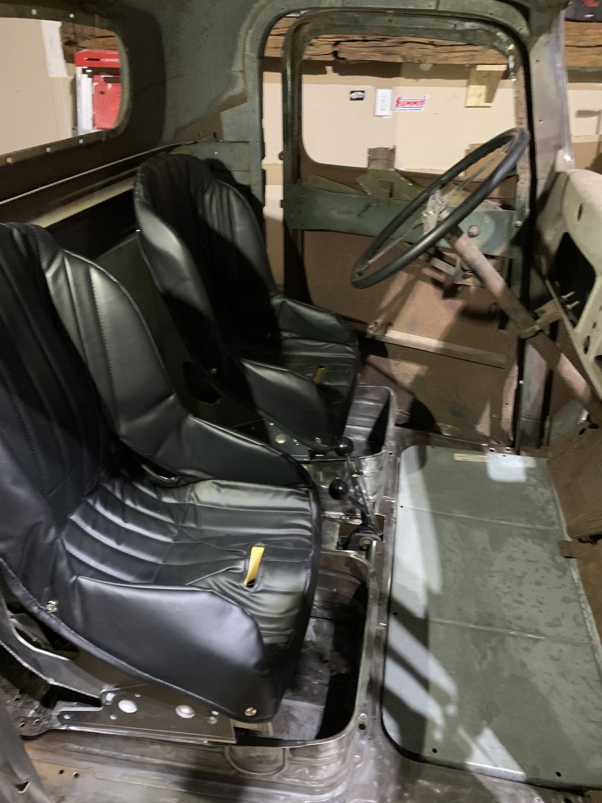

    IMG_4676.jpeg IMG_4678.jpeg IMG_4681.jpeg IMG_4682.jpeg IMG_4684.jpeg IMG_4687.jpeg One year later; I finally finished it! The seat issue that is.

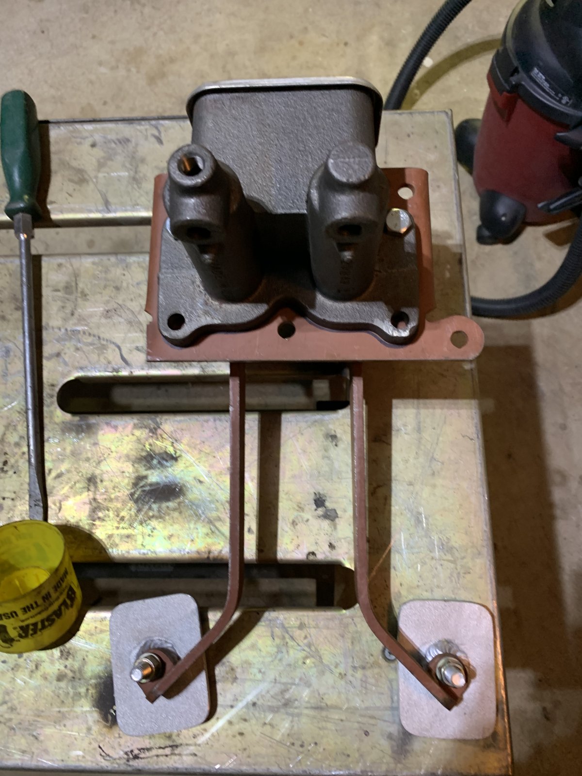

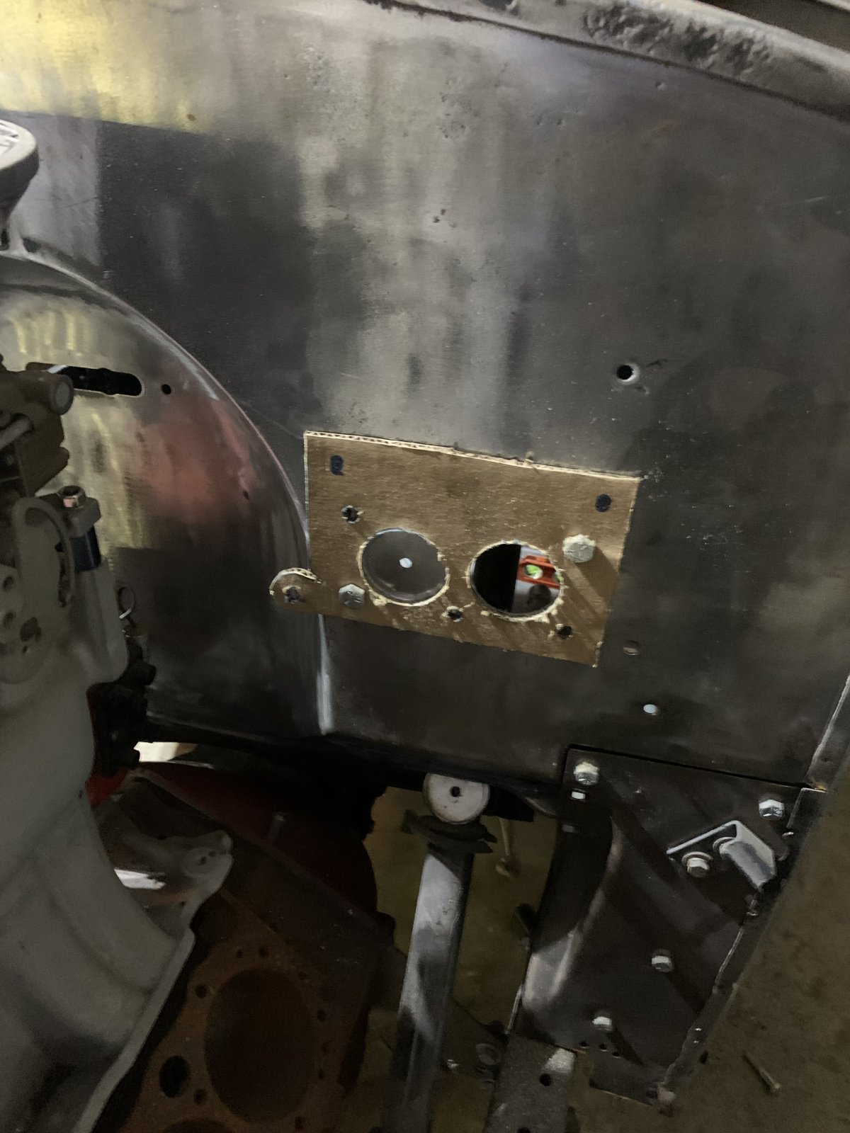

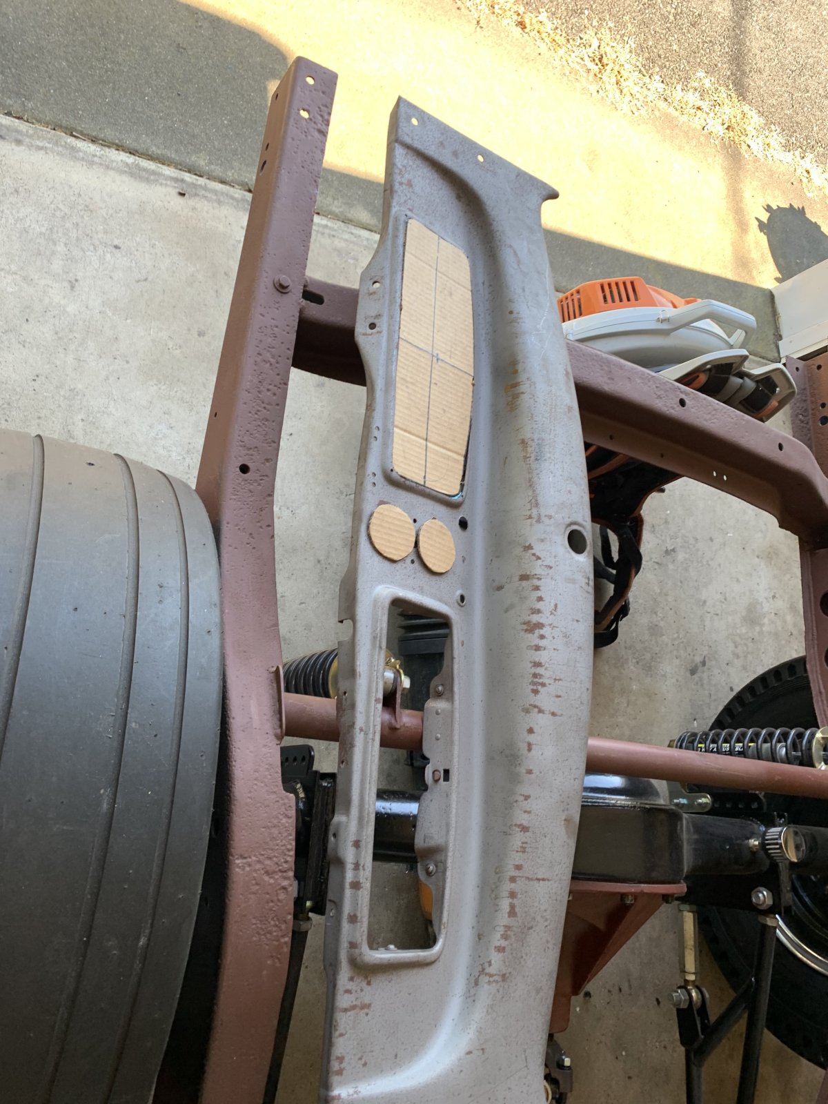

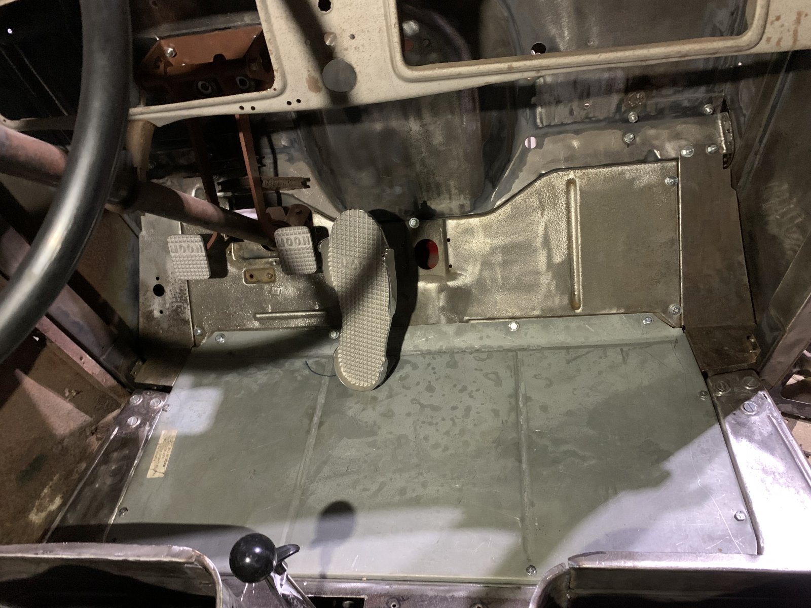

    IMG_4705.jpeg IMG_4701.jpeg IMG_4702.jpeg IMG_4703.jpeg Master cylinder mounted up. Made an 1/8” plate for between the pedals and firewall. Will add 3/8” rod from the plate to the dash later.

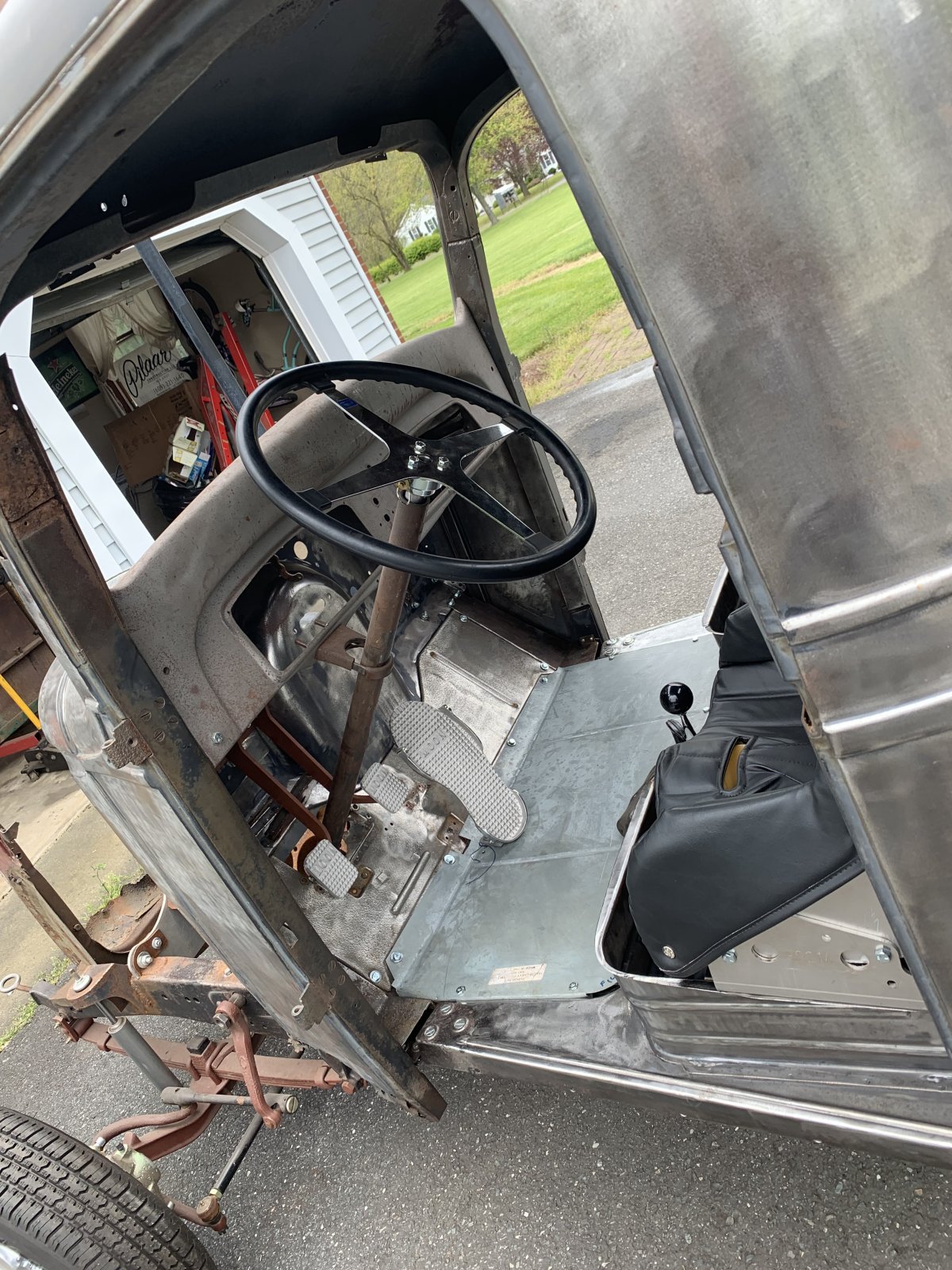

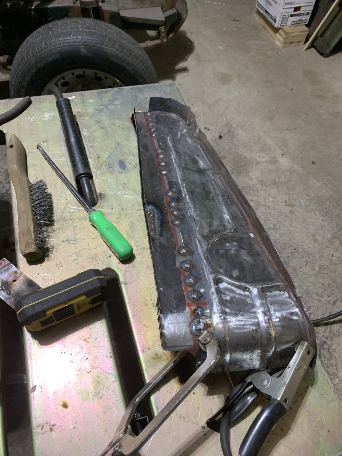

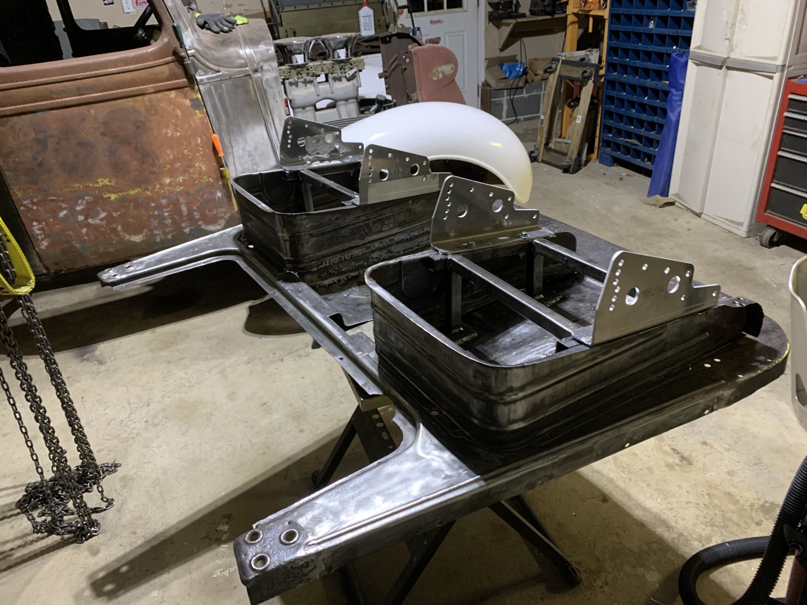

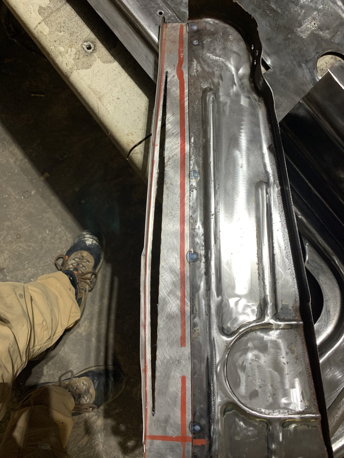

    Got some work in on the floor and pedals. Getting close to blowing it apart for prime. Also, got the engine block at the machine shop. Maybe this pile will make noise someday.

    I found after driving my '37 for a couple hours, my legs were going to sleep. I raised the front of the bottom seat for more support, ( factory bench seat ), it made a huge difference in comfort. Setting straight up with no leg support gets pretty old real quick

    Thanks Joe. I’ve been sitting in it quite a lot and it seems pretty comfortable. If needed I could always add a block to my seat frames if they need to be raised. The way it sits now, the seats are pitched forward so my legs are pretty straight.
    I do have a 41-46 box in it right now, I already rebuilt it as well.

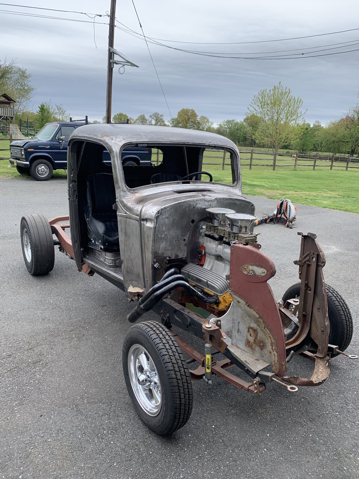

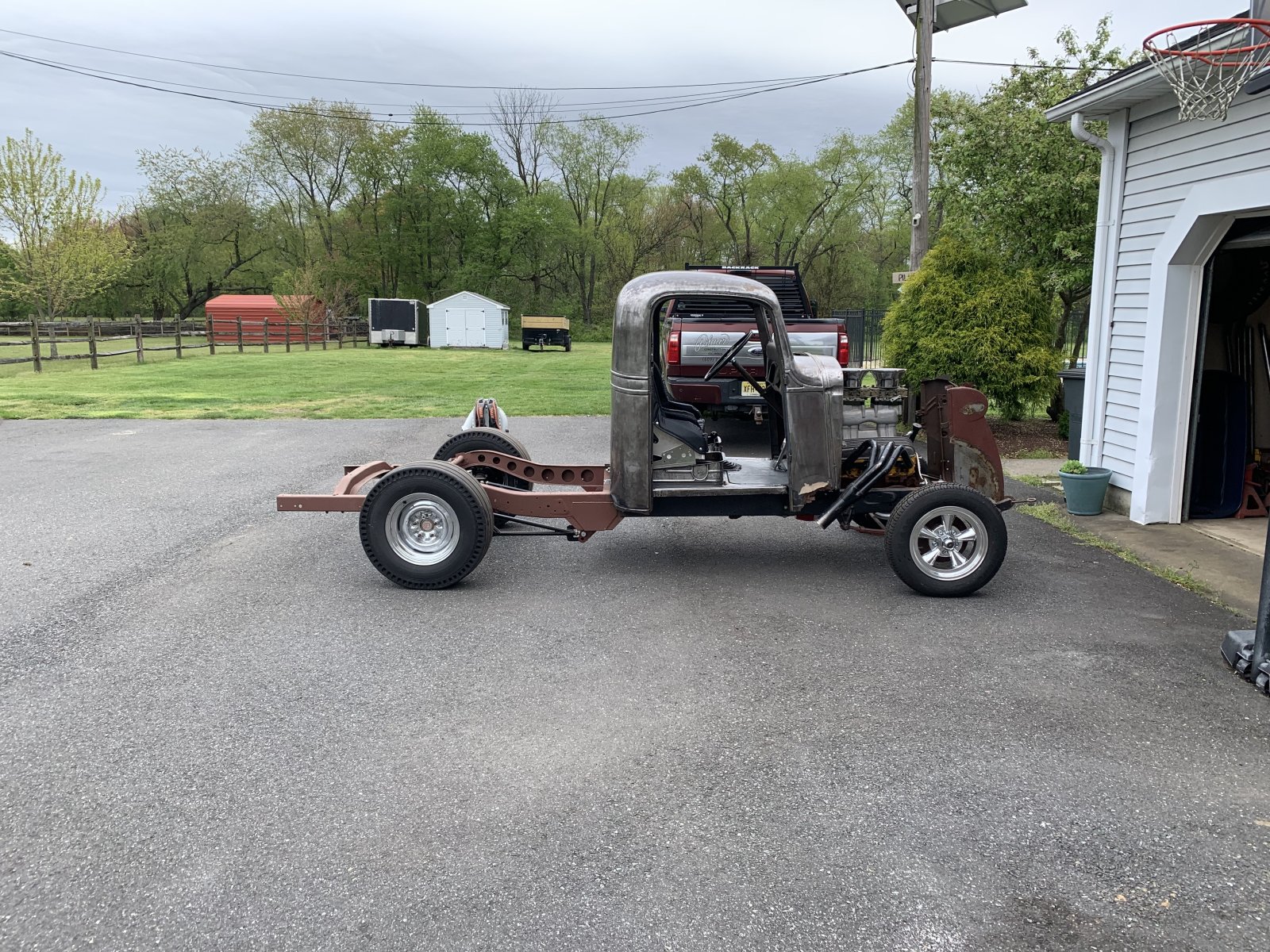

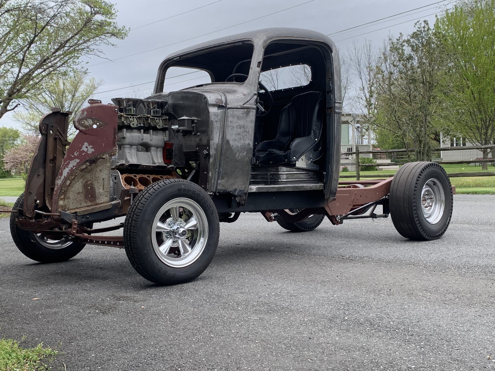

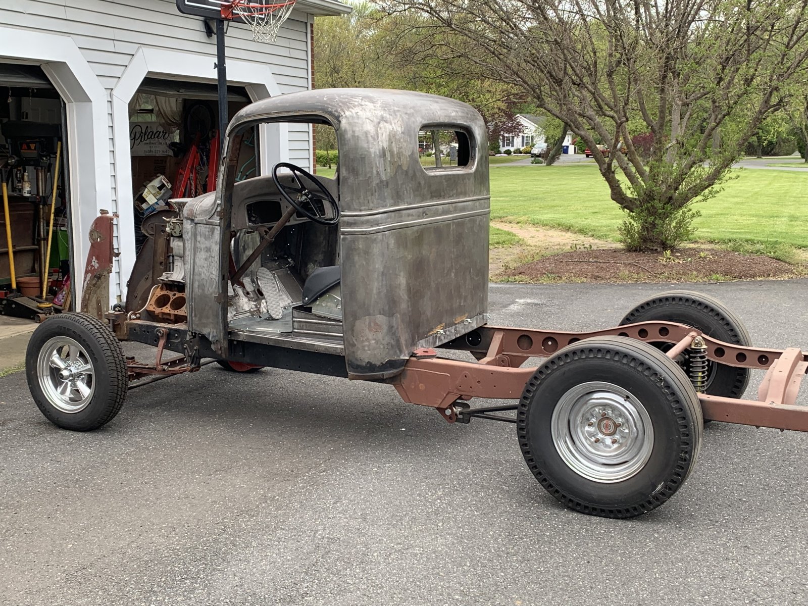

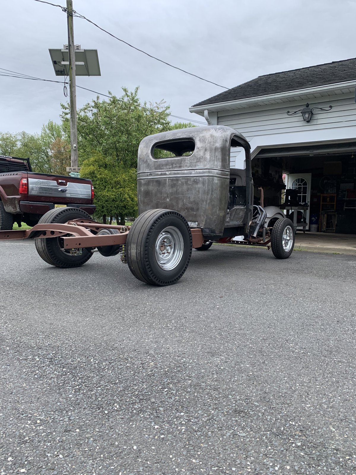

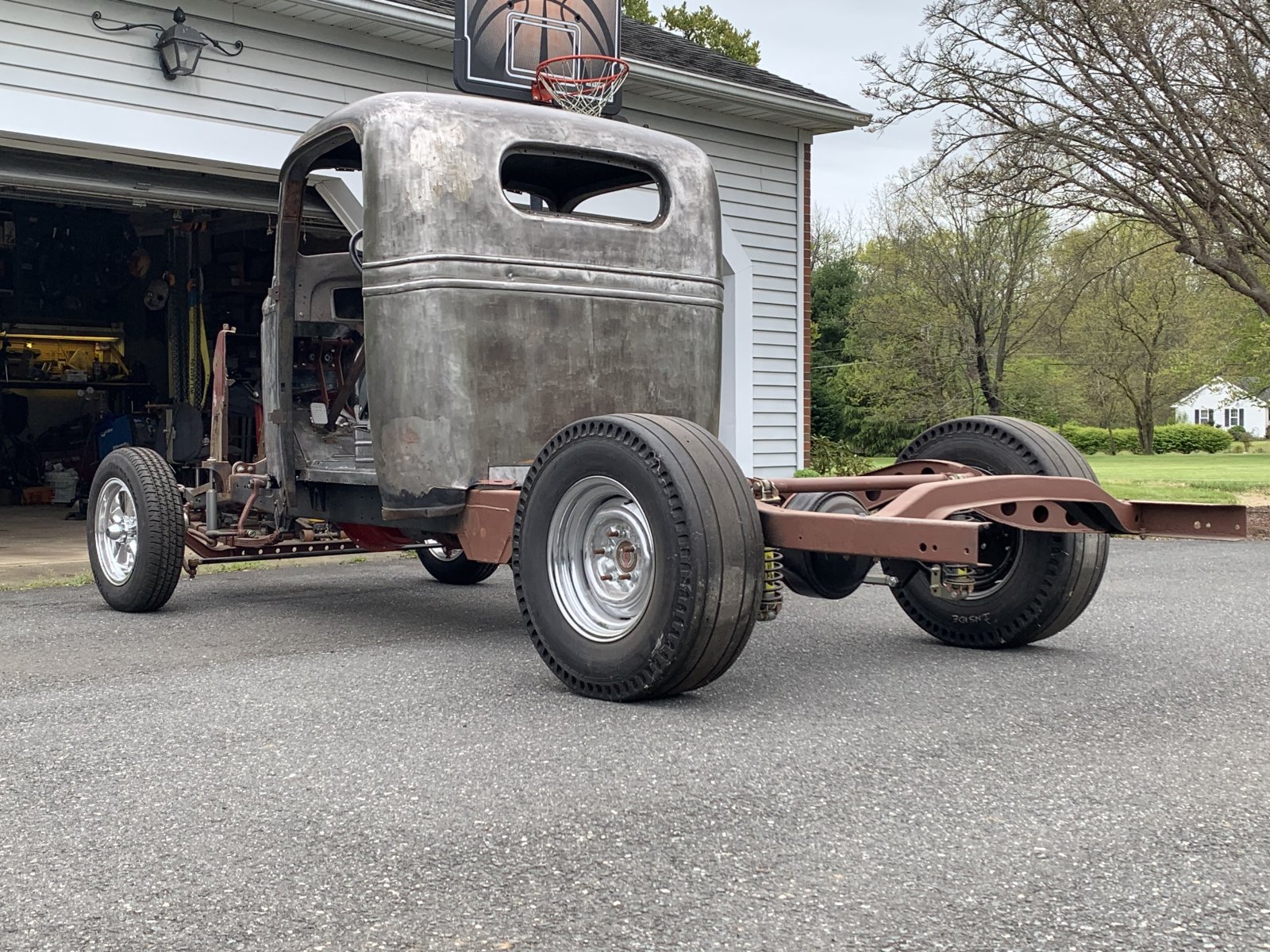

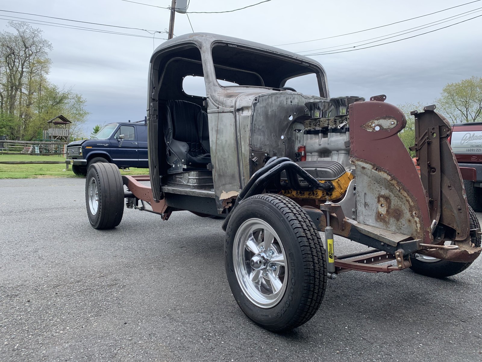

    Got the old girl outside to blow the dust off and took some beauty shots. So far…I like what I’m seeing, but I’m bias.
    IMG_4771.jpeg IMG_4772.jpeg IMG_4773.jpeg IMG_4774.jpeg IMG_4775.jpeg IMG_4776.jpeg IMG_4777.jpeg IMG_4778.jpeg IMG_4779.jpeg IMG_4780.jpeg IMG_4781.jpeg

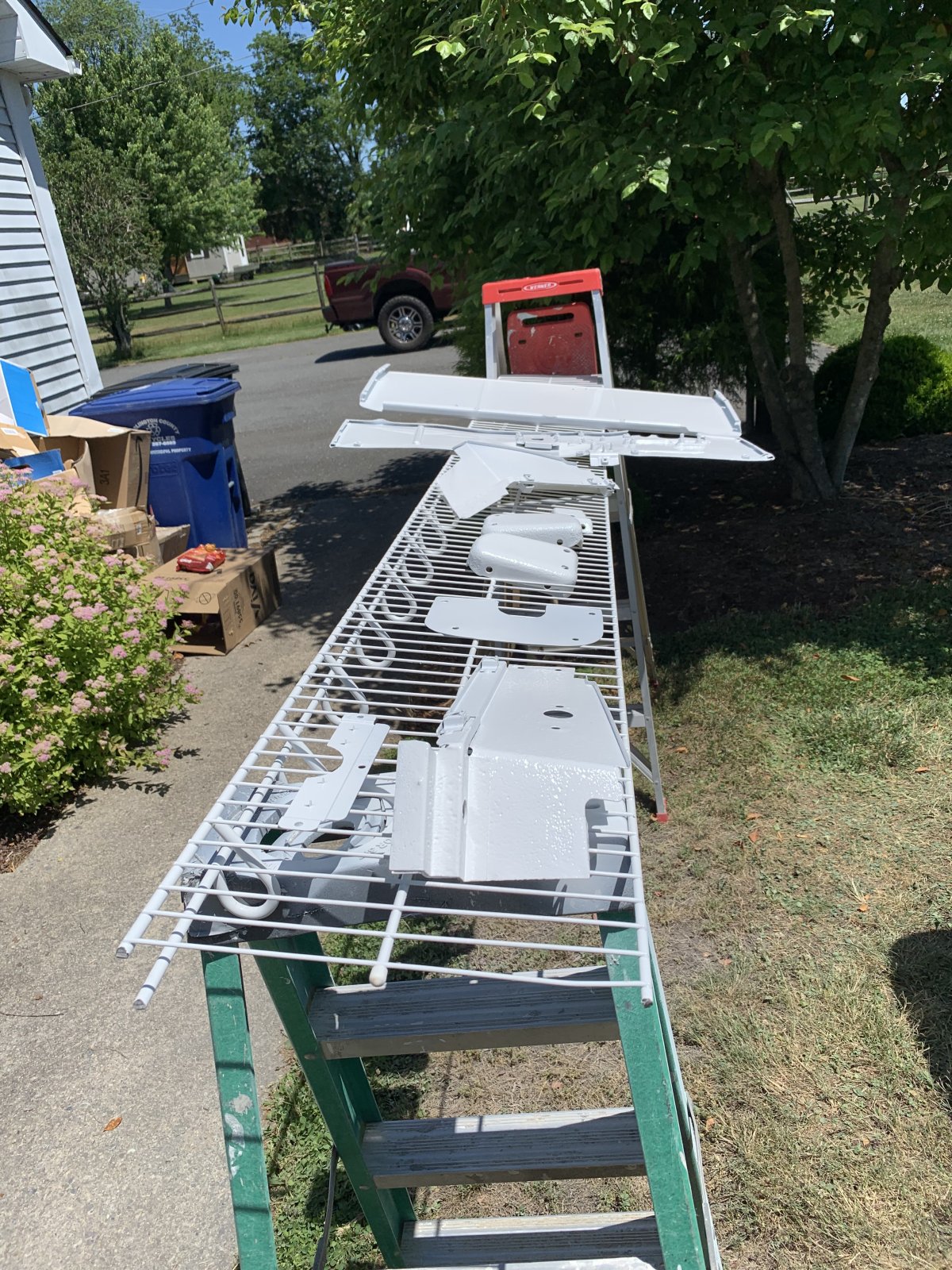

    Been doing a lot of cleaning and prep….boring stuff. Shot some prime on the floor pieces today so I can keep moving on.
