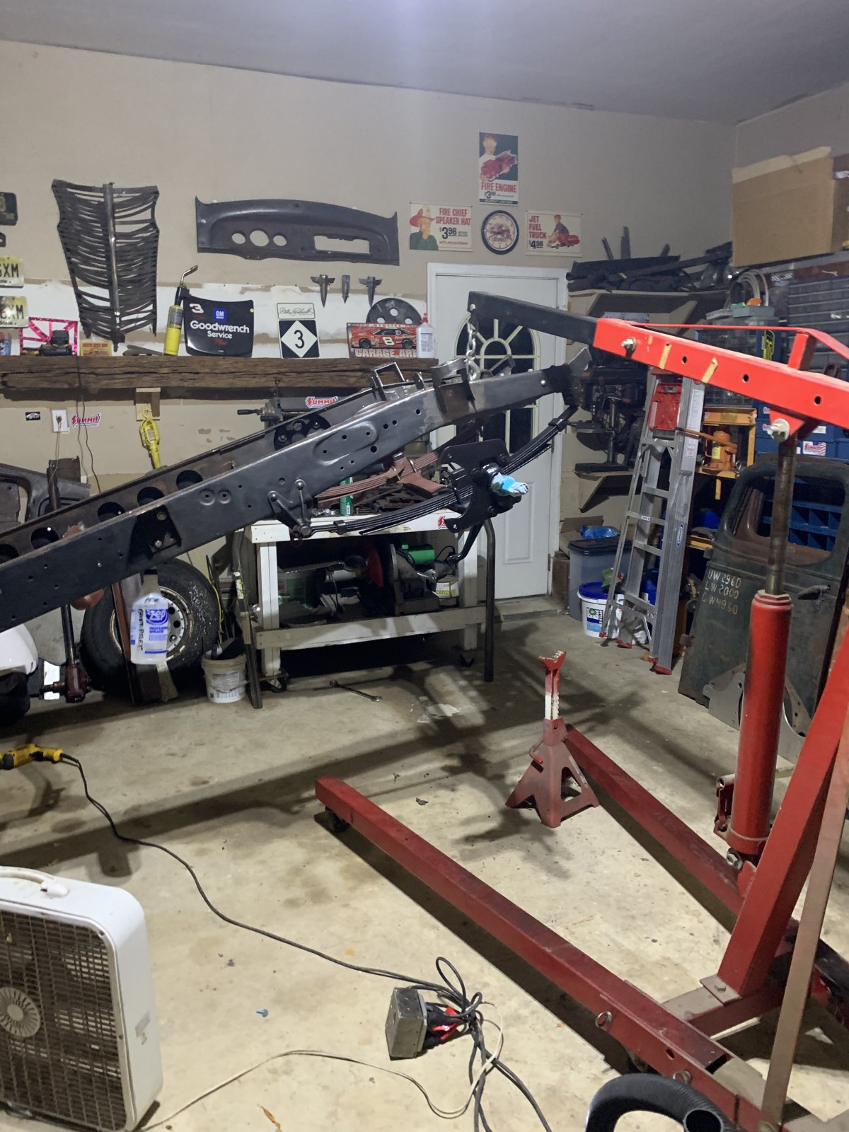

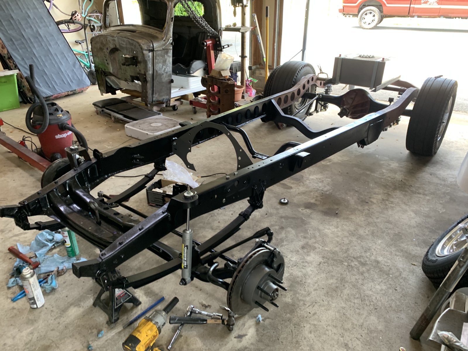

  3. pila38
    Joined: Mar 25, 2009
    Posts: 1,097
    pila38

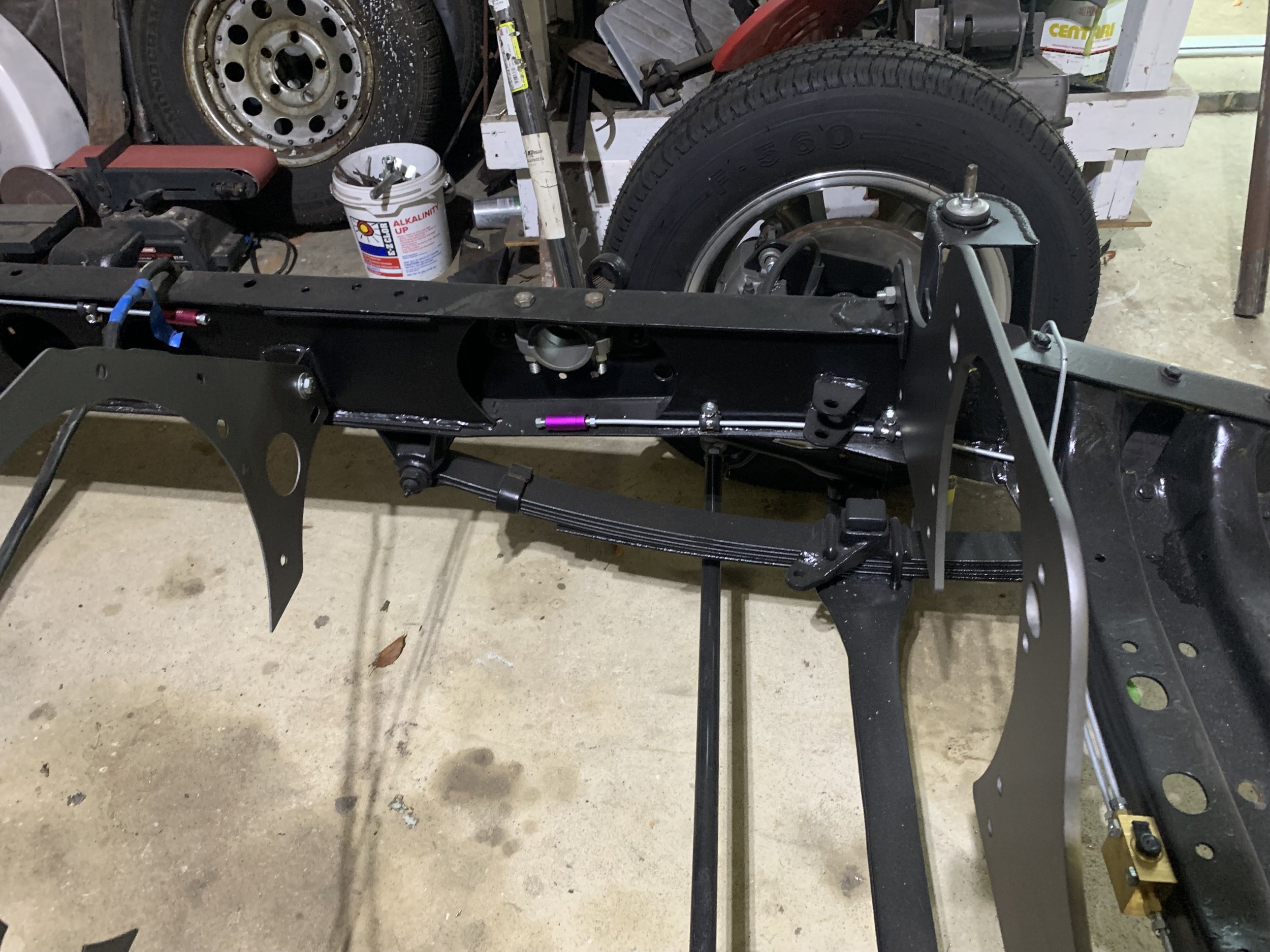

    Ripped it all back apart again. Time to clean up the ch***is and put it together for the final time.

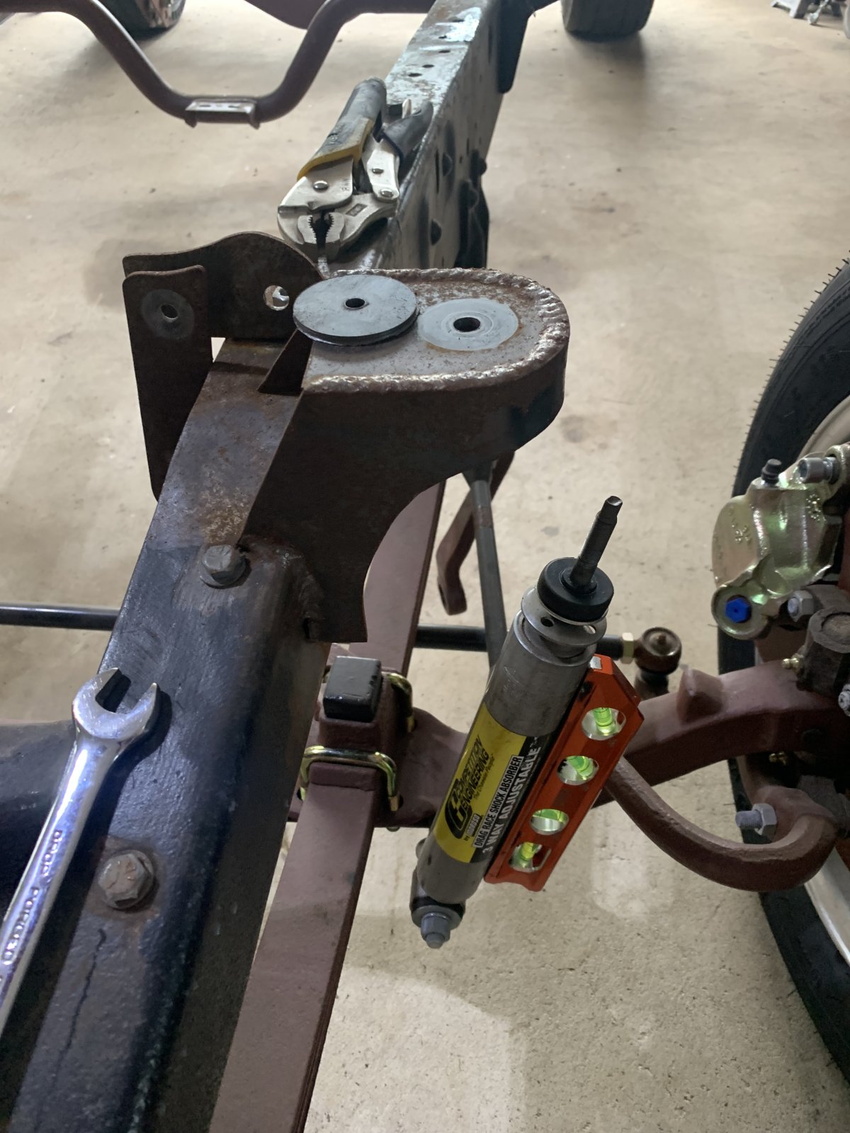

  4. pila38
    Posts: 1,097
    pila38

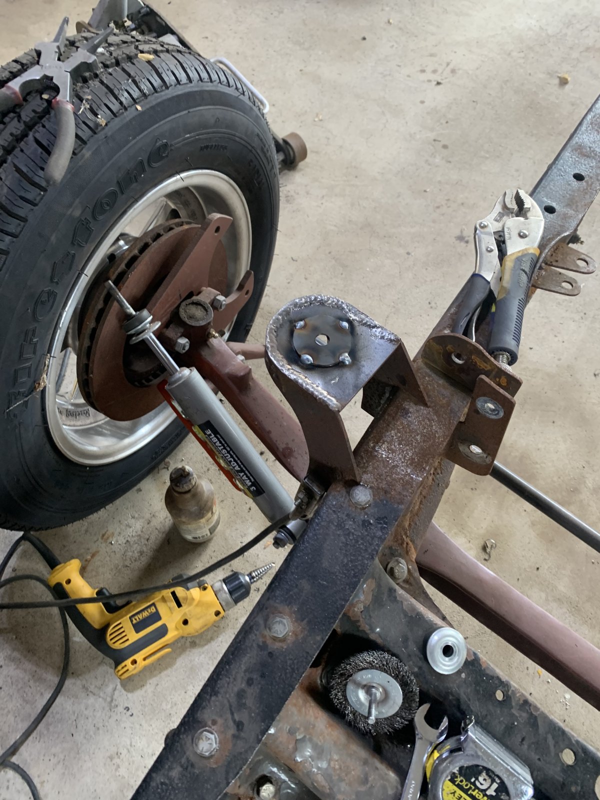

    Got something done this weekend:

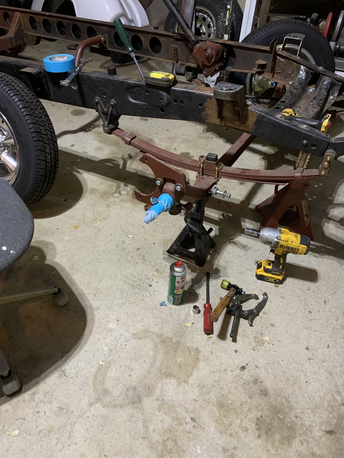

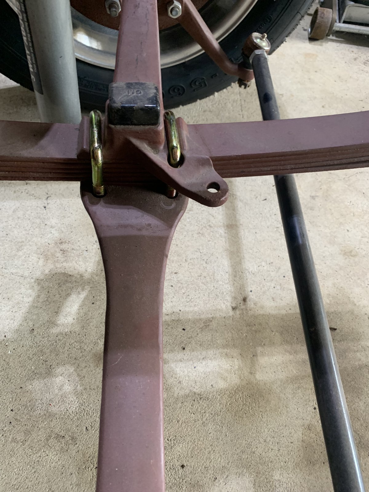

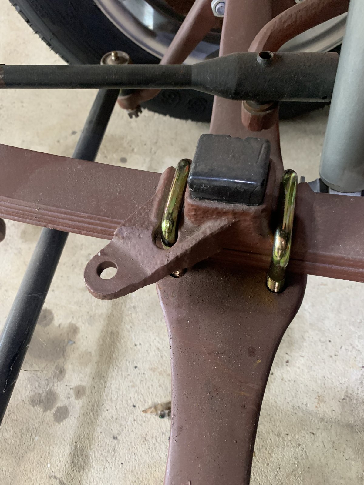

    Put the correct u-bolts in the front end:

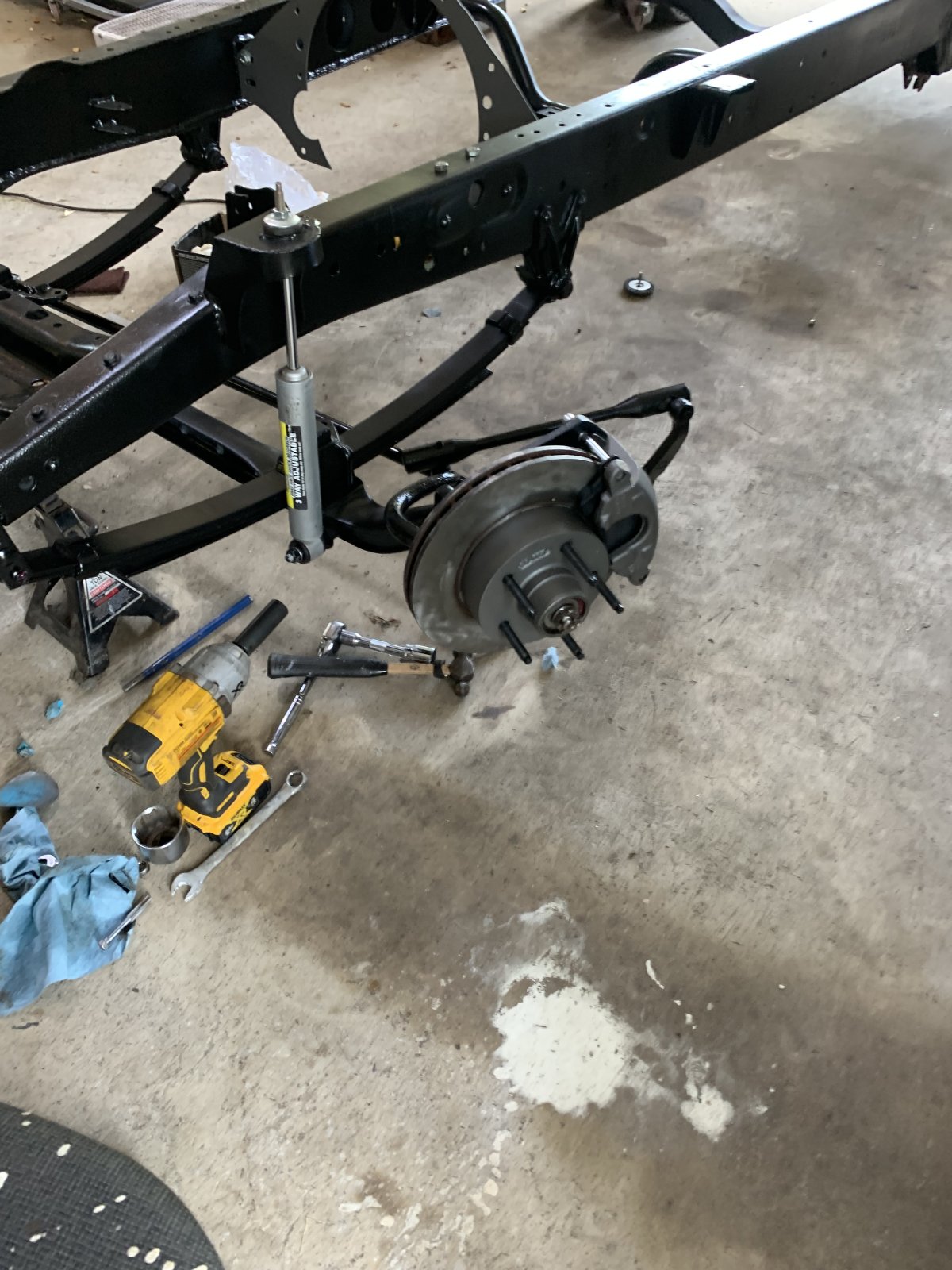

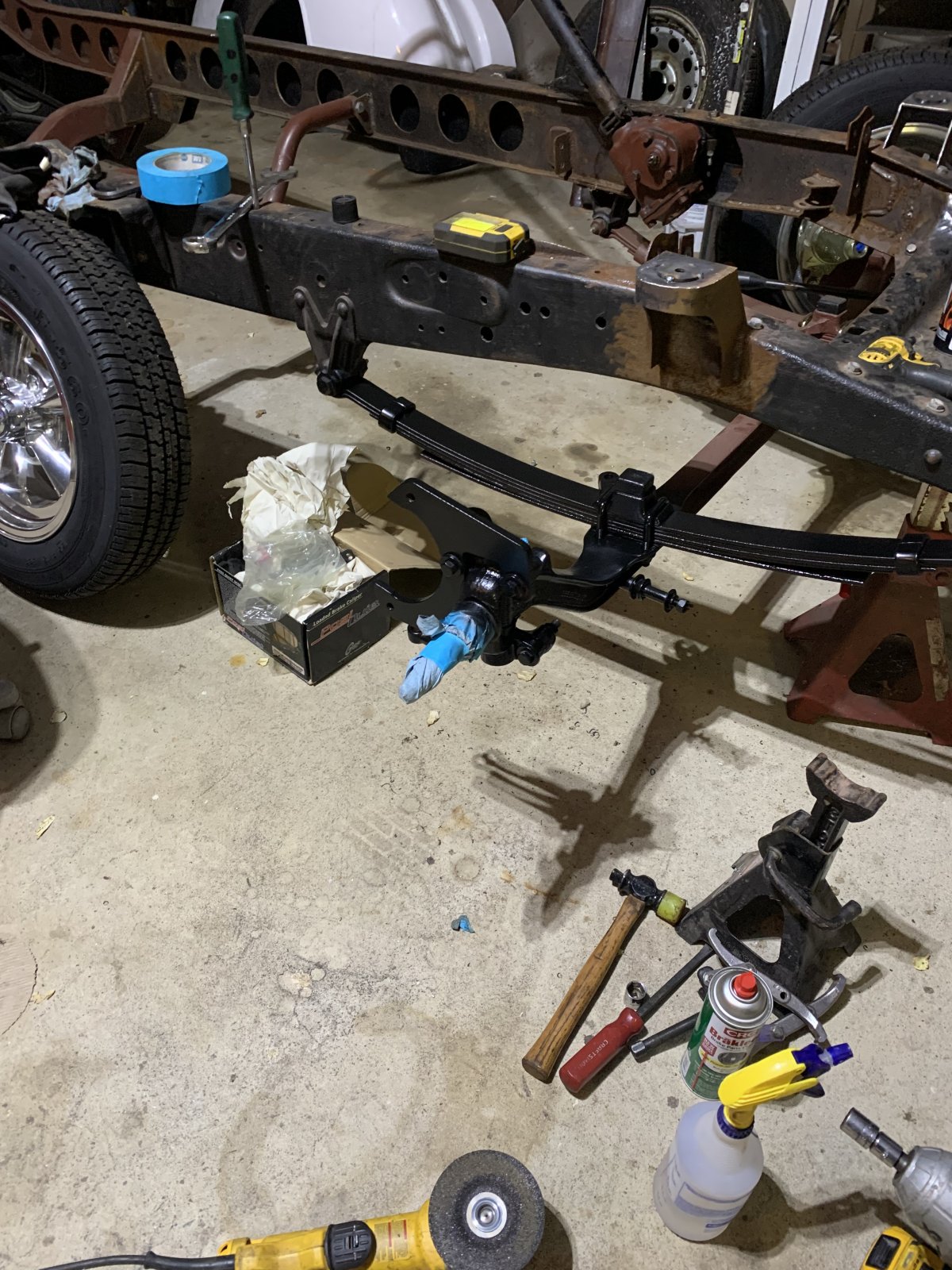

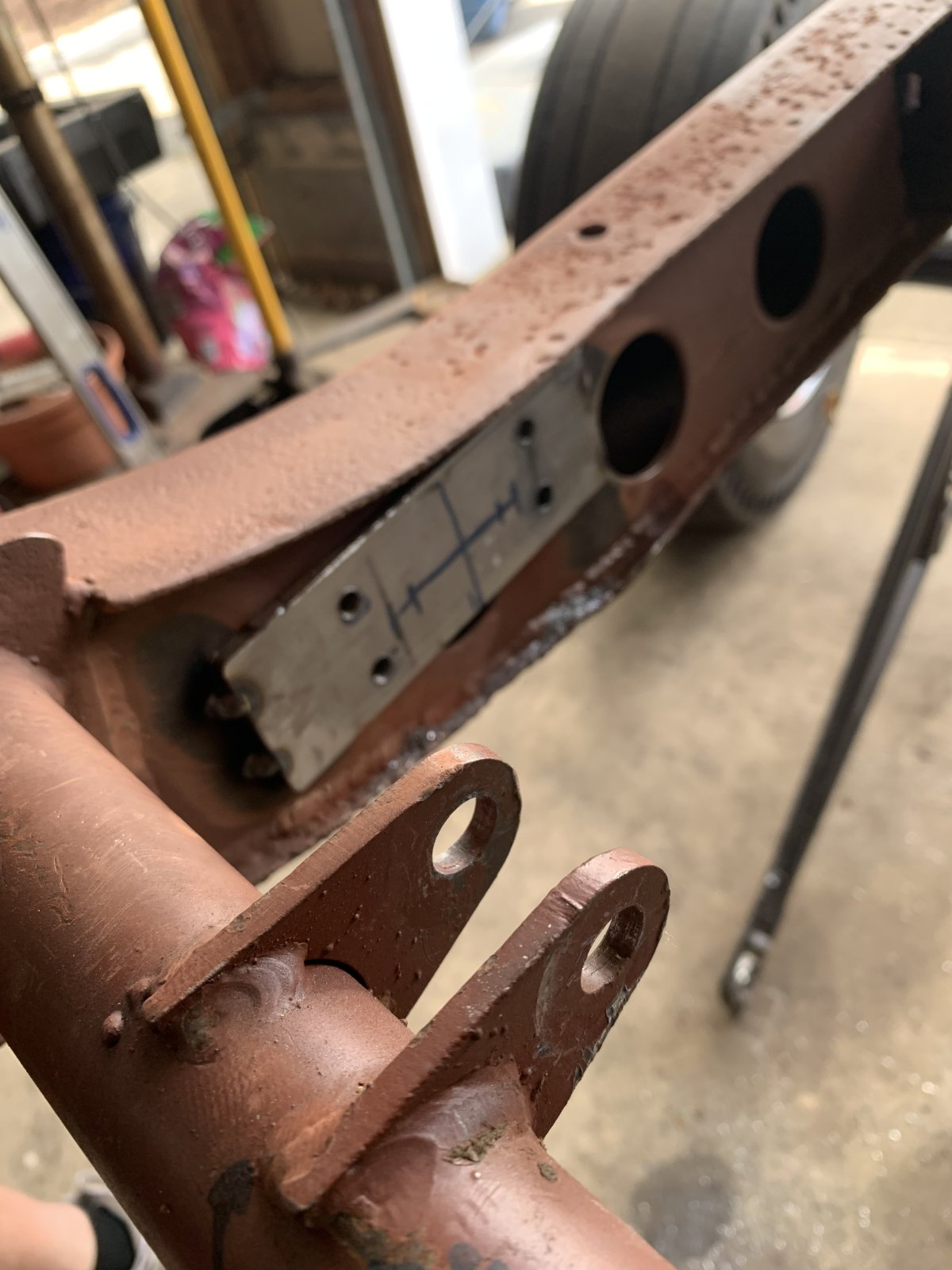

    The shocks were slightly out of plumb and it drove me nuts, so this was my solution to get it right:

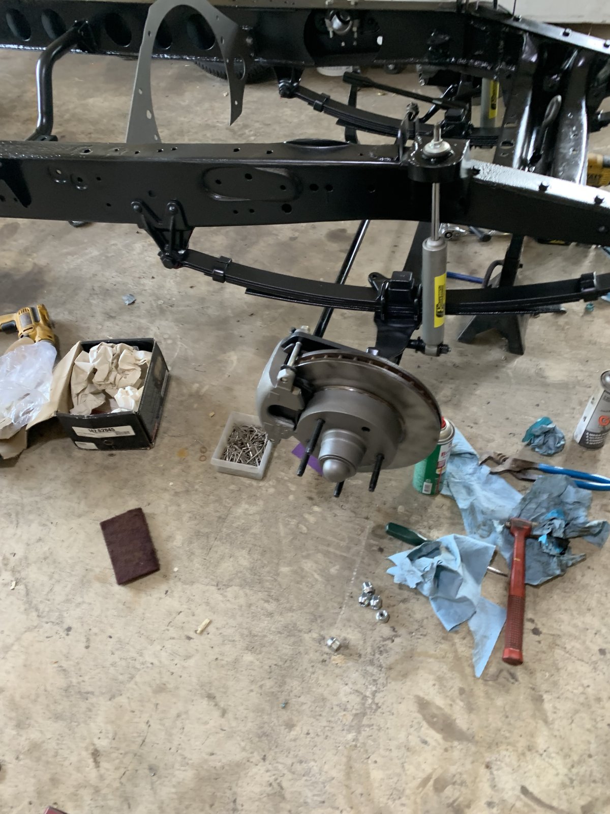

    Steering box had a ton of play in it, so I adjusted that:
    Then ripped the brakes back apart and cleaned them up and started cleaning and painting the ch***is:

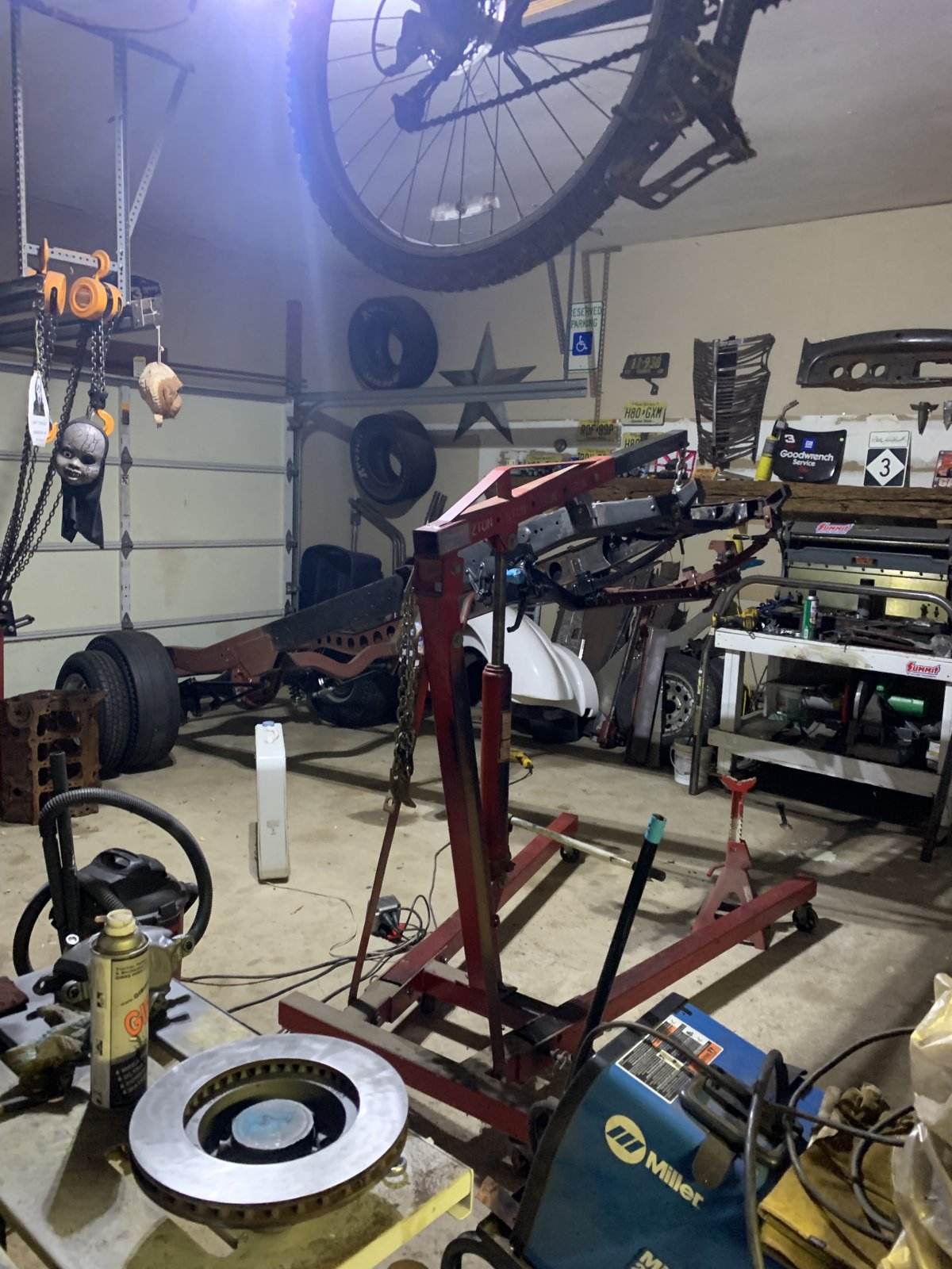

  7. pila38
    Posts: 1,097
    pila38

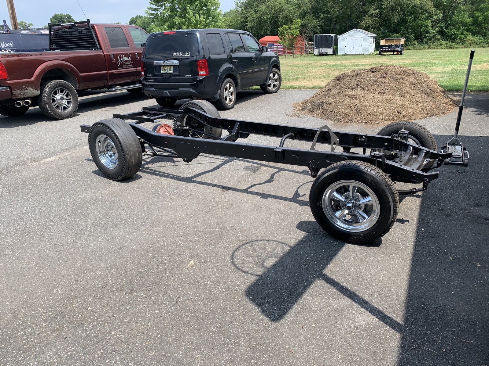

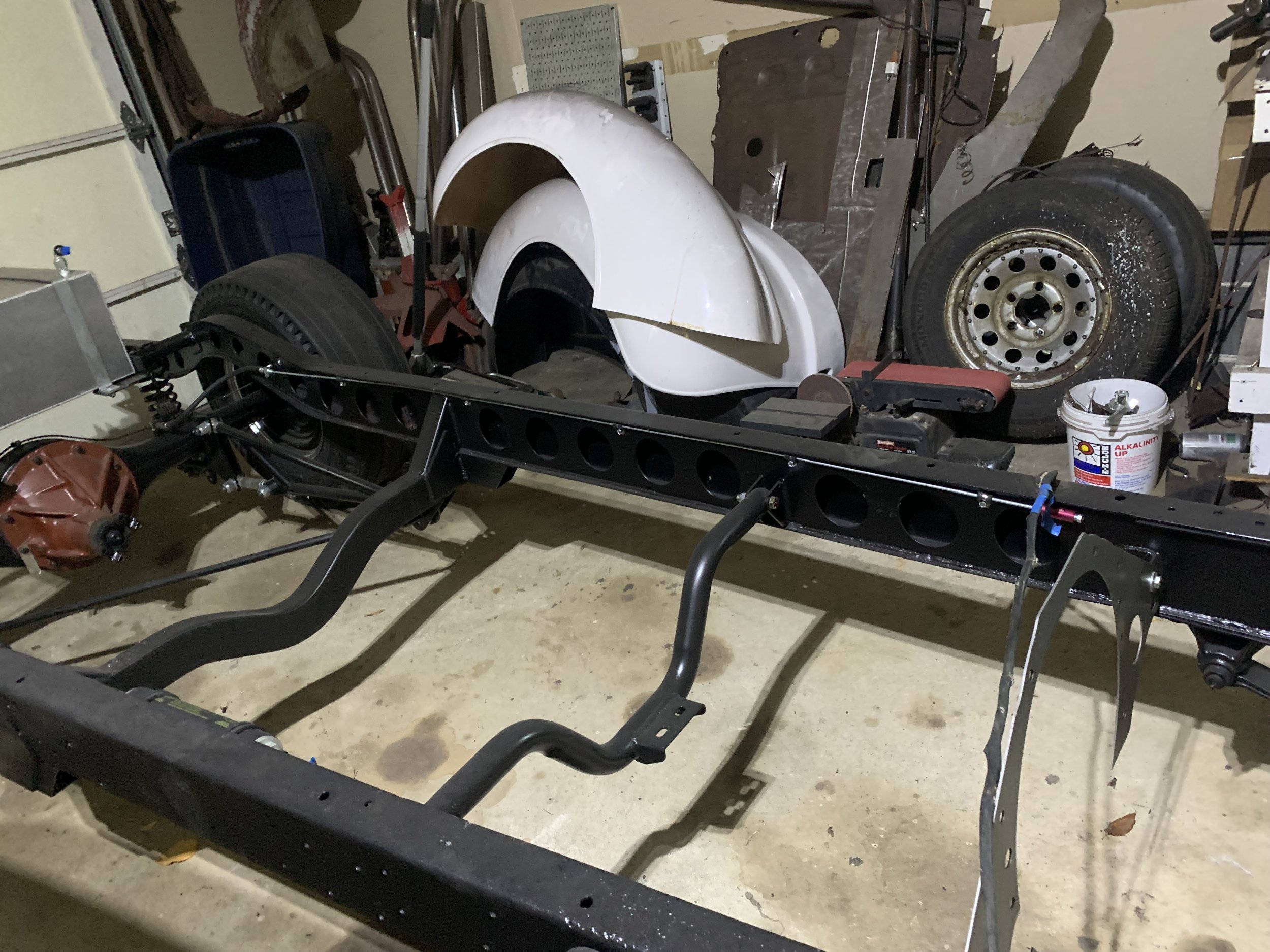

    Wheelies! No, just spraying some paint. Decided to paint the ch***is in sections. Started with the front suspension. The engine crane has been indispensable. It may spend a lot of time in the corner, but when you need it, you’re glad it’s there.

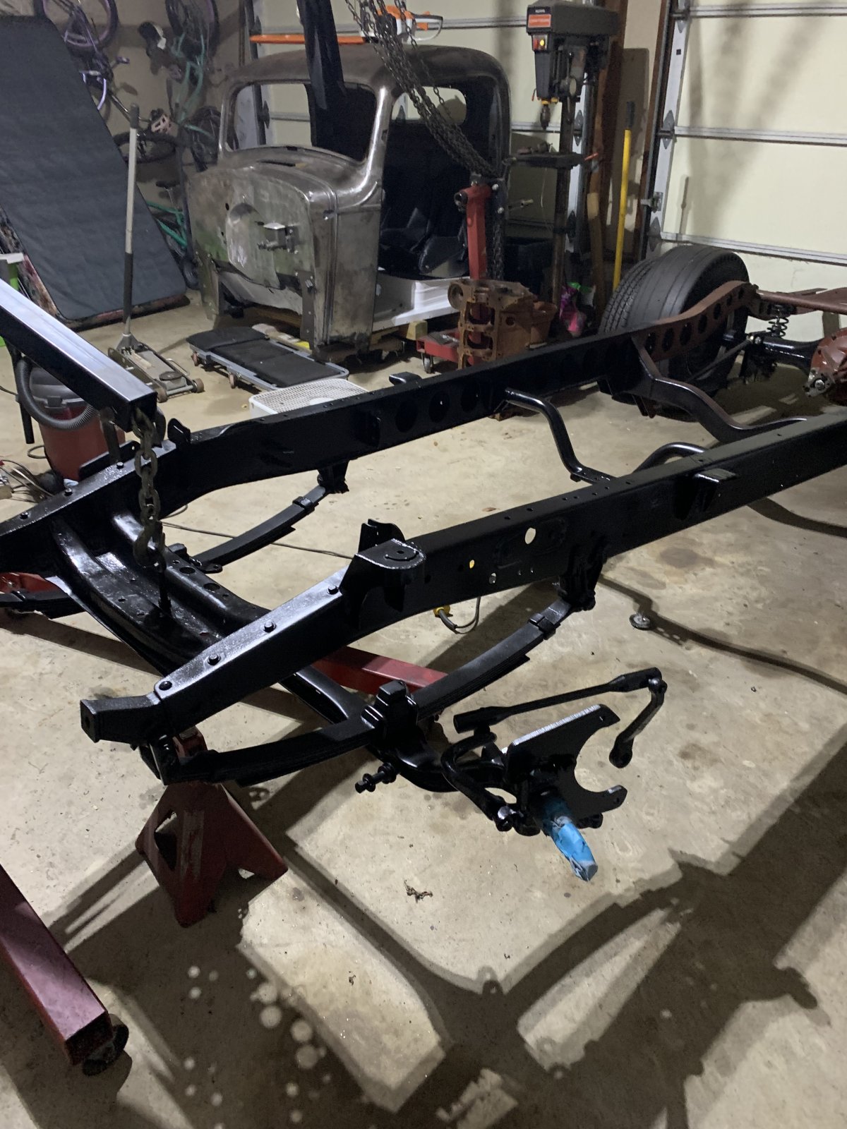

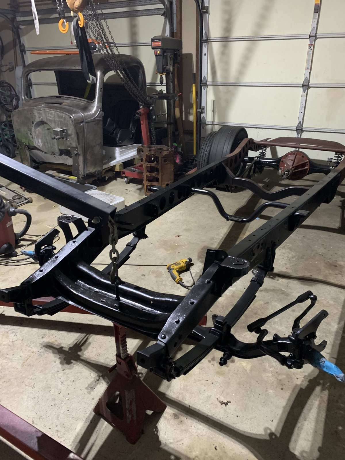

    More progress. Plan on getting the ch***is finalized this week and then back to work on the cab.
    IMG_4917.jpeg IMG_4918.jpeg IMG_4919.jpeg IMG_4926.jpeg IMG_4927.jpeg IMG_4928.jpeg IMG_4929.jpeg IMG_4932.jpeg IMG_4935.jpeg IMG_4934.jpeg IMG_4959.jpeg IMG_4960.jpeg IMG_4961.jpeg IMG_4962.jpeg

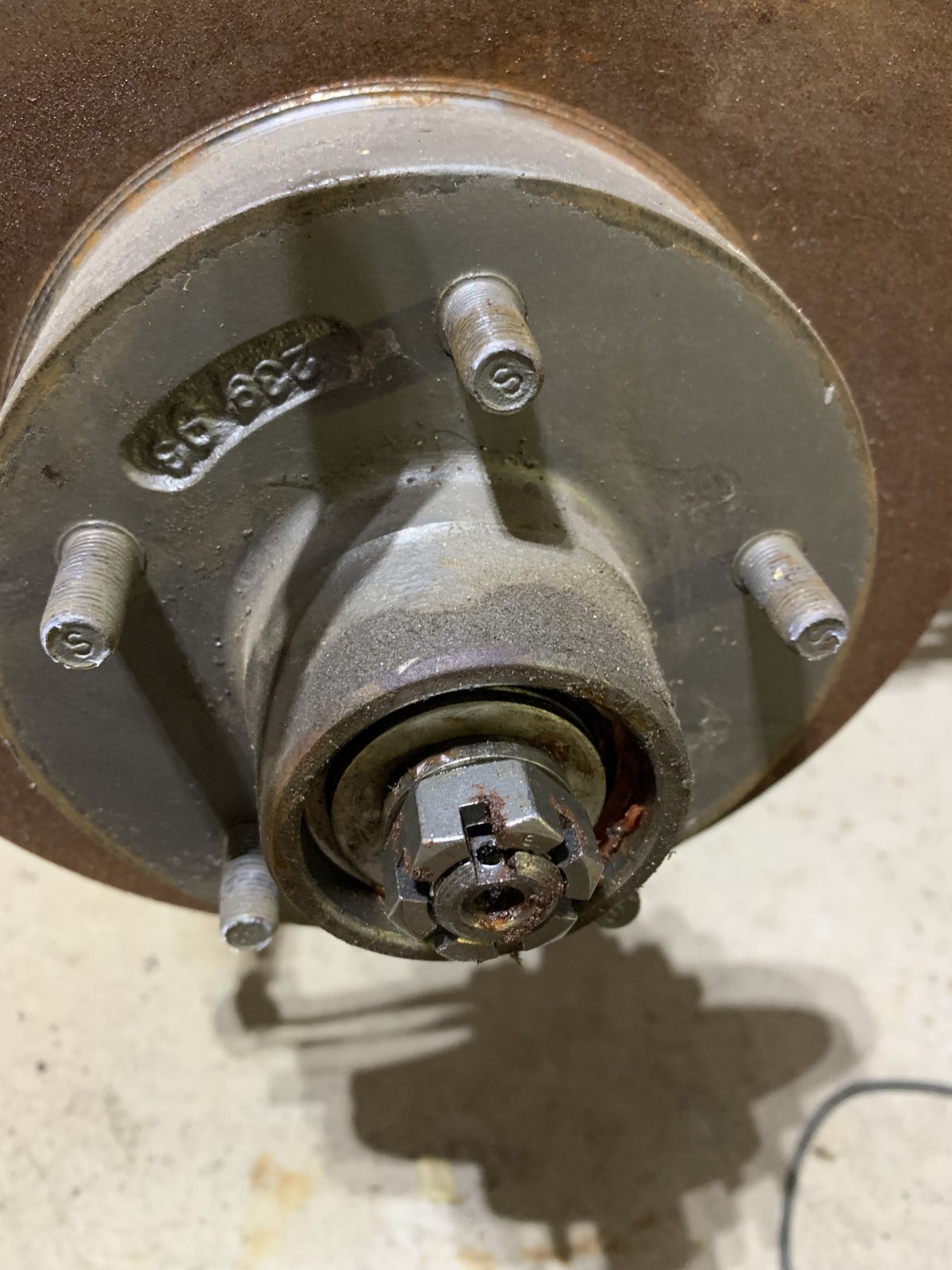

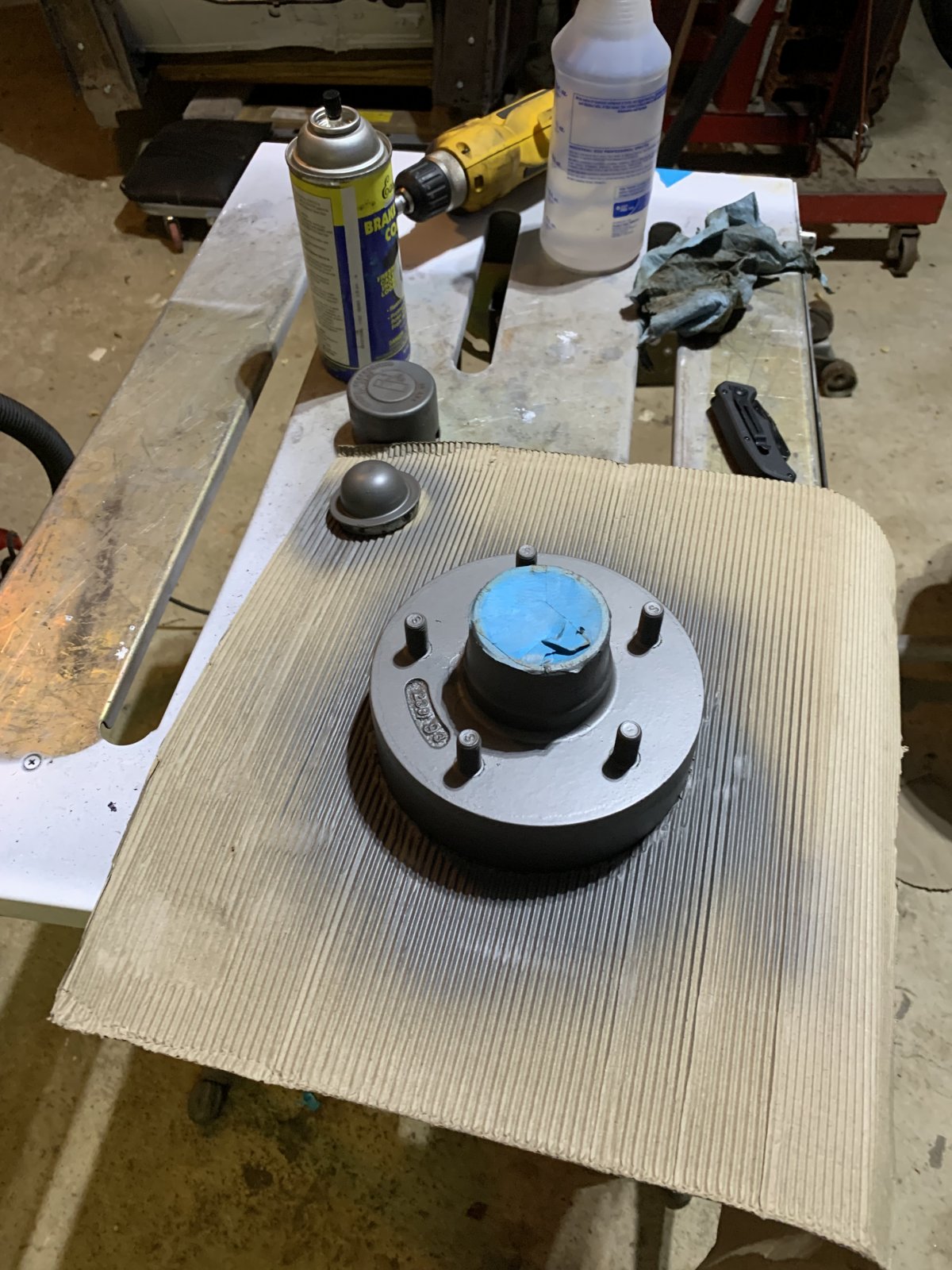

  10. nunattax
    Joined: Jan 10, 2011
    Posts: 3,390
    nunattax
    hi eric tell me about your front disc kit .what diameter is the rotor and what thickness is the rotor.in metric or imperial chris
  11. pila38
    Posts: 1,097
    pila38
    Hey Chris,
    It’s a kit I bought from ECI probably like 30 years ago (not an exaggeration). It’s for a 41-46 GM axle which is what I had at the time and since I had that front end all redone and had the brakes and everything, I just stuck it under this truck. Essentially they are just mid 70s GM disc brakes (I always just use ‘75 Camaro parts for it). There is a bearing adapter that goes on the spindle so the inner bearing will fit, and the outer bearing I believe is from a Mustang II or Pinto of the 70s flavor. Should be an 11” rotor I think. The thickness I don’t know off hand, but can measure them tomorrow.
    nunattax likes this.
  12. pila38
    Posts: 1,097
    pila38
    Oh, and I swapped out the wheel studs for 3” ones for racing.

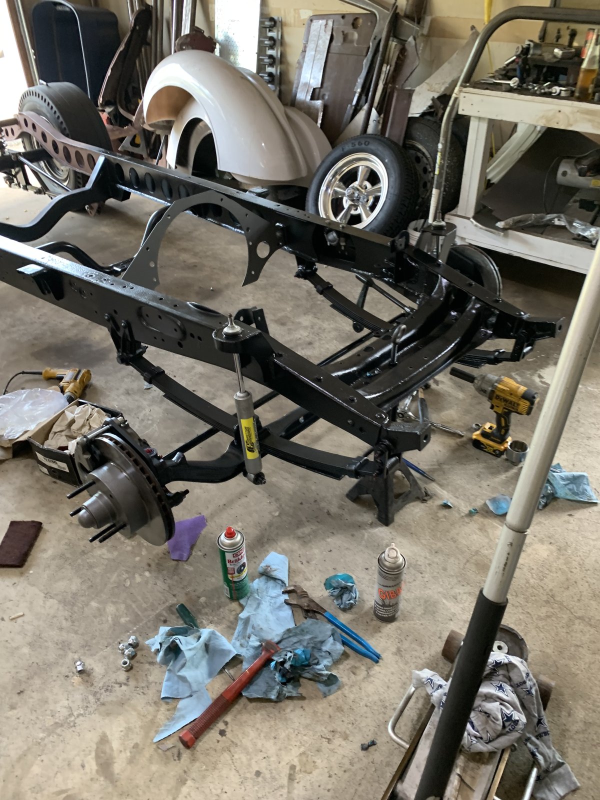

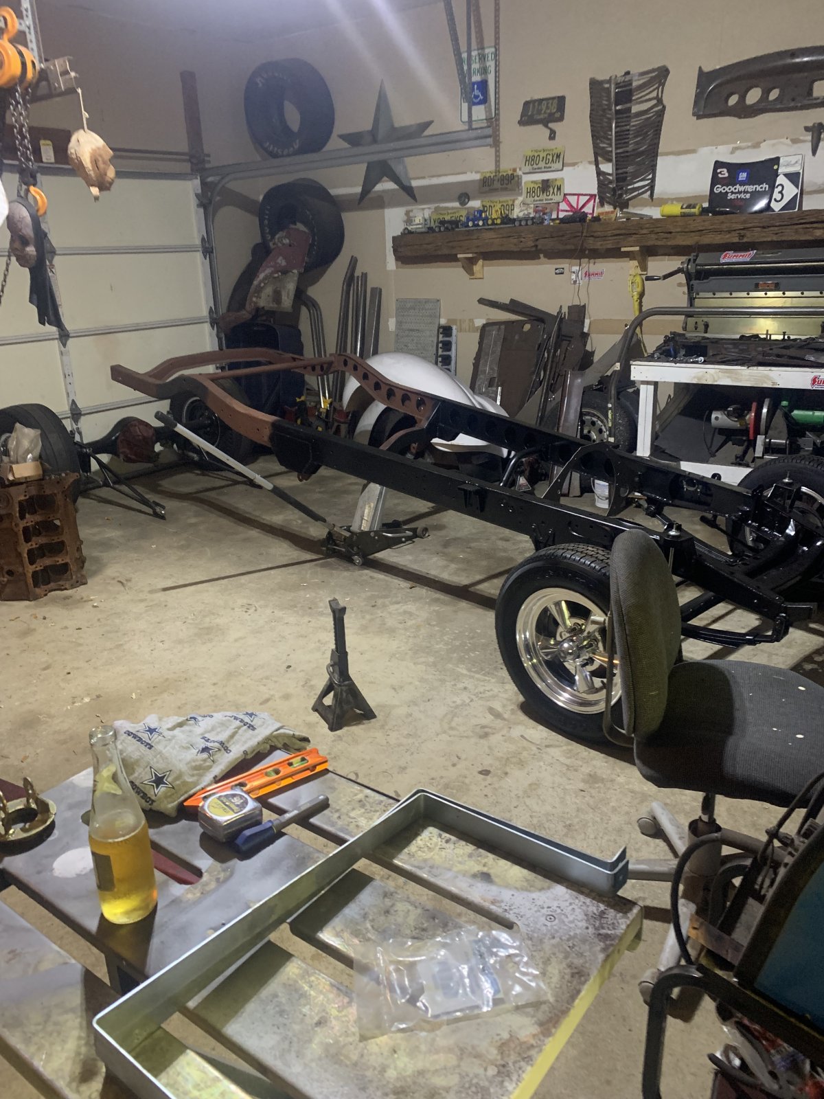

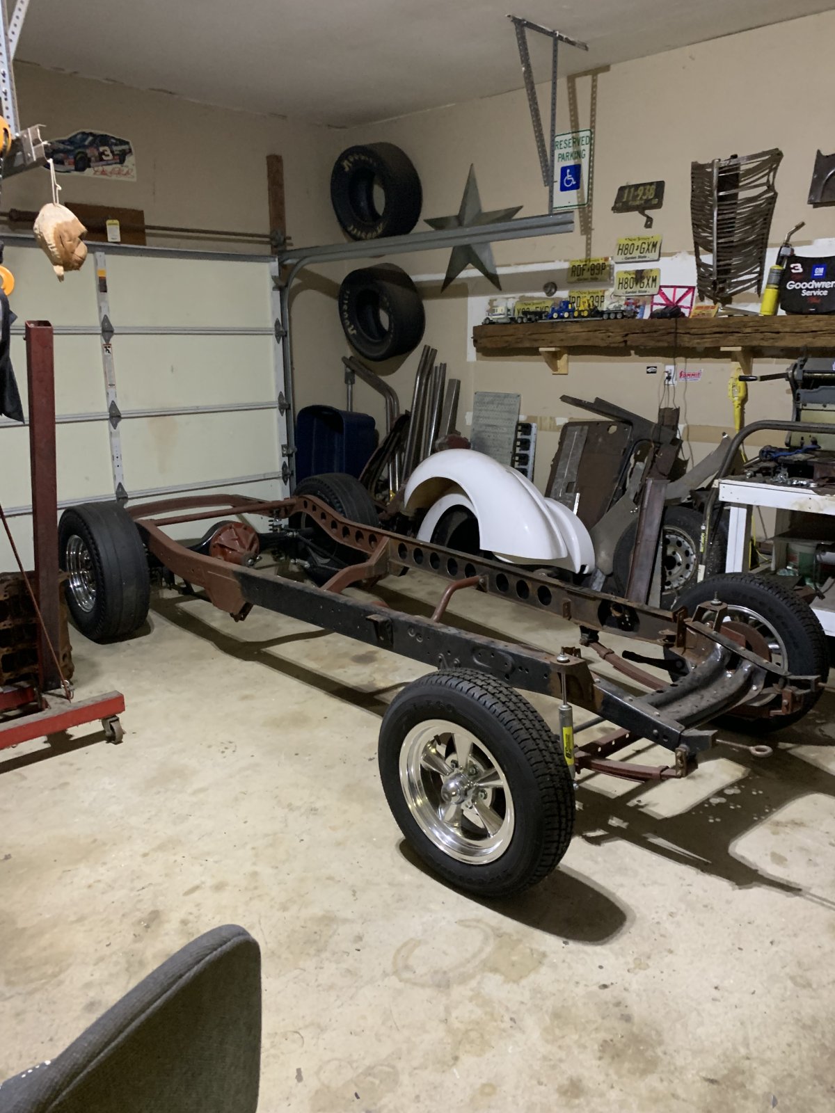

  17. pila38
    Posts: 1,097

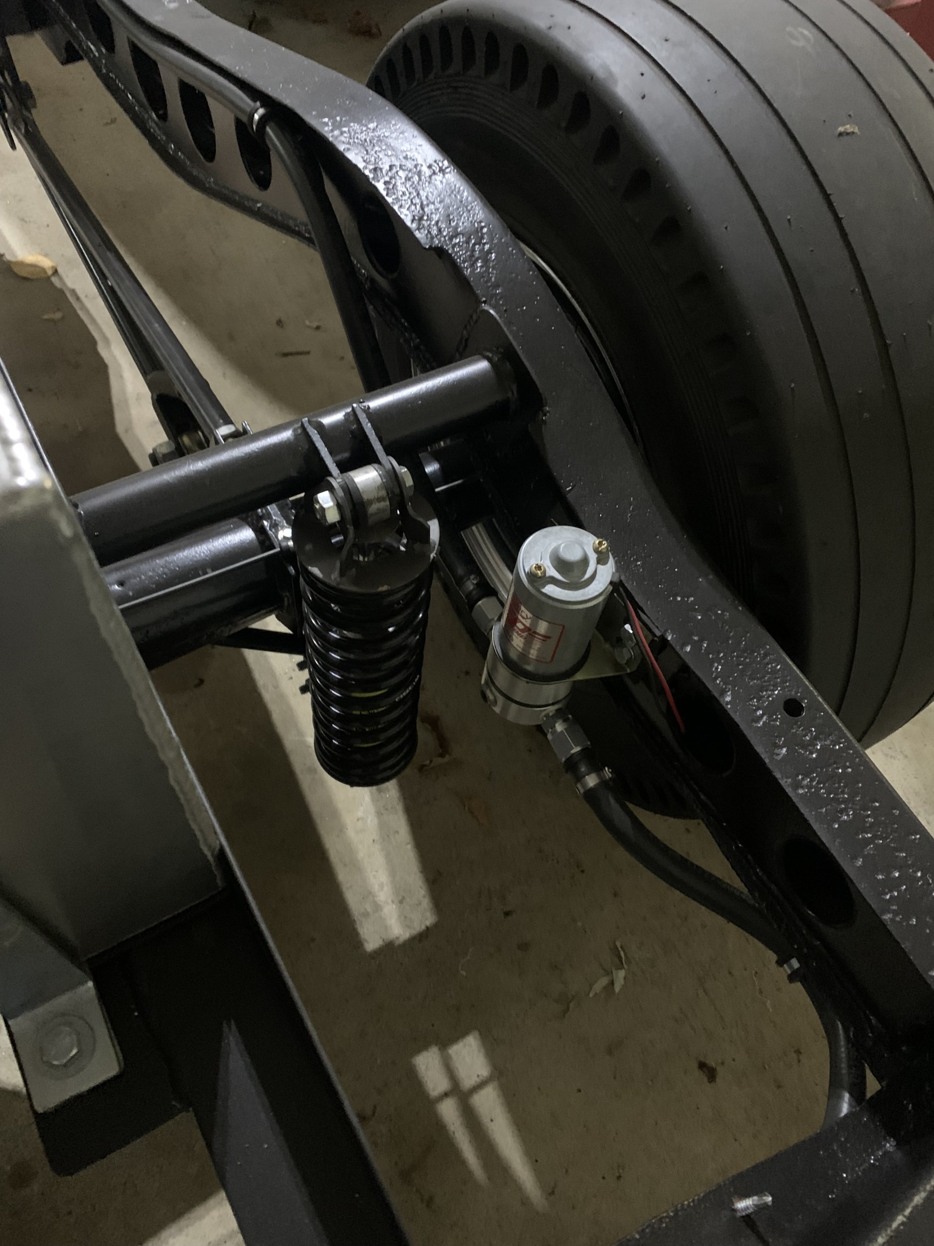

    pila38

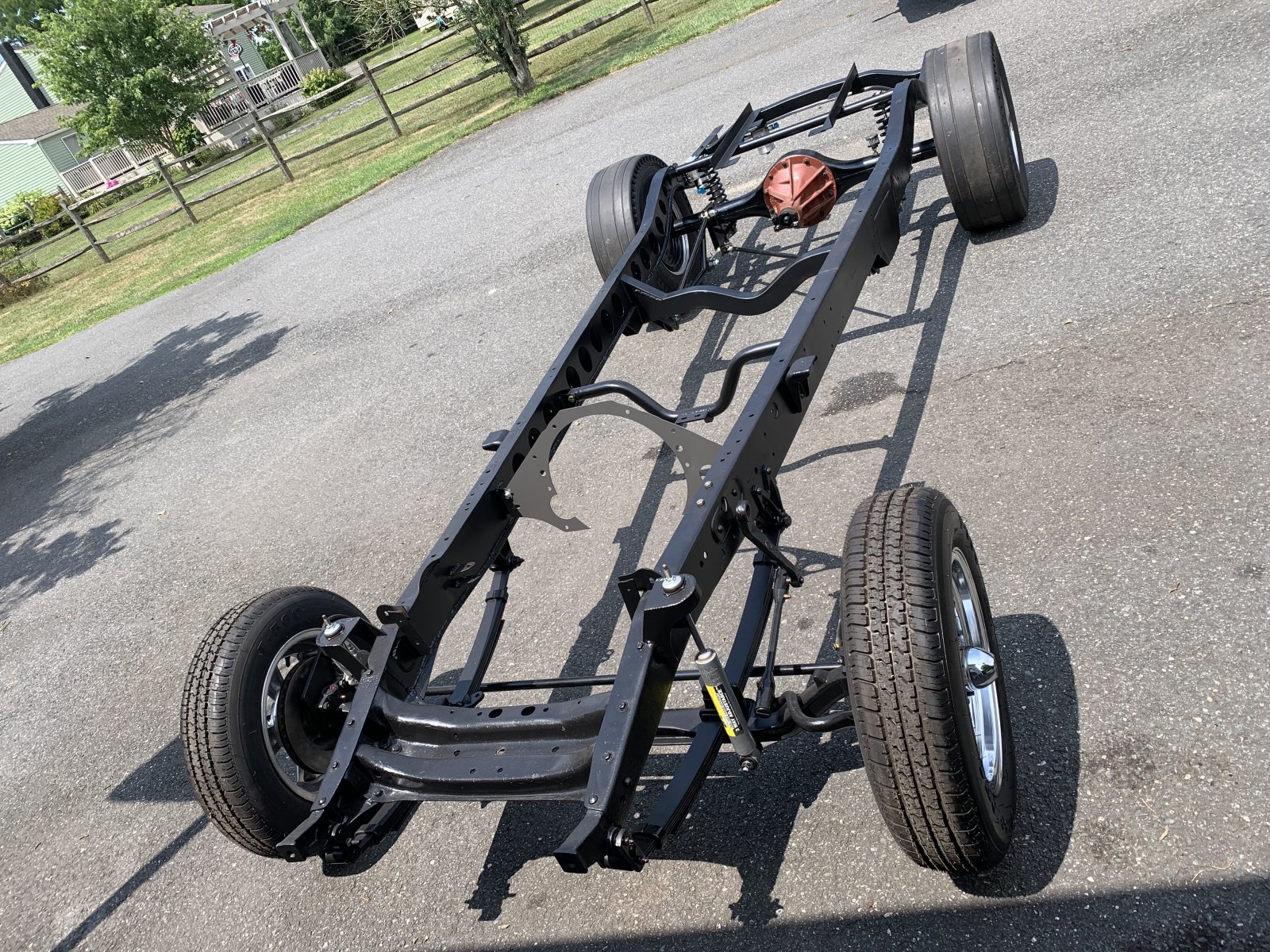

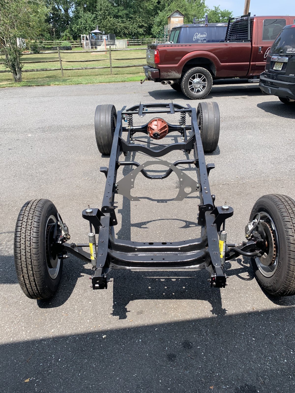

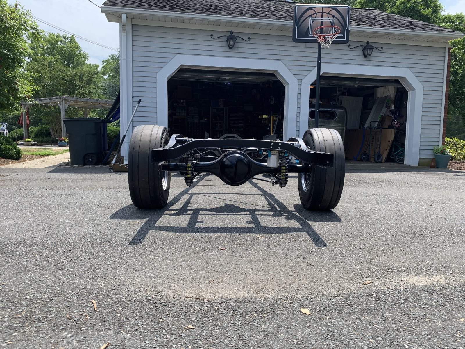

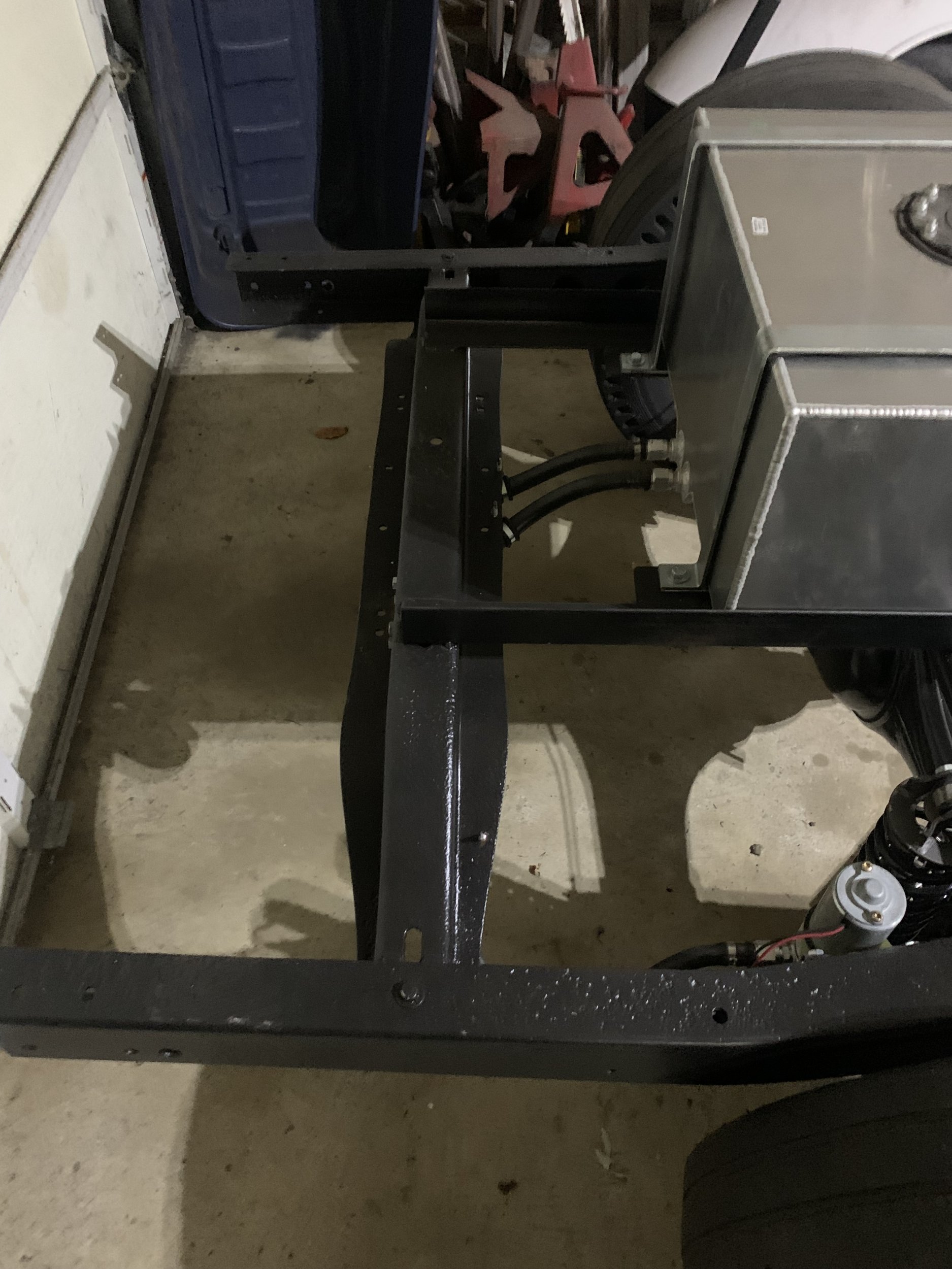

    Ch***is is ready to go down the road, save for two things. It needs to be plumbed and I screwed up and put the rear shocks at different settings so it’s sitting crooked. Started cleaning the cab again yesterday to get it ready for primer and lizard skin. Then I can sit the cab back on the frame for hopefully the last time.

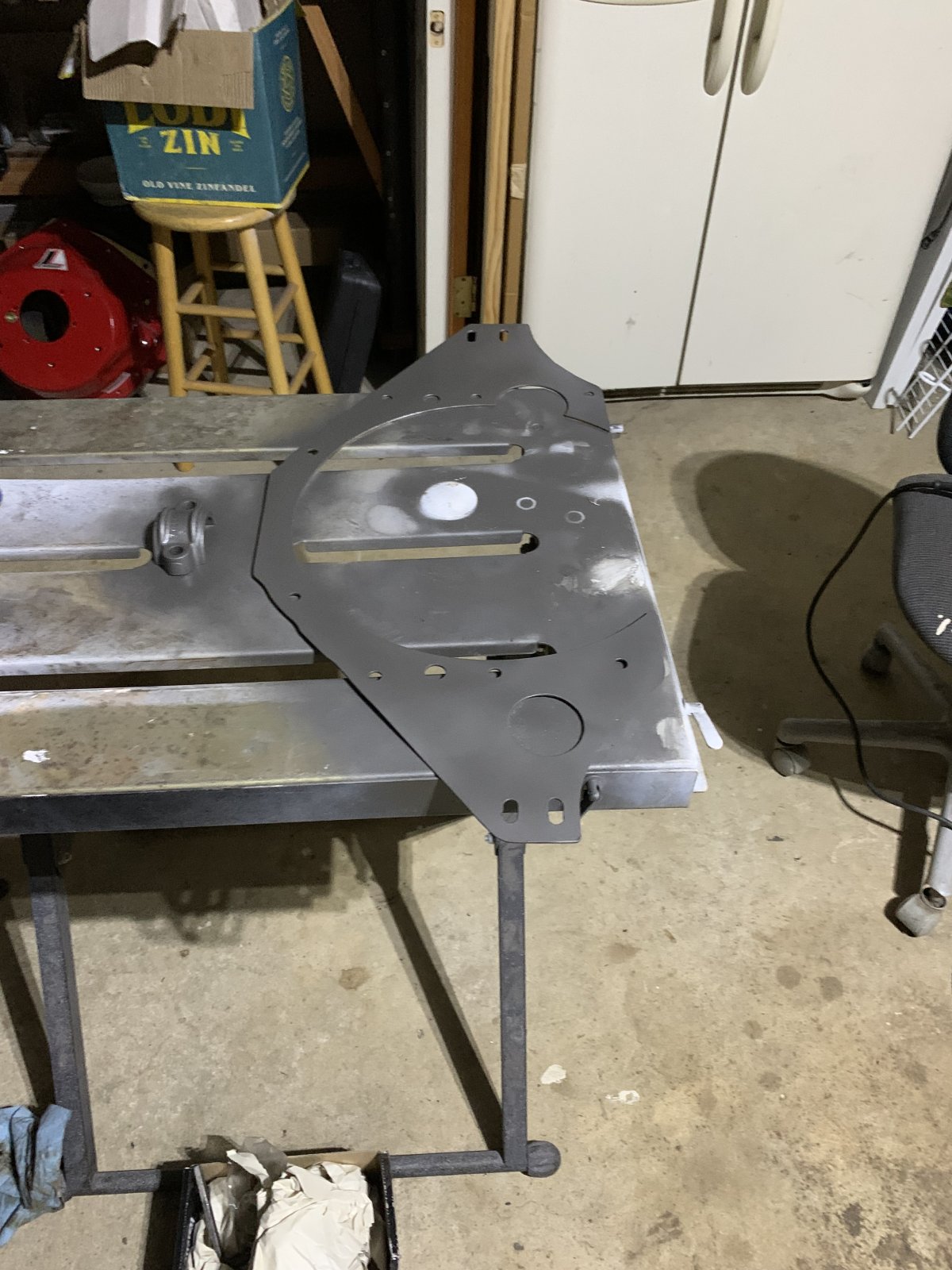

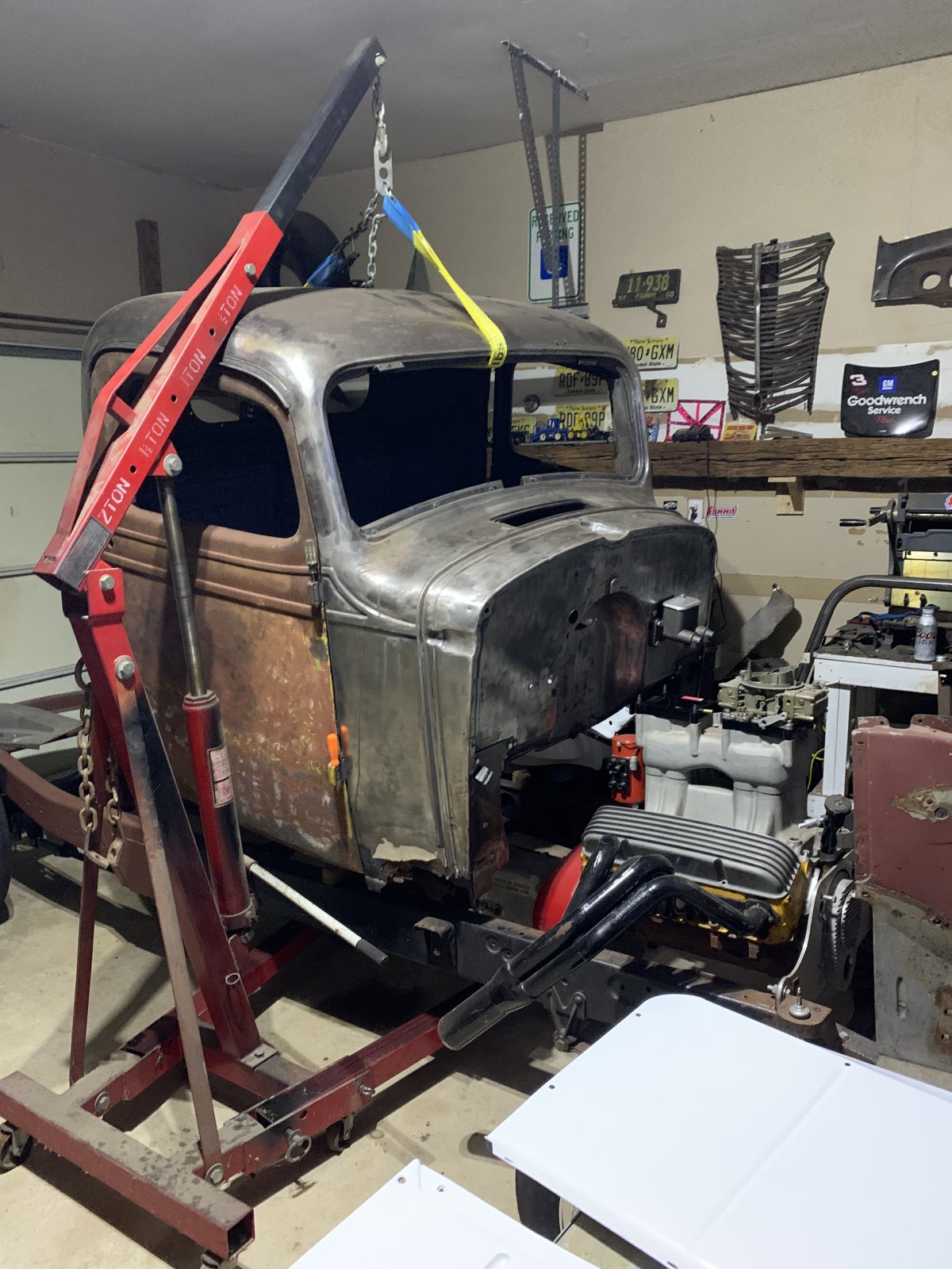

  20. pila38
    Posts: 1,097

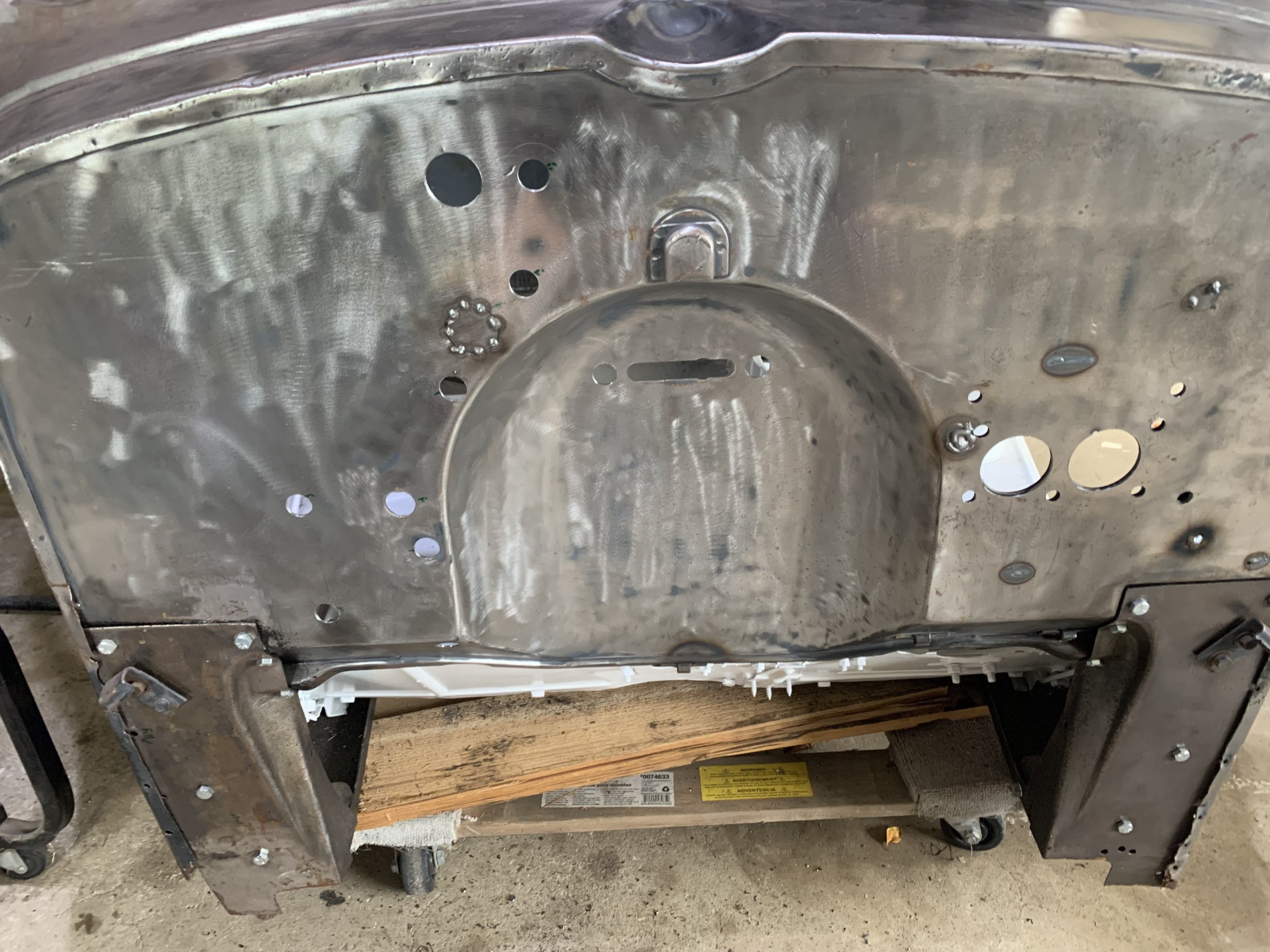

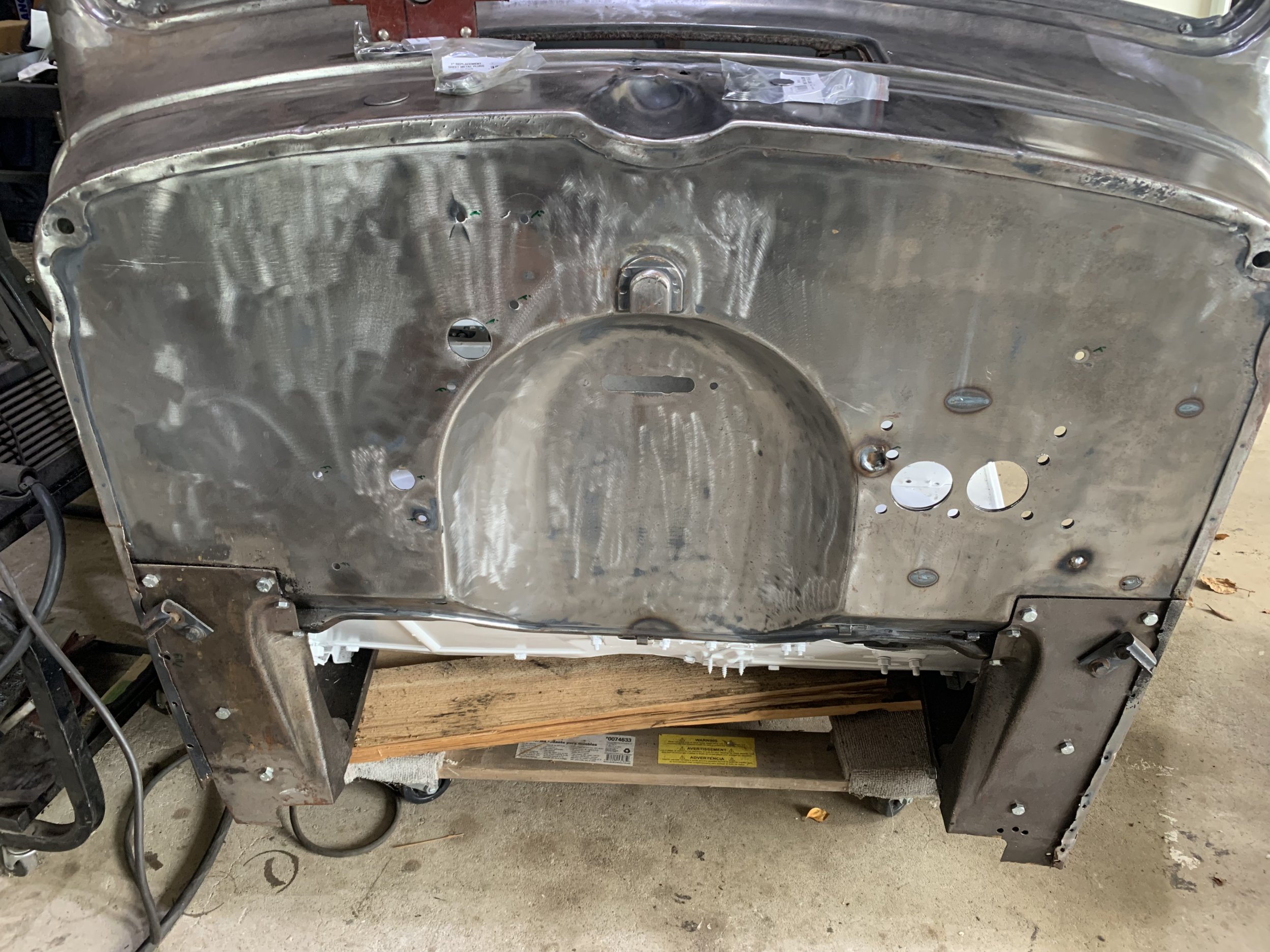

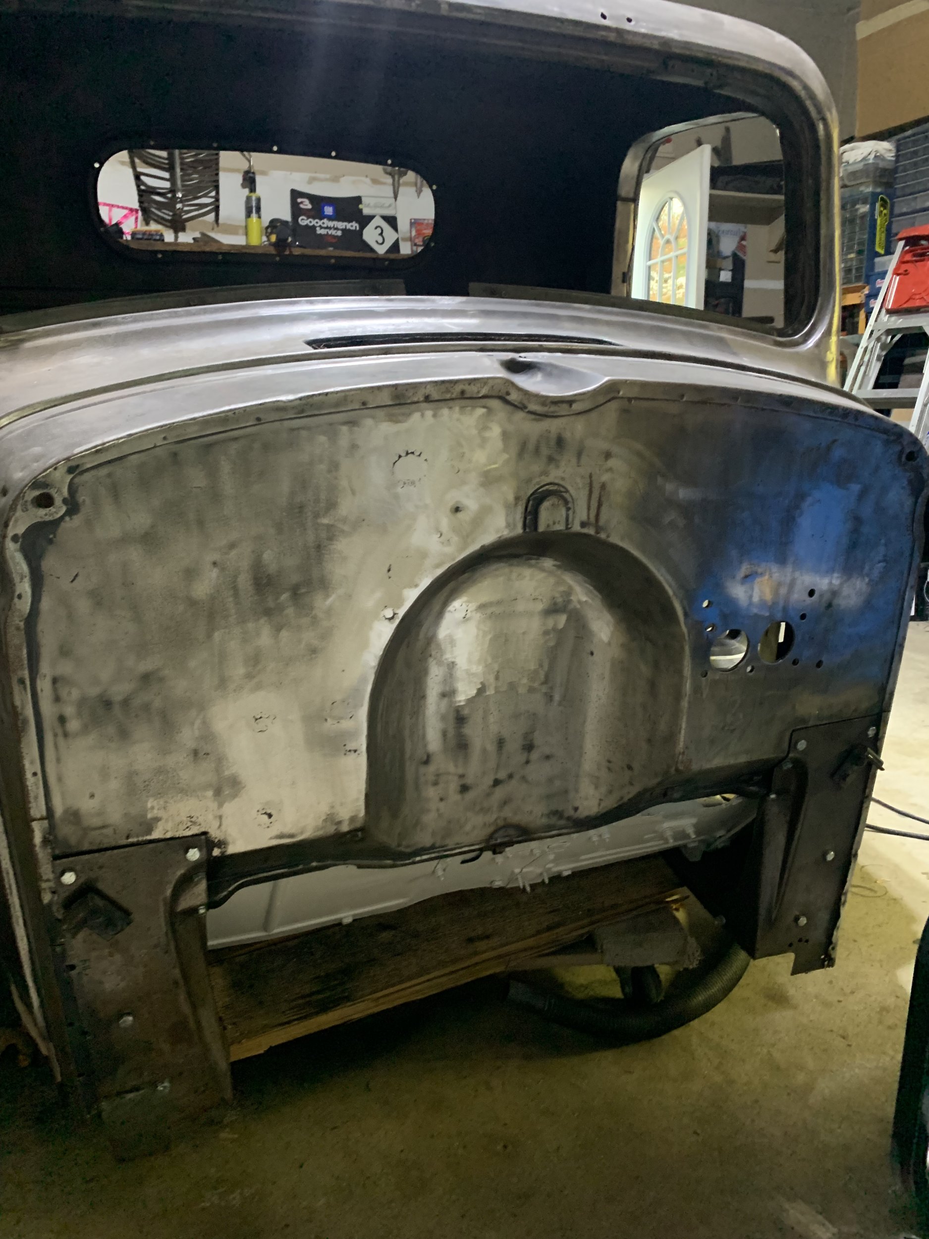

    pila38

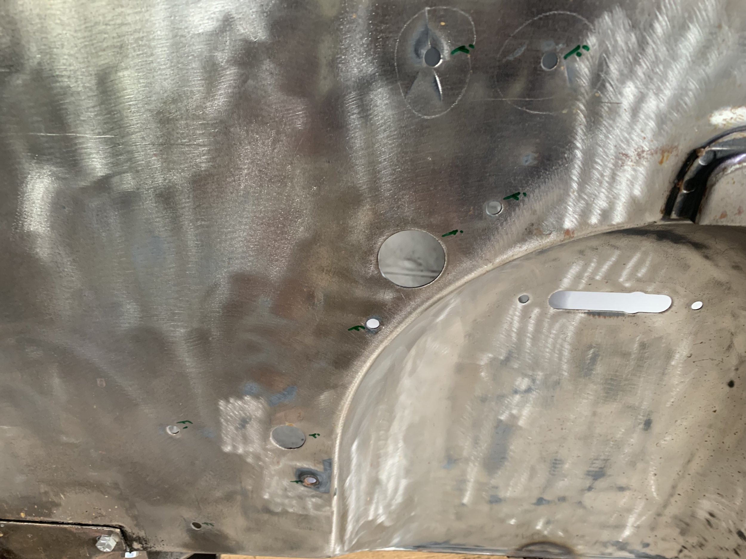

    Well…its been a bit, work has been really busy. However, I have managed to stay on this thing at night and some weekend days. I’ve just been really bad at posting (surprise, surprise). I’ll post some of the progress here now. Filled the unnecessary holes in the firewall. IMG_5044.jpeg IMG_5045.jpeg IMG_5047.jpeg IMG_5336.jpeg

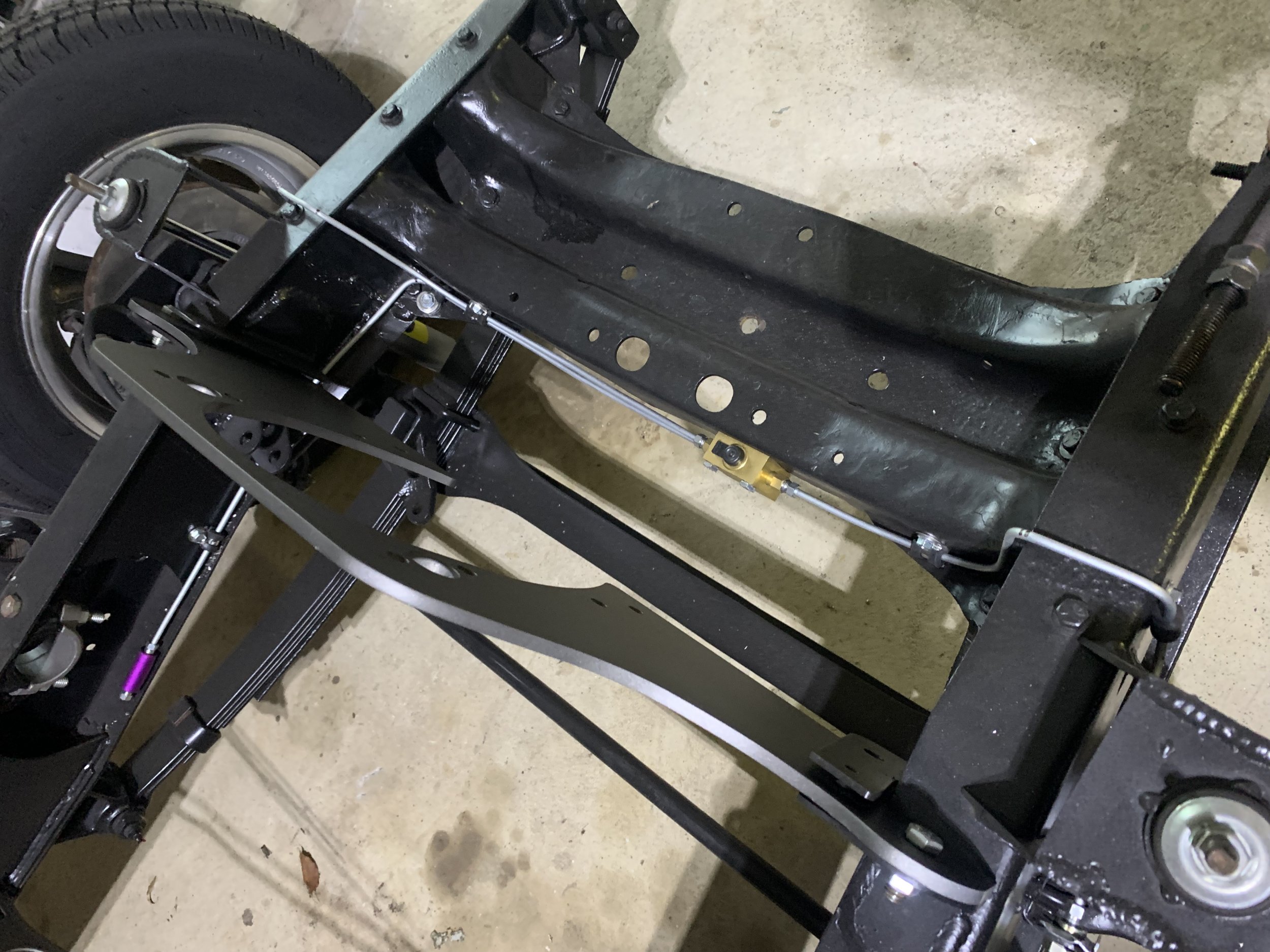

    pila38

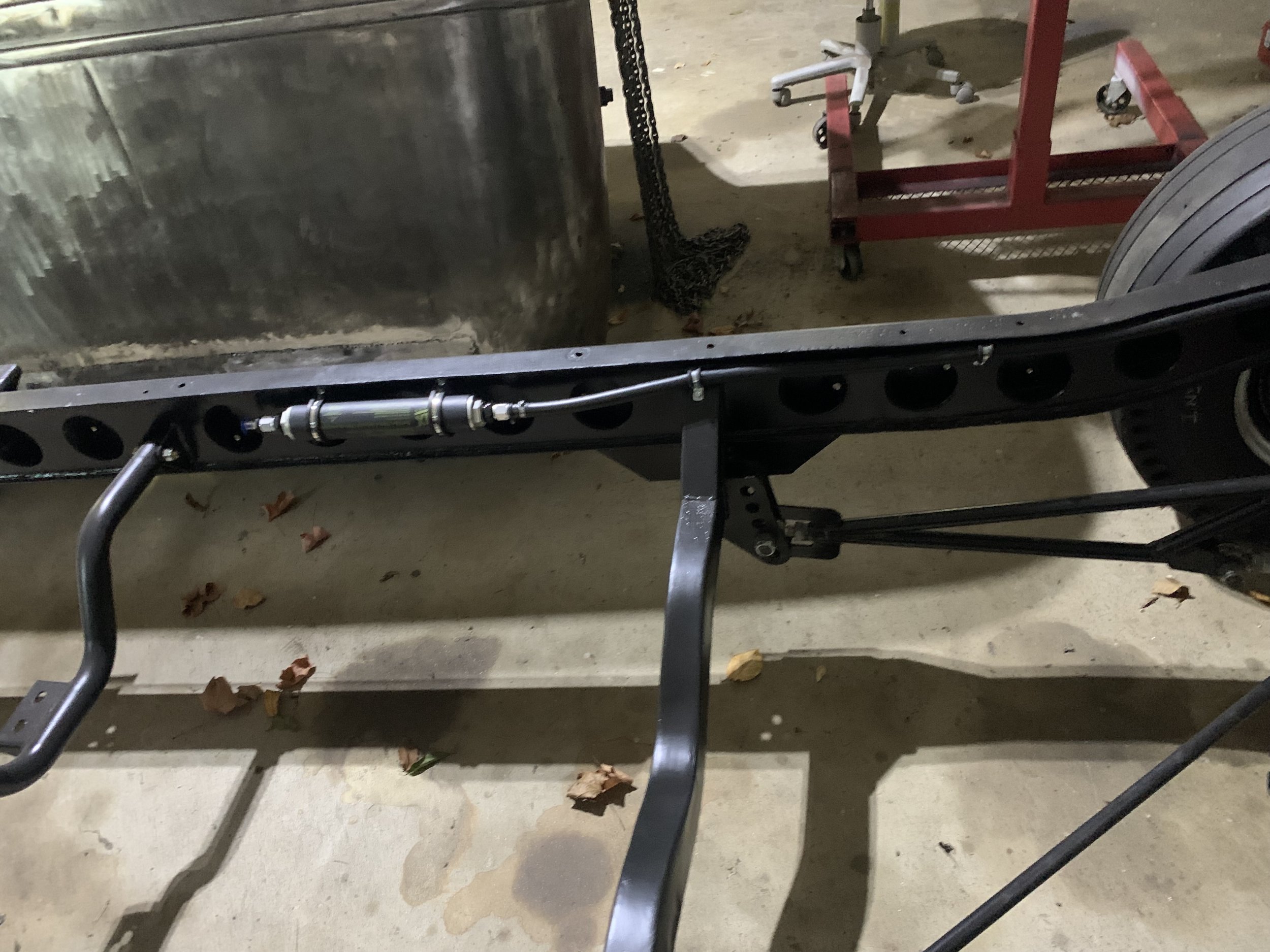

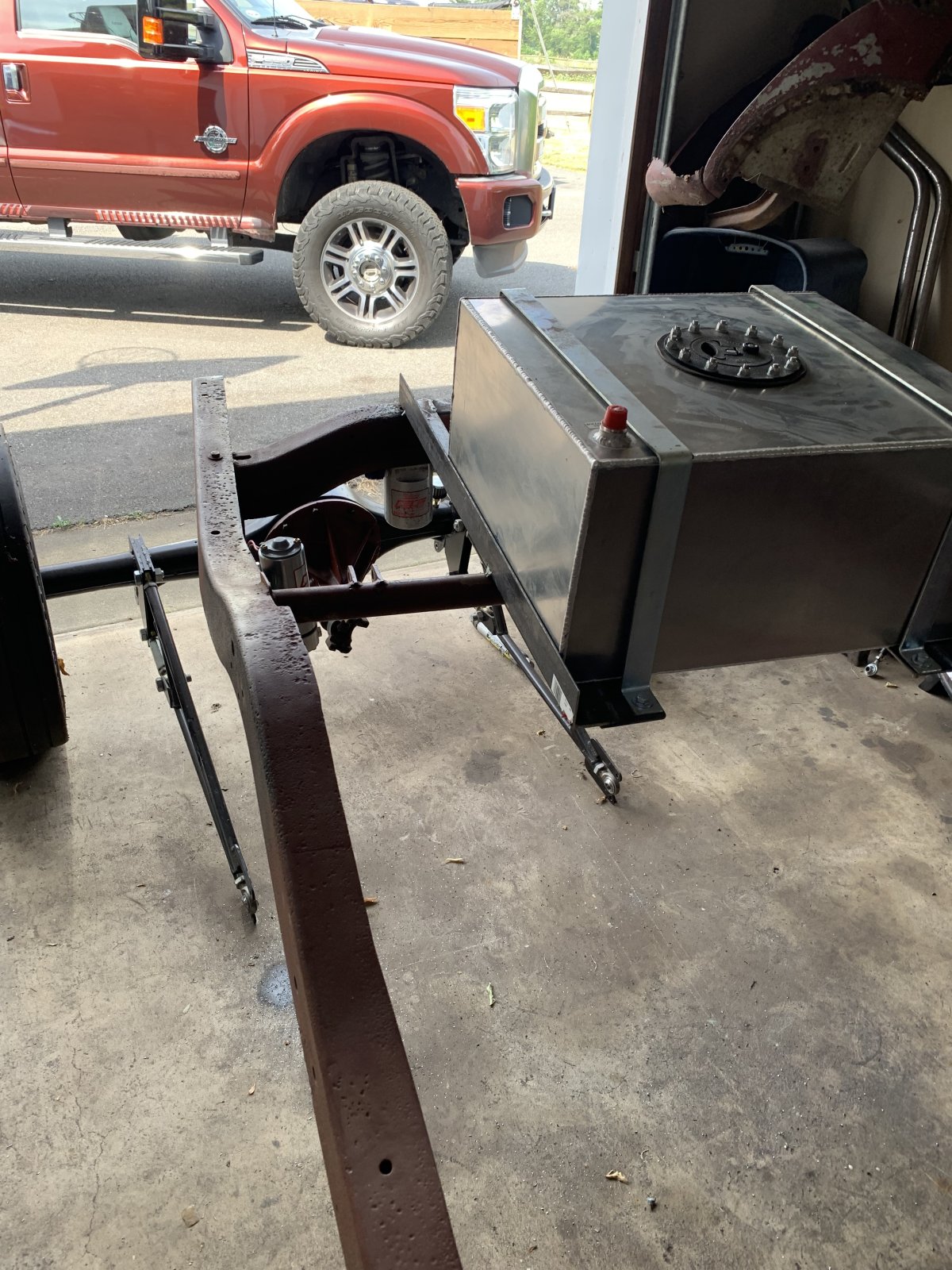

    Plumbed the ch***is for brakes and fuel. Need the cab on and engine in to finish that up. IMG_5075.jpeg IMG_5337.jpeg IMG_5338.jpeg IMG_5339.jpeg IMG_5340.jpeg IMG_5341.jpeg IMG_5342.jpeg

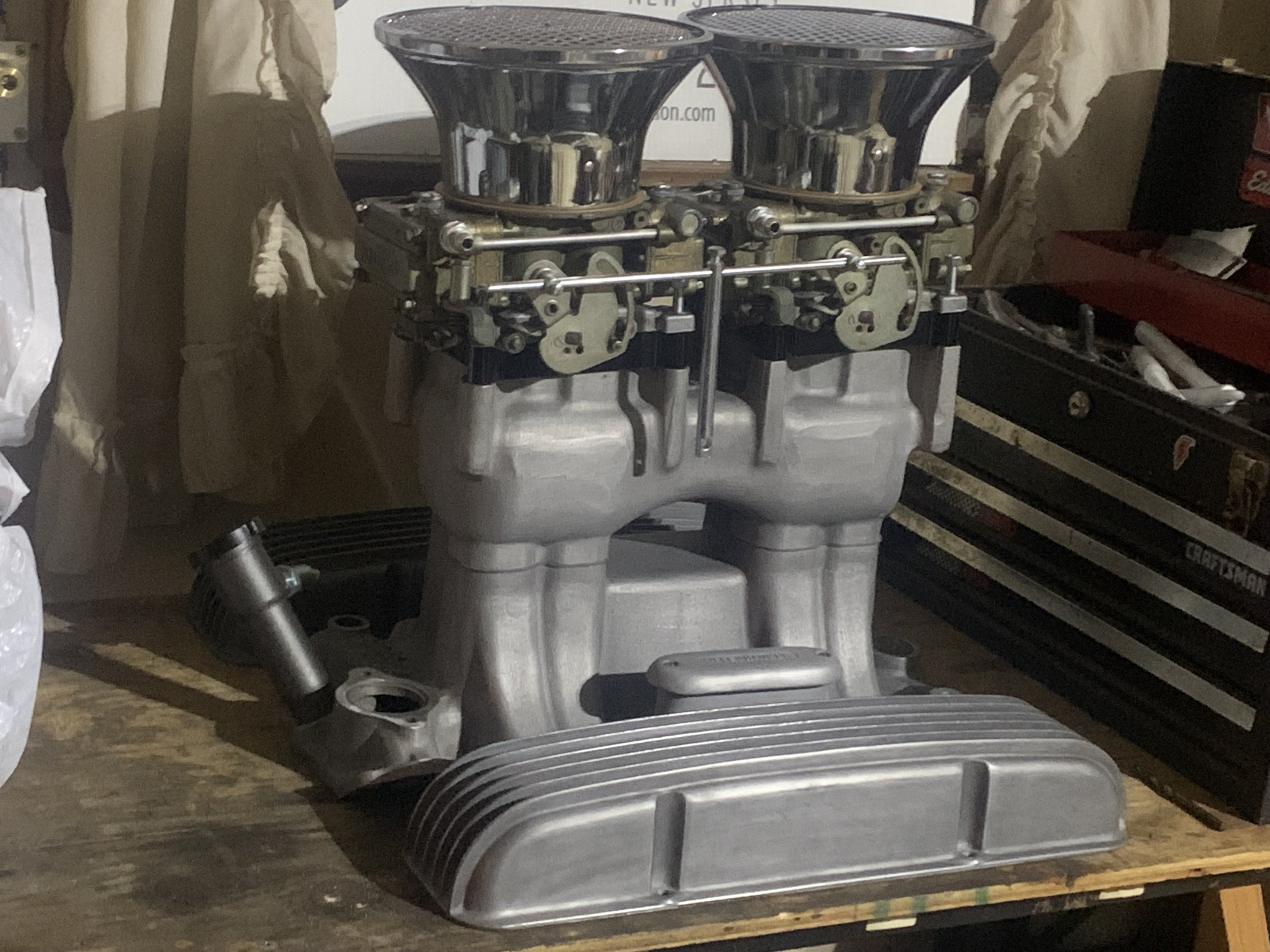

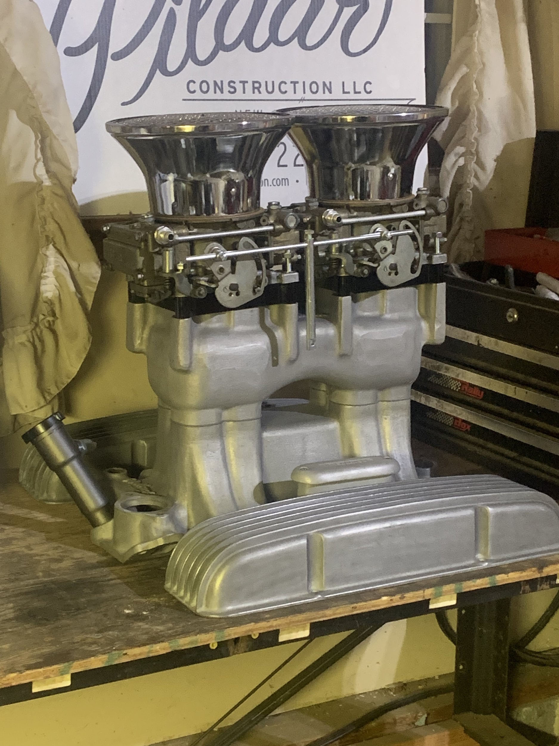

  22. pila38
    Posts: 1,097

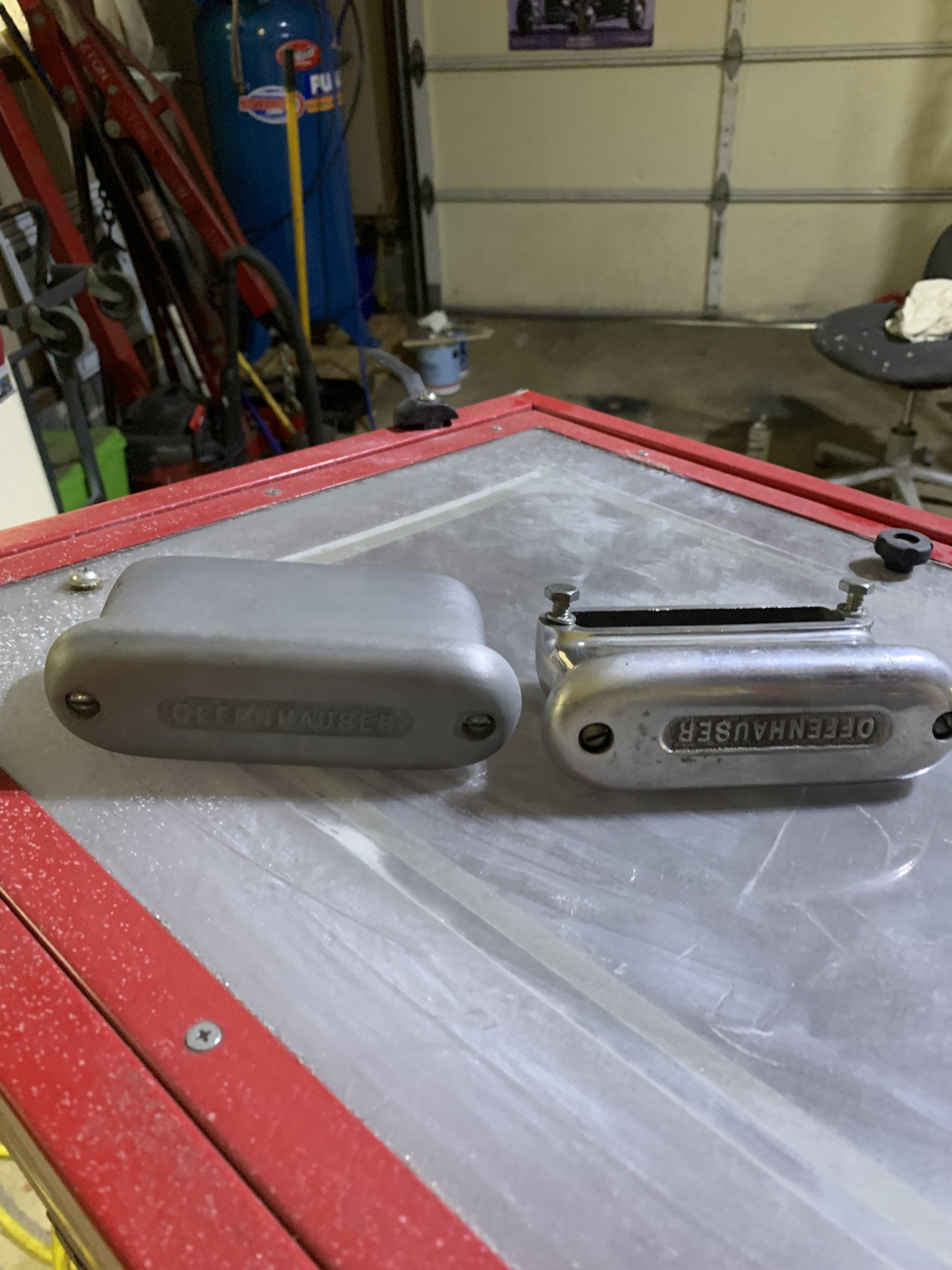

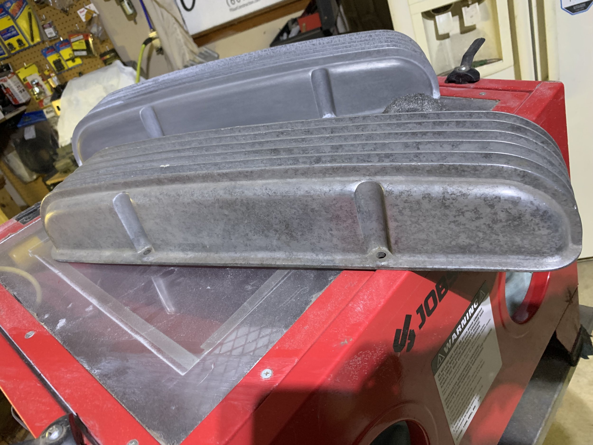

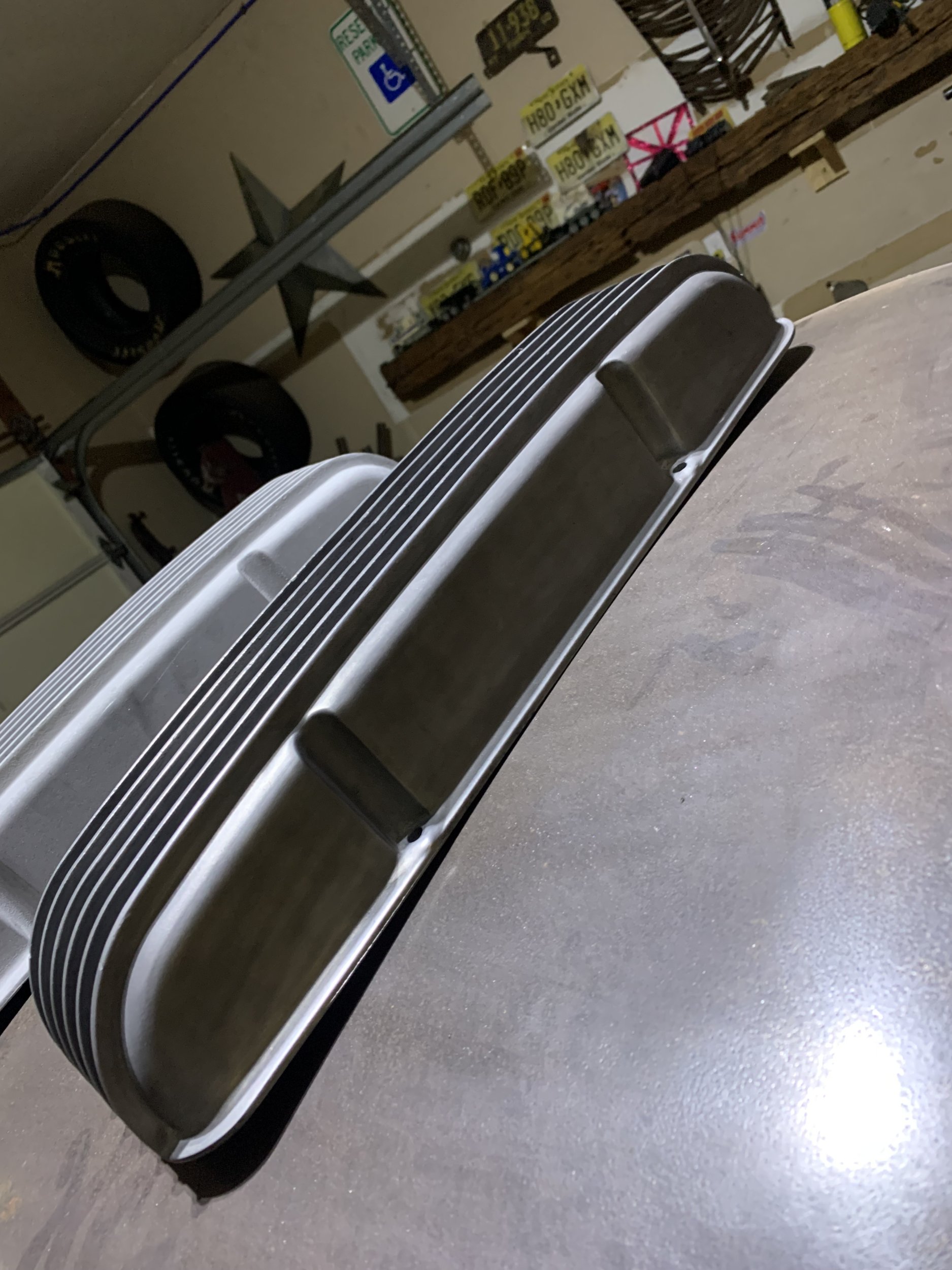

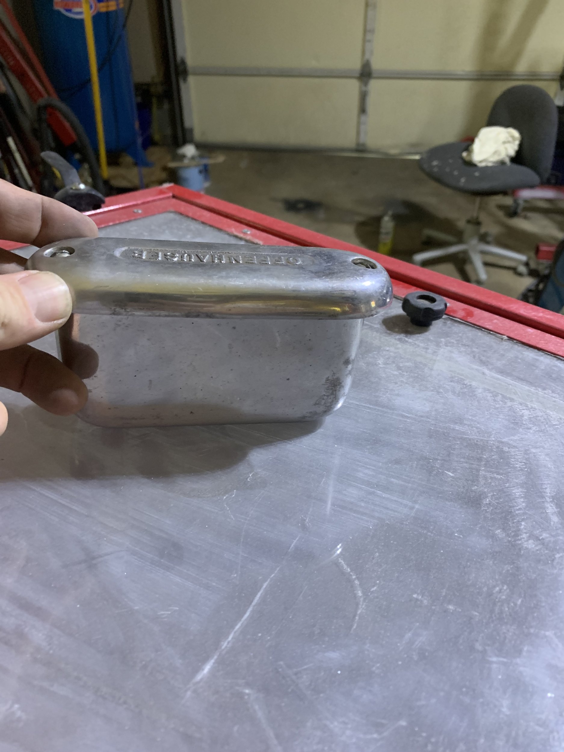

    pila38

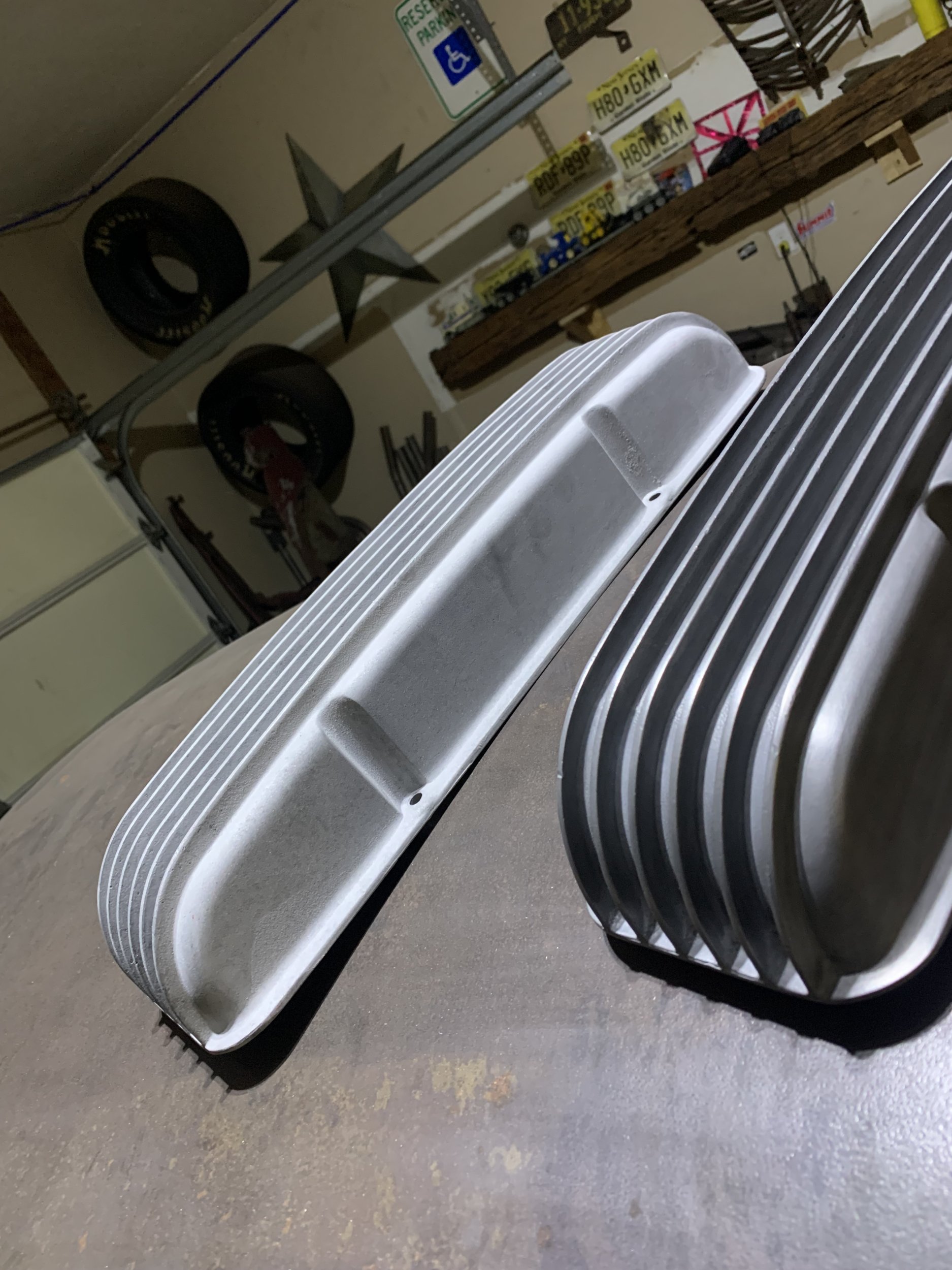

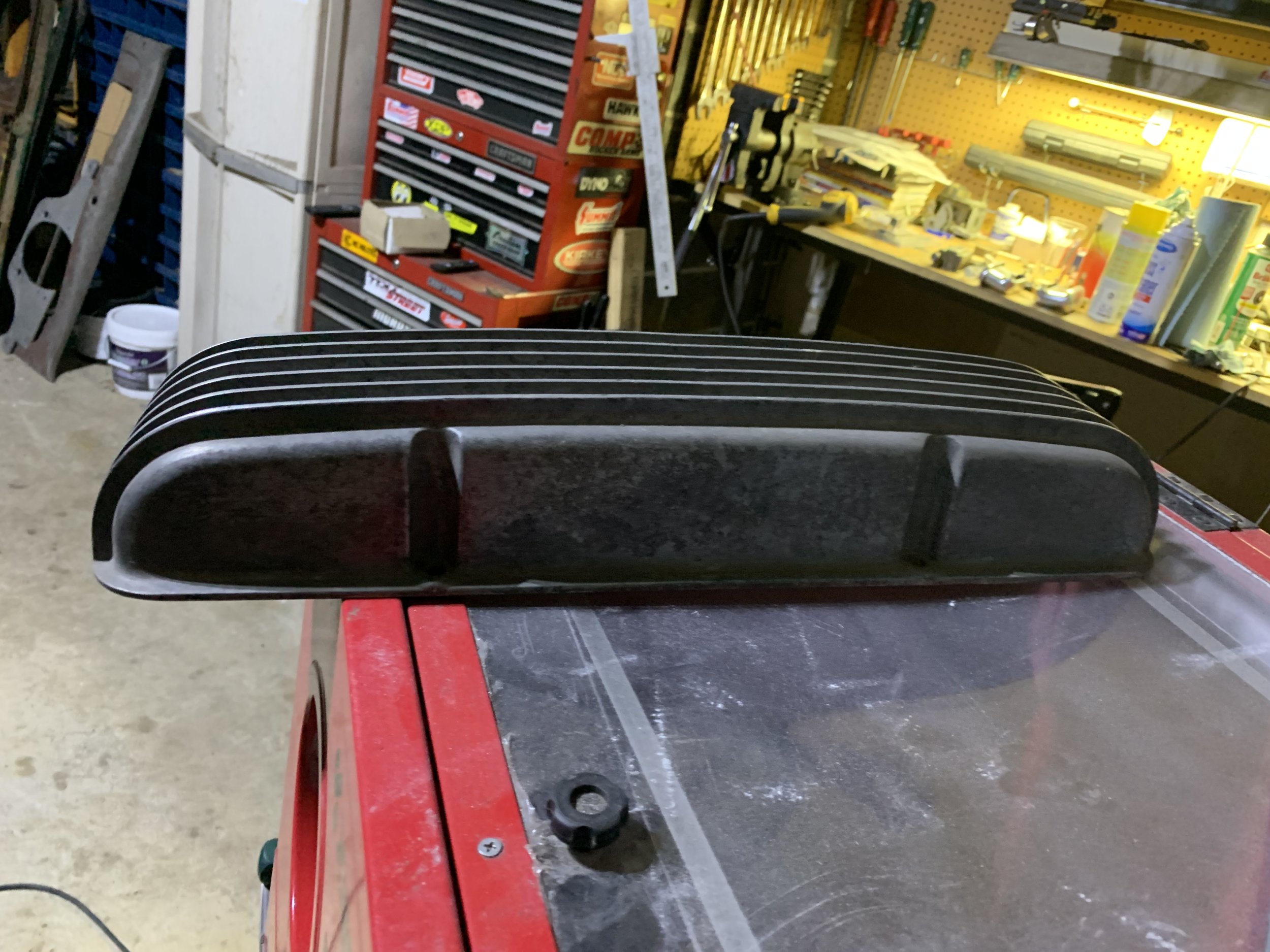

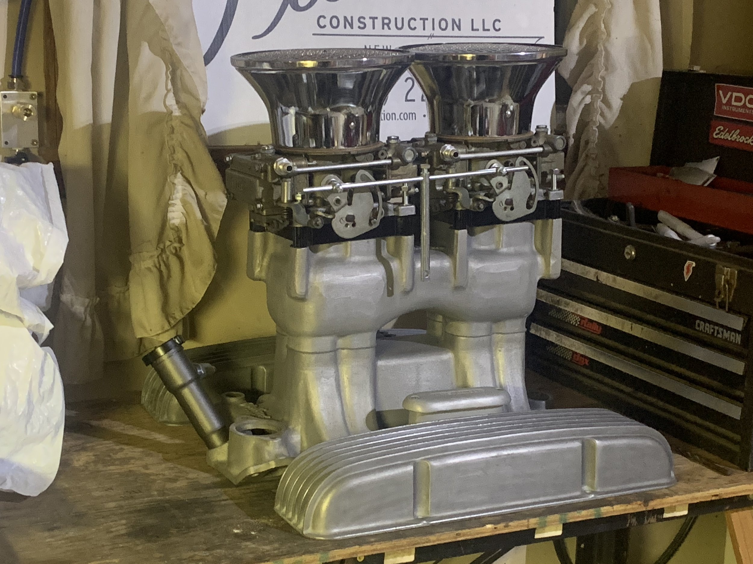

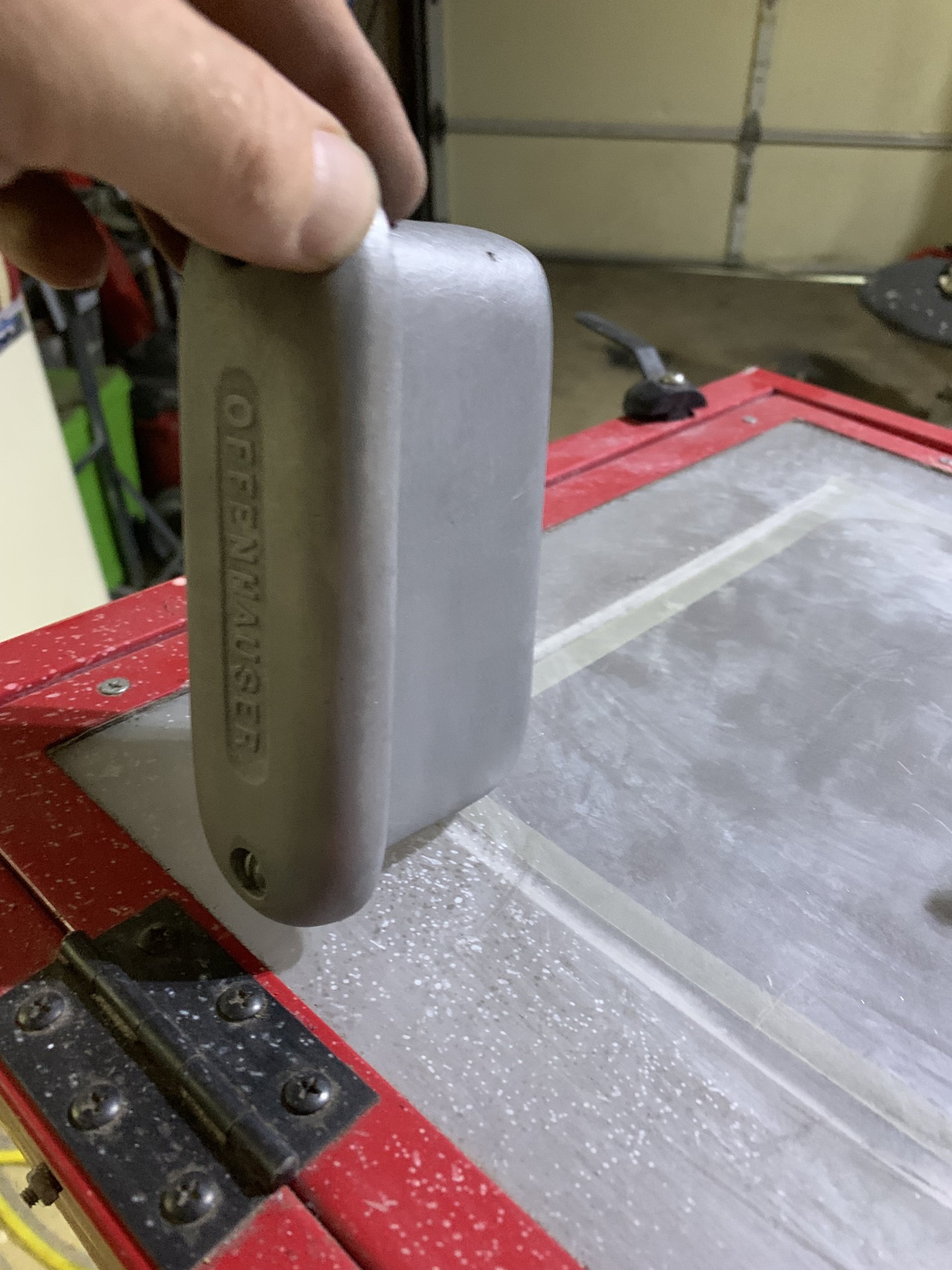

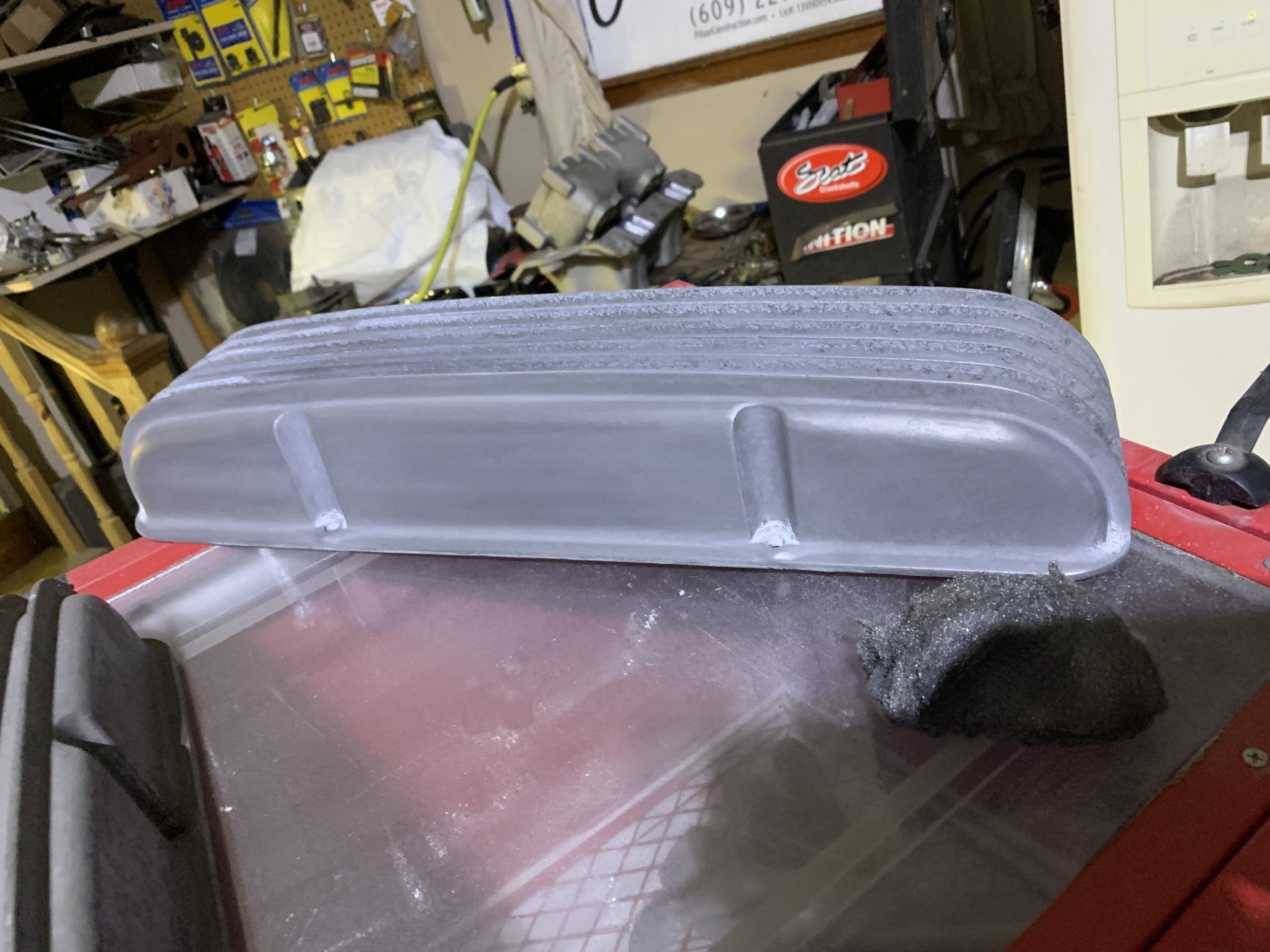

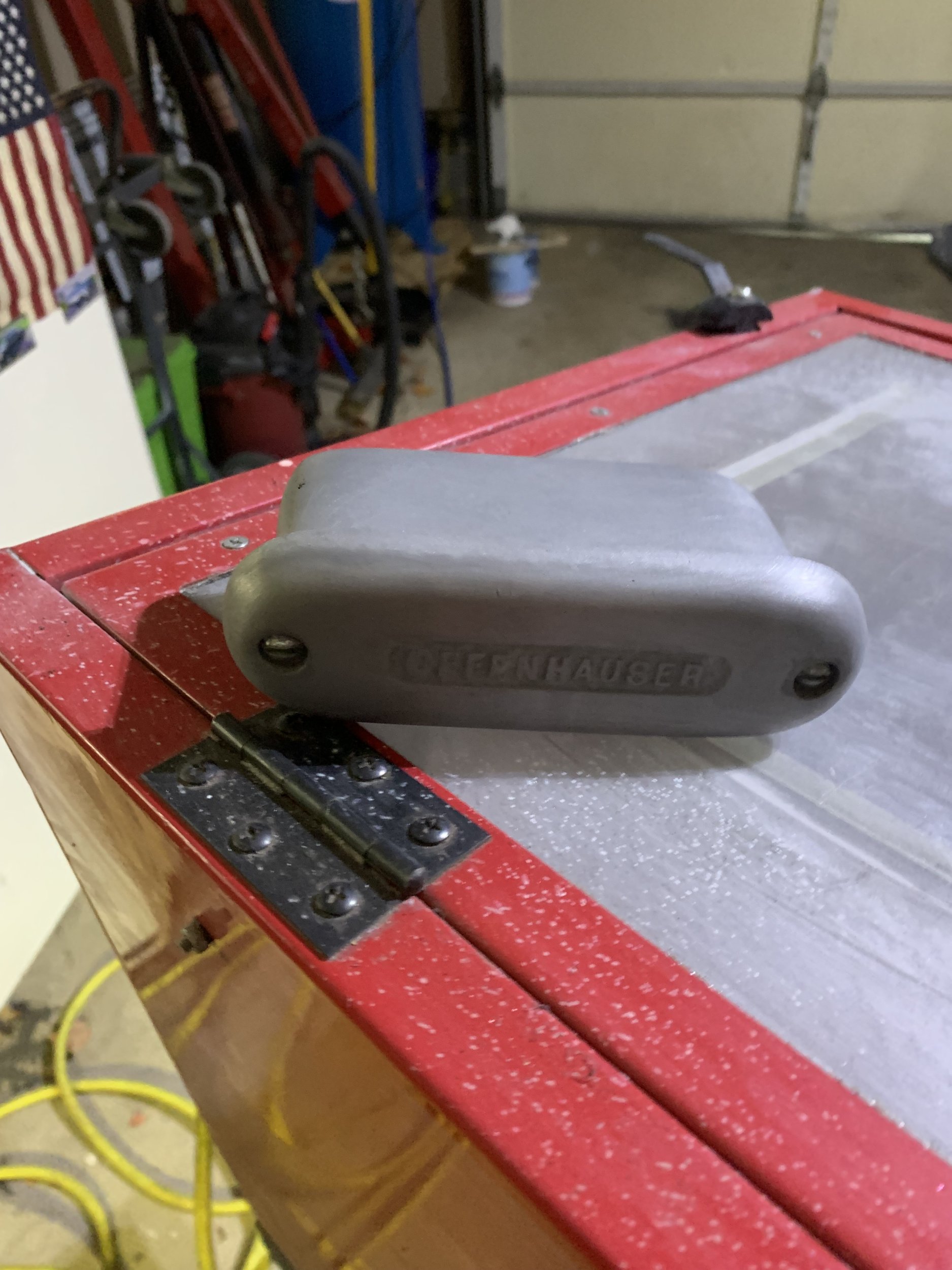

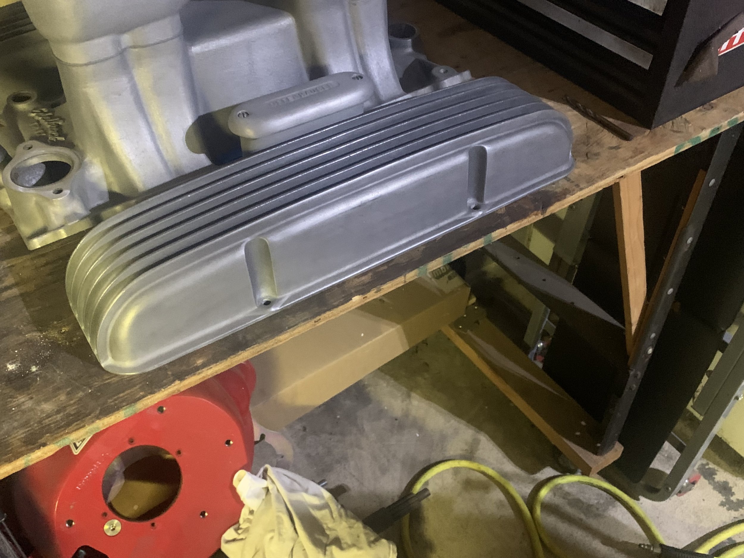

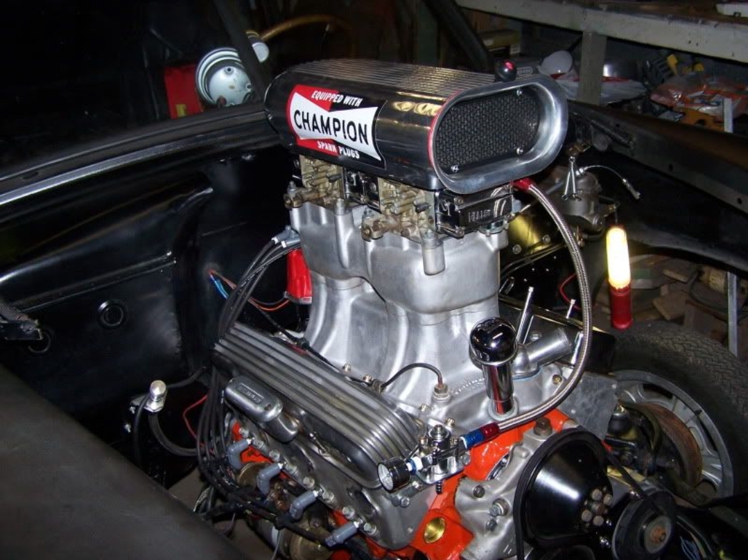

    Cleaned and aged the valve covers, breathers, and intake. May not be everybody’s cup of tea, but I wanted that no nonsense look to the aluminum. Clean, but not polished. IMG_5293.jpeg IMG_5292.jpeg IMG_5294.jpeg IMG_5295.jpeg IMG_5296.jpeg IMG_5331.jpeg IMG_5332.jpeg IMG_5333.jpeg IMG_5334.jpeg IMG_5335.jpeg IMG_5343.jpeg IMG_5344.jpeg IMG_5345.jpeg IMG_5347.jpeg Also rebuilt the carbs, so the top end is ready to go.
    LAROKE, TFoch, tb33anda3rd and 4 others like this.

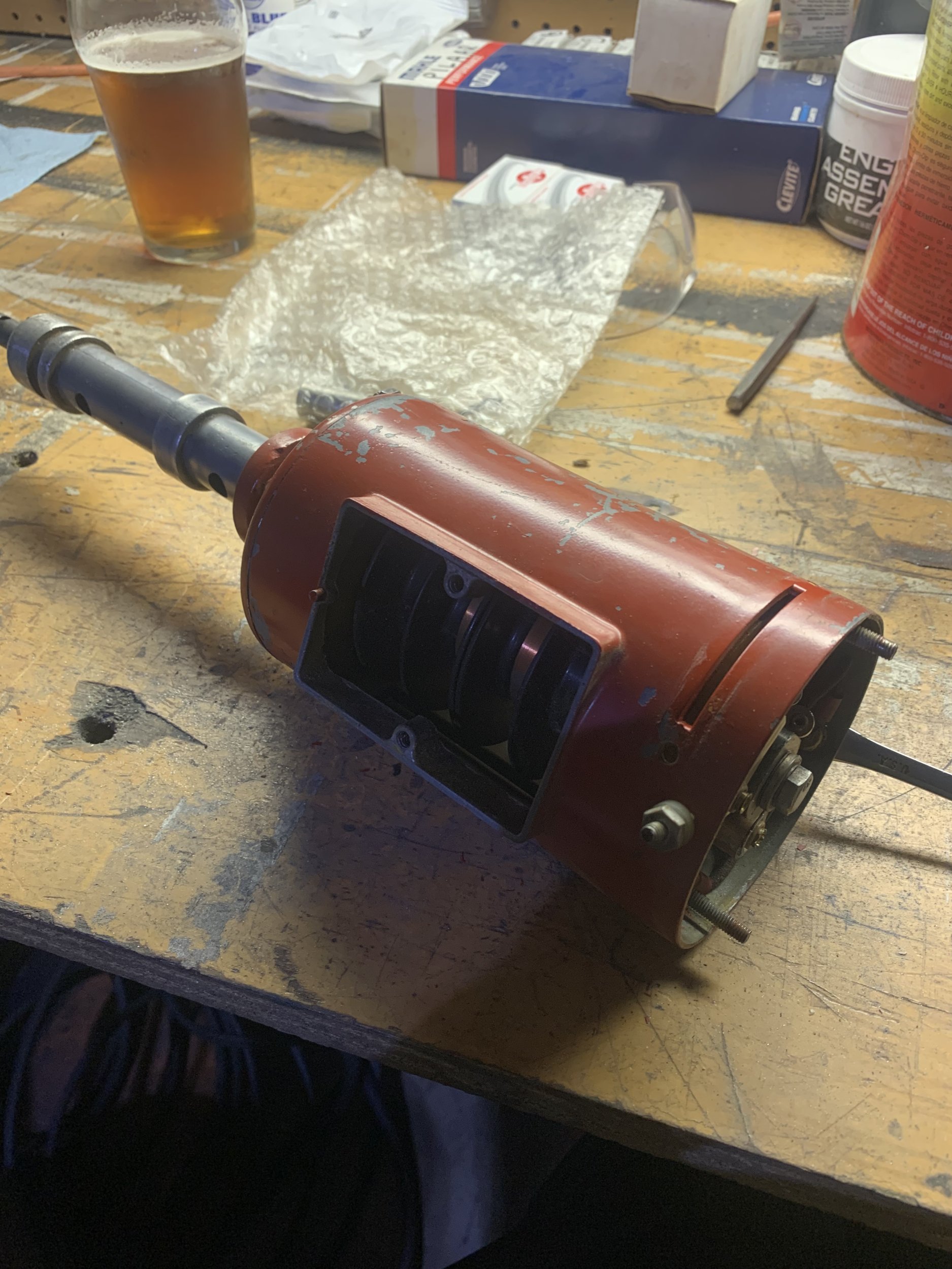

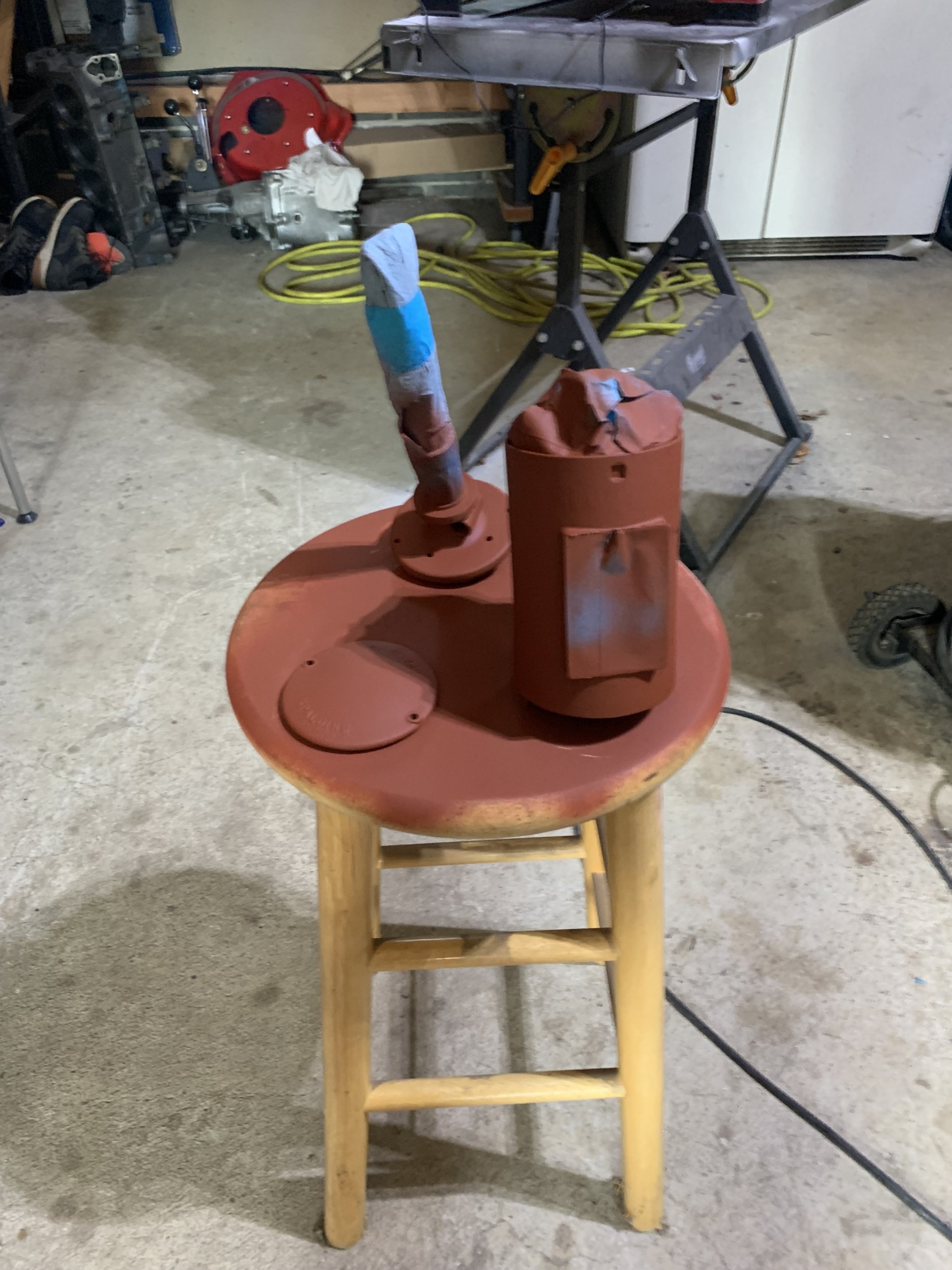

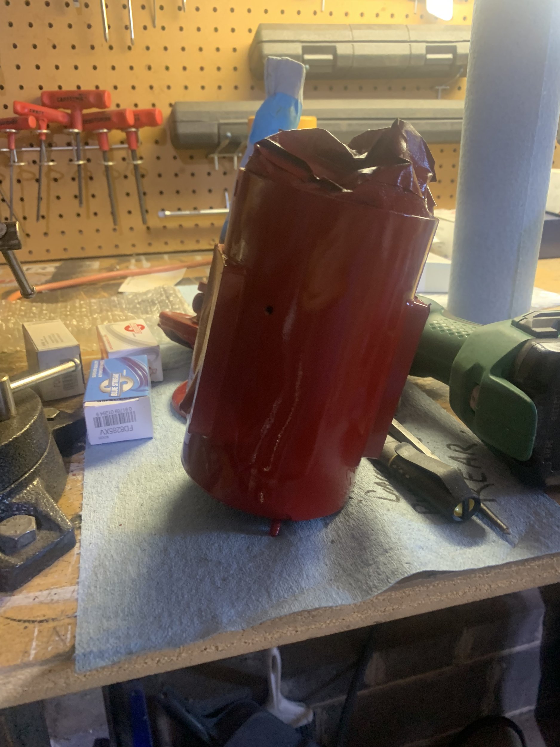

    Got the flamethrower painted this week, but had very little time in the garage this week. Oh well. IMG_5377.jpeg IMG_5389.jpeg IMG_5390.jpeg
    TFoch and loudbang like this.

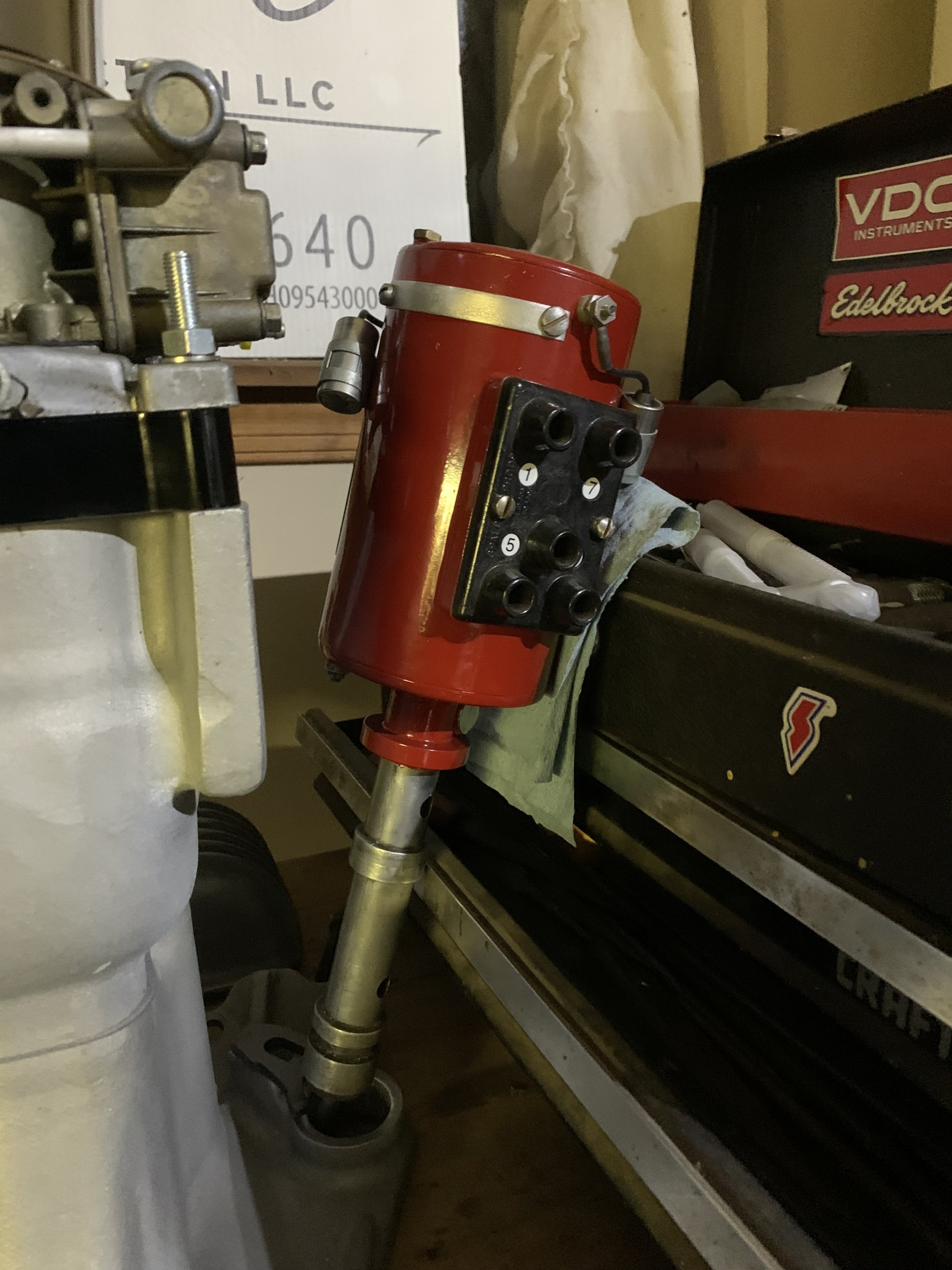

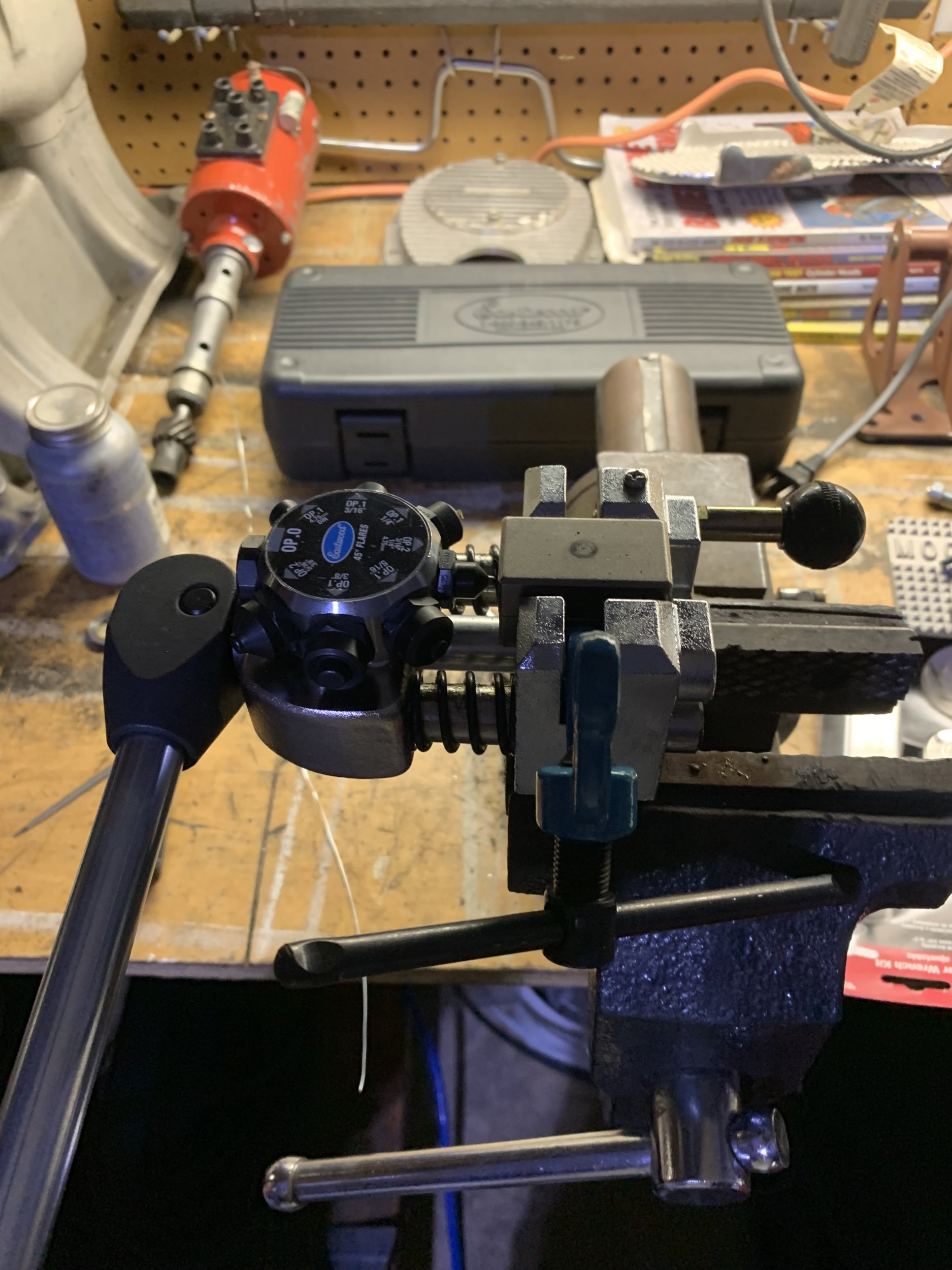

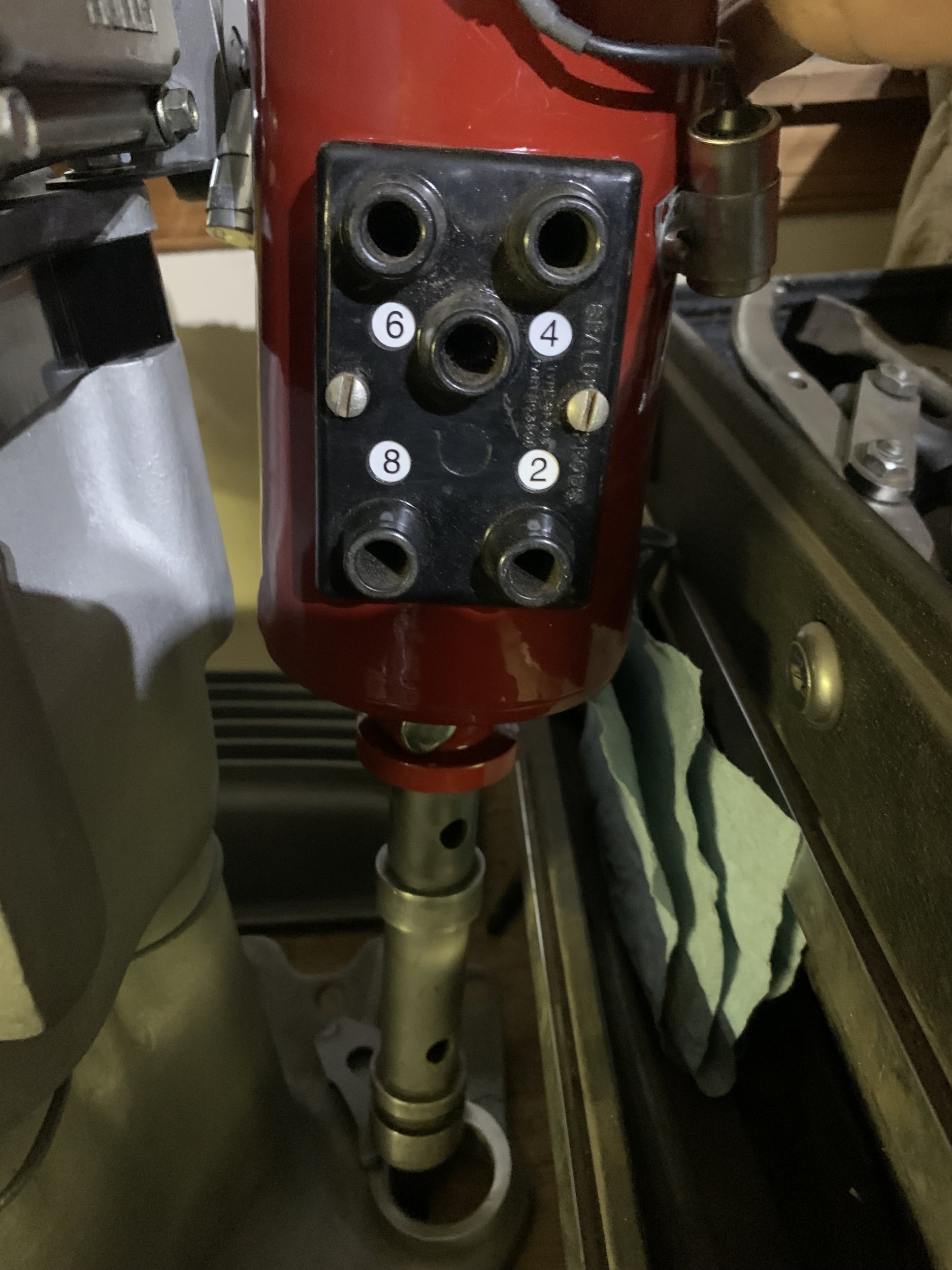

  30. pila38
    Posts: 1,097
    pila38

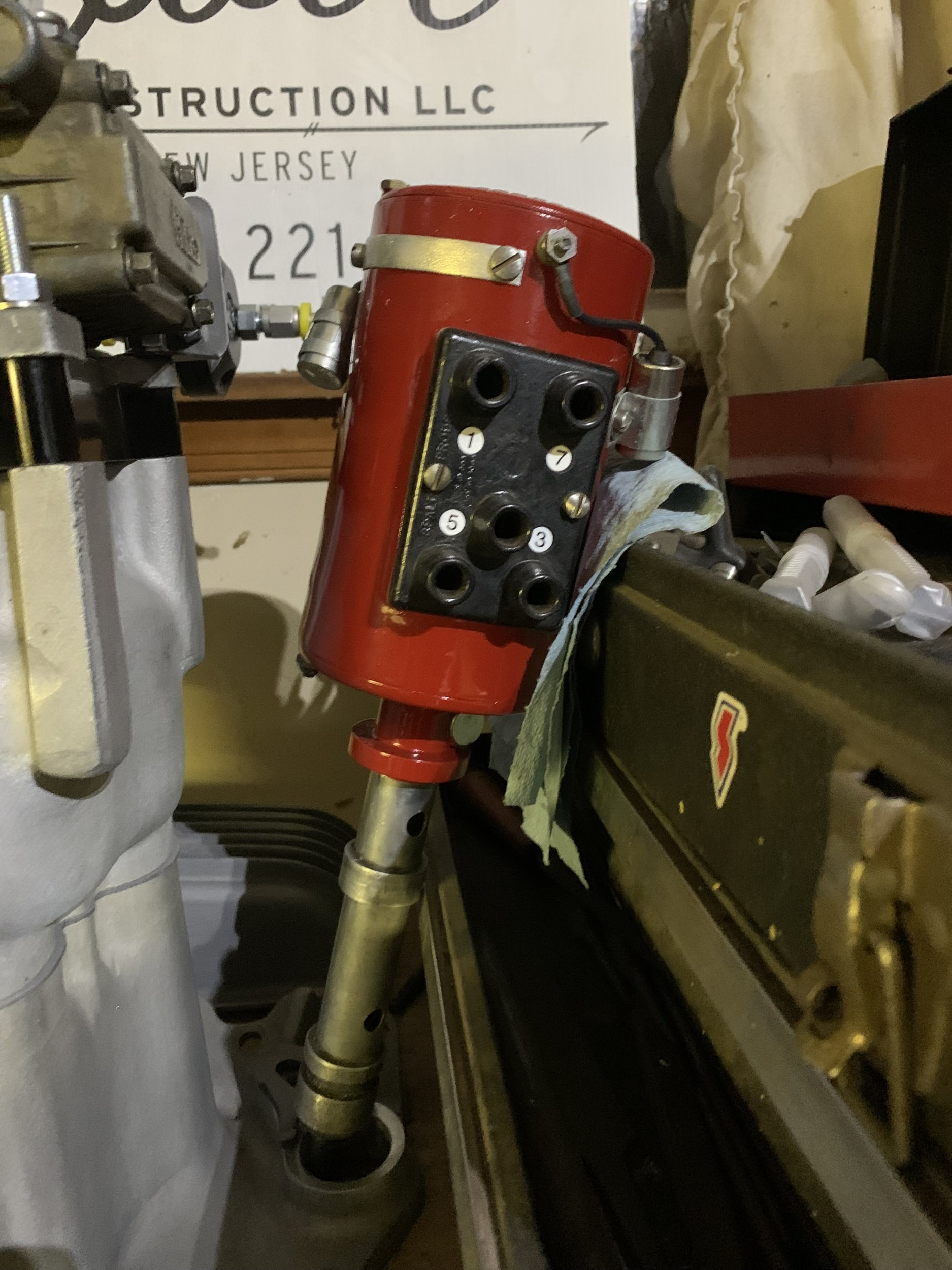

    Finished up the flamethrower. Threw some new points in and cleaned it up. Left the weights and springs as in for now, we’ll see how it runs when we get there. Still waiting on the composite gear to show up.
