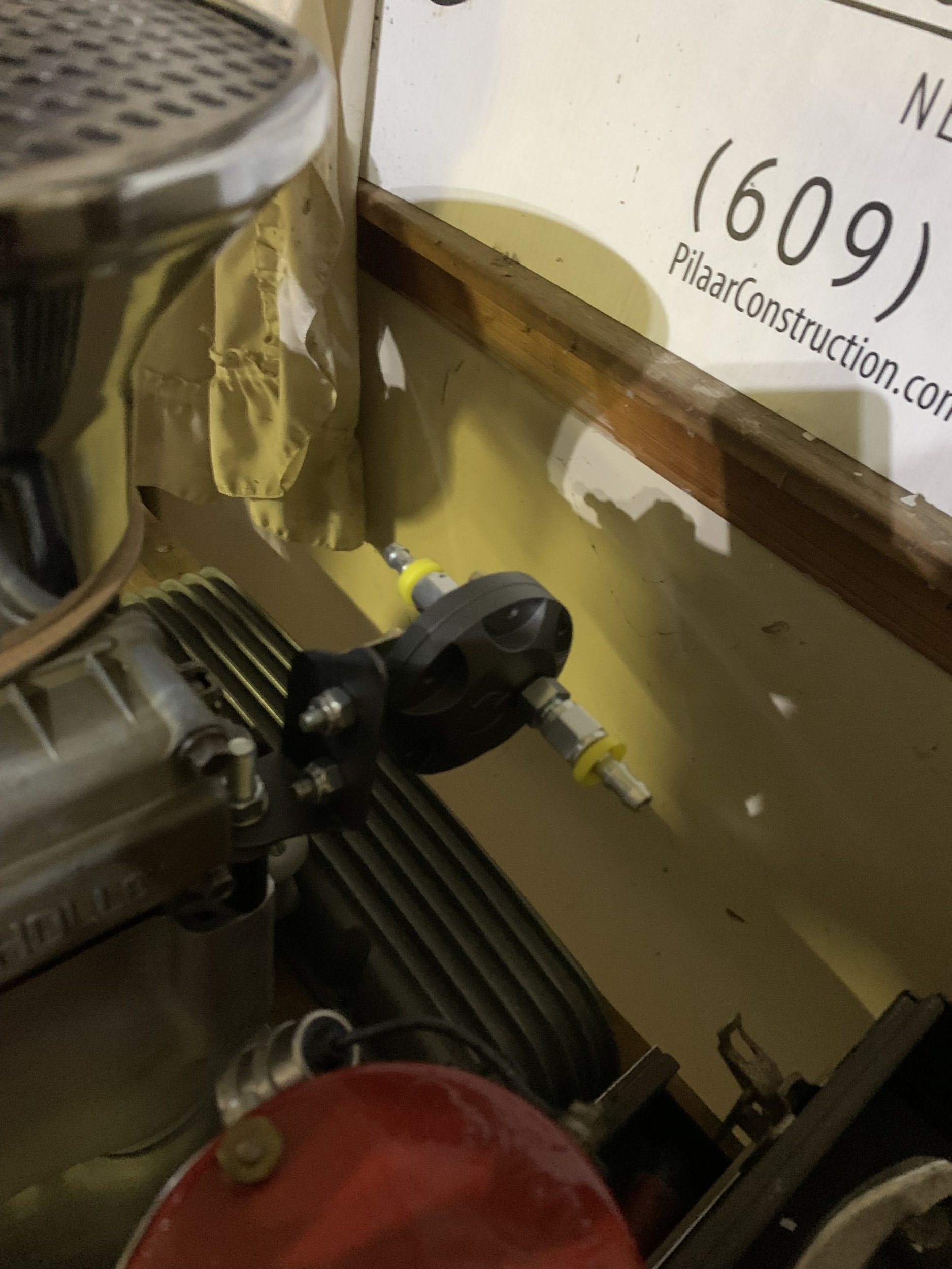

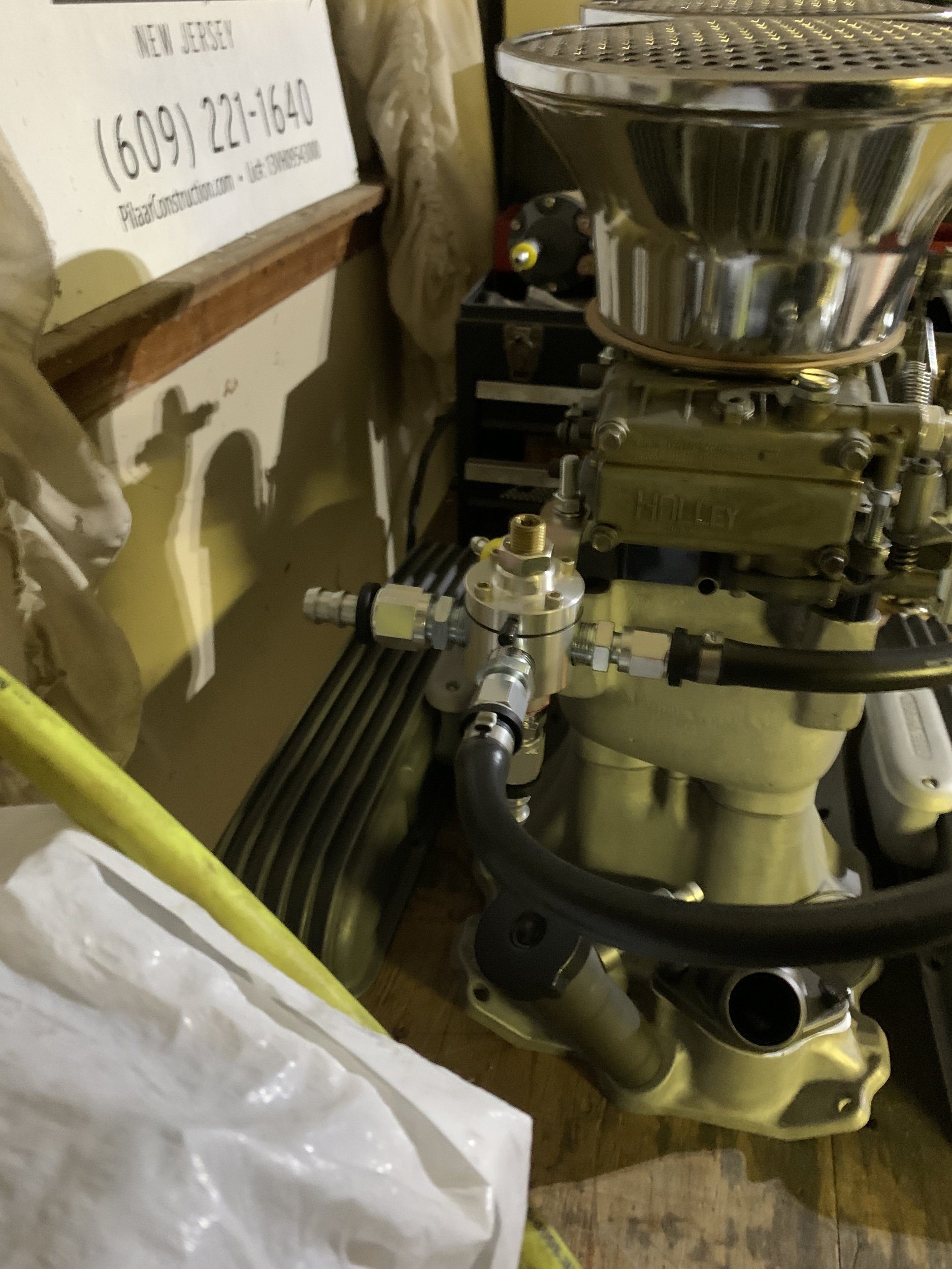

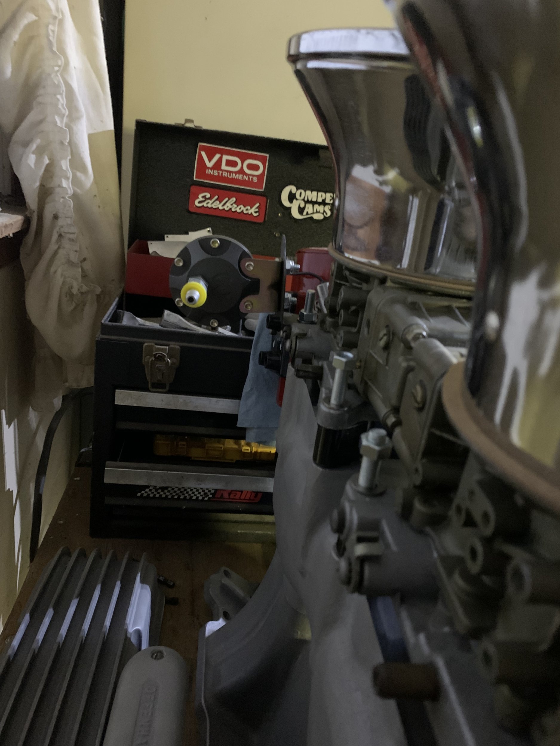

    Mounted the regulator and fuel pressure isolator (had to make a quick bracket for it). Ran most of the fuel lines up top, but need a fitting for the isolator hose.

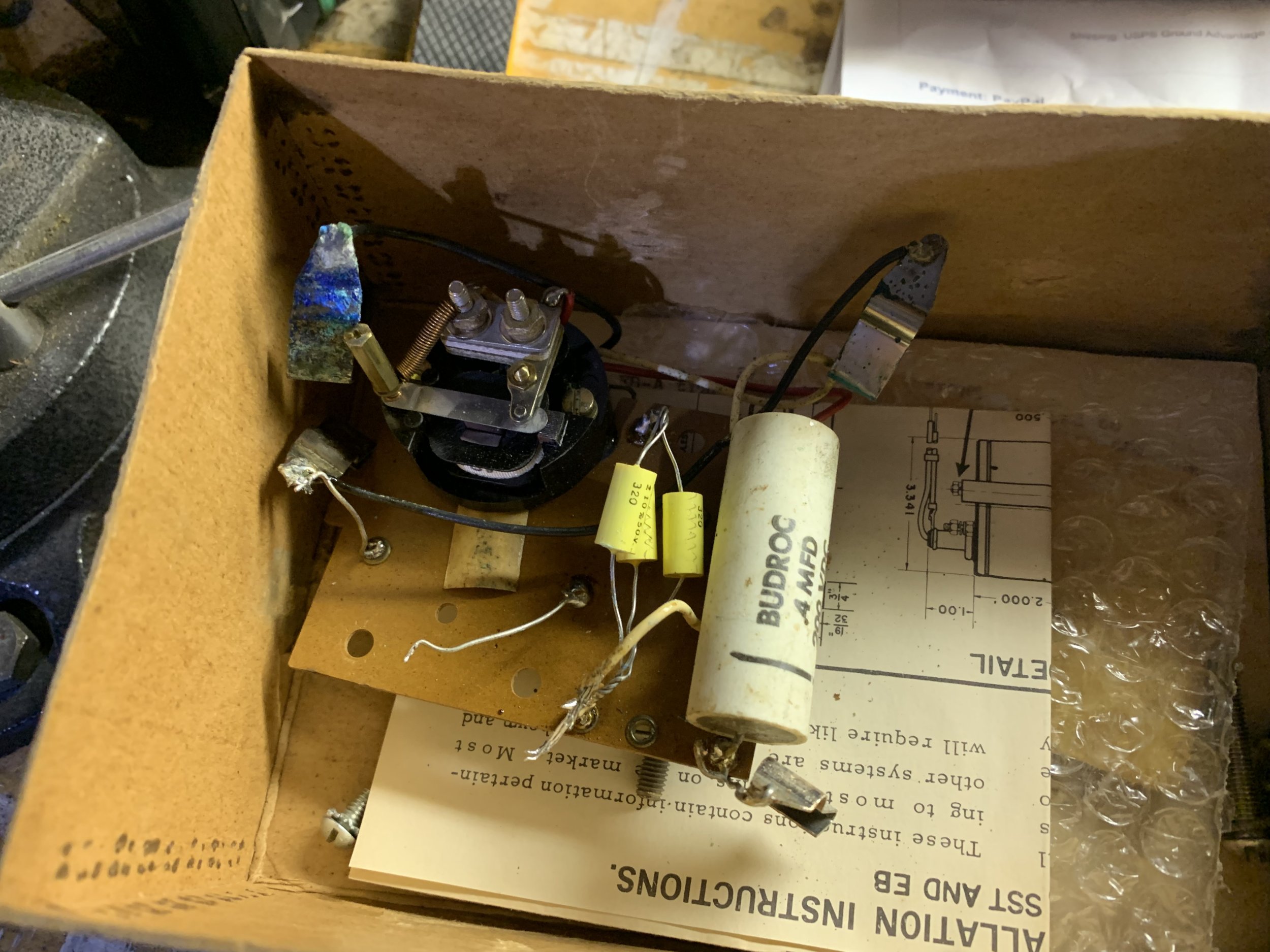

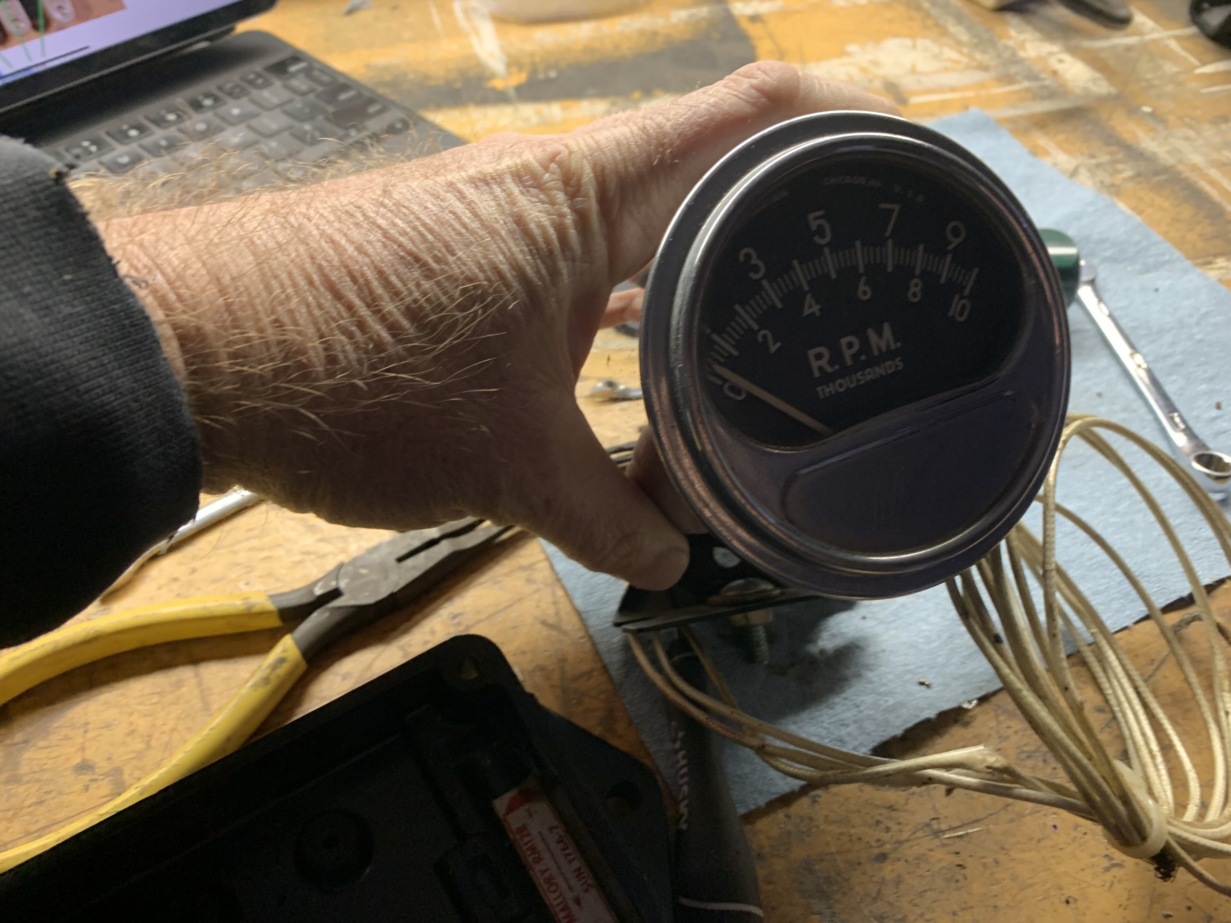

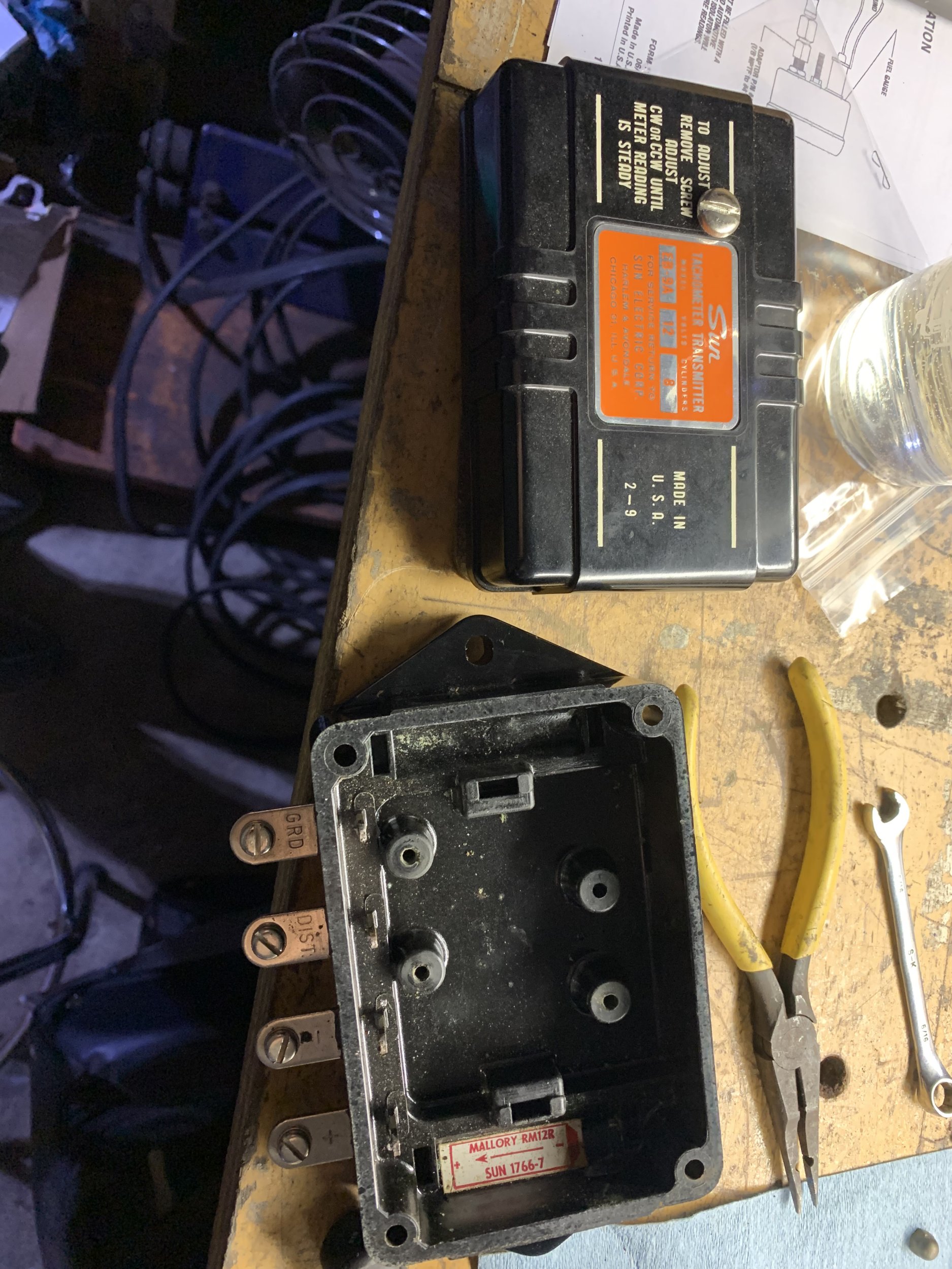

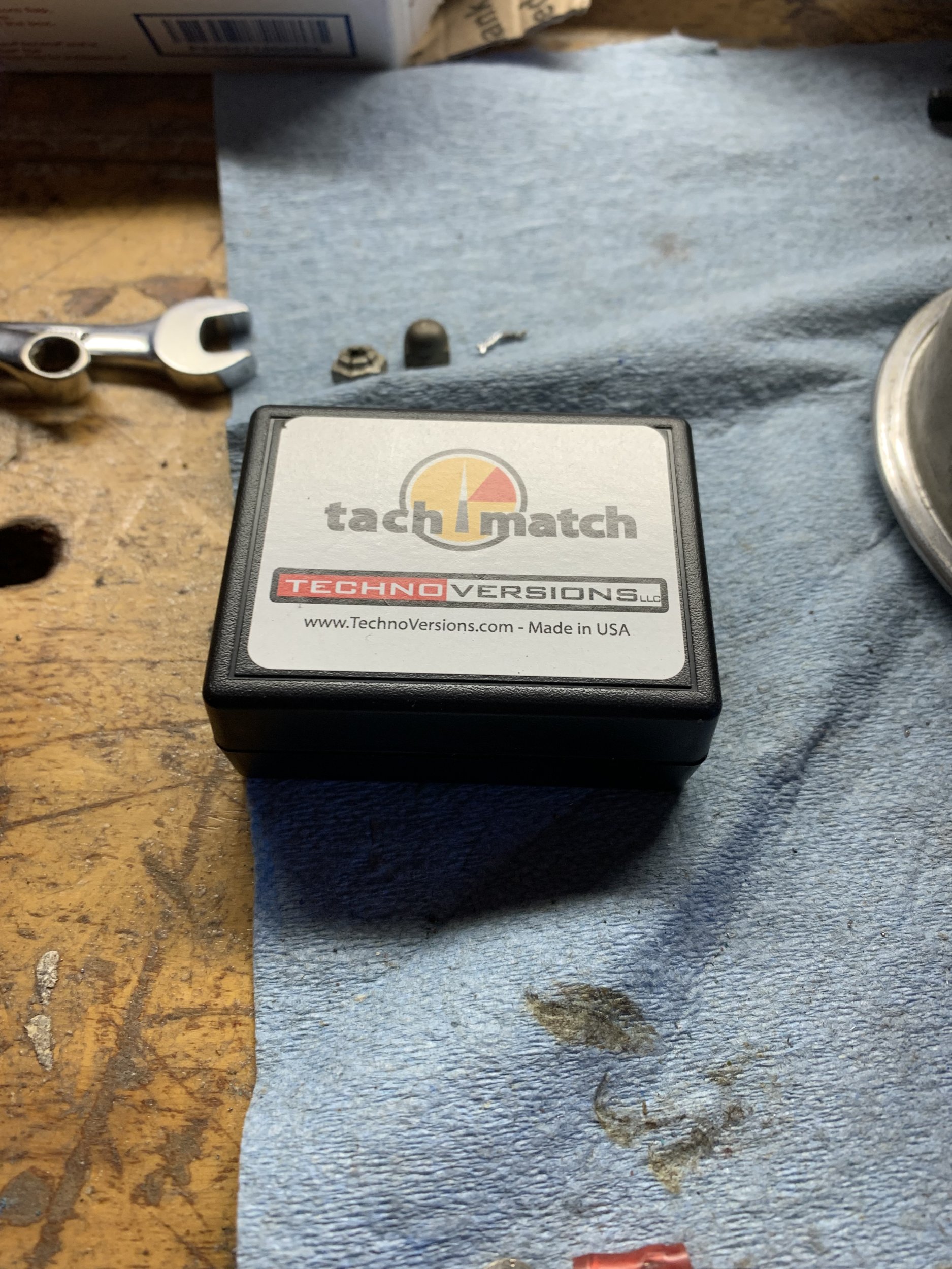

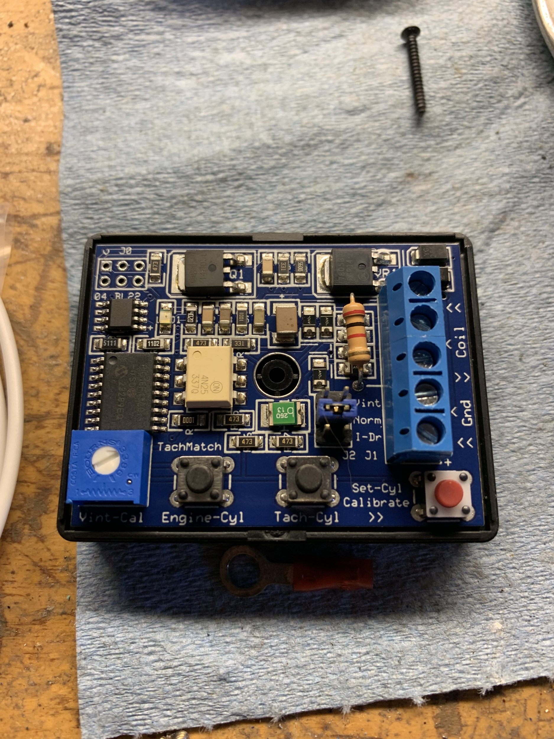

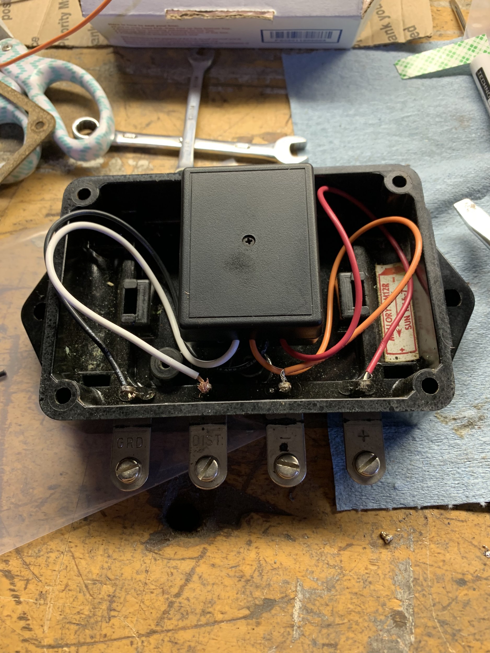

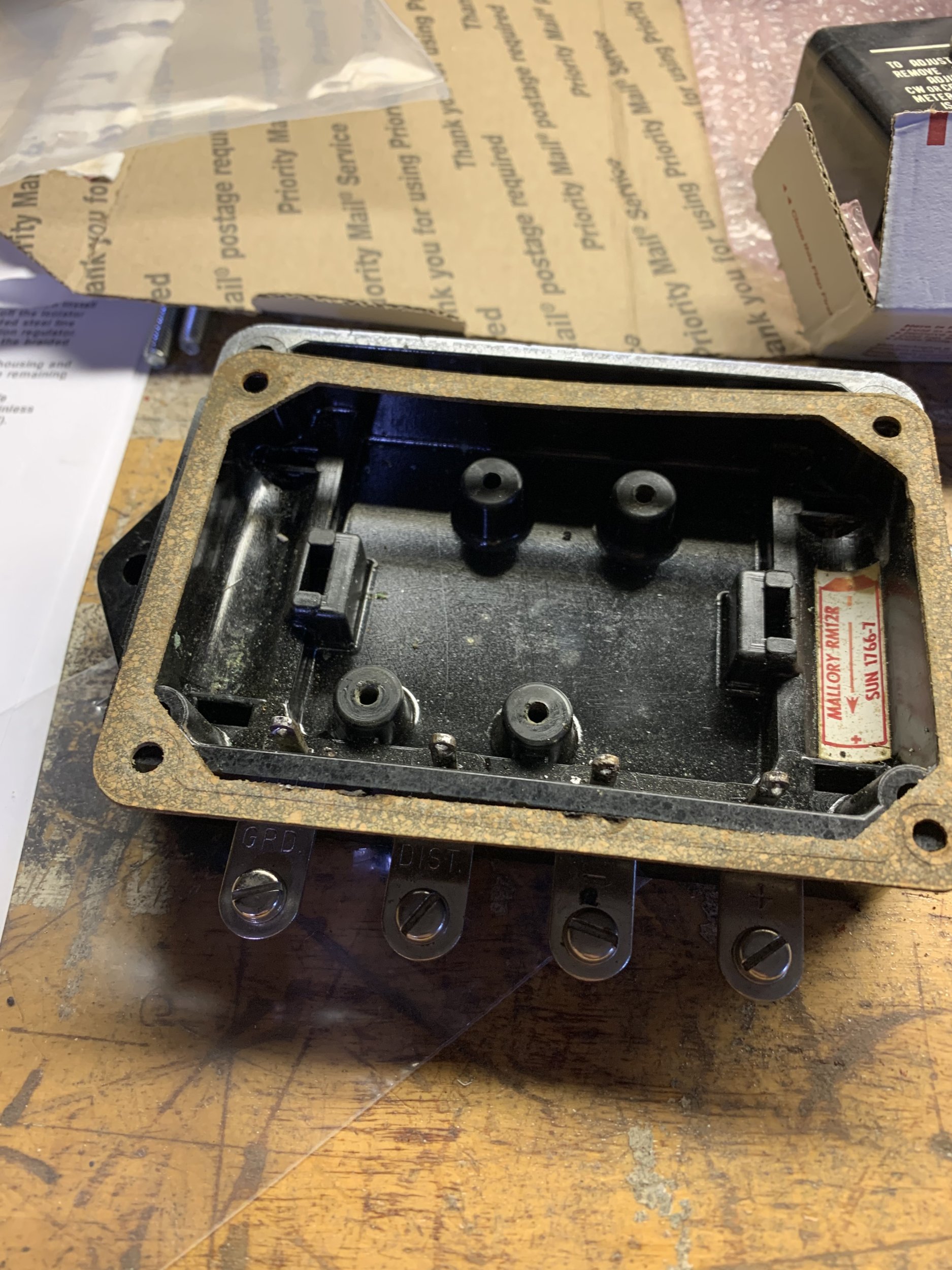

    Now I’m working on modernizing my old Sun tach parts. Using TechnoVersions TachMatch inside the EB9A box. It will allow the Flamethrower, which needs a 4 cylinder tach reading, to send the proper signal to the Sun 10K tach. Just need to solder the connections and ****on it back up. IMG_5423.jpeg IMG_5425.jpeg IMG_5422.jpeg IMG_5424.jpeg IMG_5440.jpeg IMG_5442.jpeg IMG_5441.jpeg IMG_5443.jpeg

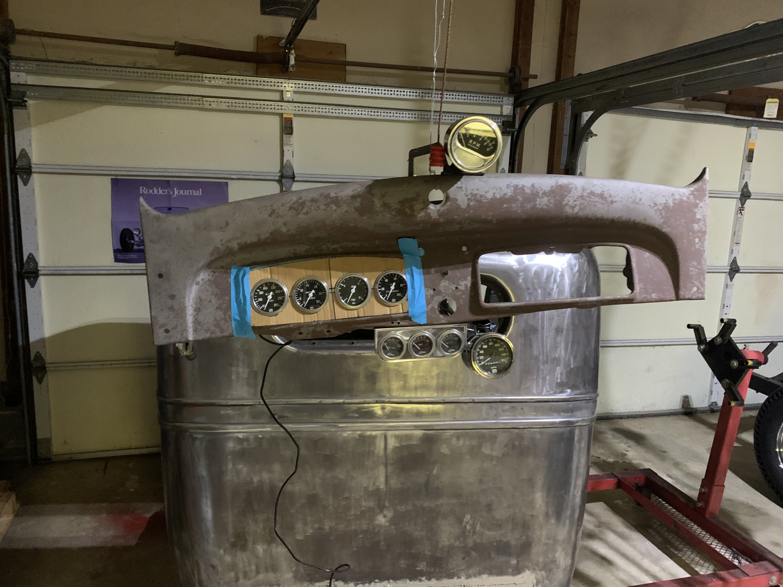

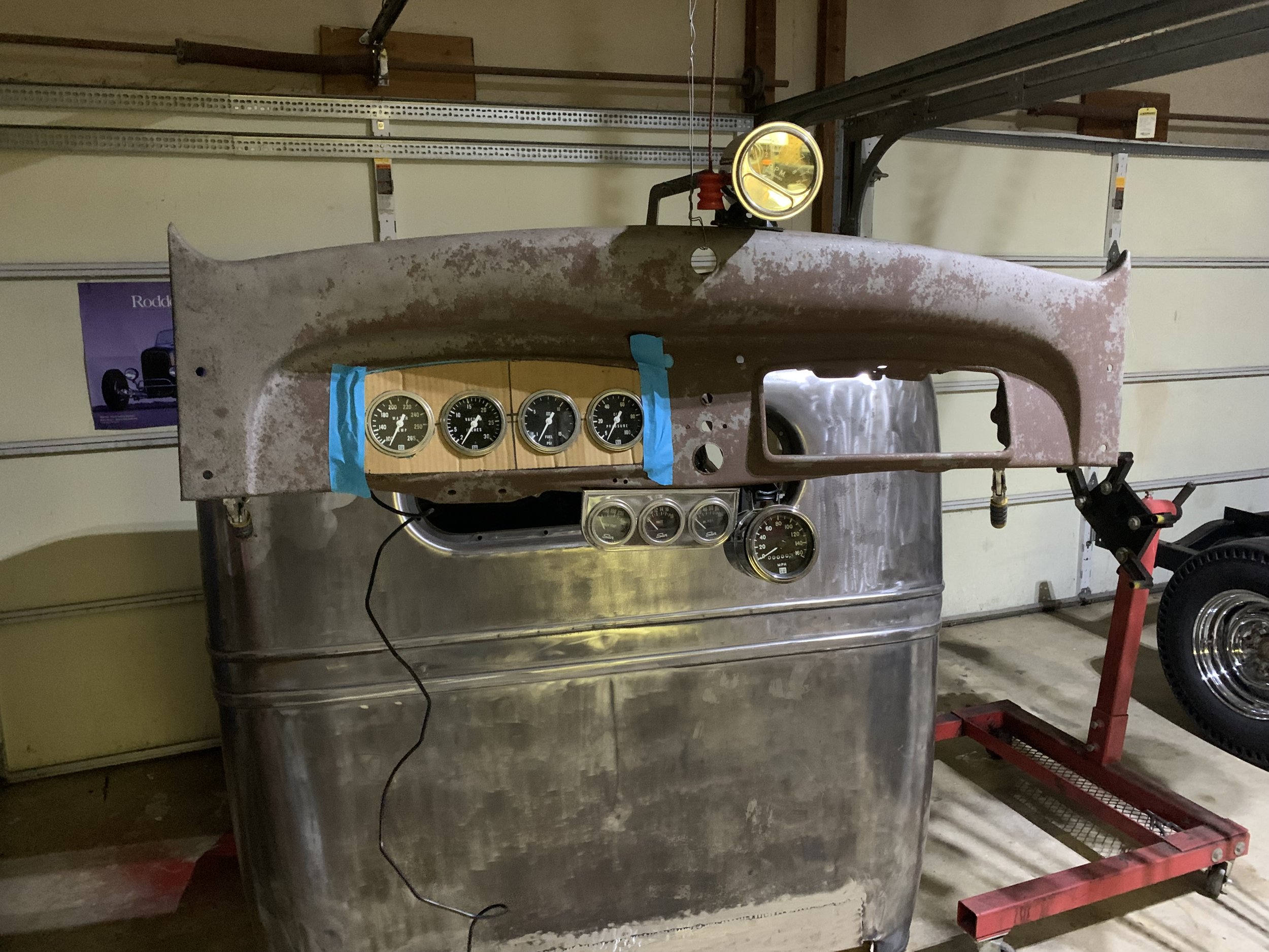

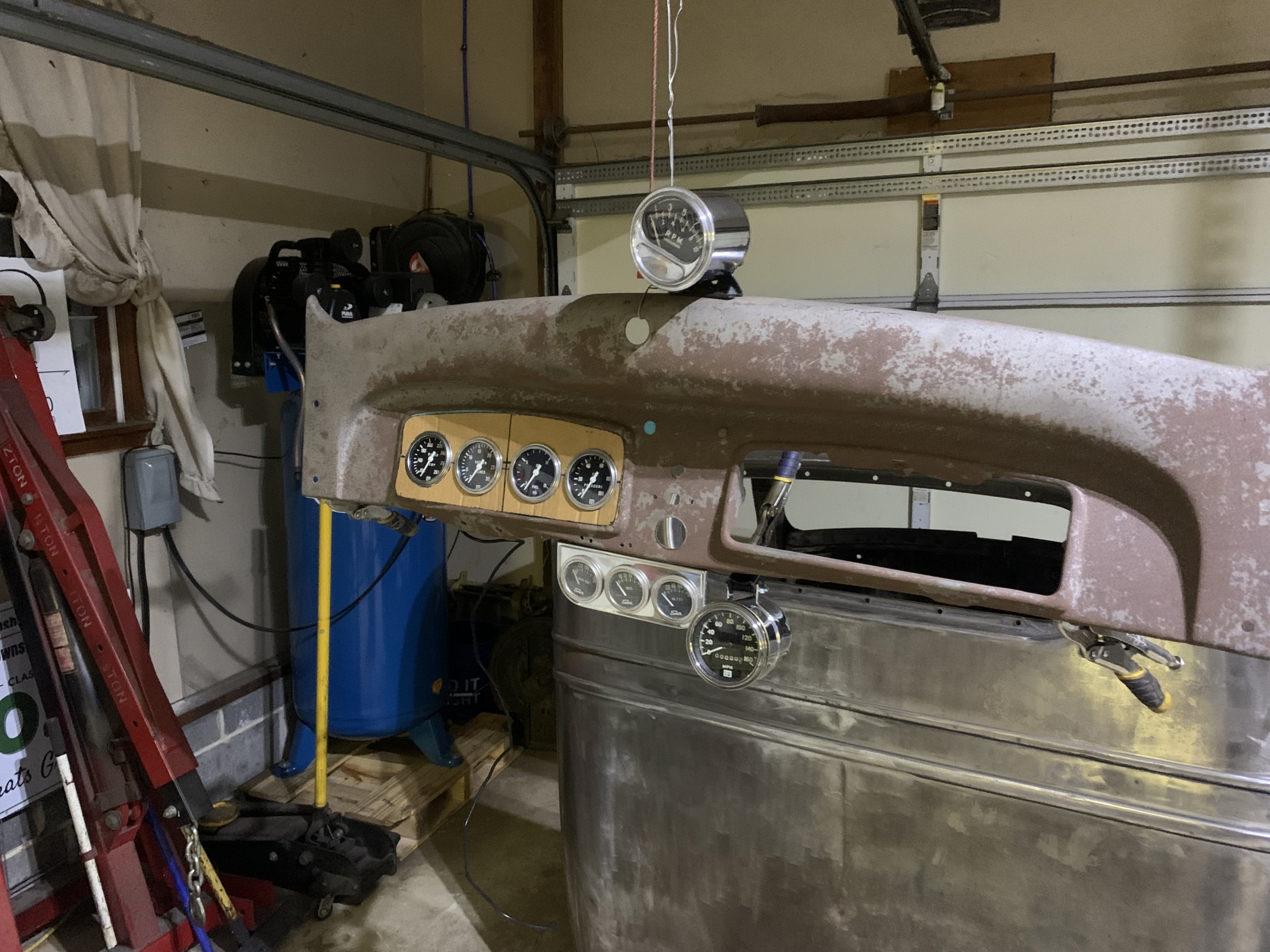

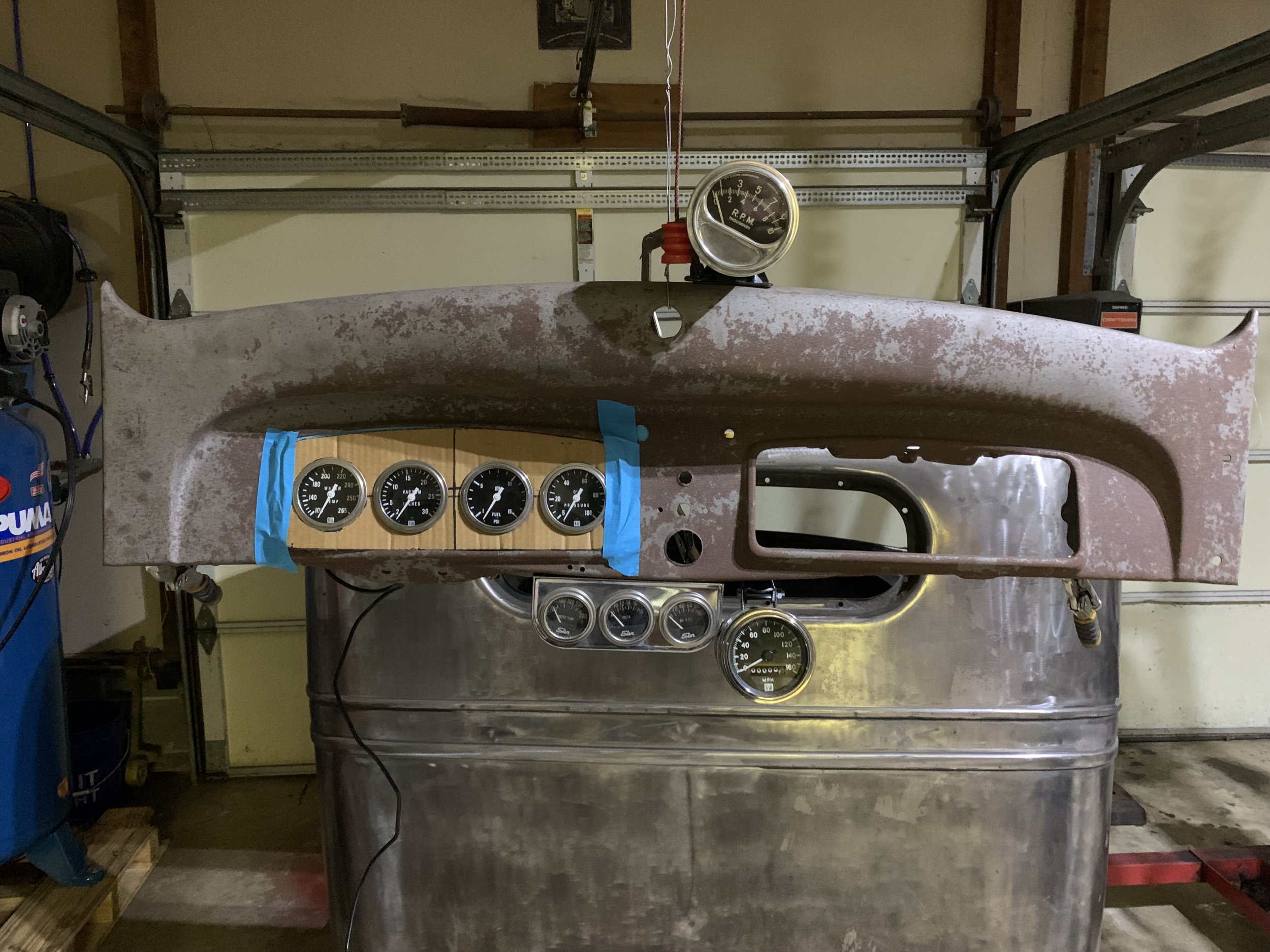

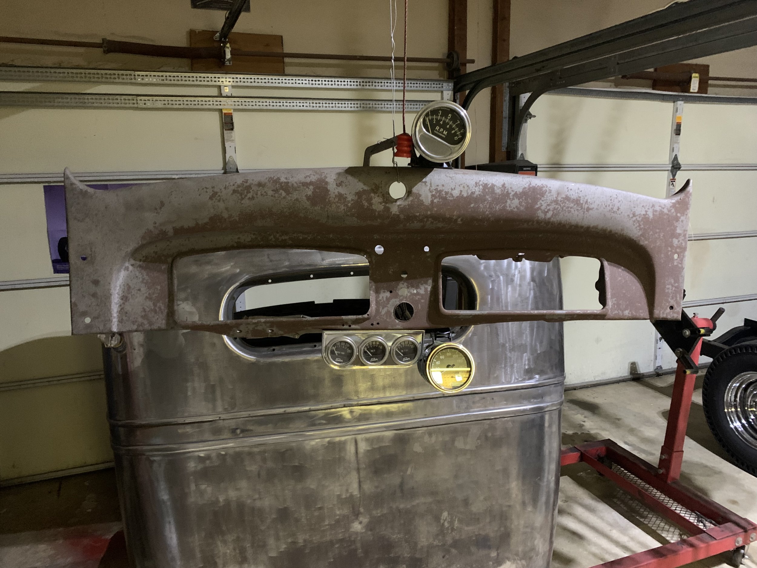

    Working on gauge placement. IMG_5463.jpeg IMG_5464.jpeg IMG_5465.jpeg IMG_5466.jpeg IMG_5467.jpeg

    Thanks man! Can’t take credit for it though, got the idea right from TechnoVersions website.

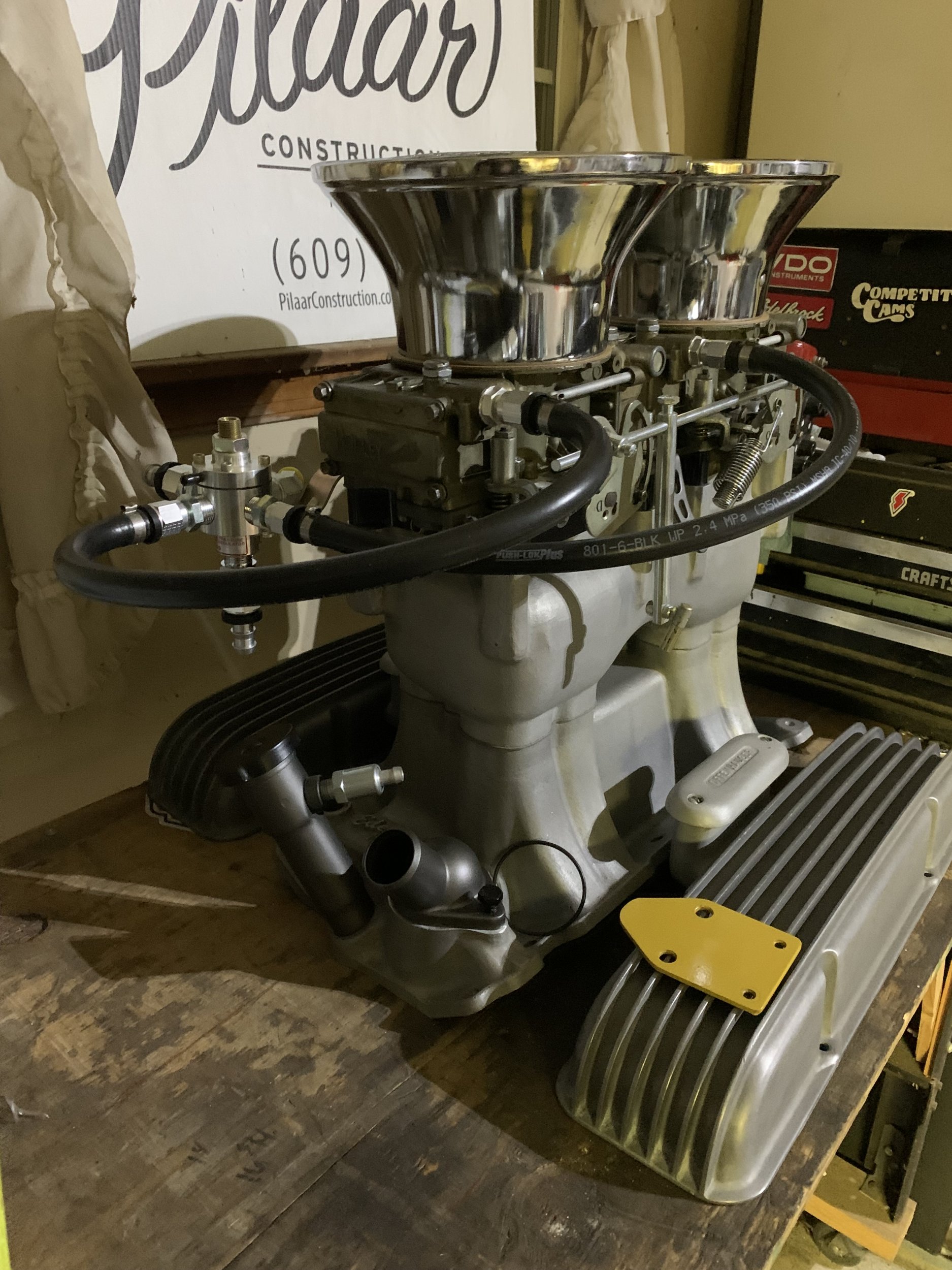

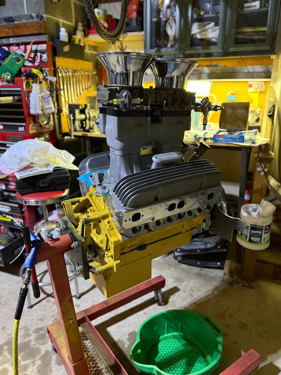

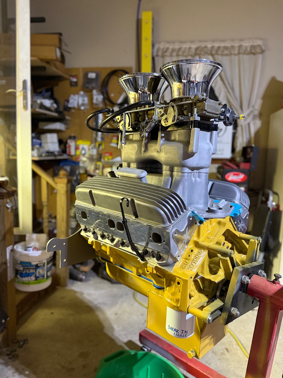

    Intake not installed yet, but couldn’t resist dressing it up tonight.

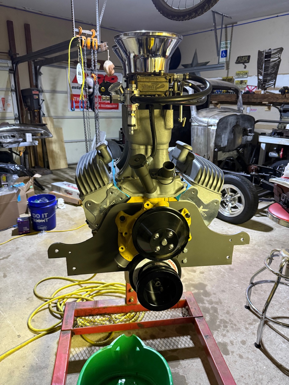

    Was about to stab the engine in and found a slight hiccup. In all my measuring for the engine (years ago), I never accounted for the bottom pulley. Duh. Welp, I had to slice up the front crossmember and because, why not, we’ll have to redo the front brake lines too. Now, I just need to weld the boxing gussets in and it will be all set for the engine to go in. Although, I am now thinking I should set up the bellhousing, clutch and trans and then put it in.
