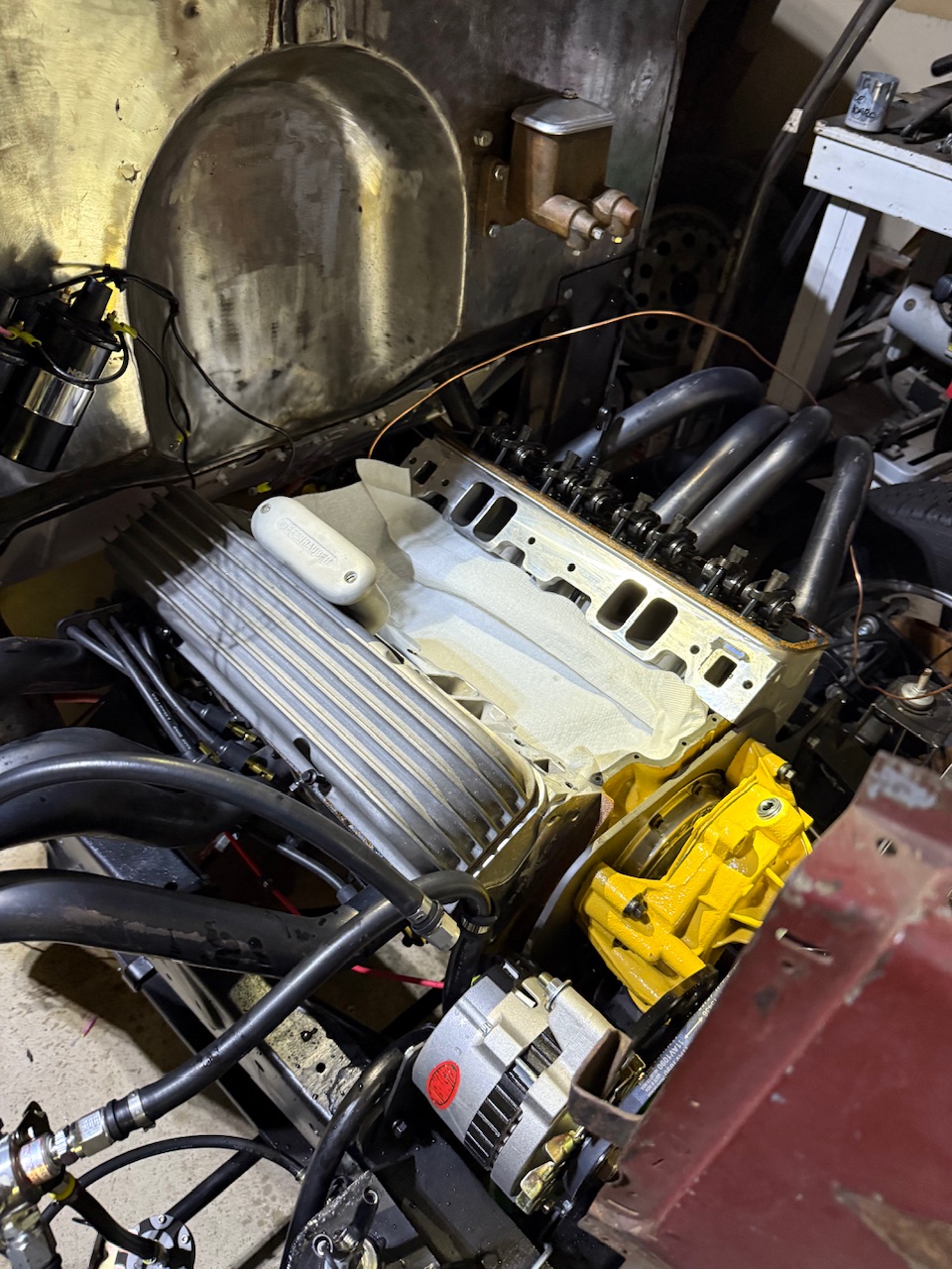

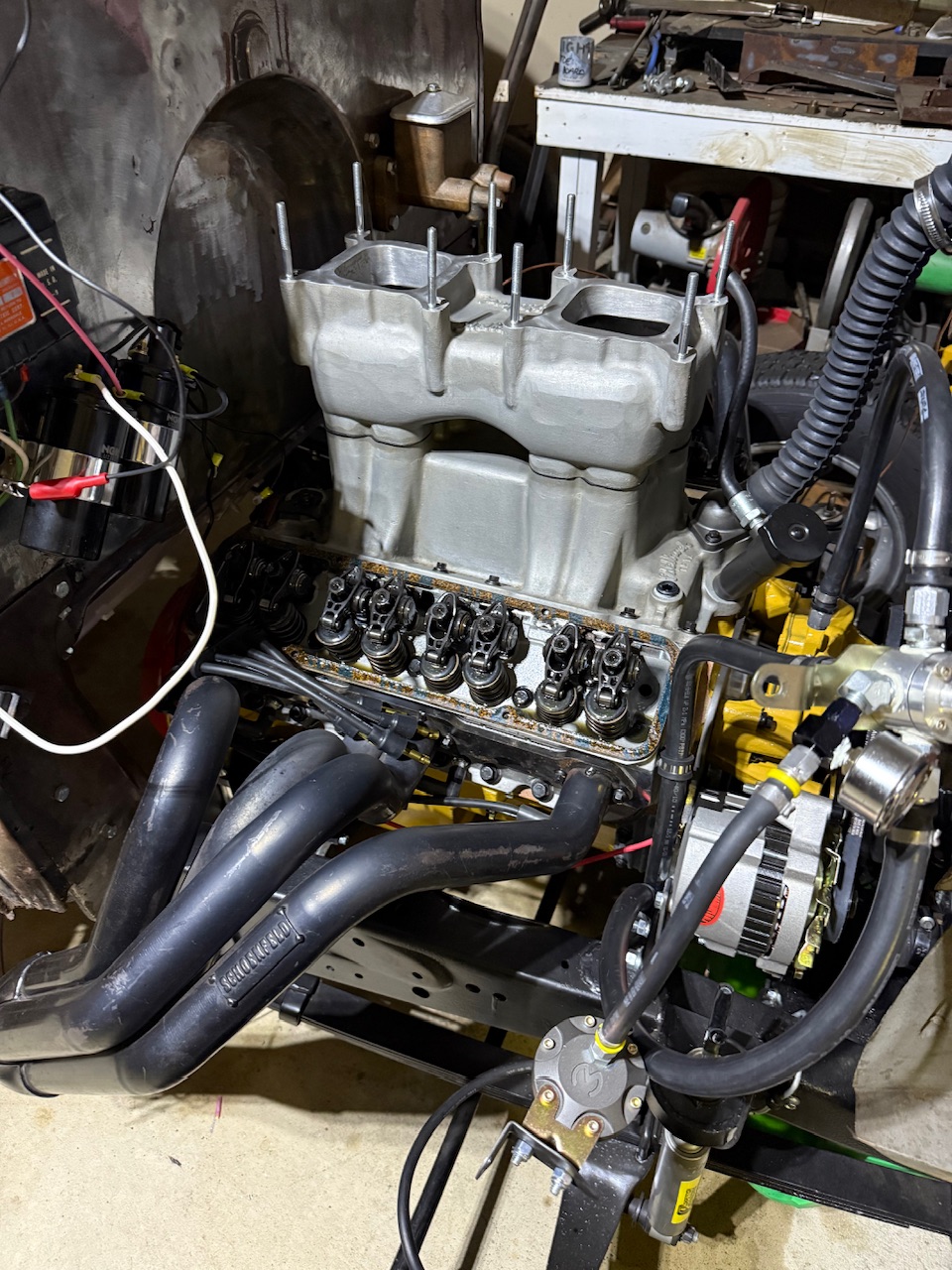

    But not the end of the world either. Intake didn’t seat properly and there was a razor blade width gap at the number 7 intake runner and cylinder head port. I ordered up some thicker intake gaskets and should have it back together soon.

  12. pila38
    Joined: Mar 25, 2009
    Posts: 1,097
    pila38
    Yeah I thought it was running a little weird and then I found that little gap and explains a lot. Trying to run this old manifold with these modern ports is kind of a challenge the manifold is a little thin at the top for the gasket.

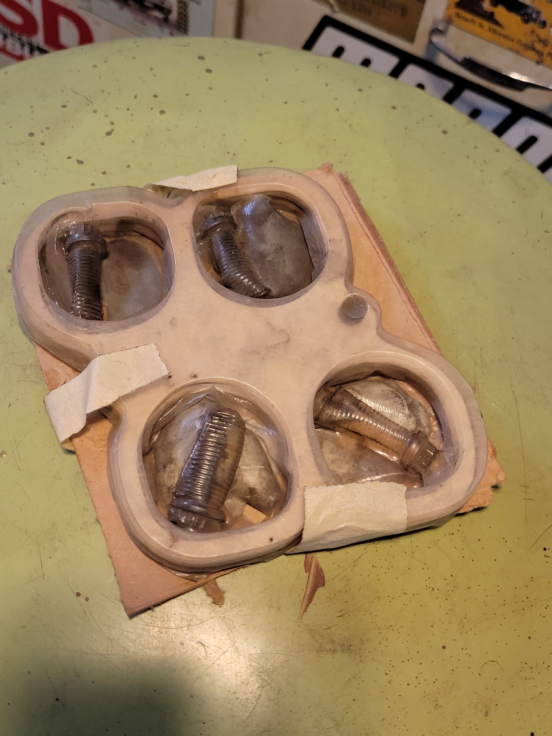

    I was using these white fiber material gaskets, in the end I used just "the right stuff" no gasket and thread locker on those bolts
    On the intake I used a Felpro gasket that matched the Edelbrock rpm heads

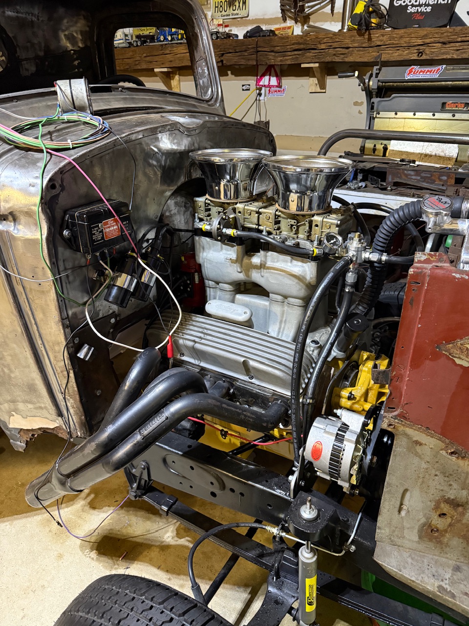

  18. pila38
    Posts: 1,097
    pila38

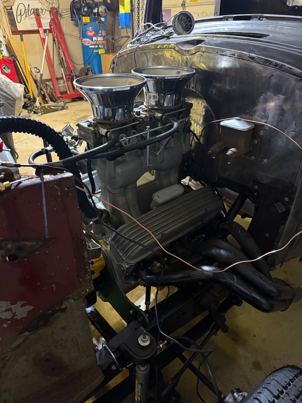

    She’s back together. Want to let everything cure up good before I fire it off again on Monday or Tuesday. Excuse my cobbled wiring and mechanical gauges, I promise I’ll make it right later.o_O
    TRAVLR, bchctybob, LAROKE and 6 others like this.
  19. pila38
    Posts: 1,097
    pila38
    I couldn’t wait any longer. Fired it up this afternoon. The videos don’t do this engine any justice, it’s f$&@in loud and rowdy. Now that the giant vacuum leak is fixed, I’m super happy. Good oil pressure, idles nice enough for now. Definitely needs tuning, but like @swade41 said, that’s the fun part.
