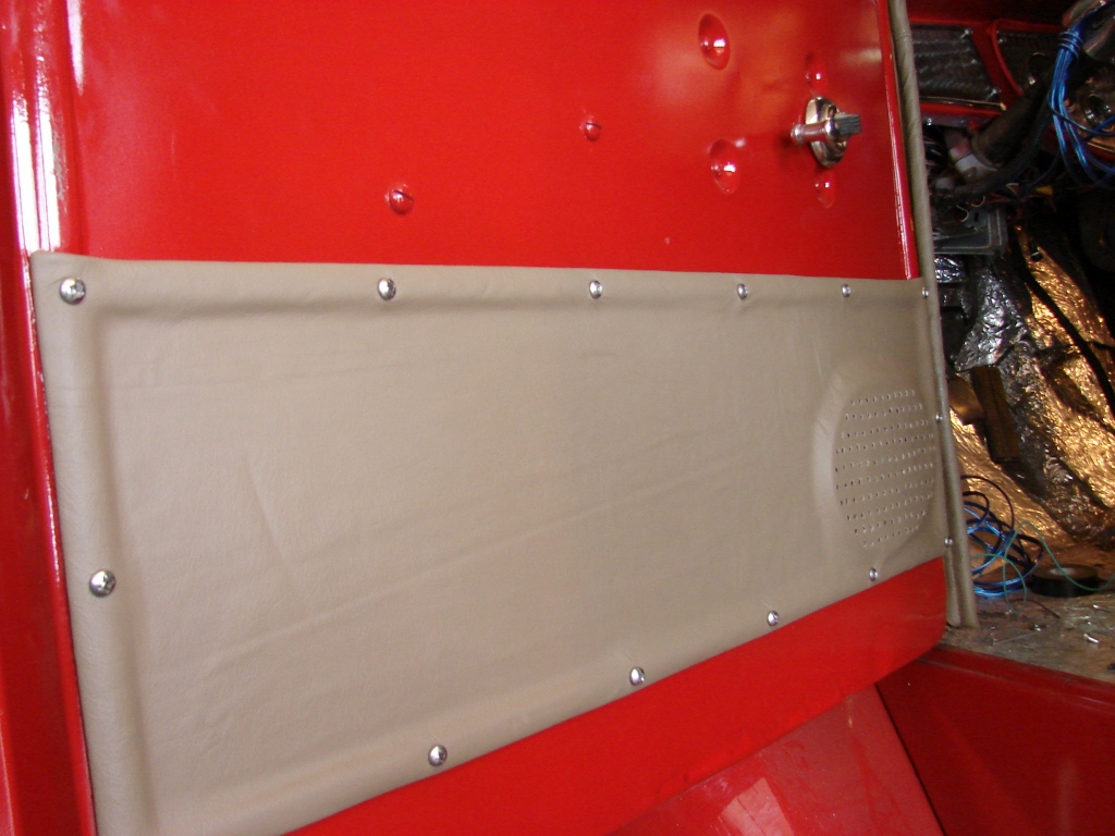

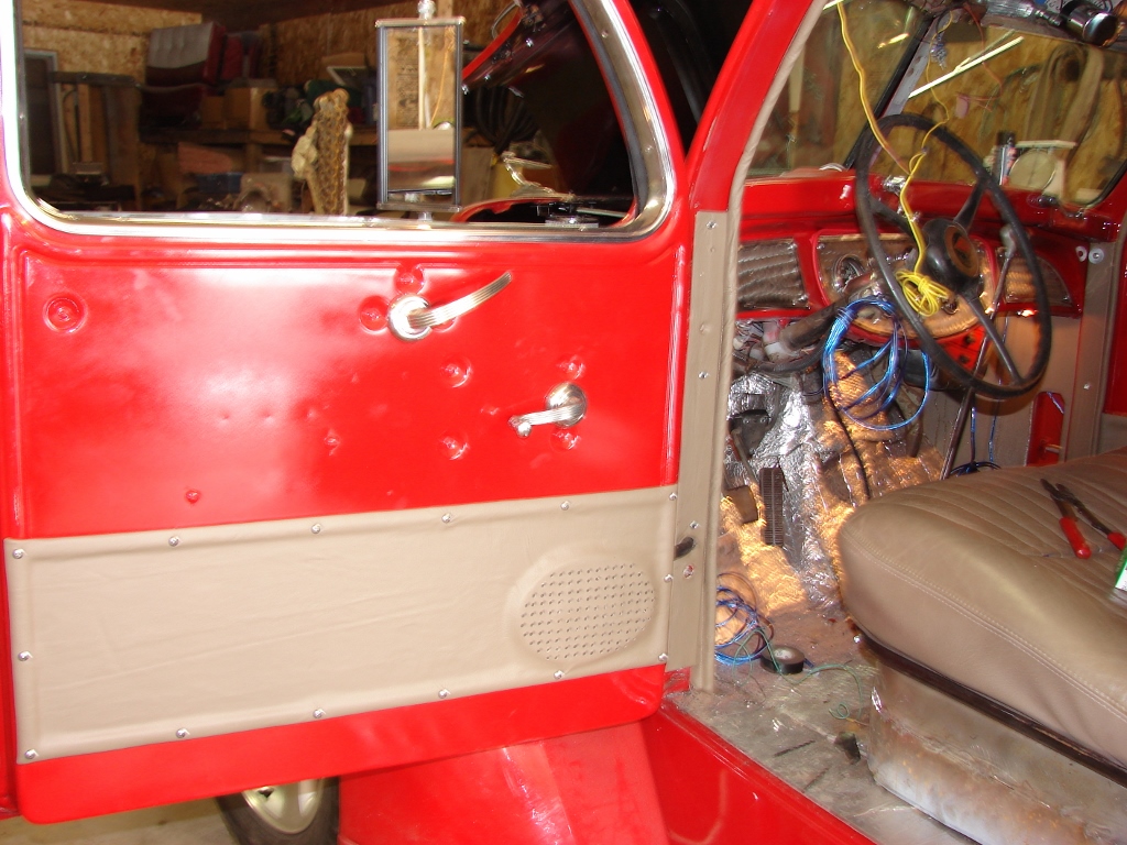

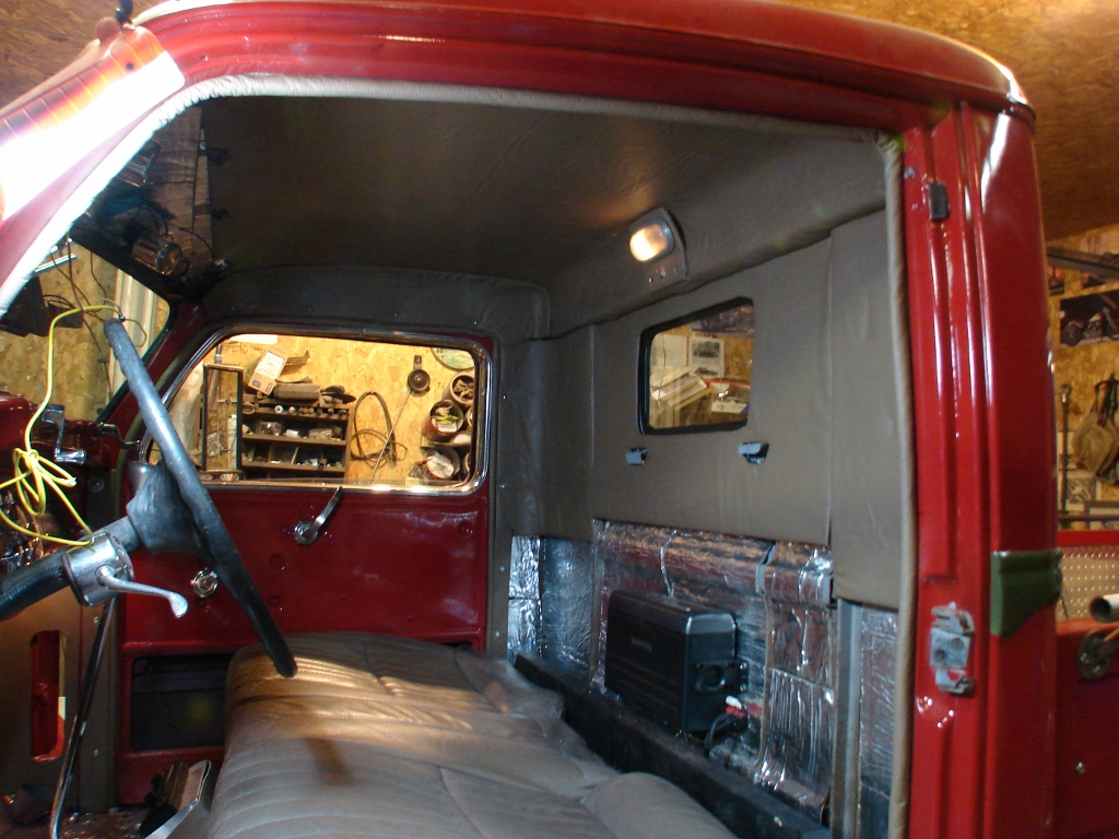

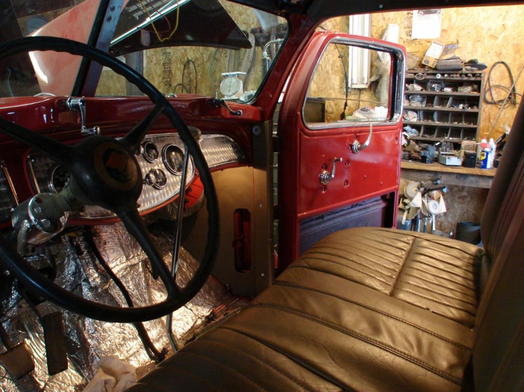

    I got the windlace in the Diamond T today, and covered the kick panels in leather to match the rest of the interior. Like the rest of the trim panels, they're .040 aluminum, covered with leather. I used Loc-***e spray adhesive on them, and that stuff is the BOMB! Much nicer to use than either 3M or the headliner adhesive from JoAnnes Fabric, and only $7.99 a can at Home Depot!

    That looks pretty decent so far.

    For the same reason I did't want the modern radio exposed, hanging under the dash, I didn't want the 6x9 Pioneer speakers to show on the door panels. I tossed the covers, and simply covered the entire panel, speaker and all, with leather. I perforated the leather over the speakers, so they're (sort of) hidden. I'd have mounted them completely behind the panel, but the door isn't deep enough, so they're not flush, but they are disguised. The speakers aren't muffled (at least to my slightly damaged hearing) behind the perforated leather.

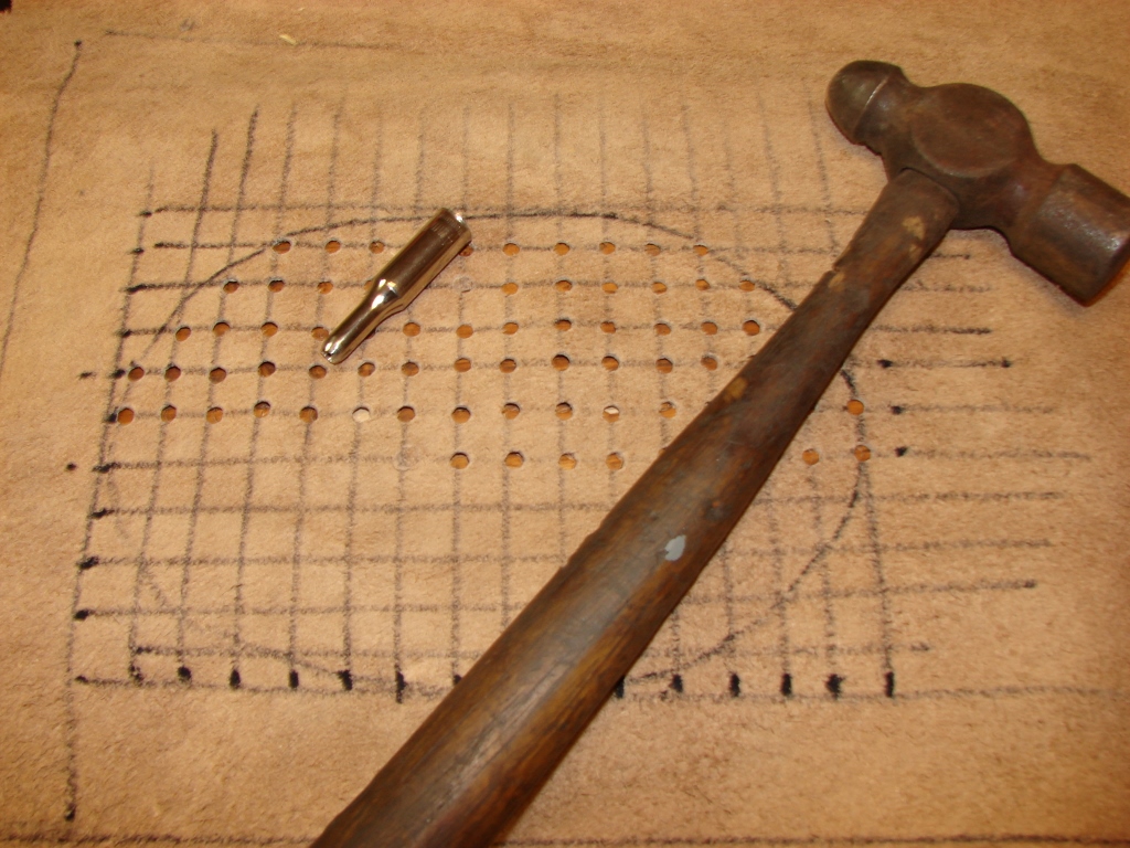

    I use a small 1/4" drive deep socket that I ground a razor sharp edge on with the grinder for a punch. The pattern is simply laid out on the back of the leather (in this case, but the same thing works with vinyl), and smack the socket with a ball peen hammer. When the socket is filled with cut out blanks, I just push them out with a small punch or finishing nail.
